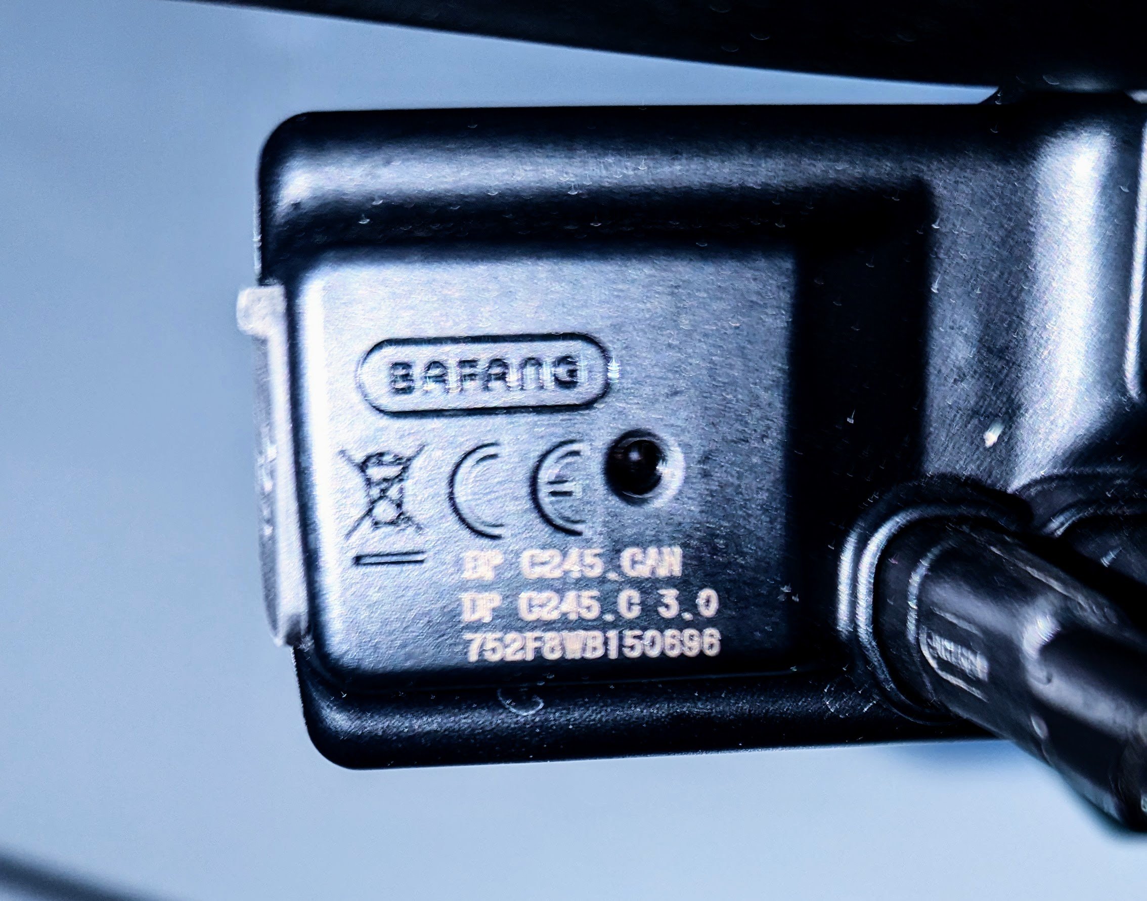

Could you post a photo of the back of the display I want to compare to LAnton's photo

Dear Mike,
Yes, DPC245 is 2.0 version, it only fit go, can not fit go+, version 3.0 is better. We keep asking bafang to offer the 3.0 version, but bafang do not start mass production for 3.0 version, and in the marker, there just only some version 3.0 samples, we can get version around Aug, thank you very much.

I have the same issue with the Go+ app, apparantly it only works with C245 controller which has the QR code PD051505 . Mine is PD051405 and will connect but with an error message. I havent tried the older app yet.

Only DP C245 3.0 bluetooth 5.1 can connect to Go+ App

Have you found anyone selling the DP C245 Ver 3? The Aliexpress ads for the C245 which mention Go+ in their ad are not Ver 3 and hence do not support Go+. How do i know this? I bought one.
I got DPC245 from Aliexpress to replace a DPC185 that looks like a smartphone with no additional functionalities. DPC245 is great. Pitty about Go App not working for me too.
