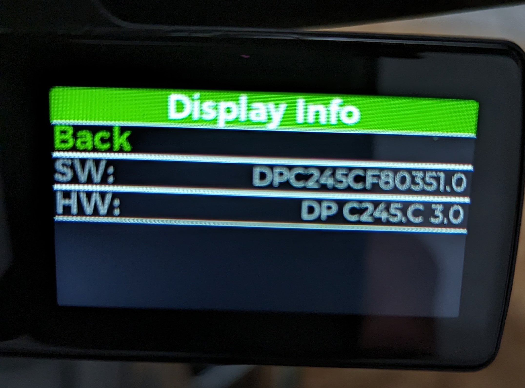

Just test on my M820 with DP C245 not working. Can U show us your DP C245 version? and what smartphone U use?
Yes I will take screen shot tomorrow, Battery is inside and charging tonight. I am using Google Pixel 6 Pro Android 13.
