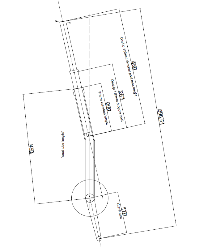

Height 182cm, fit for frame size L, the Max droopper post insert length is 200mm, not 180mm,
Hi Jim
Yes insertion length is 200mm but the longest dropper post to fit the frame is 180mm (stroke). The shortest insertion length droppers are made by OneUp. If 240mm (stroke) dropper post is fitted in LCE930 frame than 184cm tall person will have too short legs to reach the pedals.
Hi Jim
Are there any news if the frame can be supplied with the motor+battery kit ? Or the motor+battery kit have to be bought somewhere else?
Thanks
That is really good what you did there.
You need to create a little website where people can insert their preferred dropper post dimensions, frame they are considering, crank length, current pedal to seat height, and determine what max dropper they can fit in the frame they are considering. Should also add a dimension for the thickness of the preferred pedal.
Inserting my known pedal to top of seat dimension I'd be able to squeeze on the 180 OneUp whereas on my SJEvo for example I currently run a 200mm KS Lev (which isn't as compact as the OneUp).
