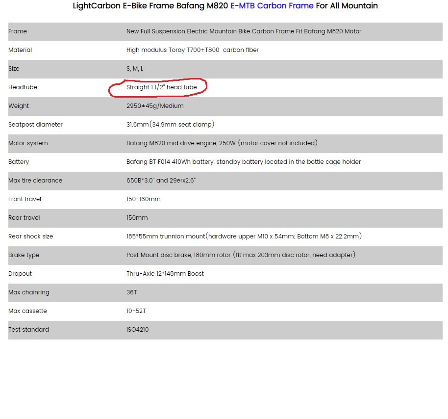

DJ_Eagle
Mar 2, 2023
Hi Guys,
First at all: Nice looking Frame!
BUT?
I am a bit Confused, Straight Tube? Can you Show me a Fork for 27.5" or 29" wheels with more than 120mm of Travel with a Straight Tube?
you can see the Head Tube also on this Video very well, it really Looks Like 44mm upper and lower part. Or i am wrong?
brbr
Dec 28, 2022
463
244
France
Hi Guys,
BUT?
That's a good remark, I did not even notice it, I was quite sure it was OK for a tapered fork.
I guess you can use this kind of adapter ? 44MM INTERNAL X EXTERNAL 1.5 INCH HEADSET CUP
But will it impact the cable routing ?
TCFlowClyde
Feb 26, 2022
1,227
789
Mesa, AZ
[/QUOTE]
Ask Jim at LC of course. But, I think it's likely a typo...the head tube is conical and probably for a tapered steerer tube. (Although even a lesser conical head tube could still use a straight one...but it's rare in my personal experience.)
But I think a reducer on straight steerer MIGHT present internal cable routing issues from the IRC headset.
(The reducer should sit flush with the bottom of the top bearing well.)
Just FYI: Plus, those reducers are usually heavier aluminum block disc inserts. I'd guess adds another 200+ g?
Bottomline clarify with Jim?
brbr
Dec 28, 2022
463
244
France
[/QUOTE]
Yep, you’re totally right, we’ll see tomorrow his answer

JimLee-Lightcarbon

Hi Guys,
BUT?
The data "Straight 1 1/2"" is the for head tube,the fork request tapered forks, the rest space of head tube is use for inner cables,
