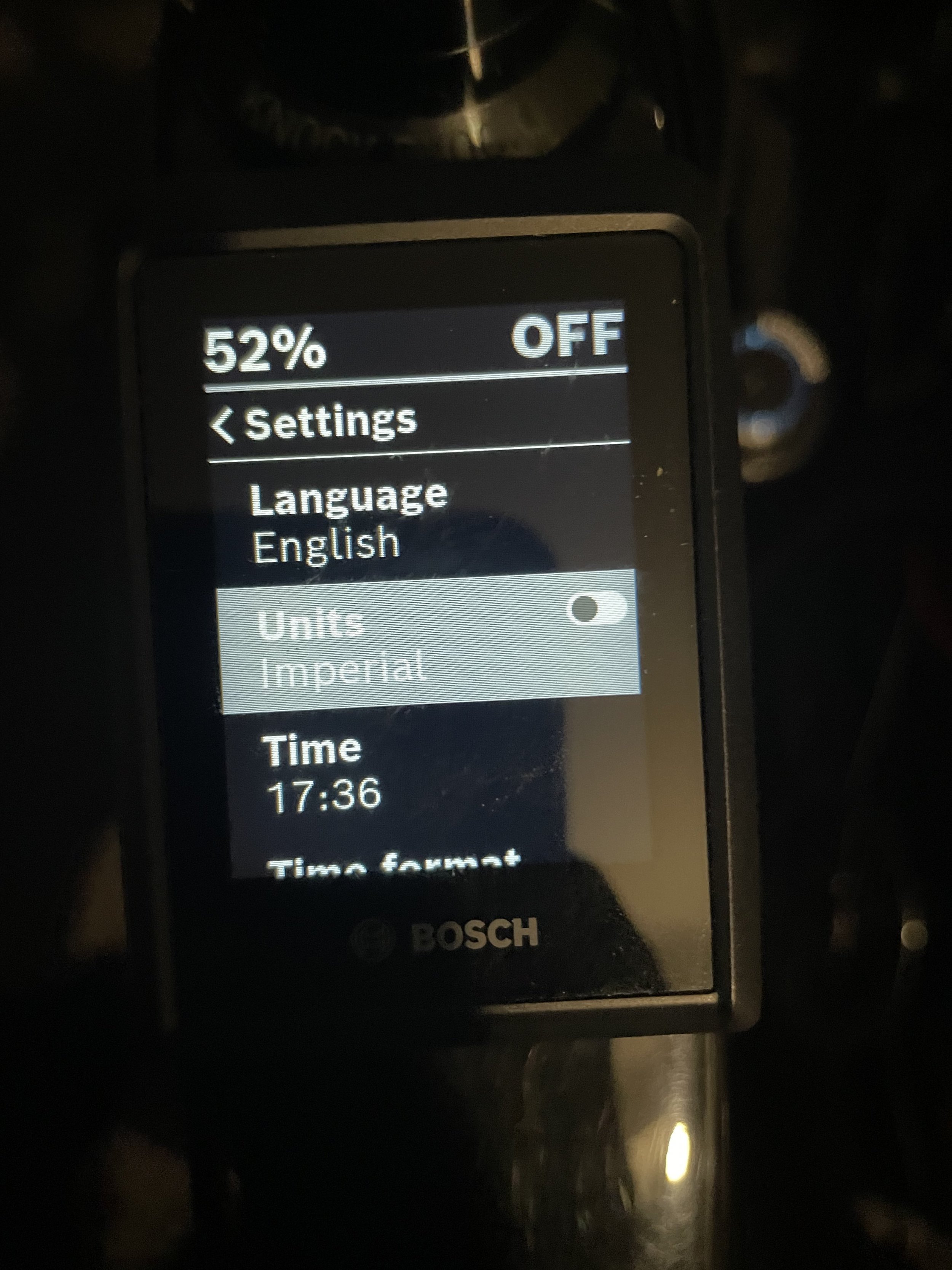

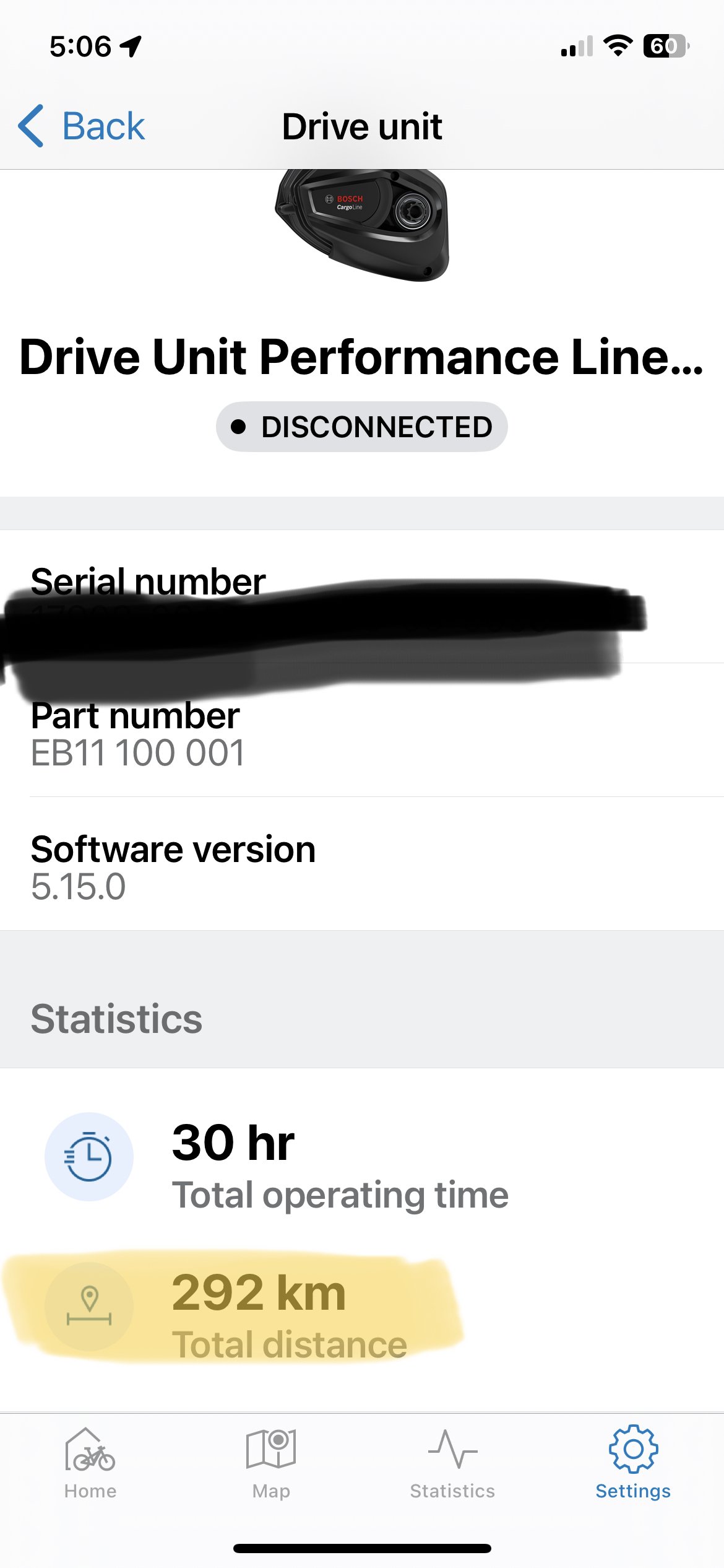

Can you share a snap shot of your drive uint, mime is showing in KM which should be in Miles I believe, i’m in the USA and I wonder if they pushed the incorrect firmware to some folks.
iPhone 12 Pro
Now I just spun up the rear wheel on my bike stand with the bosch smart system on, I did two full turns of the cranks and the distance I traveled 778 feet, I am thinking it is something in the firmware on the motor and the sensor communication with the magnet, idk, frustrating to say the least.
I also check the units of measure and it is set to imperial.
