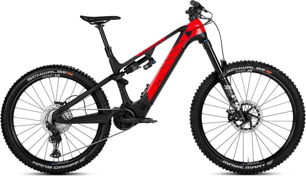

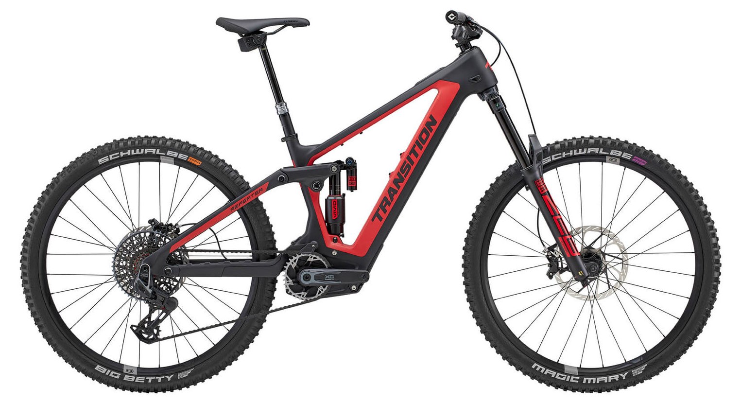

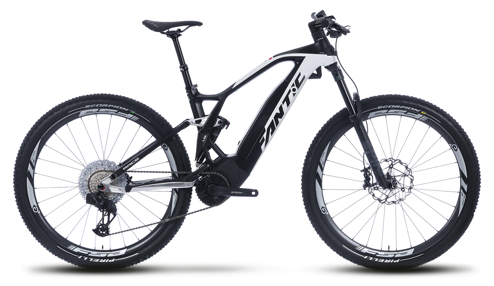

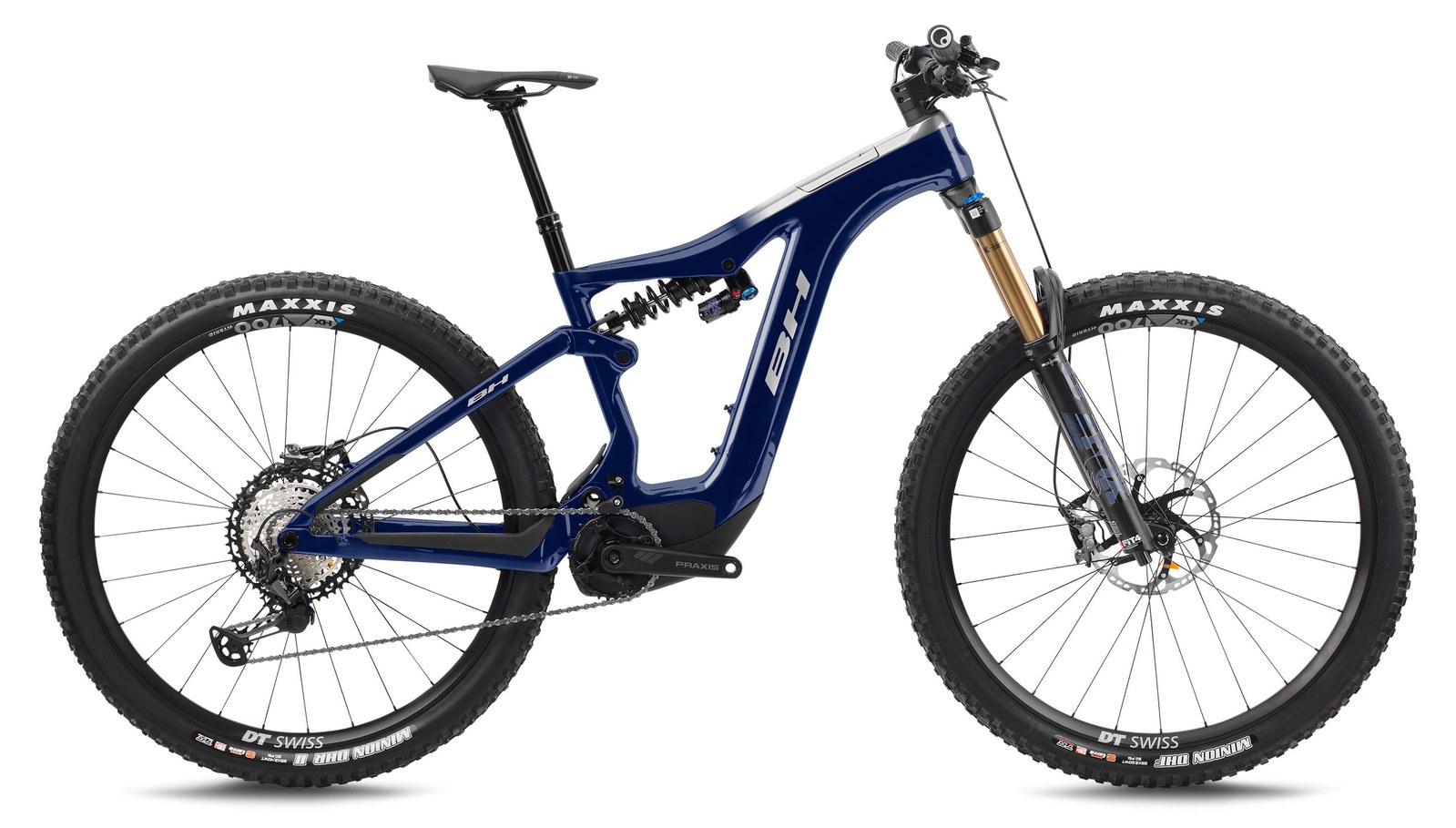

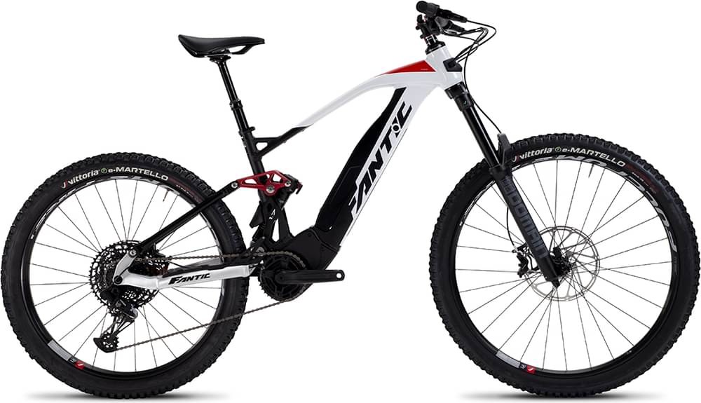

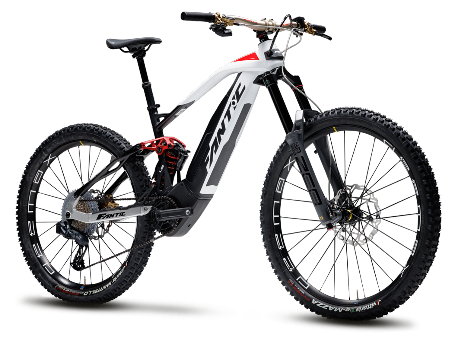

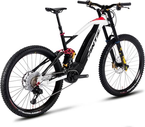

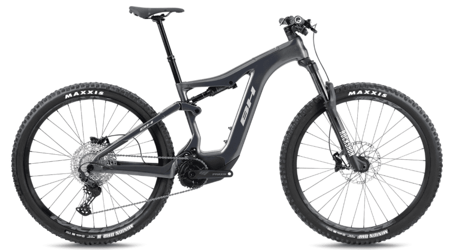

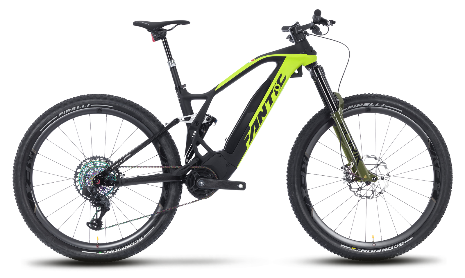

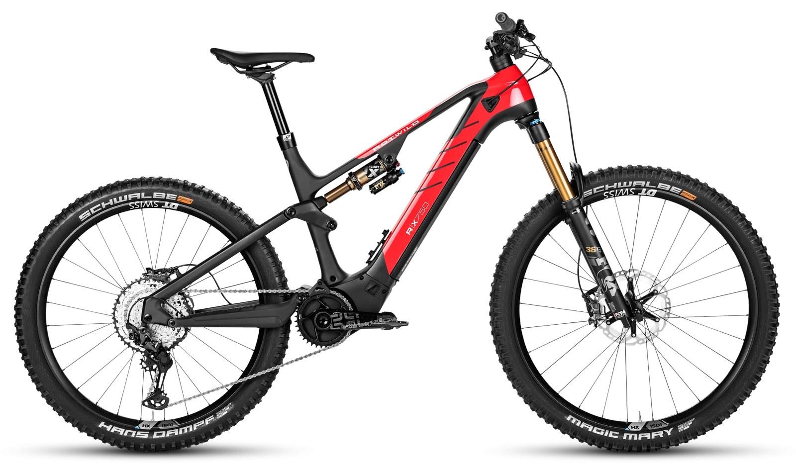

Bikes you'll find it on. Trail riders should look at the Fantic XTF 1.6 Carbon Factory 2025 (160/160 mm) or the lighter BH AtomX Lynx Carbon 2025 at 150 mm. For enduro the Fantic XMF 2024 at 170 mm is the sweet spot, while the Fantic XXF 2024 pushes to 200 mm of travel for park use. Rotwild R.X750 2024 is the integration benchmark, mated to a 750 Wh pack and Rotwild's own tune. The Transition Repeater 2025 (now discontinued) used the most raw, least-filtered tune in the lineup. Fantic's firmware leans aggressive on initial bite; BH runs a noticeably softer Trail map.
