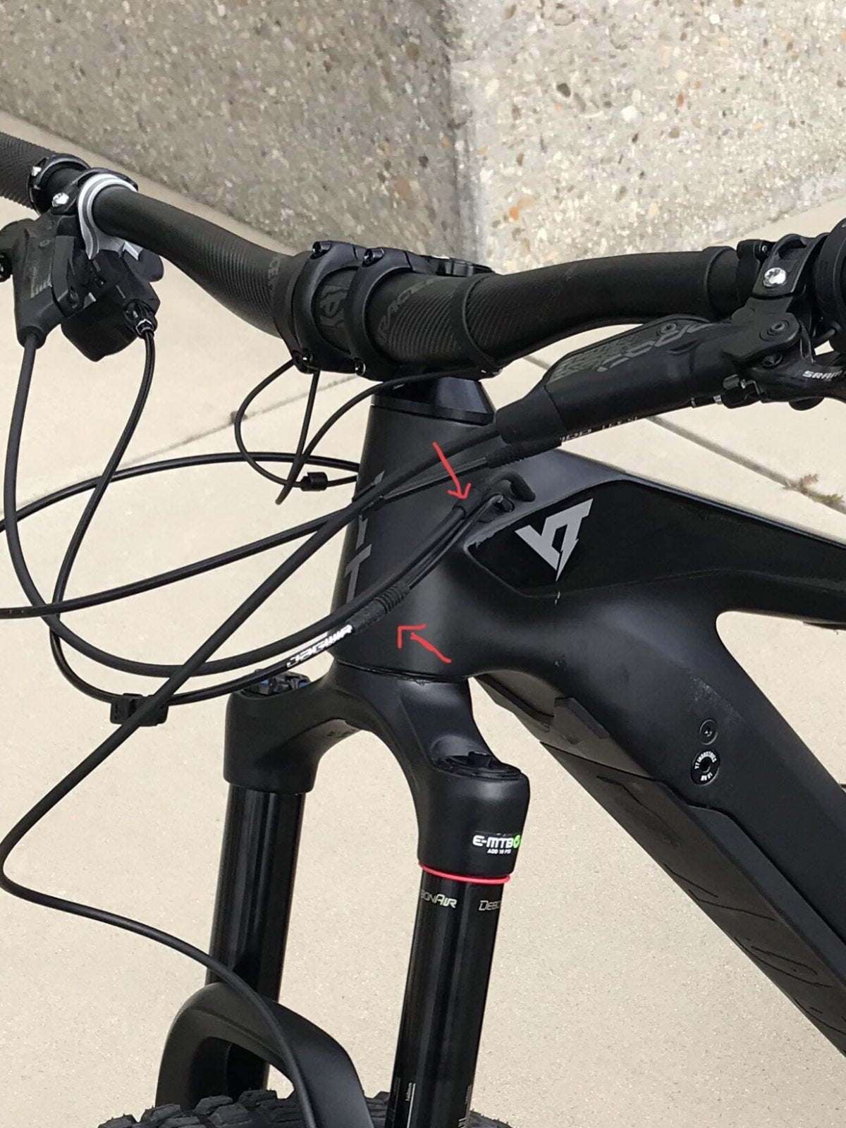

The bike comes with these little rubber sleeves on the hoses. They don’t really fit into the frame cause there’s not much room and when you try to jam them into the hole they just kind of squish everywhere. Mine migrate all over, because I never really got them deep into the frame. Not sure if they’d stay in place if you manage to get the ribbed portion into the frame hole.
Yea the cables are ridiculous! That pic was straight out of the box. I’ve heard YT is usually very precise about cable lengths but they’re clearly uncut. It was double frustrating they didn’t include hardware to shorten them. I ended up spending $20 for it so I could shorten them at home. But I’m sure you could argue with YT to pay your lbs to do it.
It’s funny I think they left the dropper and shifter cables extra long to match the brake cables so they could use the stupid double sided clips.

One item I'd like to ask folks with delivered bike: Are you having issues with the frame grommets staying in place where the cables comes through? Mine keep moving about and I've got a few ideas that require small cable ties to try and solve this.

Yes same little issue with these grommets. If you solve this please post some picture.
Yep, I found a good wiggle, ideally when wet, whilst moving the cable a bit helps embed them further (a few of the ribbed parts at least).
To be fair though with the frame design and direct access to all cable runs......their water tightness isn’t a real concern, just avoiding the cable rub will do.

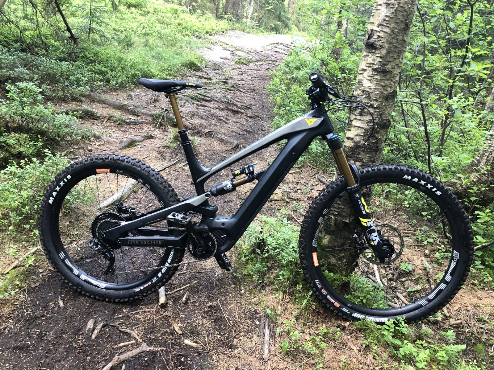

I’m 175 pounds. Bike specs are:
- Large decoy base model
- 160mm travel Yari with Avalanche damper and Vorsprung Smashpot with a 55 lbs/in spring and minimum preload
- Avalanche tuned Bomber CR shock with 450 lbs/in spring and 2 turns of preload
I’m running pretty open LSC and roughly 3/4 closed LSR.
Still need to take it to the bike park to try some proper lips and drops, but I was hitting some chest high jumps at over 30 mph and the bike felt amazing. Also did a 14 vertical foot step down resulting in a pillowy soft landing. There’s a little more feedback on the small stuff, but the responsiveness to slapping and brapping is sweet.

The smashpot travel adjustment is super simple, but the spring rate recommendation changes. I’m limited to 160mm on the avalanche tho (they come in travel ranges 180-170, 160-150, etc).
The tuner recommended a 400 lbs/in spring for the bomber, that netted 31% sag. The 450 lbs/in nets 25%. But I basically tuned it for bottom out. Even with a fair amount of preload I’d slightly bottom the 400 on my biggest local drop. With the 450 I’ll have to case something hard to bottom out. I think the over spring coil is still far more supple than most air shocks. The manitou Mara looks to be a very plush air shock. But the biggest reason I went full coil on this bike is maintenance. I figured since it’ll be doing a lot more miles than my pedal bikes ever did I’d rather not have to air spring/can servicing all the time.
That makes sense. I'm a similar weight and bounced between 400 and 450 lb spring and went with the 450 for those reasons. Still better through the stutter bumps than an air shock. Before I sold that bike I was considering a 425 from SAR(super alloy racing). I had ordered the 450 originally to be safe after bottoming the 400 ten many times.
