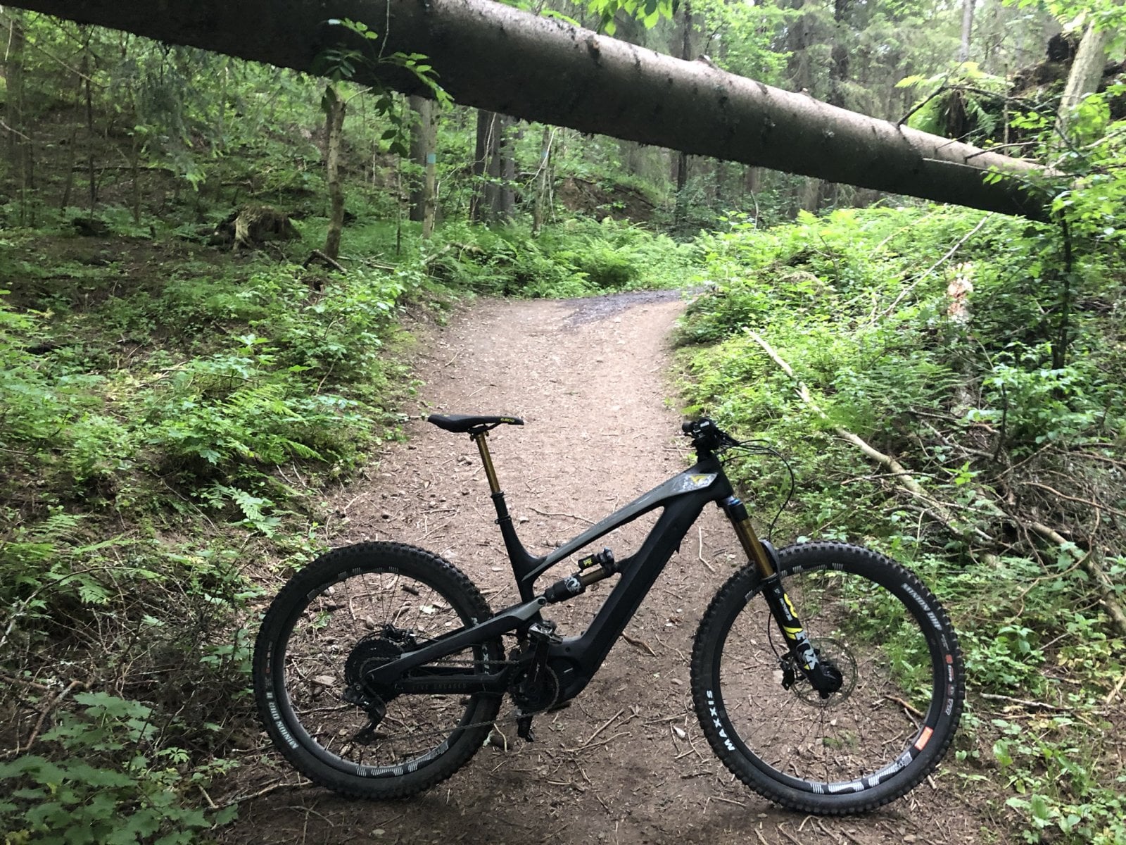

issues so far with my CF pro black.
1. the cable pods falling out all the time
2. there is a loud repeating backlash clunk in the shimano motor when there is no force on the motor (downhill) its annoyingly loud.

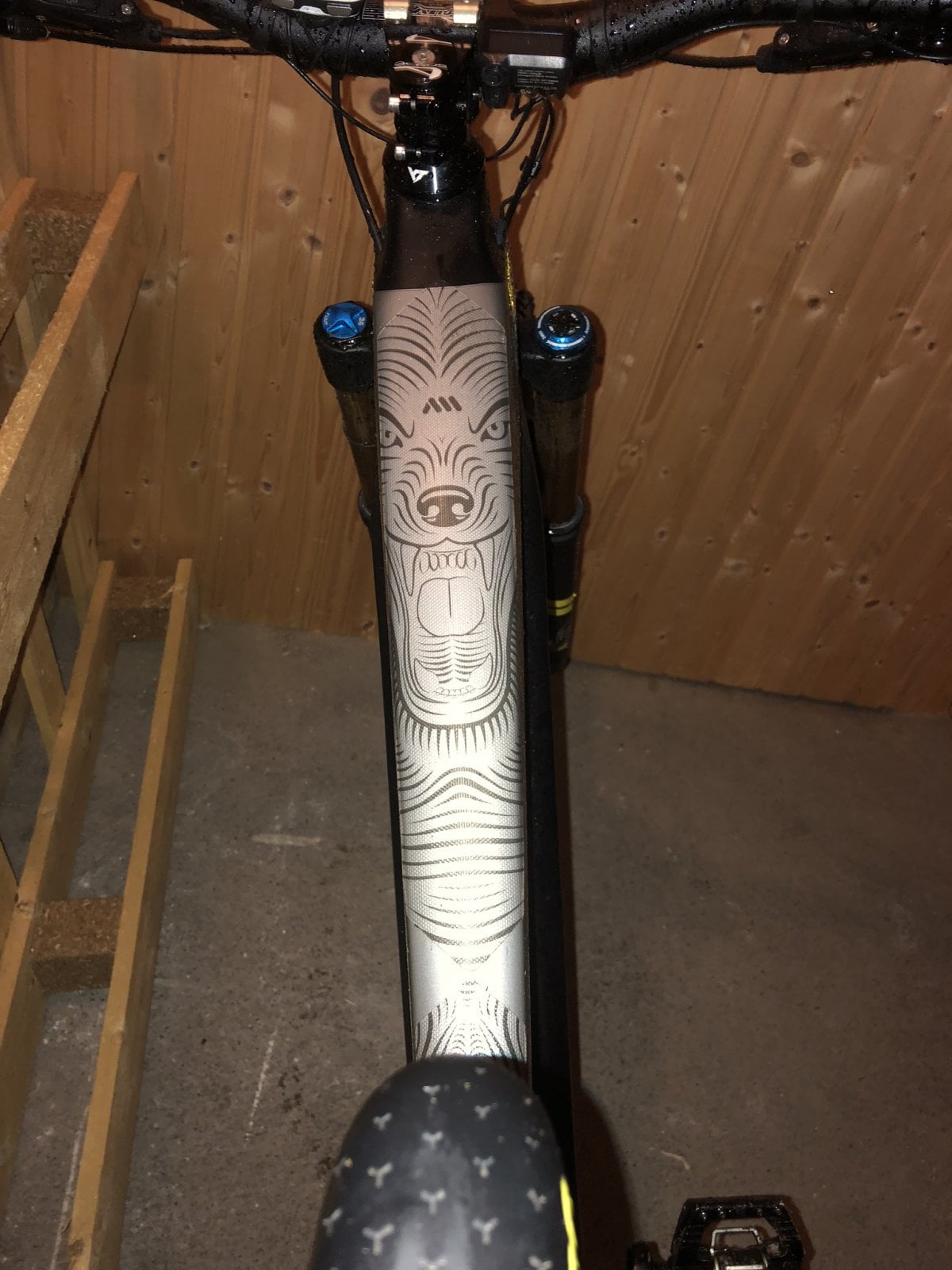

3. the toptube acts like a mirror, black glossy, distracting in sunshine and very prone to scratches (wraping it in vinyl)
4. compared with my non ebikes (speci enduro, yt capra) the chainstays and the motormount feel kind of squishy under full load. I think thats related to the much higher torque with a motor.
5. battery lid is kind of sticking out a bit, gap is filled with some foamrubber, does not look really professional.
other than that its a monster! holy cow... this thing rips, grip is outstanding and it handles like my 2016 capra cf pro race. the fork has grip2 and it feels great.

I only have managed to ride 50km so far but everything is doing fine. its still stock, no tuning, no derestricting yet.
the battery is crazy... on my first ride 20km (up and down) only one bar (20%) was used. And I was mostly in boost mode!? I think it has to calibrate itself with a few cycles first.
that big 2.8" back tire is so much fun... I would never ride such a big tire without a motor but man does it provide grip!

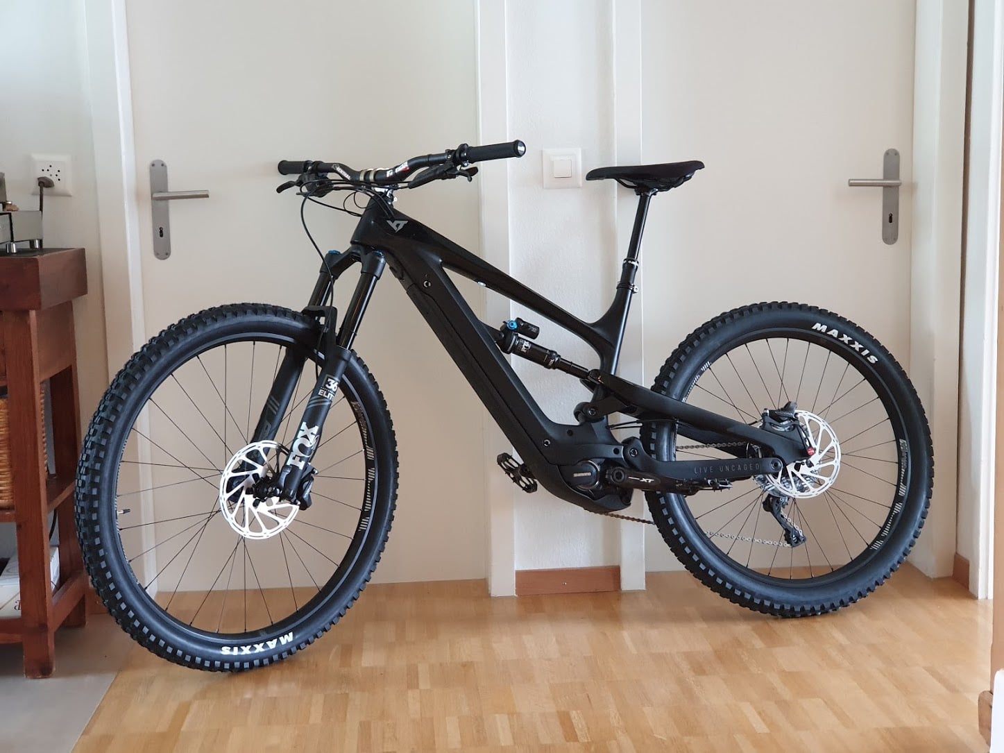

Size L (they got smaller since 2016, my L capra feels bigger somehow)
here is a short video of the annoying backlash rattle... while riding its loud and I am used to almost silent bikes.

Size L (they got smaller since 2016, my L capra feels bigger somehow)View attachment 15351

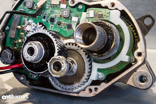

Isn't that just chain slap on the chain guide? Adjusting the guide may help?
Sadly its not. I am not hitting the chainguard. Its inside the motor. I do have a normal ebike (bosch) it has the same clunk to some extent but you wouldn't notice it on normal roads.
I have a Shimano Center nearby. I think I will go check out some other e8000 to see if it is just normal or if my motor has an issue.
I have two E8000 equipped bikes and haven't heard a noise like that before

@Marc
Is it a carbon chainstay?
Hollow carbon amplifies knocking sounds a LOT
Mastic tape the fk out of the rubber chainstay protector.
(possiby insulating underneath it with a thinner tape as well)
the chainstay is carbon but there is a thick rubberprotector around it. I am not touching anything with the chain in my video. its like the gears inside the motor have no dampening.
the carbon does transfer the sound everywhere thats why I was looking for loose parts at first on my initial ride. But I tracked it down to the motor. when I am knocking on the chain you can see the crank wiggling slightly. thats whats causes the sound not the chain.
at this point I hope my motor has an issue ;)
Ah...
have you owned a bike with an E8000 motor at all previously?
There aren't gears as such inside the motor but as the e8000s chainring spider freewheels it needs to engage and disengage just like any freewheel. The sound you are hearing is freewheel pick up. It's the same sound you'll hear on every e8000 motor if you lightly apply pressure to the pedal and release while stood with one foot on the floor stationary. Perhaps amplified because of the carbon frame construction? the noise shouldn't really be noticable while moving as the hub should be freewheeling. it should only really happen when you start to apply pressure to the pedals again from freewheeling.
check that your hub freewheel is smooth and freewheels without resistance.
also is there play anywhere at all on the bike there shouldn't be?
Is the crank spider lockring tight? (the splined lockring that looks a little like a 20mm centrelock hub lockring) which holds the spider on? it's easy to check. the spider mounts to a splined section of the axle and will have slight play if it's loose
Are all (6) Motor mounting bolts tight?
Is the rear mech clutch (if Shimano) on?
Carbon is annoying AF for transferring sounds from one frame area to another.
a few years back I had a tiny intermittent creak from my carbon roadbike that sounded like it was coming from the BB area or possibly the seat post. I disassembled the BB. removed and cleaned the seat post carbon pasted and it was still there. went over the bike (every component) and it still remained. eventually i tracked it down to one tiny rear mech hanger bolt being very slightly loose. (the other hanger bolt was tight so the actual hanger didn't feel loose at all but it was obviously just loose enough to cause friction under power/turning forces to cause a creak that sounded like it was coming from somewhere entirely different.
cool story I know. ;)
hope some of this helps. if not I hope you find the issue.
  • Like
Reactions: 06z
first of all I want to thank you. really appreciate your efforts to help me (y)
its my first emtb. thats what I meant in my first post - my normal bikes are silent other than the usual hub noise. I checked every bolt and the lockring is tight. rear mech clutch engaged.
there are quite a few gears inside a e8000 but maybe we are not talking about the same (language barrier on my side ;))
I am afraid its freewheel pick up - backlash on the chain from the suspension leads to a recurrent rattle. thats why I said I hope its a motor issue. Uh that will be quite hard getting used to but I know I am very picky regarding noises with my bikes.
btw. my Decoy CF pro black large with atlas pedals and a few pieces of vinyl is 23040g or 50.8lbs.
