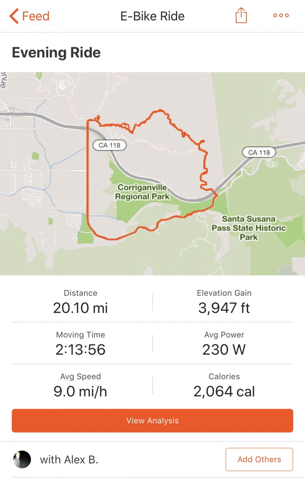

I have a small battery range anecdote. I rode with a friend in a mix of boost and trail. I didn’t use any battery saving techniques. My friend and I paced with each other. I ran out of juice about 2 km from the car, his trek powerfly did not.
I’ve noticed it takes a long time for the first bar to drop off the battery indicator. But the last two bars go really fast. It has given me a false sense of range and has led me to run out of power on other rides.
