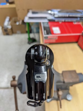

I am currently riding a Cane Creek DB Coil CS with 550 lb spring. I have been super happy with the ride. Sag is right around 30% and I don't know if I've ever bottomed, certainly not hard since I've never noticed. Not so happy with the shock failing after ~90 hours (oil leaking out). Also the top bushing "migrated" somehow:
Also, there's a LOT of flex in the shock. You can flex it easily by hand when on the bike and the shaft has noticeable play now that I've removed the shock from the bike. I have read a rumor or two that Cane Creek is no longer recommending the shock for the Levo.

The DB Kitsuma Coil stanchion is the same as the DB Coil CS; 9.5mm. (The DB Coil IL was 8mm). I wouldn't use the DB Kitsuma Coil on a Levo after my experience with the DB Coil CS. The TTX looks pretty small as well but I couldn't find the exact size.

First and foremost, we are still very much recommending our old Coil CS and it's replacement, the Kitsuma Coil, for use on the Levo. It is a great shock for that application. We HAVE discontinued the Coil IL for the Levo and Stumpjumper frames due to an unusually high number of our limited warranty issues with that shock being related to those models. Those frames have pretty high leverage ratios (over 3:1 at sag) and coupled with a Clevis mount lower, they are harder on shocks than most other frames.
