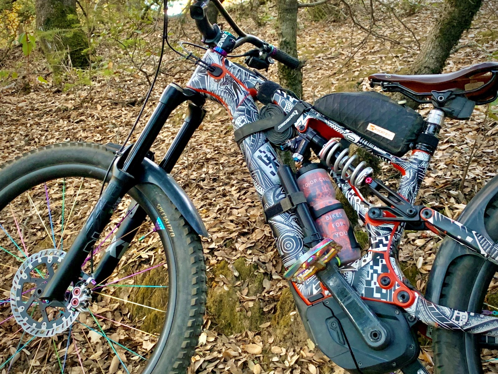

I’ve been running a CCDB coil Inline with a progressive spring in my Levo Comp...but that model shock is not a Levo/Stumpjumper version, so I have to run it upside down to clear the frame.
So now the strongest part of the coil shock is positioned where other’s coil shafts broke on their Levo’s.
I’m not sure if this will help prevent my shock’s shaft from breaking...I don’t really ride that much downhill, just wanted to try coil.

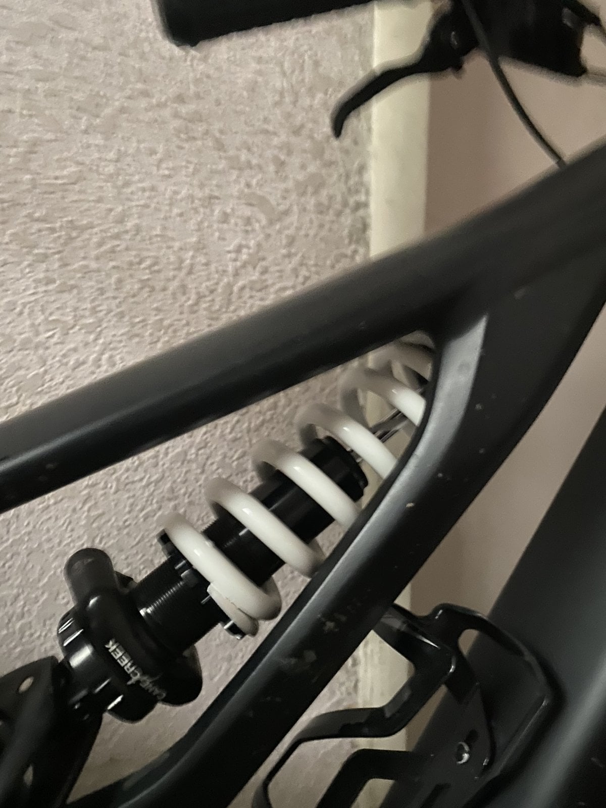

@Bigtuna00 your cane creek experience is interesting. My coil kitsuma which was recommended as suitable also moved the top bush and has play where the shaft enters the sealhead. Not leaking yet although it's only done about 7 rides.
I send the supplier a video and they claim the play is fine. I'm less convinced.
This is on a 20 kenevo.
I kind of regret not spending a bit more for the ext.

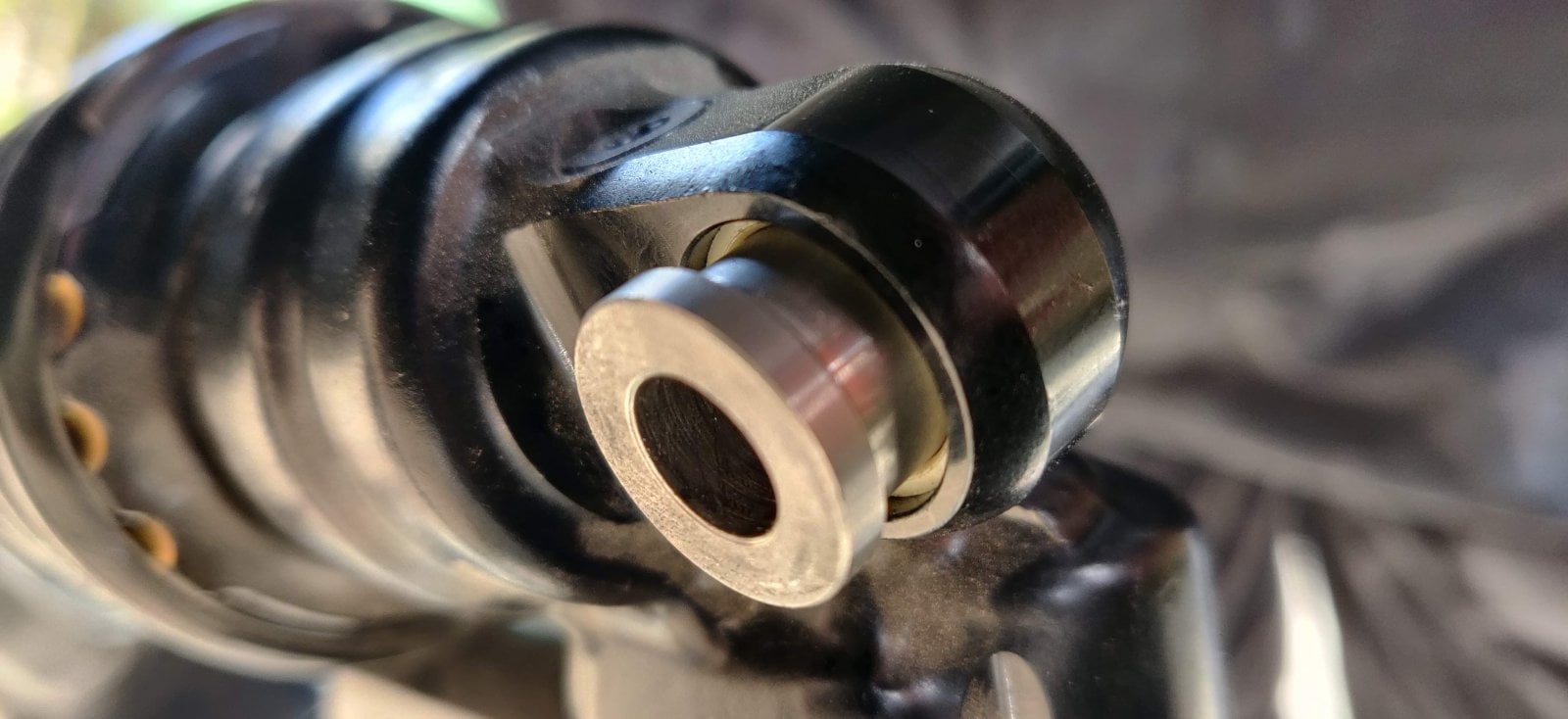

Play evident in the kitsuma after a handful of rides.
And the displaced upper bush
Based on this I would not recommend, even though the shock feels great.
The supplier claim the play is ok & the bush displacement could be due to frame misalignment... I kind of wish it would fail so I could get a refund.

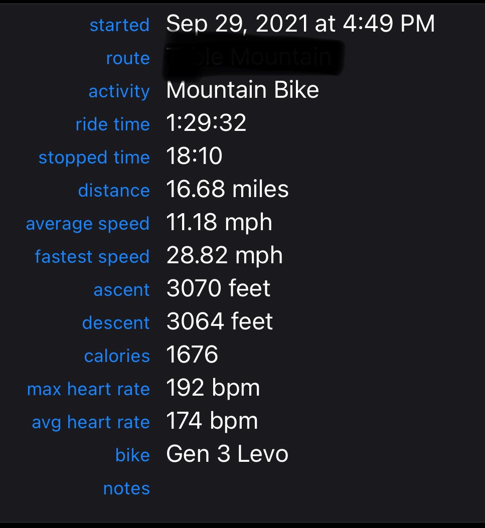

First ride last Wednesday and felt great. Brake bumps and rocks seem to disappear compared to my previous set up (38 and x2). Another rider following me noticed that I seemed to be faster. On a tight switchback, I just put my weight on the outside pedal, thrust the hips and rear tire followed and glued to the ground. First time I did that move without putting my foot out for support and without skidding. The rider commented that I did a "ninja move". Second ride, hopefully, tomorrow.
I am about 155 to 160 lbs with riding gears and the spring included is 500 lbs/in.
See attached. First time riding this intense - check my average and max heart rate.
