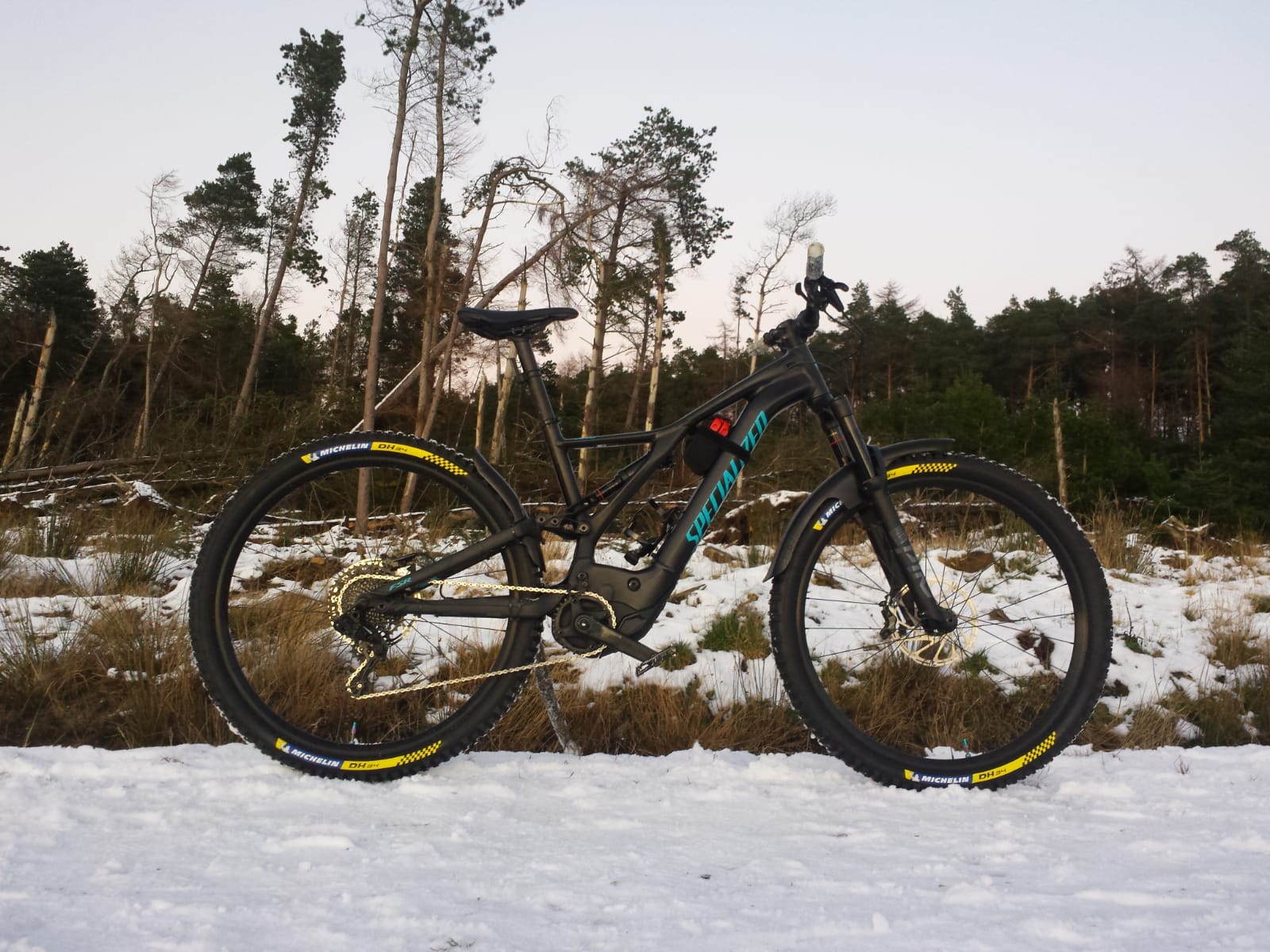

How are the DH22 and DH34 in Winter conditions? Would you recommend DH22 front, DH34 rear as a combo?
Your thoughts would be appreciated. Thanks.
If only michelin had thought to give details of intended conditions for each on their website, packaging and info blurb for online sellers ?
