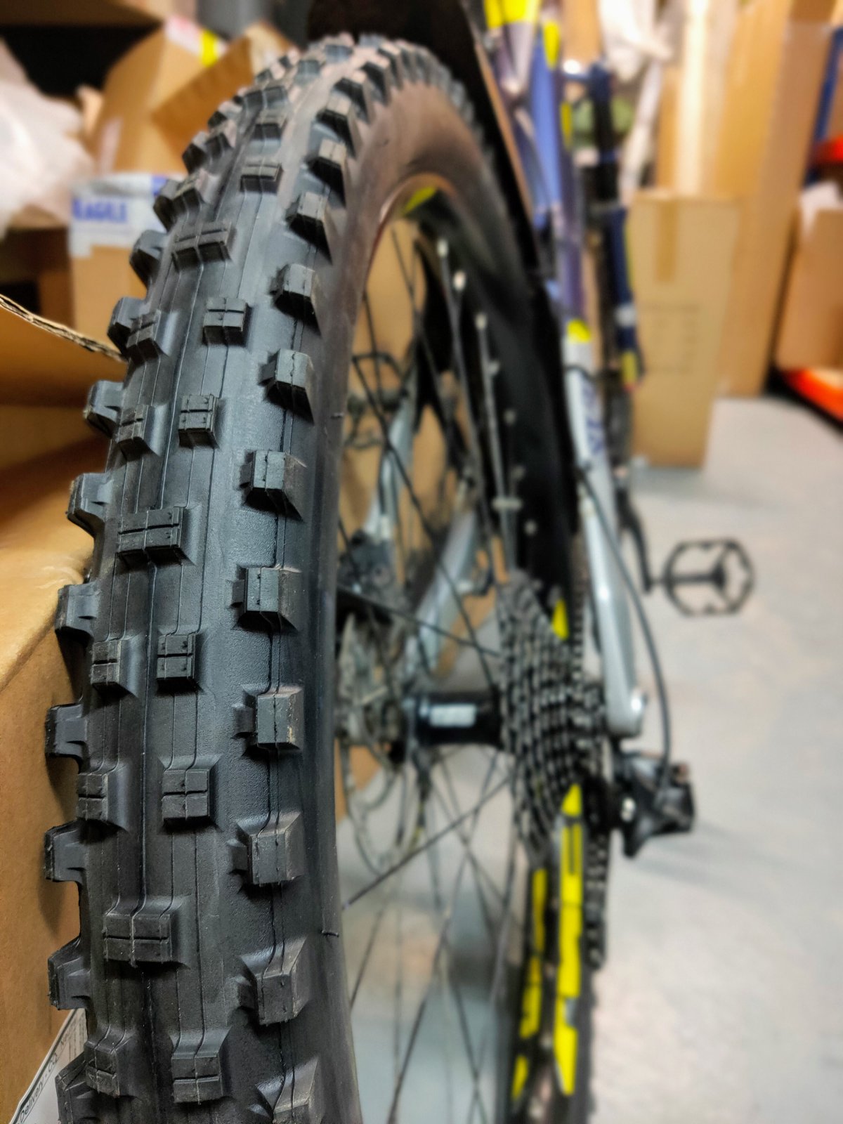

Front tire i mounted backward.
I heard this advice from forum member Tim29. He accidentally changed the tire orientation. And he find out that it have more grip.
I conclude that the physics behind it is the side of the knobs. Which is cutted to 45 degrees (which are intended for rolling resistance) now used for braking instead of the defoult side which is on 90 degrees.
When you aproach with 45 degrees knob on wett root you immediately have a full contact area.
And when you approach with a knob cut to 90 degrees. It is in contact with the corner of the knob and the root (small surface area). Which begins to merge / flex with the object.
And you have to press the corner of the knob a few mm to achieve the grip surface on the side which was already cut at the start to 45 degrees on the other side.
I tested the grip with the palm (or thumb) in one direction and then the other direction. And I definitely see that it has better grip when I go with my hand in the direction of the knob that is cut to 45 degrees.
I’ve also heard that tire has better grip when is slightly used. That is probably because of that sharp corner becomes rounder and it had the similar effect.
The original orientation is probably a better option for deep mud or loosed rocks. But now it’s winter and it’s wet. And the scariest driving conditions for me are wet rocks and roots.

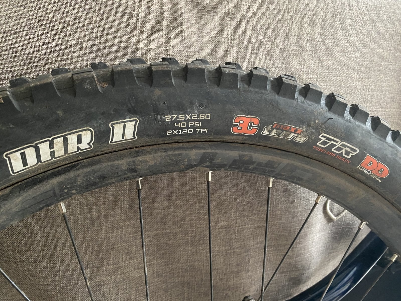

they do exist. Just not yet for sale. Here’s mine.
Interesting!!! Do you have any idea when they will hit the market ? 2.6 27.5 DHRII DD is perfect for the rear on an Ebike
No. It’s actually from a demo bike that I had to change out on the trail to a new DHR2 as I got a huge stick caught in it and the sealant wouldn’t seal. So I swapped that entire tyre on the demo to a new DHR2 . I chucked this one in my shed and was there for a while after the demo bike went back (o didn’t actually realise it was a DD). I since repaired it and put it back on.
hopefully it’ll be released soon.

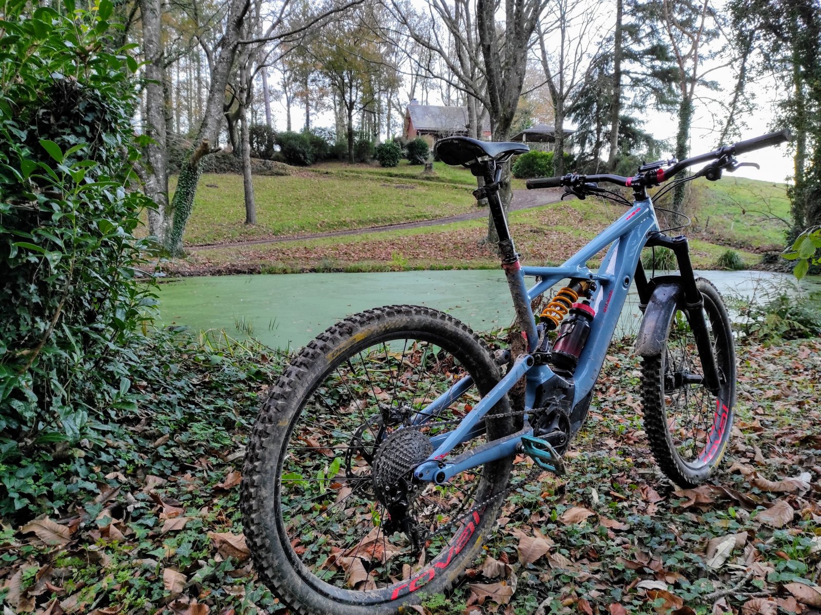

My OEM tyres were Assegai 27.5x2.6 3C Maxx Terra EXO+ on the rear and 29x2.6 in the front.
I wanted more grip on the rear, when wading through thick mud, so I bought 27.5x2.8 Hans Dampf EVO APX TLE.
Well, I have to admit that I have a better grip with Assegai in 2.6, so I shelved Hans Dampf for summer and gone back to Assegai, at least for the winter season.
