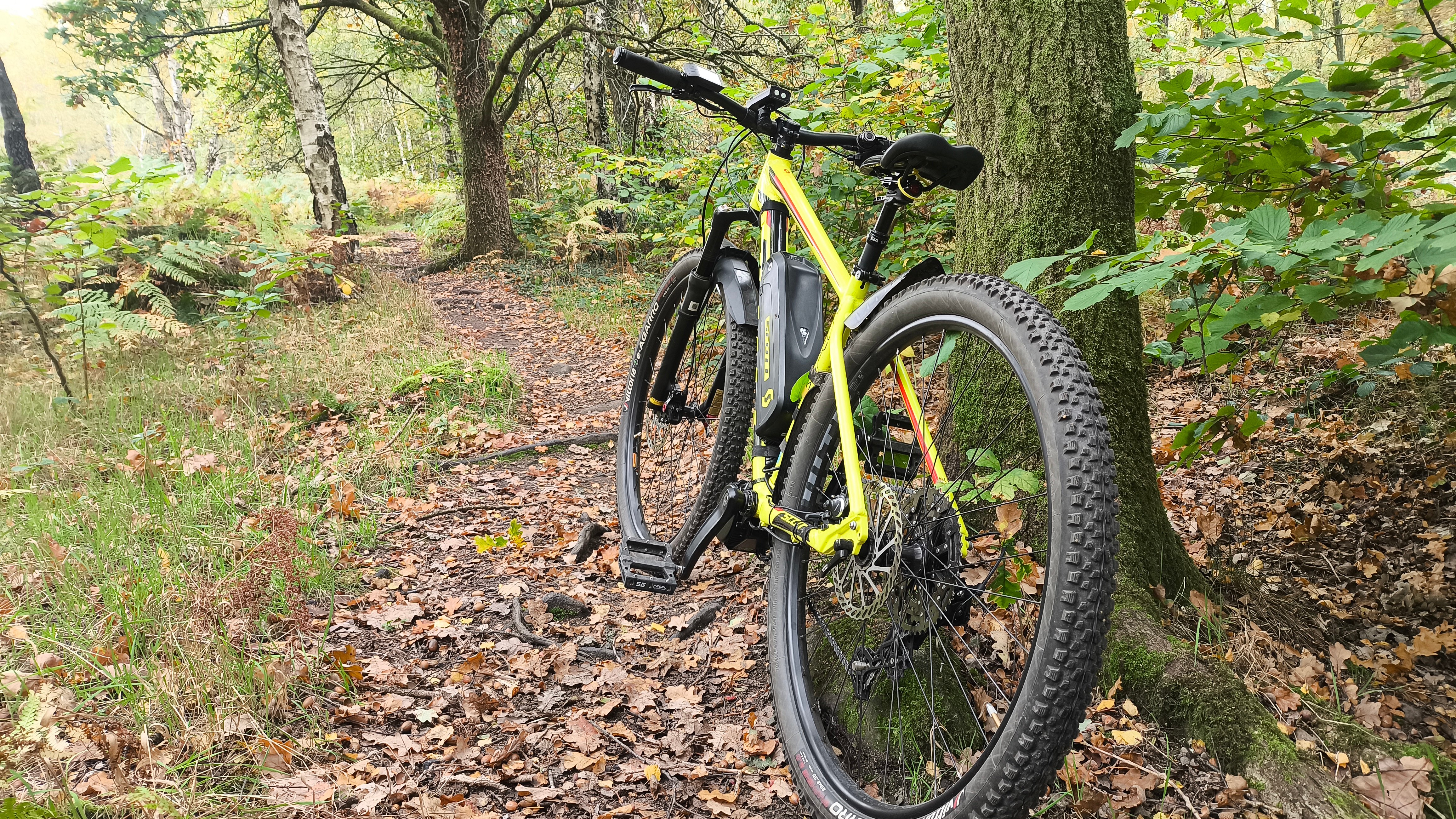

(^^not bad for a bike that covered 200 miles from new before Canyon's battery thing so had a year unridden & now on 250miles😧)

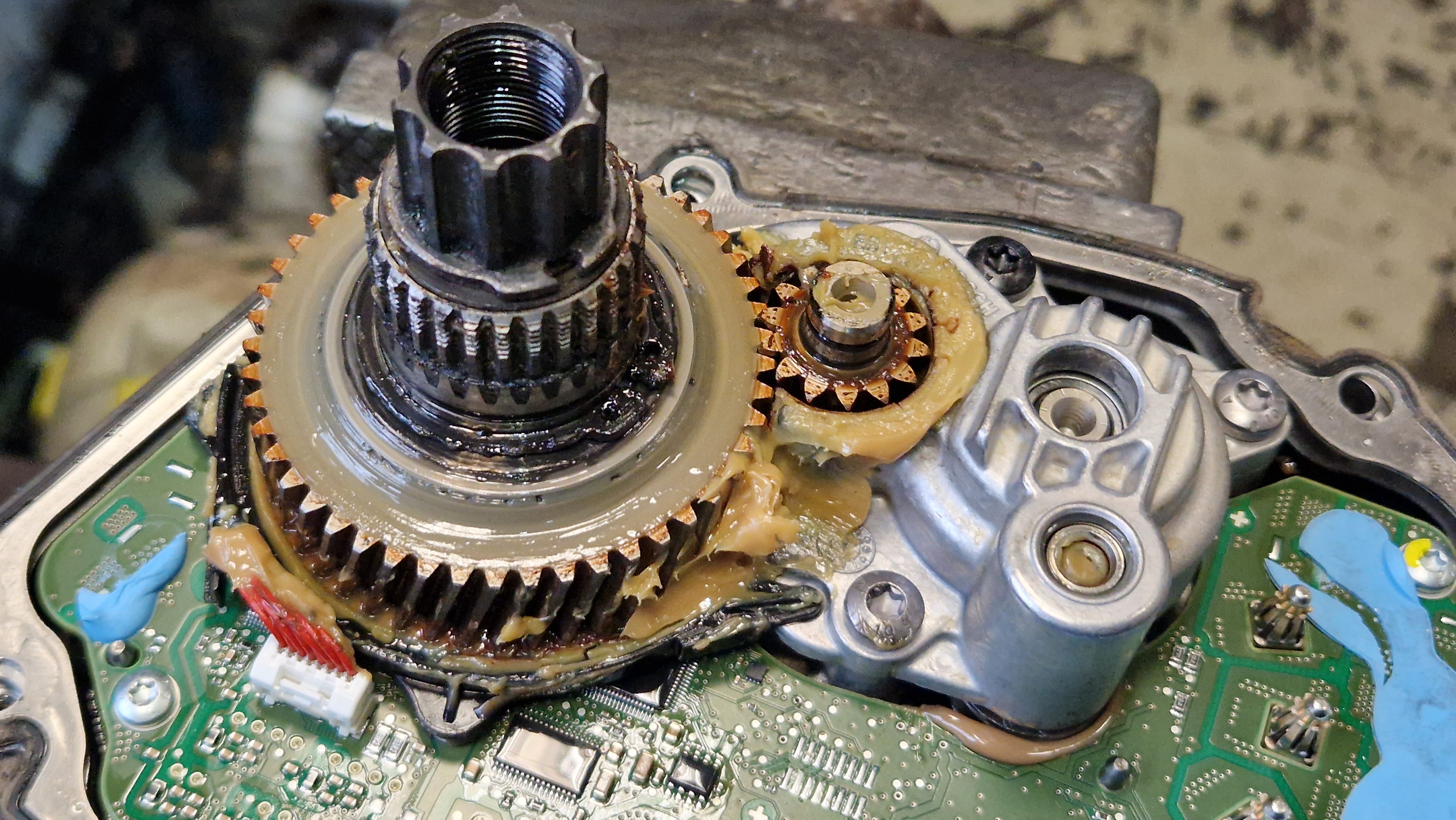

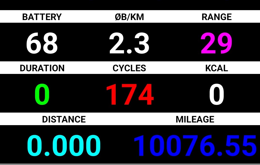

I hit 10 000km on my gen4 cx last week (in 1,5 year),it was getting bit noisier on the rough stuff, i decided to open it up, and re grease it. Looks like it got a little bit water ingress. Didn't took any picture afterwards, but I used a hefty amount Motorex white grease on the cogs, and the clunking noise is barely noticeable anymore. Also replaced the bearing protection rings.

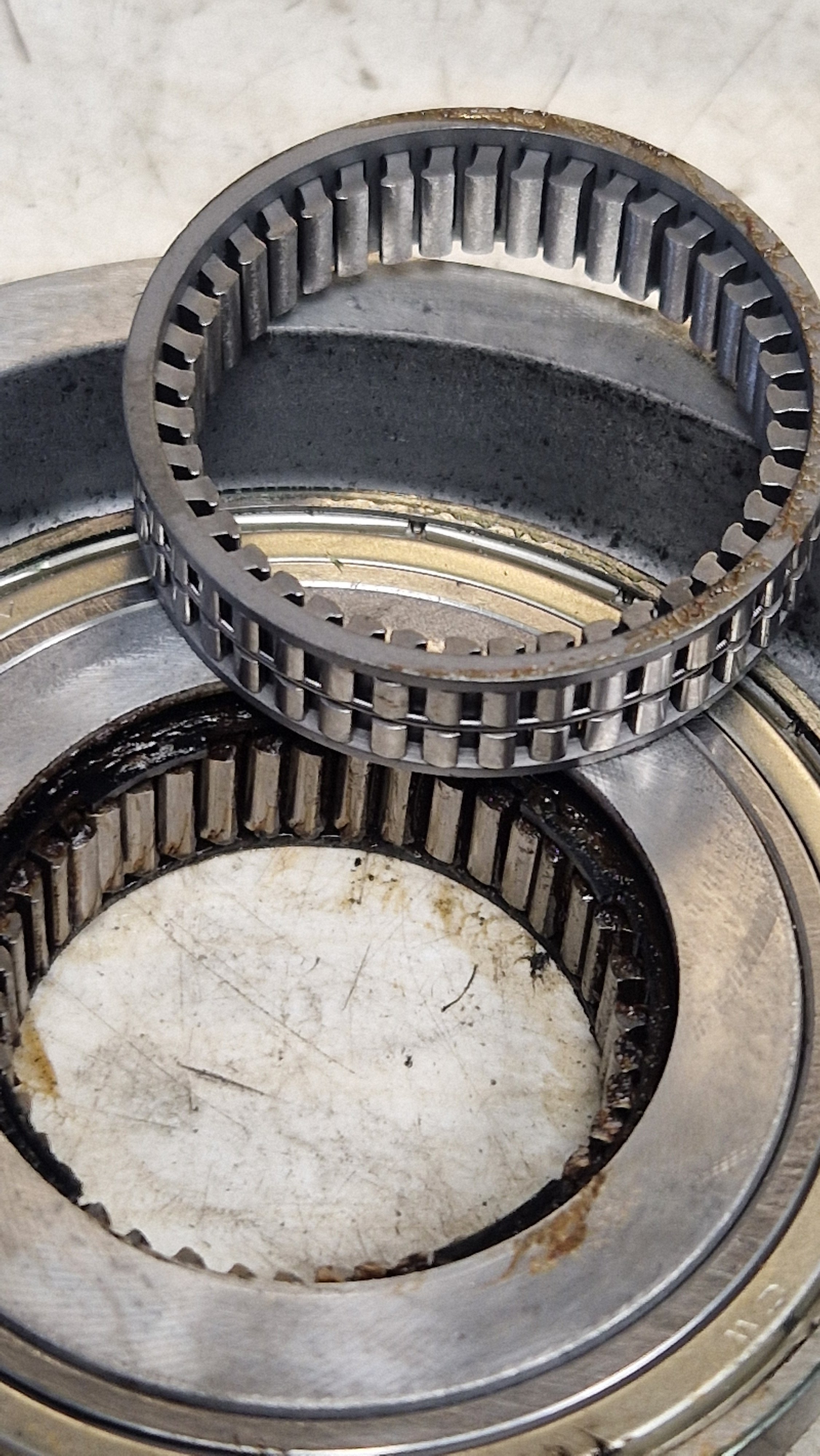

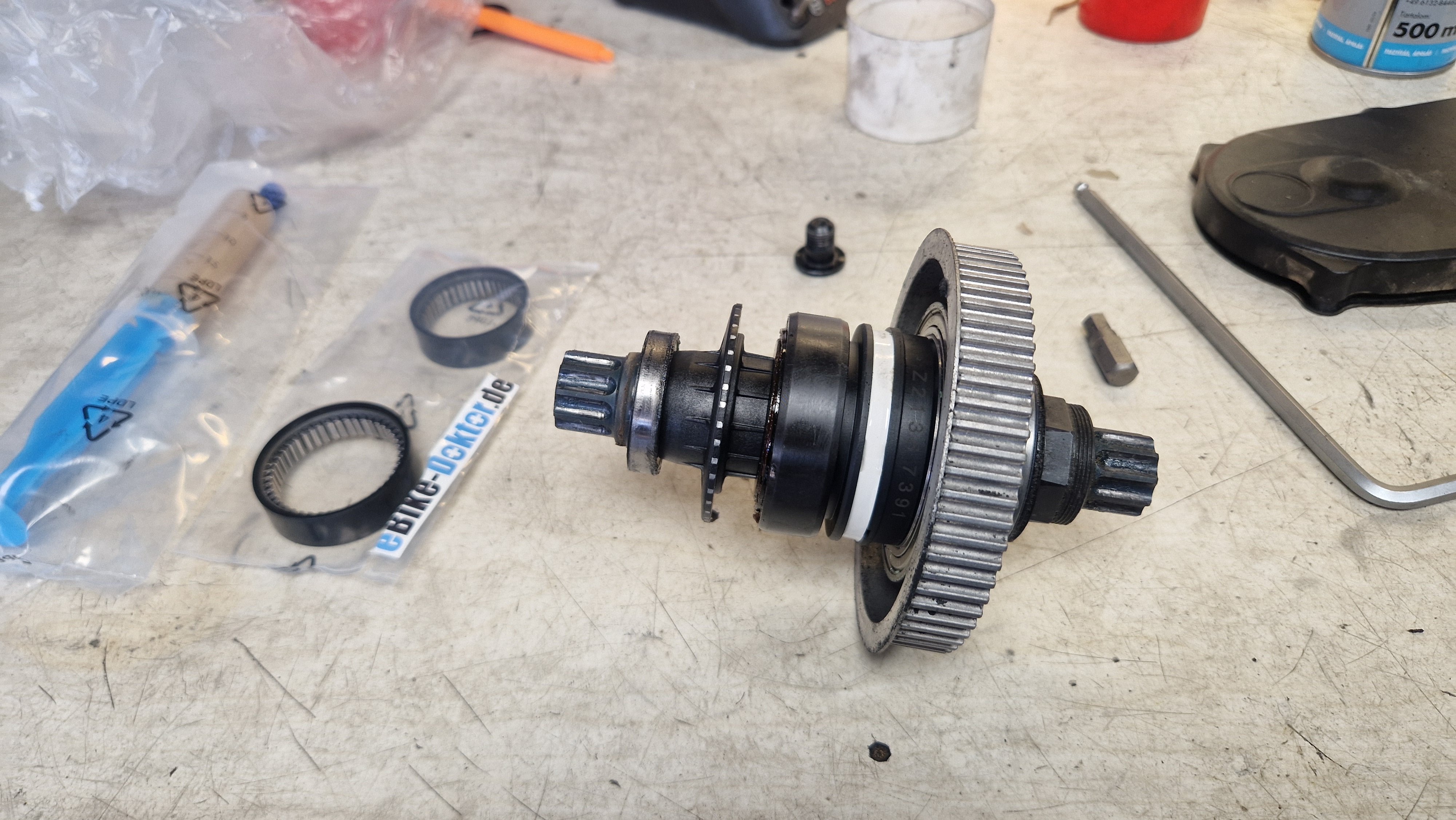

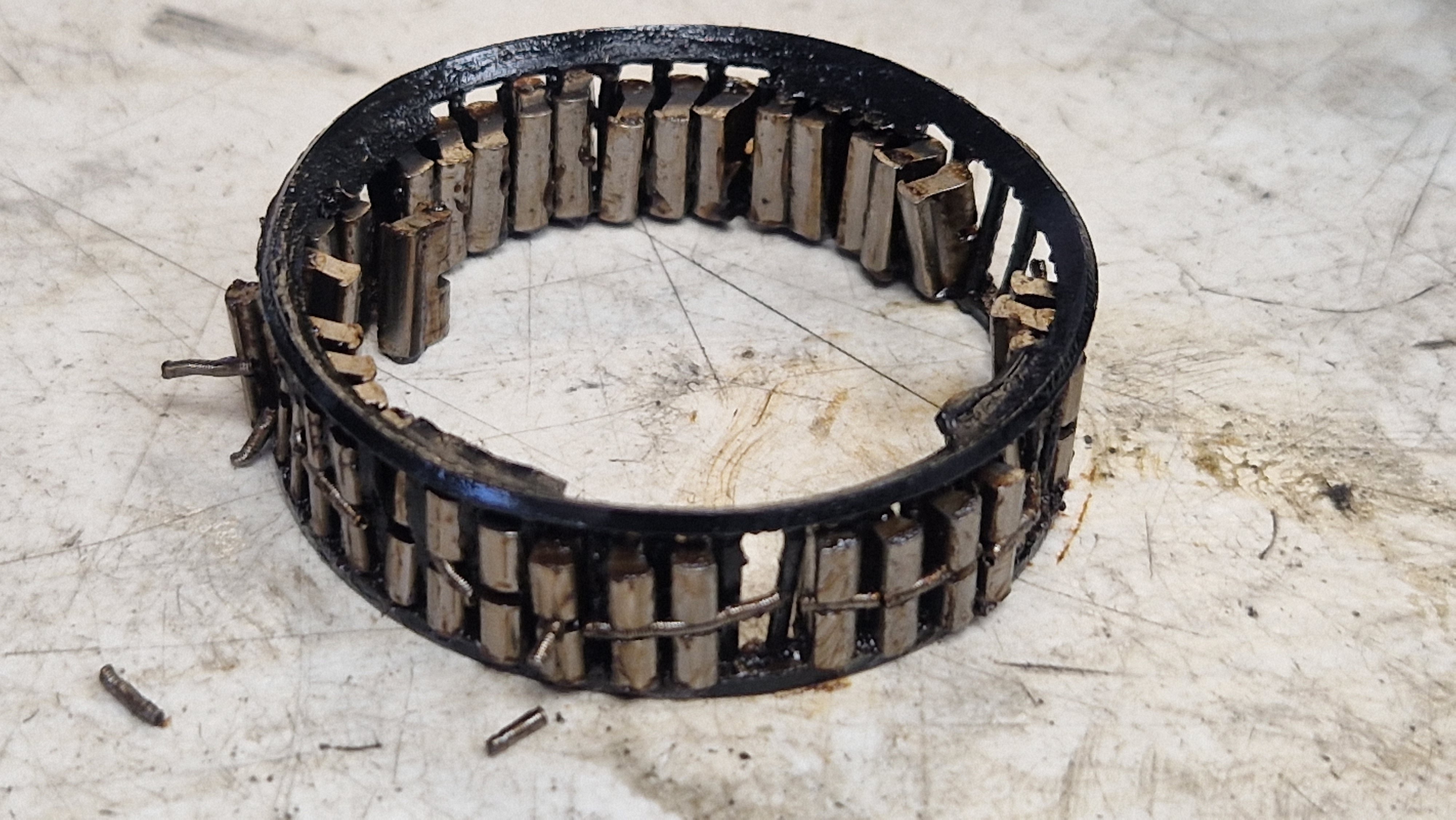

Since i bought the used Kenevo, i felt the overrun was inconsistent, and too long in Turbo mode, ordered new sprag bearings, and replaced them. It feels pretty normal now.

Damn! Nice job at that. My motor has developed some crank stickiness, probably from water ingress. I'm contemplating sending it for repairs or opening it up myself.

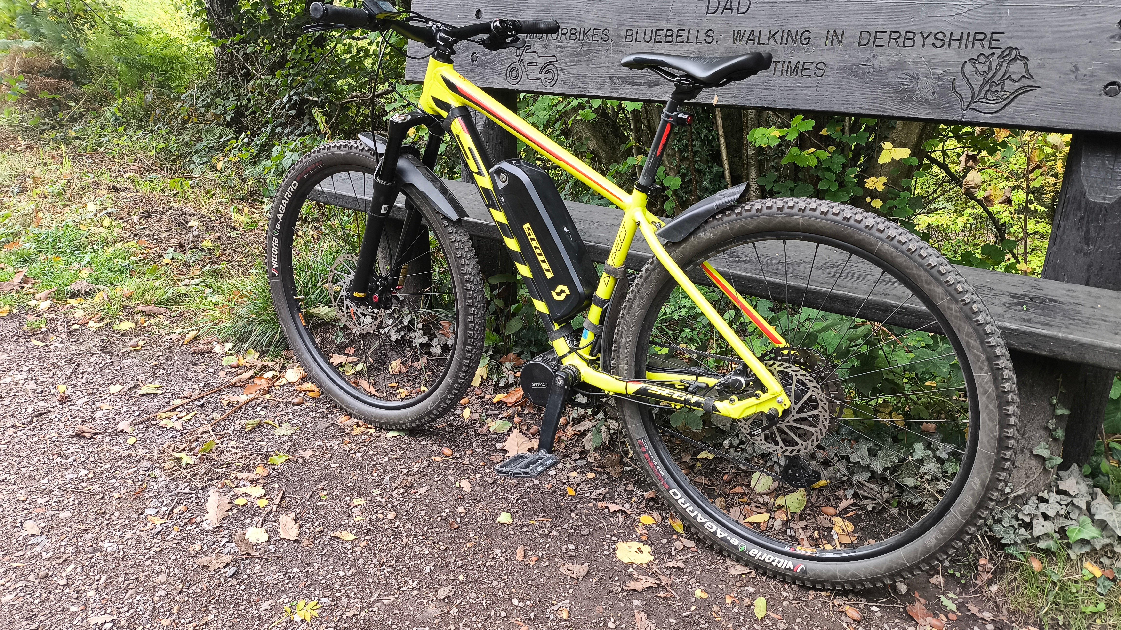

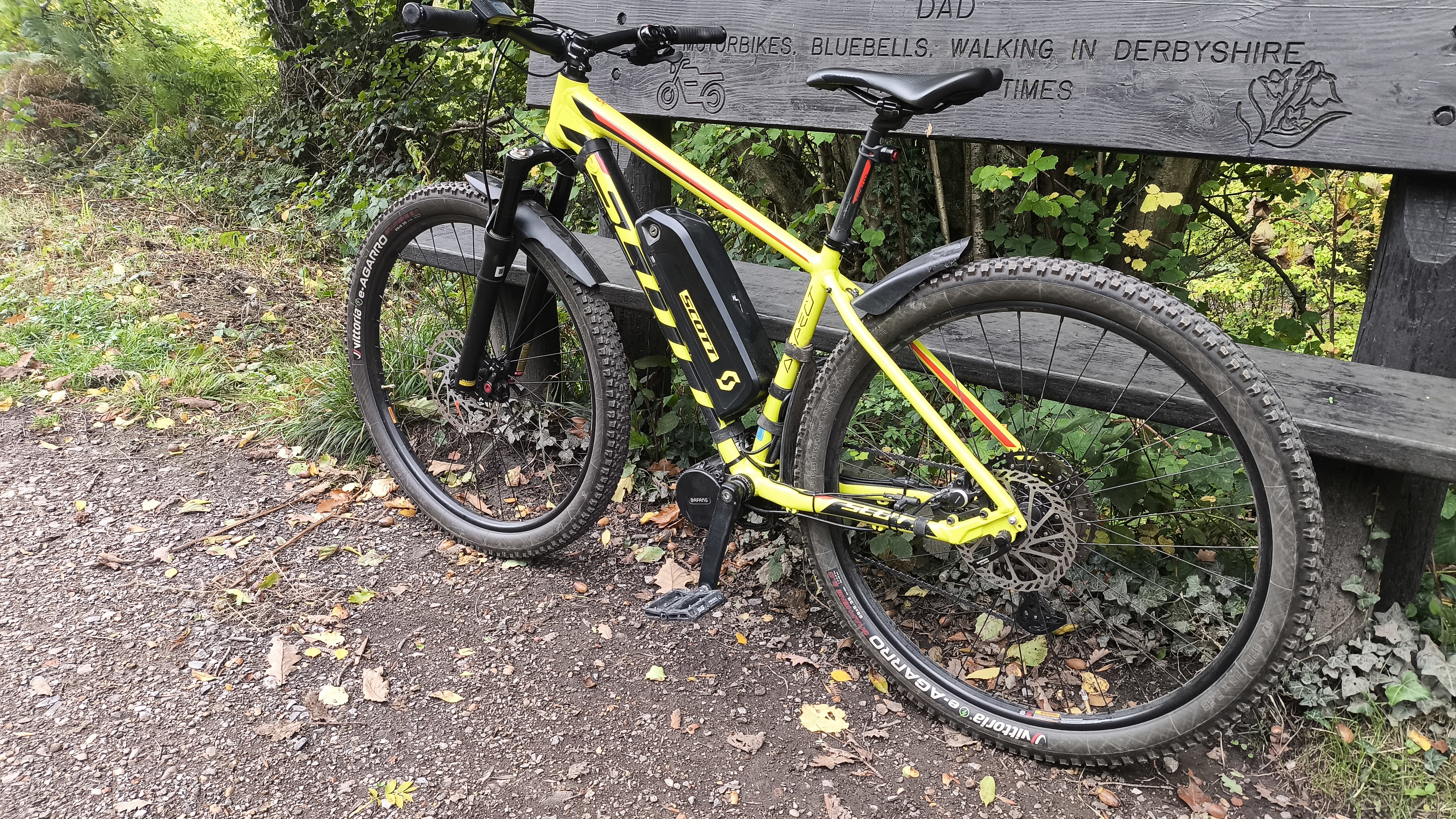

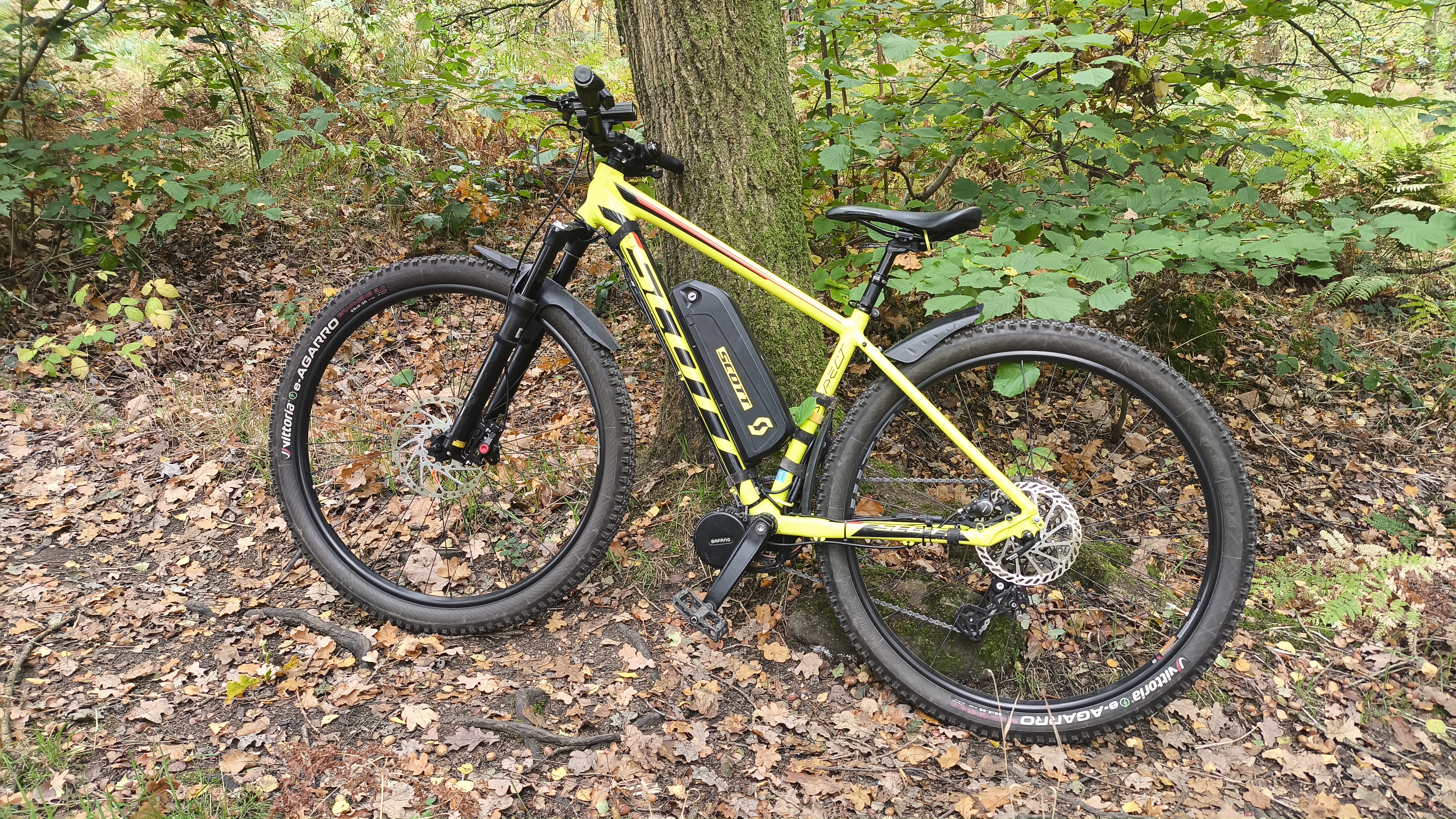

I put a 35mm stem on the Scott (bbs01b) aka The Wine Fetcher, and went out for a ride. I built it about 5 years ago and today wondered why on earth I hadn't changed from a 55mm to a smaller stem years ago 🤔. Made a change from riding the Cannondale and covers flattish ground quicker.

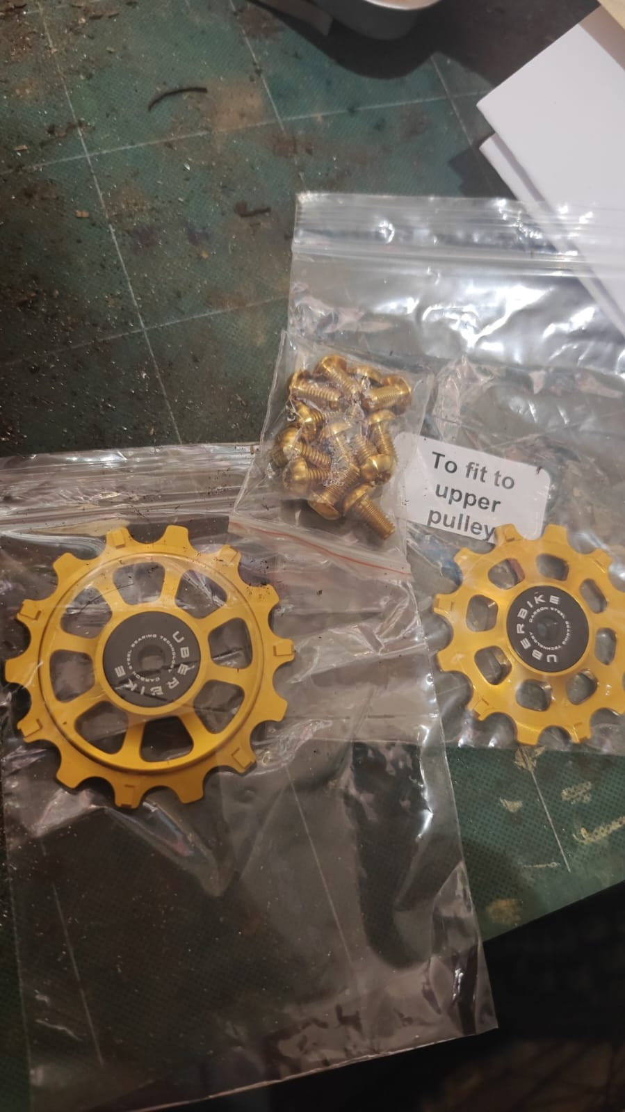

So last night:
  • I fitted the new jockey wheels.
  • Fitted the new TI brake rotor bolts
  • Serviced the PNW dropper.

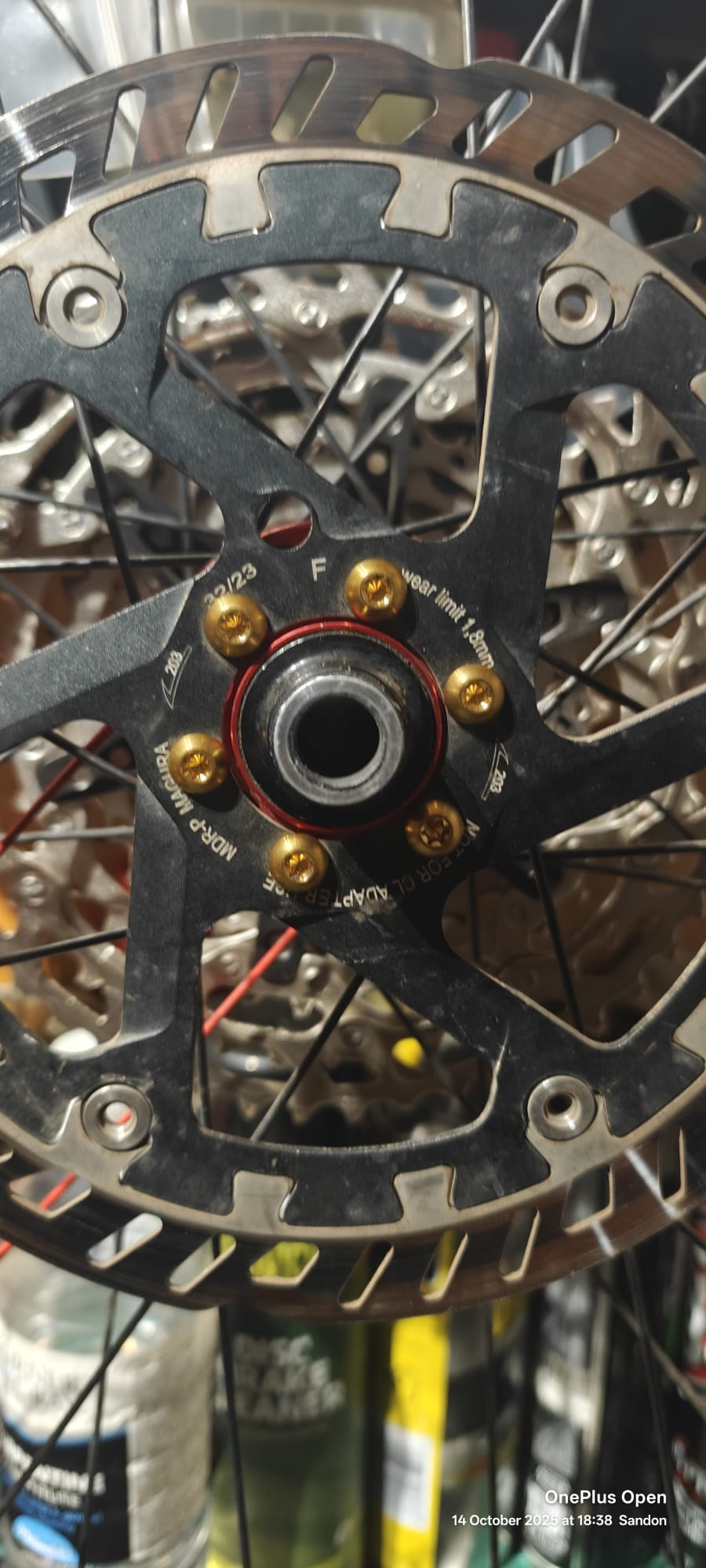

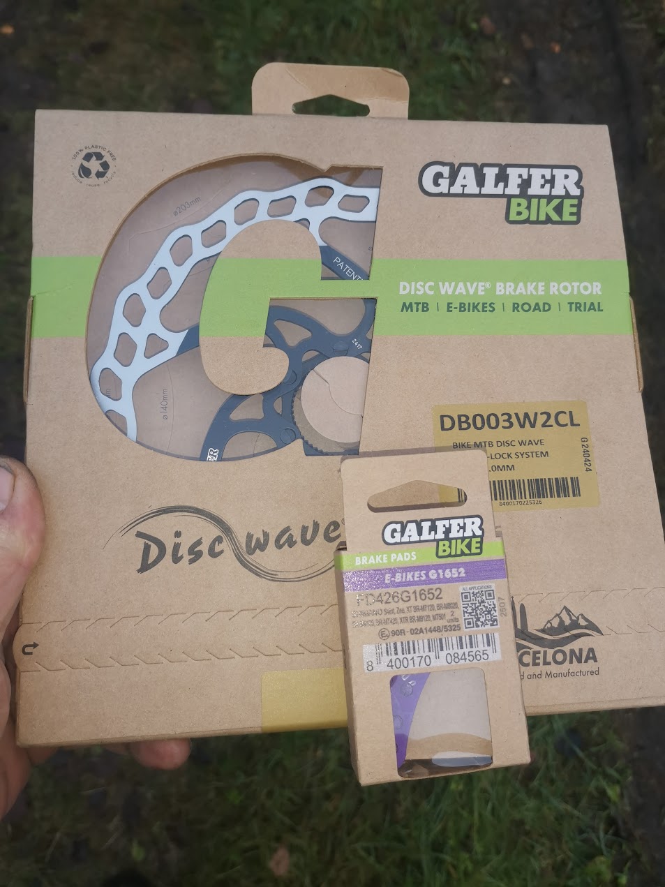

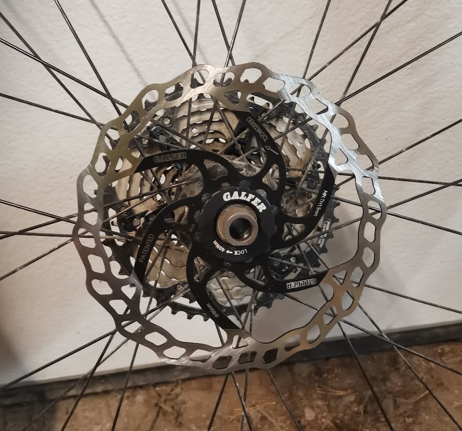

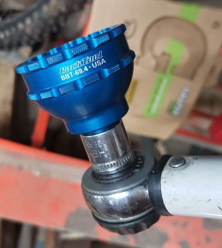

I also mounted a new rear Galfer brake disk using my new Park Tool centerlock socket. So far so good. Then, Galfer purple e-bike pads.
However, When pushing the pistons back in the caliper, one of the pistons got stuck. Then, a small leak appeared. I finally got the piston back in place and mounted the pads, but no joy.
At best, I have to bleed it. At worst, a new caliper is the solution. I'm off to my LBS today to buy Shimano mineral oil and a bleed kit and take it from there...

Also can any one tell how straight Uberbike rotors are? I’m pretty sure my Galfers had never actually been really straight since I’ve had them.
