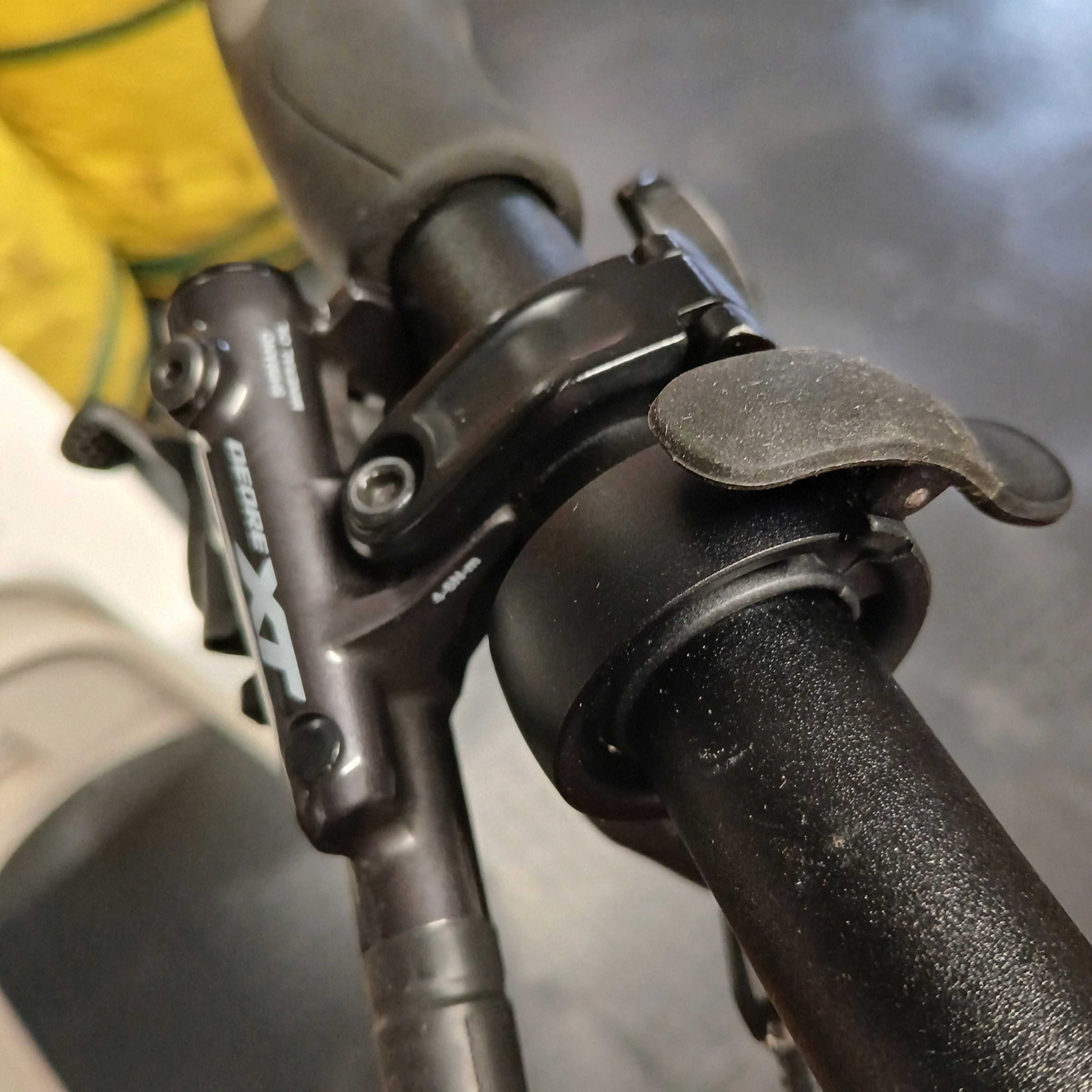

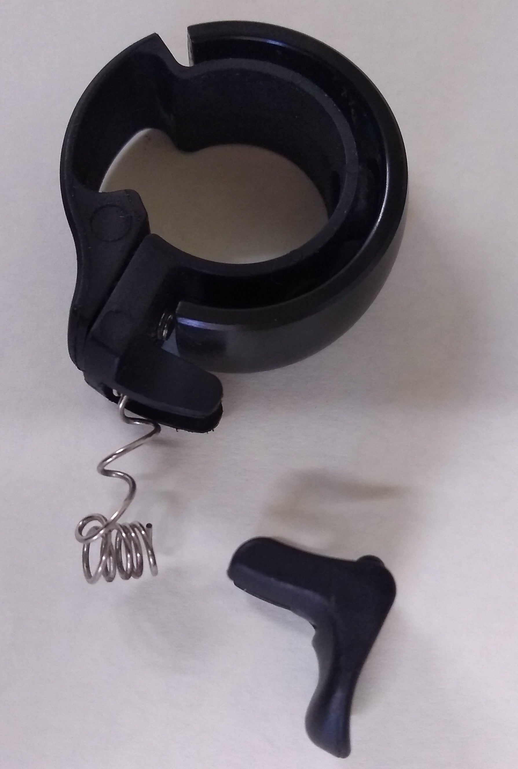

I fitted the new Knog Oi Prima bell. (1st pic) They claim to have fixed the previous problem, that the previous coil spring design just didn't work. (2nd pic)
The tone is lovely; clear, penetrating and sustained.
I got my first feedback from a walker on Sunday. He didn't leap out of the way or act in any way startled, he just glanced, moved over and said "nice bell" as I passed. There was nothing for him to see, so it must have been the tone he was reacting to. :)

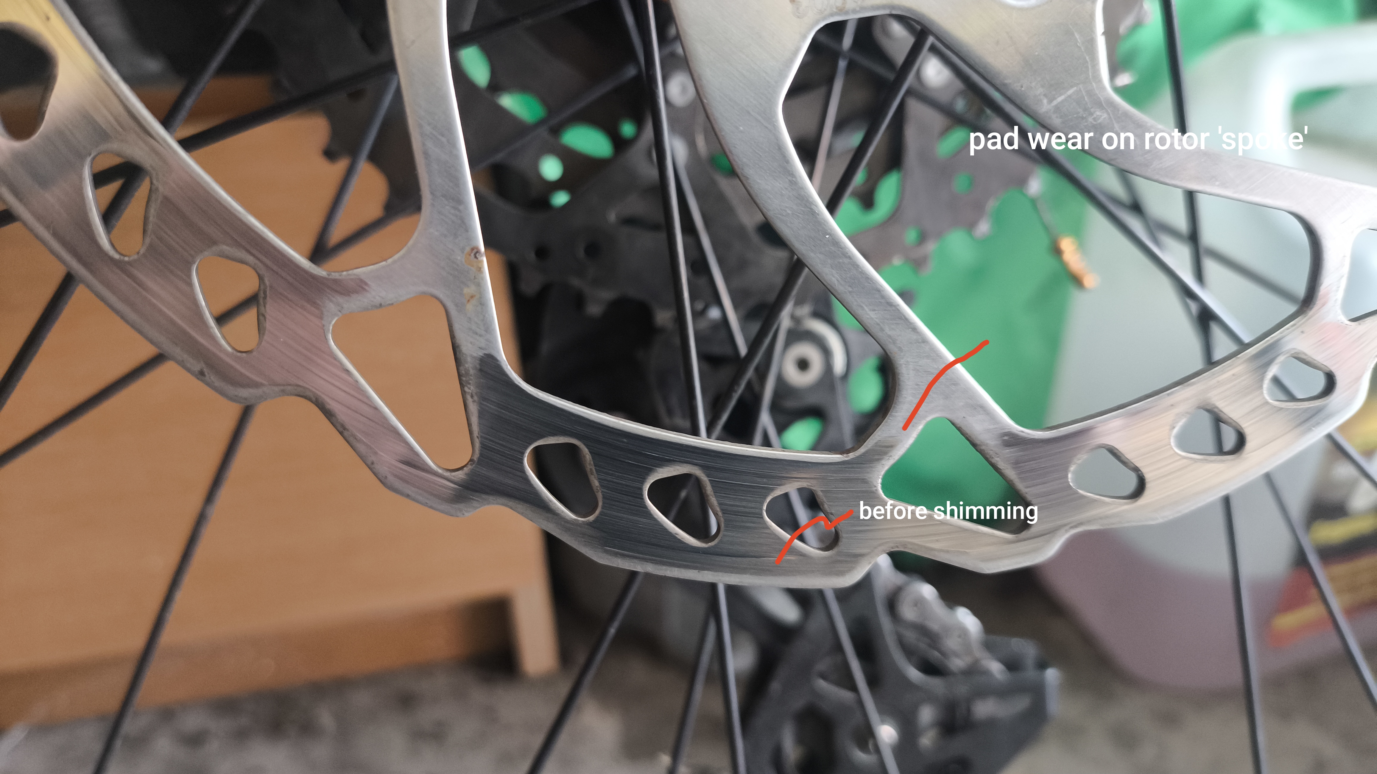

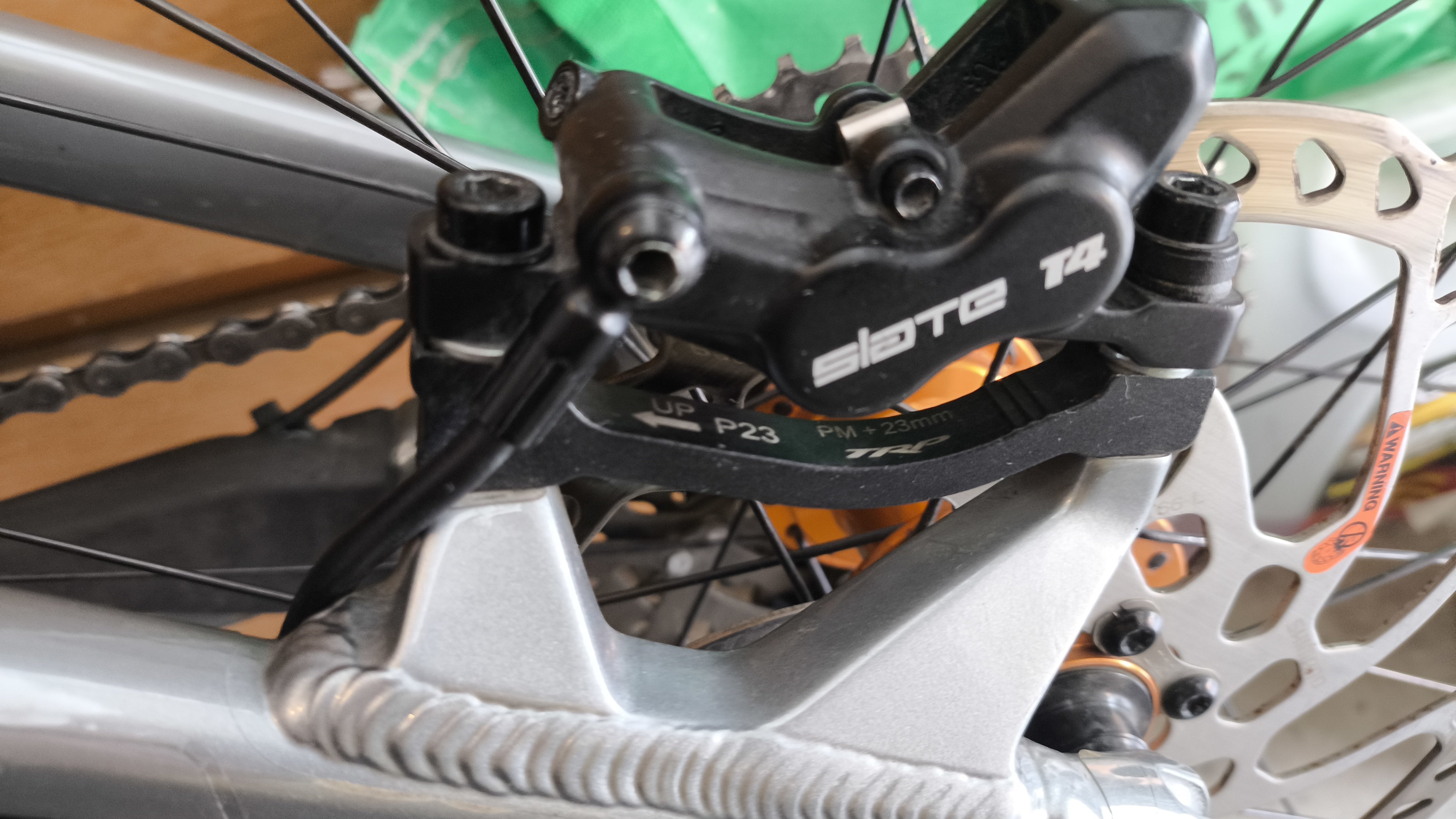

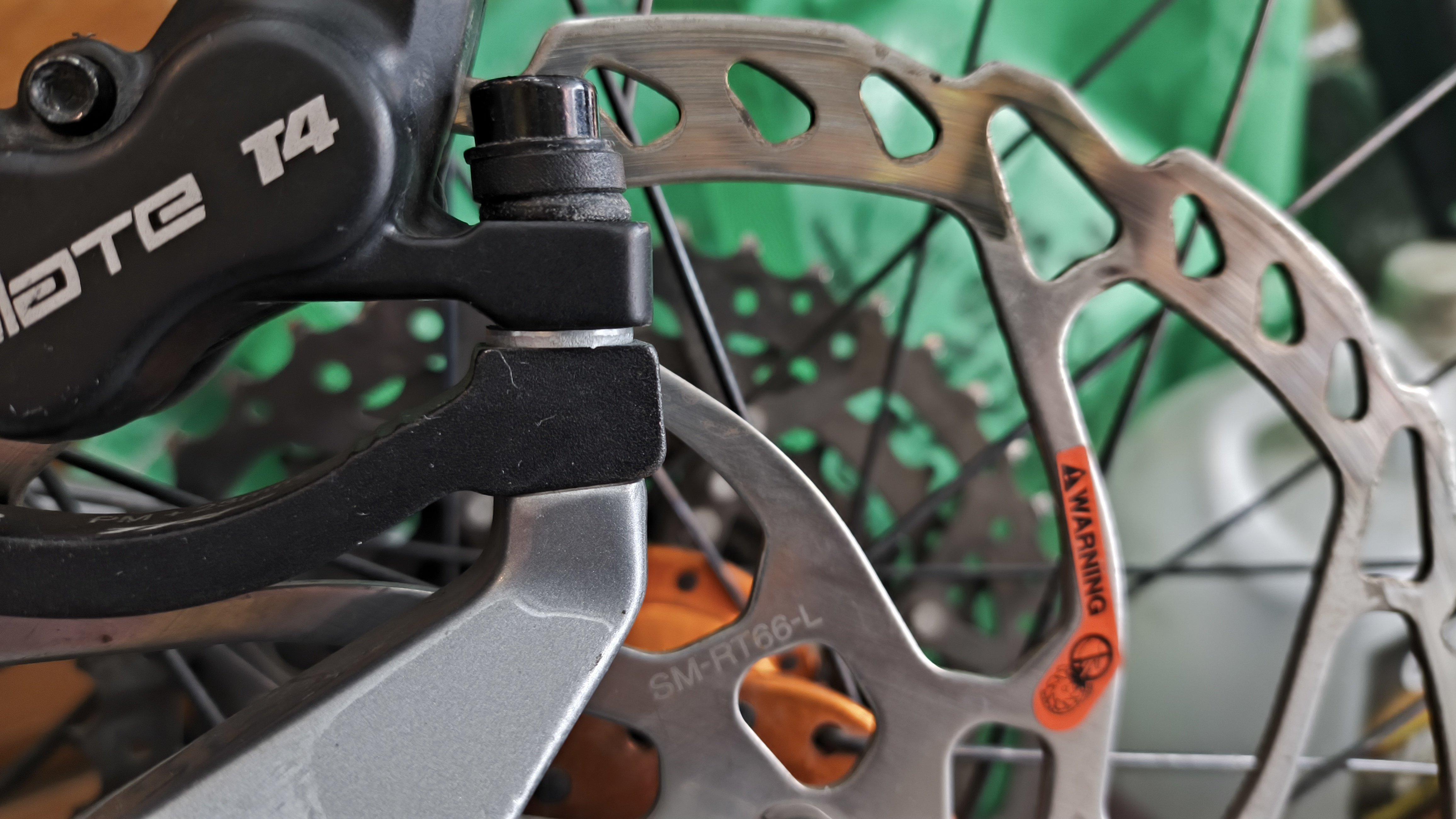

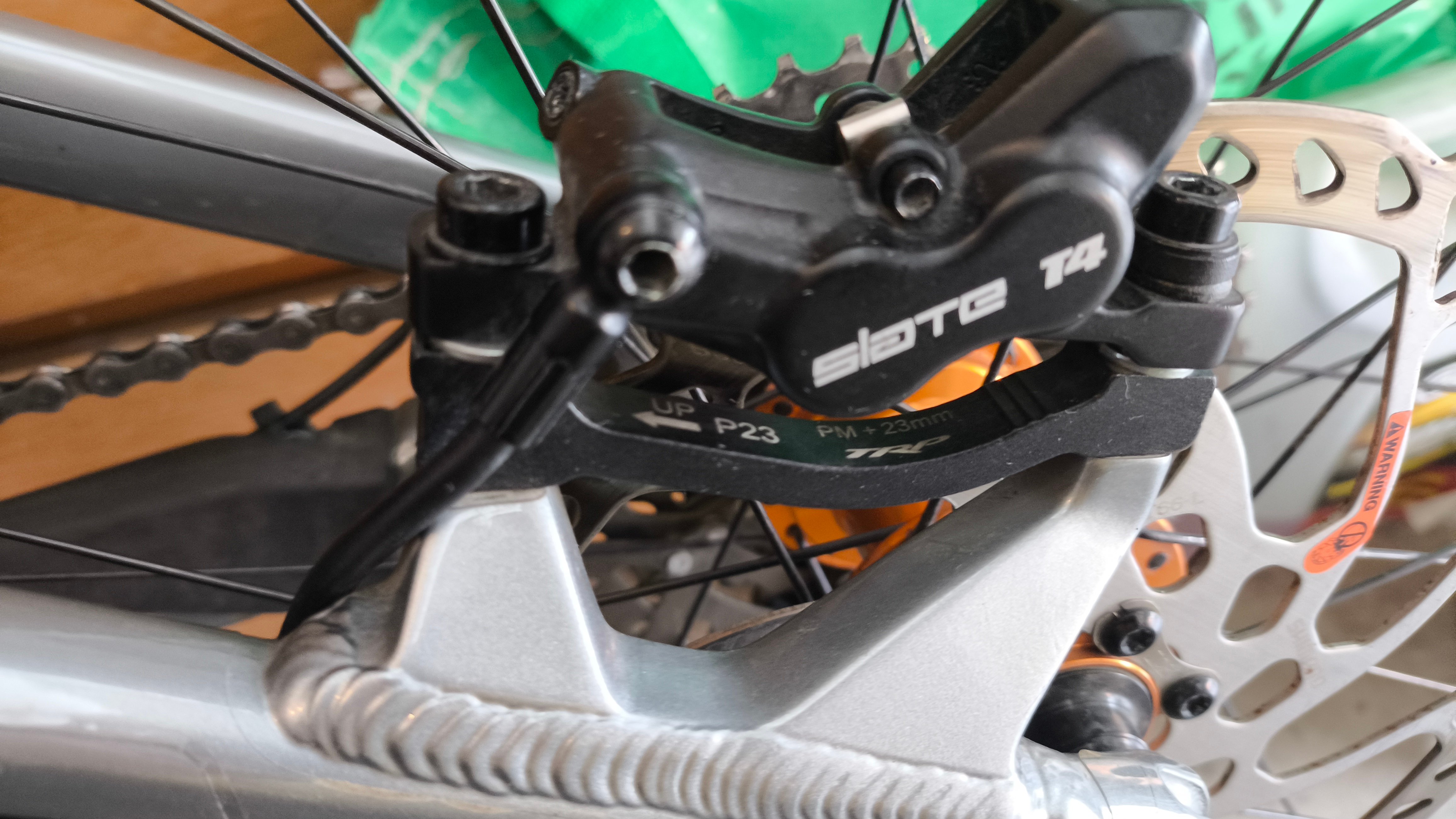

Looking at my bike today (was out on it yesterday) I noticed my rear brake rotor was wearing strangely. By strangely I mean the rear brake pad sweep on the disk wasn't a mil or mil and and a half from the edge but a good 3mm (1/8") down from the perimeter. And the rotor 'spokes' had a corresponding 3mm (approx) wear mark on them below the pad sweep area.
Hmmm, it's a 203mm disk, plus 23mm TRP adapter on rear 180 post mounts with TRP brakes on 6 bolt Shimano 203mm disks. Something isn't right, a quick calculation said I'm losing about 15% rear braking capacity as the lower part of the pads is squeezing fresh air until it hits a spoke. So I've shimmed the caliper up 1.5mm (thickest flat M6 washers I had) and noticeable improvement, bar the squealing. Yes I probably need a new rear rotor, no biggy, but what the hell, the only thing I can think of is the post mounts are short from the factory, everything else measures up . A few pics

Kind of a standard thing that, I think all my bikes are running a 1.5mm washer between adapters.
Can honestly say I've never seen it before and the front post mounts with the same TRP plus 23mm adapters are perfect. Is it a rear brake caliper thing? Anyway I've ordered a new rear disk.
if a mount is for 160/180/200mm and adding a 20/40mm adapter but using a 203 rotor you need a 1.5mm spacer.

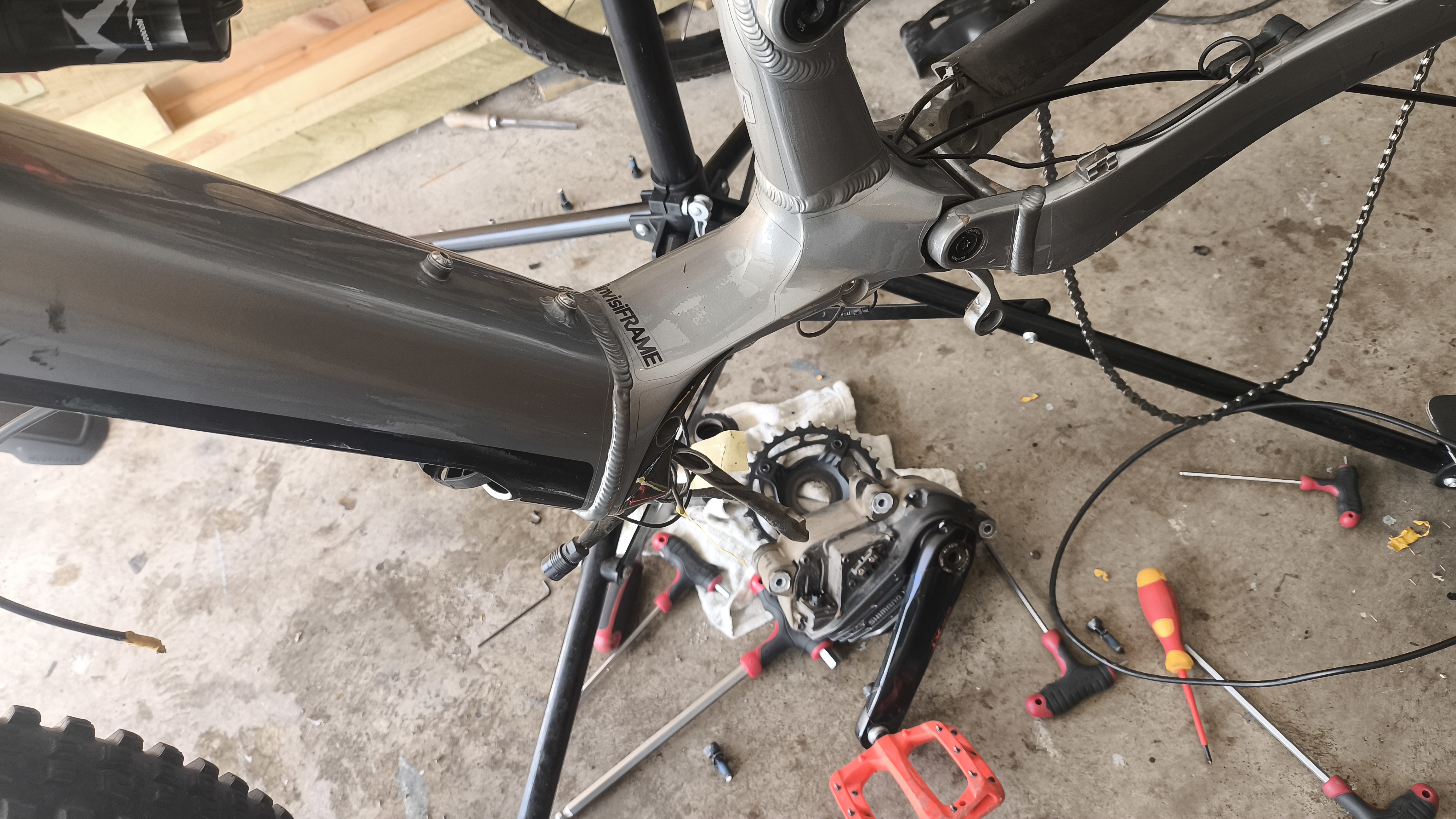

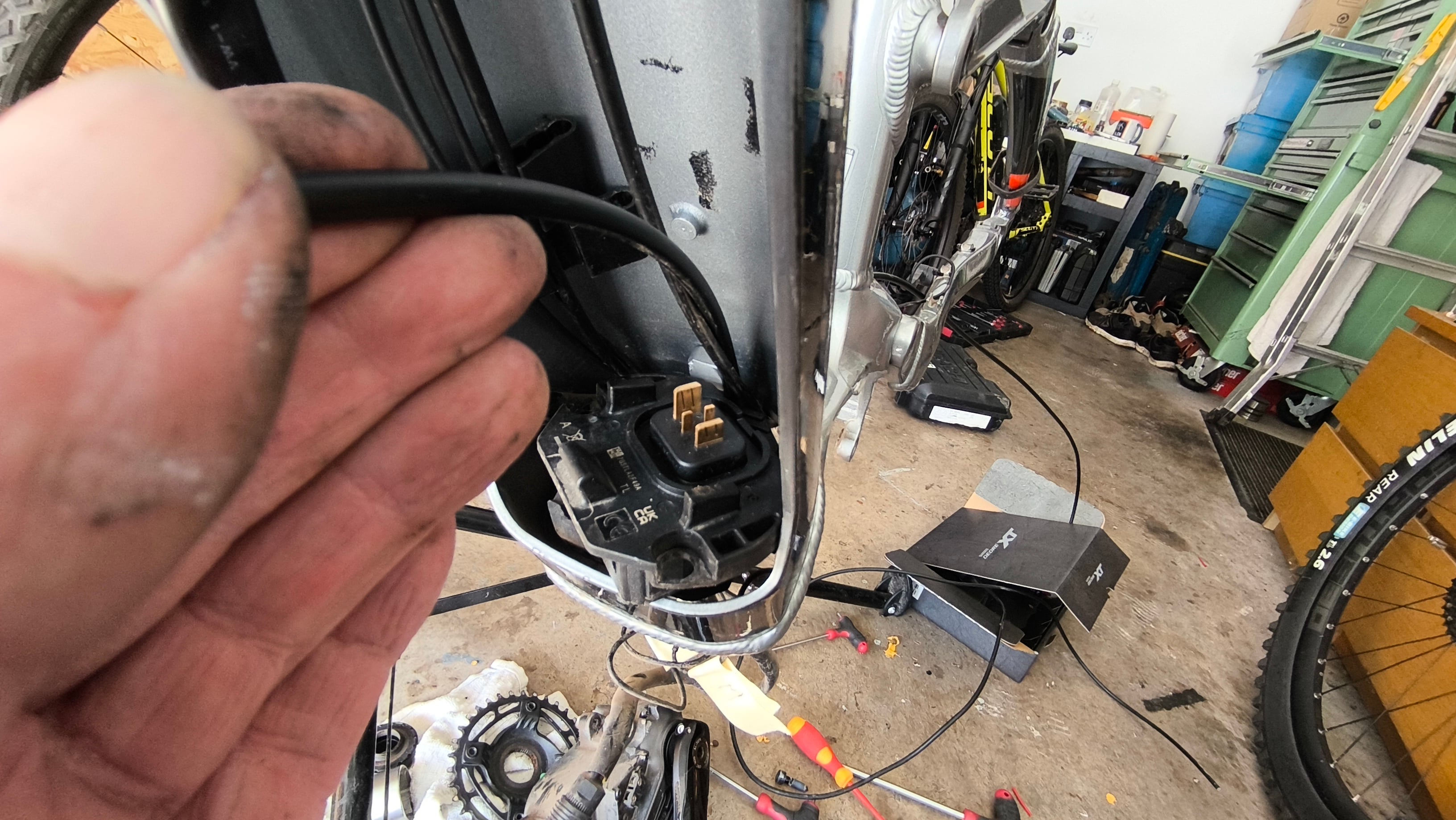

Serviced the lower legs and fitted XT 4 pots to replace the TRP T4's. Had to drop the motor to get the rear brake hose in as it wouldn't get past the sharp bend at the bottom of the down tube battery space (thank god my bikes a front removal battery) easy enough now I know how to do it. Didn't expect it take 9 hours though.l, but I was giving everything a good clean as I dismantled everything. By the way anyone who has a an EP8 and I presume an EP801 the non drive side terminal cover is an absolute BITCH to align when replacing, I think a good hour or more of the 9 hours was just trying to get all three tiny screws to align.

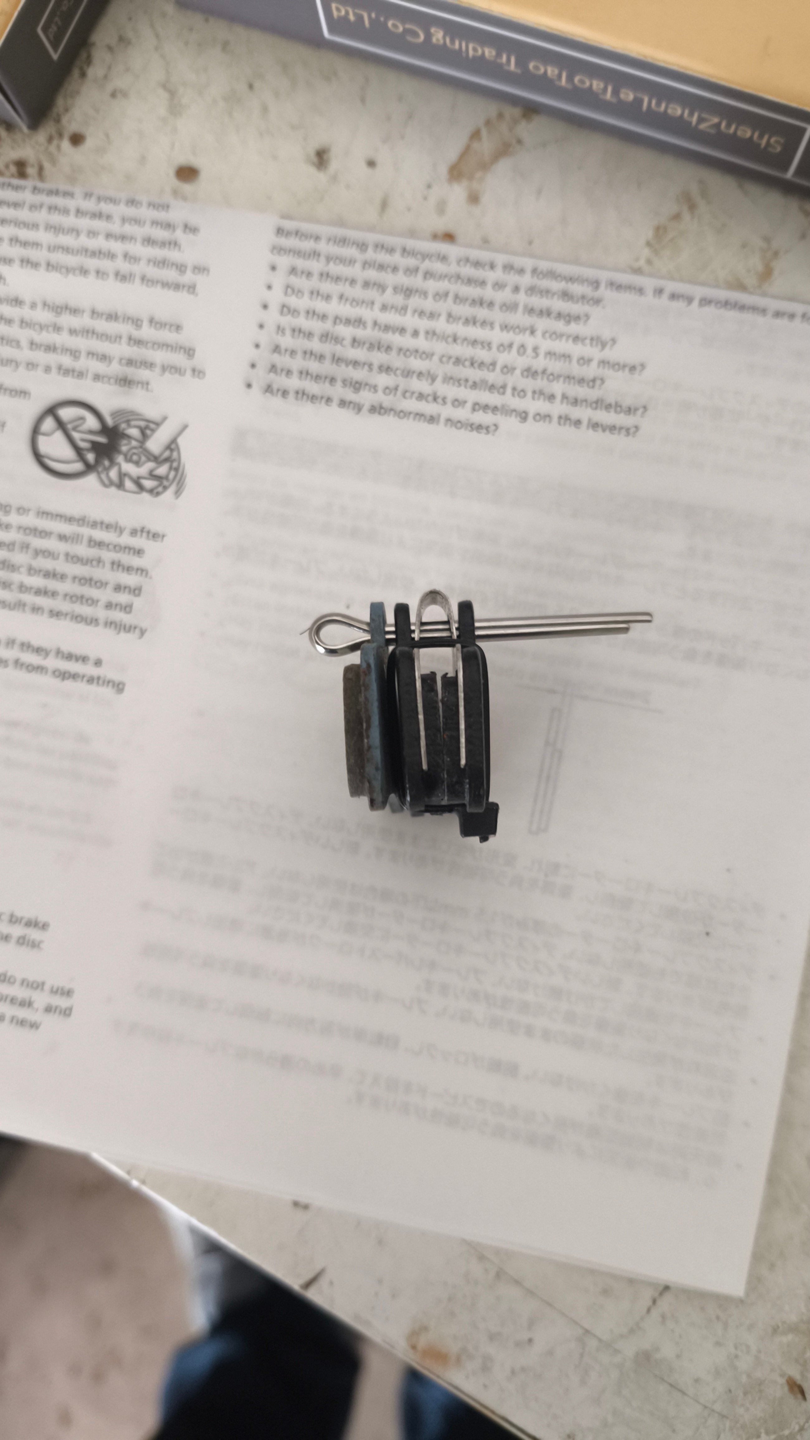

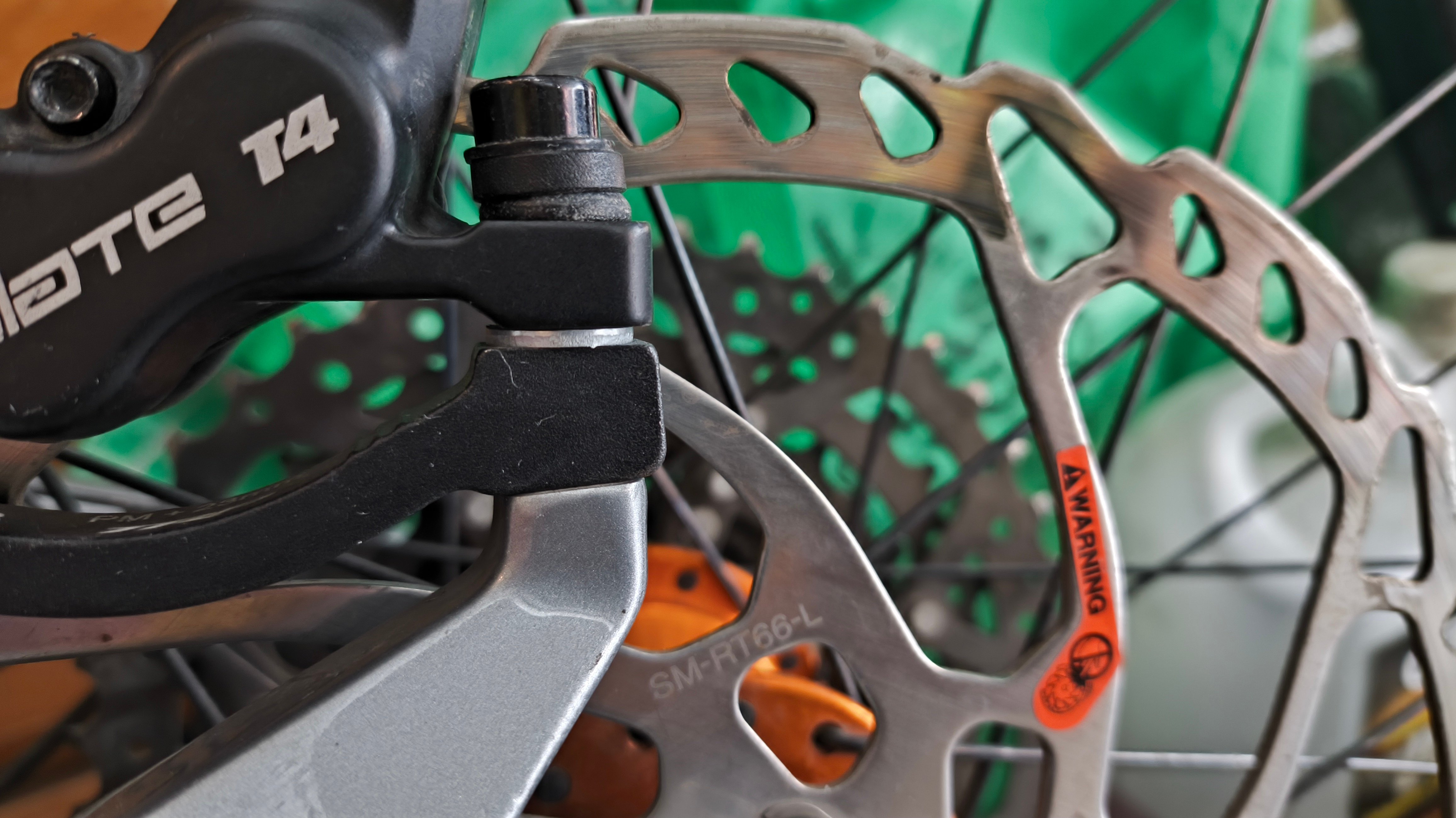

Found the problem with the uneven rotor wear which I posted a few comments above. The aftermarket pads have the braking compound (semi metallic) placed on the backing pad about 2mm lower than a genuine pad. Which is a pity as the Sommet pads are great otherwise, and I have 3 more brand new pairs.
Anyway if you look in the picture you'll see a genuine pad on the left (TRP Blue) and a pair of the Sommets on the right, all aligned through the hole with the pad compound further down the pad. So if buying aftermarket pads, it may be worth checking that the braking compound lines up with the original set before you knacker your rotors.
