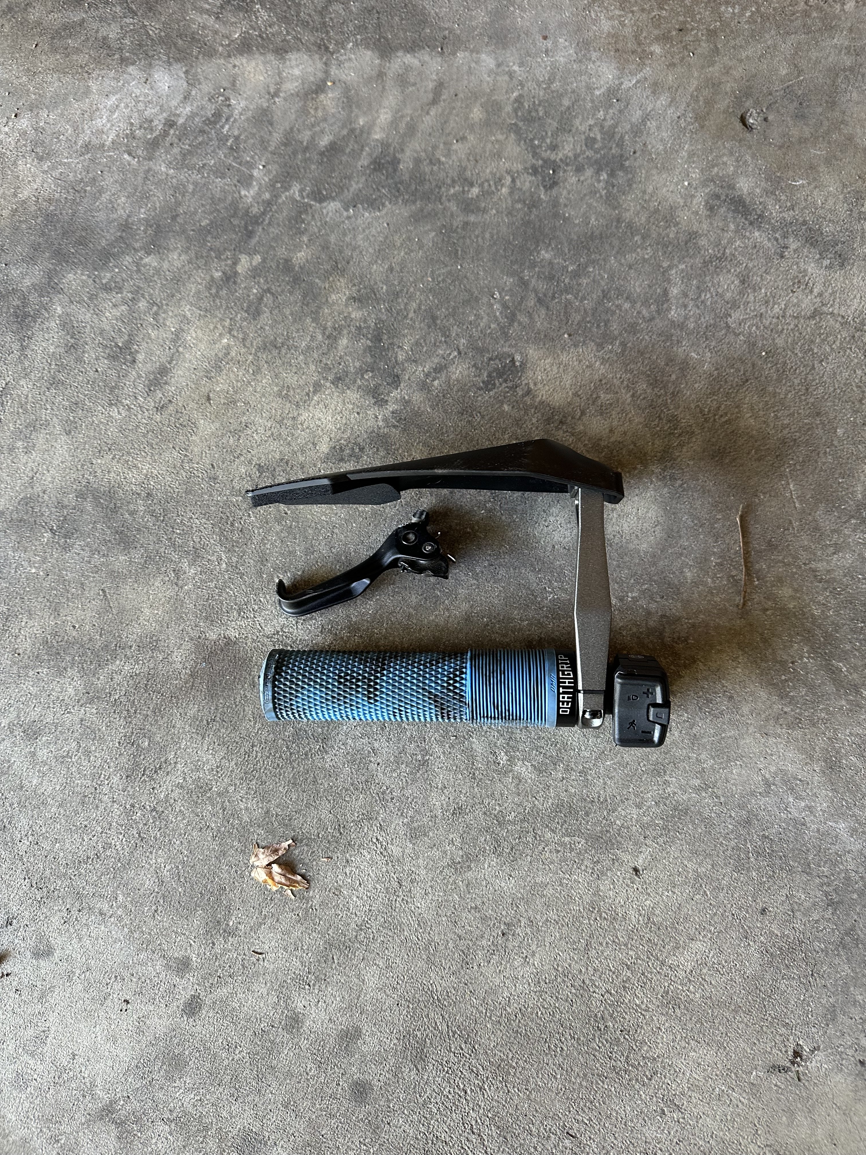

The lever felt great in the LBS. Felt great when I set off on my next ride. By the end of the ride, the travel adjust was back at the extreme, my 2nd finger was getting trapped, and this time, pumping the lever made it firmer (ie air in the system). What the hell is it? :unsure:
Left message with the LBS (they tend to use the answerphone on Mondays to crack on with work). I will keep updating.
Looking on the bright side, that means that I don't have a scrap lever assembly after all! :ROFLMAO:
I'd have them check you haven't cracked a caliper piston when you changed the pads on the trail, as it sounds like it's at that point you started having problems.

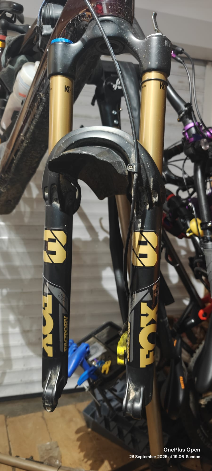

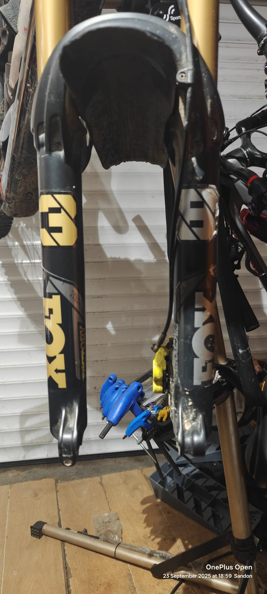

fork service & tune time.
to explain the 'tuning' as mentioned
anyway, damper stripped out of the lower-leg and now draining ready for a deeper dig and rebuild 😎

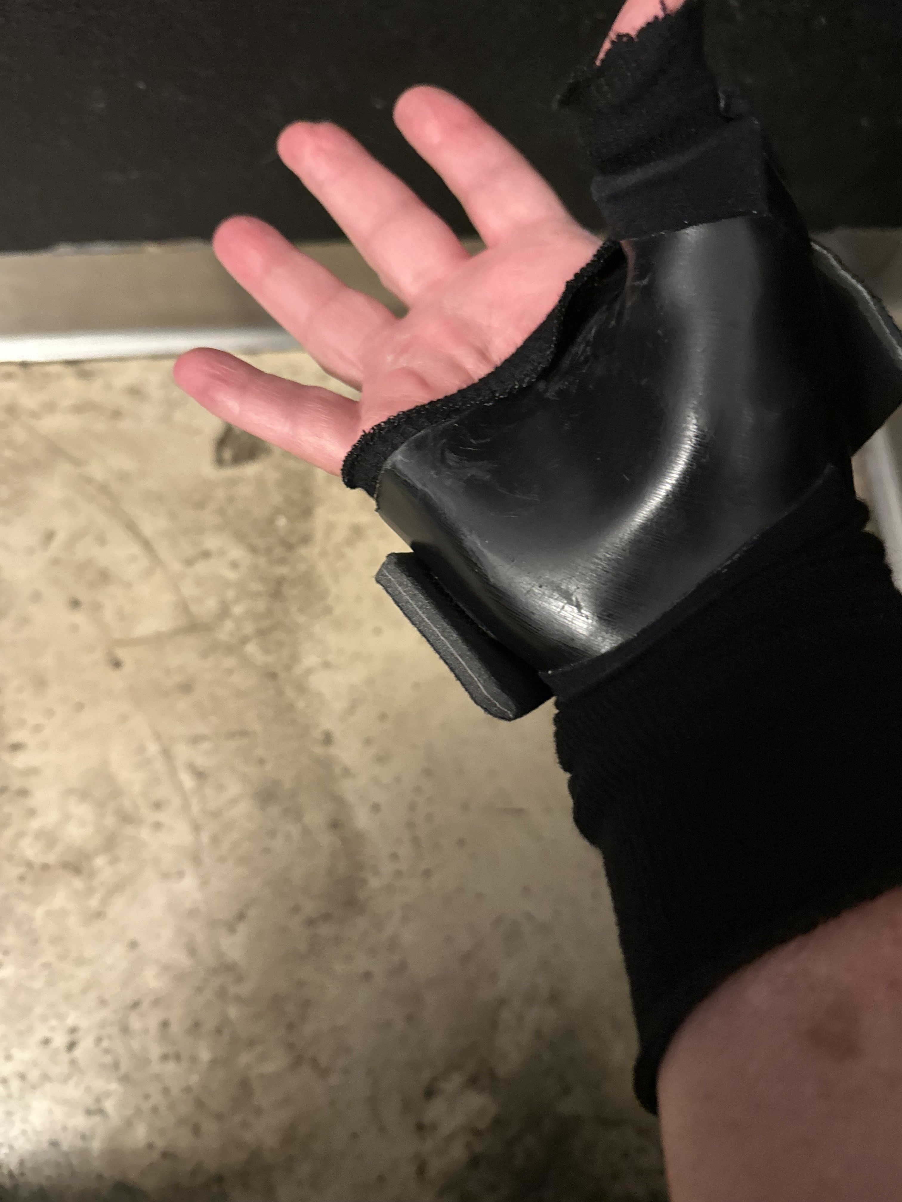

After a mishap earlier in the summer, my thumb needed surgery.
I then proceeded to talk myself into a new fork. Said fork needed a front wheel with a big axle, so I talked myself into a new carbon wheel (to partially offset the weight of the fork)(very partially). After waiting a while for the fork to be back in stock and the wheel to be built, I took the bike home. Not having ridden in about a month and a half, I took it out for a cruise around the neighborhood. Just a few rocks and curbs. Well, on the second curb I pulled for, the left grip came off in my hand. That get-off was the best yet, not a scratch. Looking at the piece of grip revealed that it was not just the grip but the whole bar that broke, outboard of the brake lever, which I found on the ground. Brake lever assembly, new bar, and a fox neo trigger was the damage. Another week and and a half waiting for brake assembly, non matching, but who cares, and it’s back…without the trigger for the dropper. Coming soon from fox, maybe. I’ve still got the stub that works so-so and that’ll have to do for now. Need a credit limit upgrade and a new supply of patience.

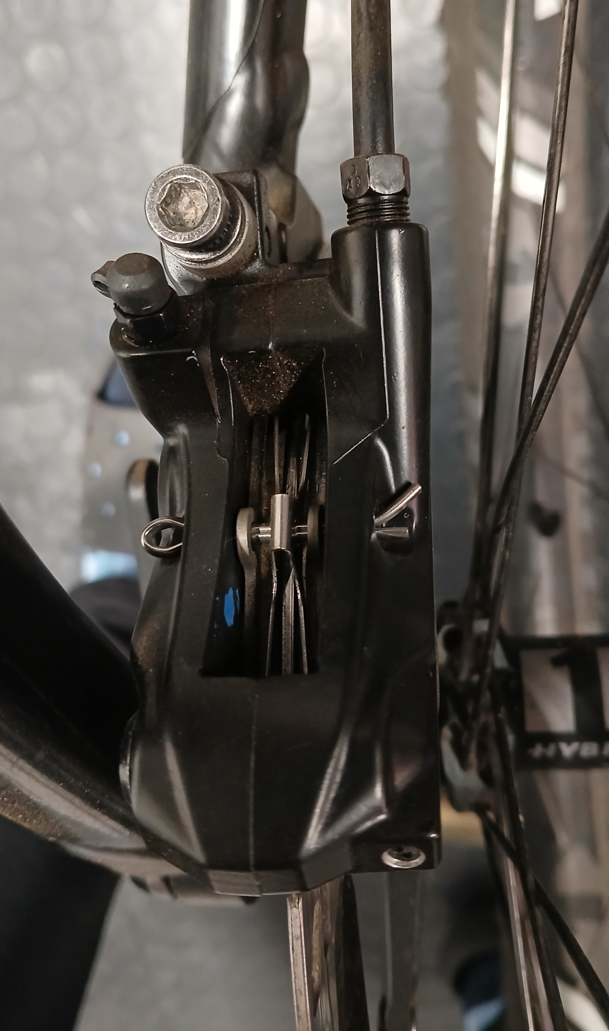

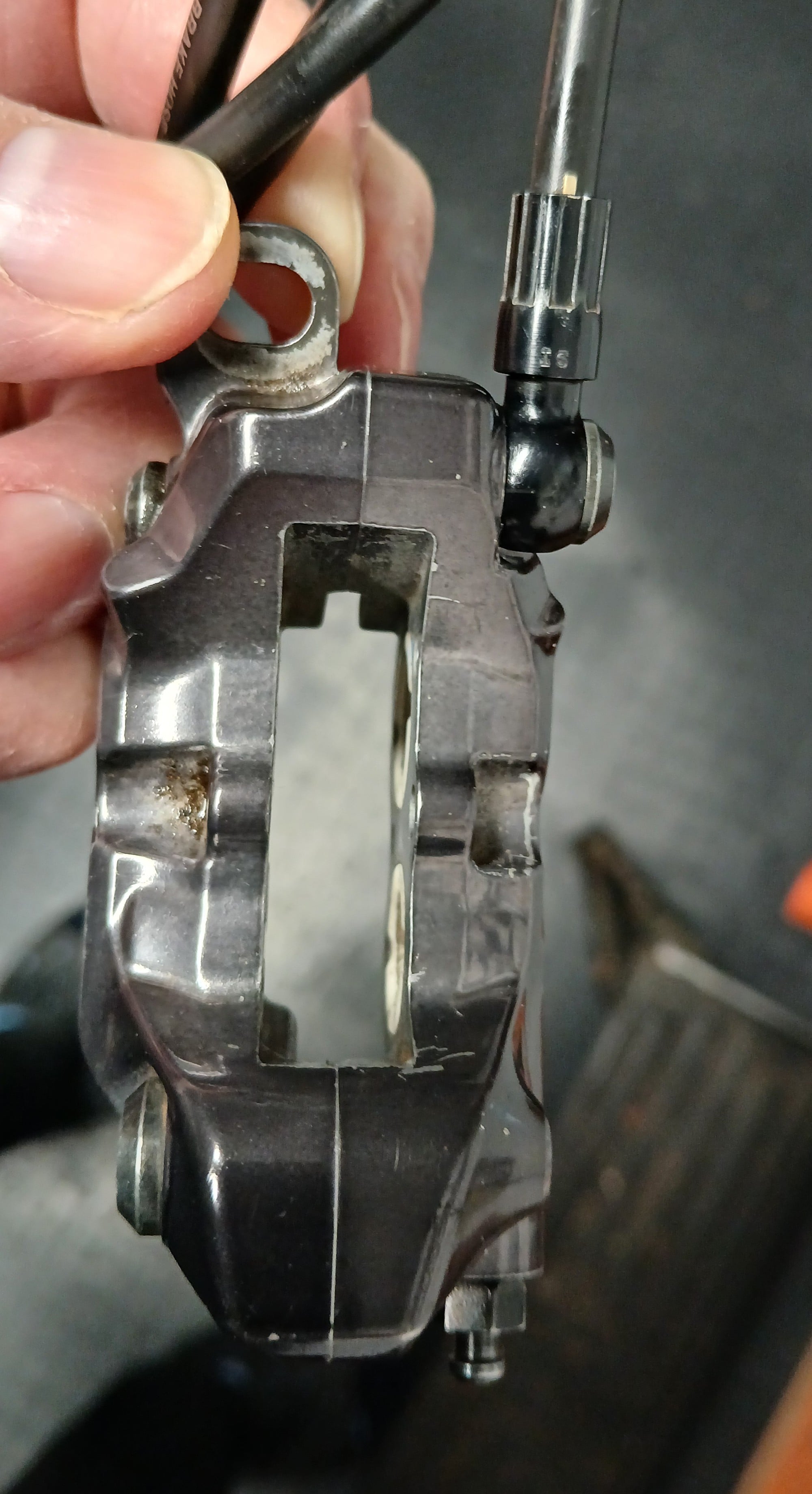

Before I contacted the LBS, I thought I'd better check the bike first.
Here is the BR-M520. Showing the hose going straight ito the calliper body.
And here is the BR-M8120, showing the hose going into a banjo that has the oil bolt going through it, entering the calliper body at right angles.
From these pictures and your post (which I wasn't sure that I understood at the time of reading), your proposal is that when the brakes were first "fixed", the BR-8120 calliper was not touched. This would be why the problem recurred if it was the banjo etc that was at fault. Any improvement seen at first would have been the result of a fresh bleed.
Subsequently, when the BR-8120 calliper was replaced with the banjo-free BR-M520, the fault was removed along with the banjo!
That would certainly fit the circumstances. Have I summarised your proposal correctly?
The only benefit that I can see from the banjo and oil-bolt design is that it would allow for a better route for the hose in to the calliper in all circumstances.
Yes, probably not the banjo itself (as your shop fitted a new hose and they come pre-installed) but the oil bolt MIGHT have a damaged o ring, or a piece of debris in it (depending if it's the waisted type or cross drilled type of oil bolt) or a slight score/scratch on it, letting a little air in but not fluid out (when you apply the brake, the fluid/oil will pressurise forcing the o ring to seal, but when the brake is released, relaxes a bad o ring and allowing a tiny amount of air in) Dead easy fix, new o ring(s) or new bolt and o rings.
And yes the banjo assembly is only there to get a more compliant hose line instead of the straight entry found on the M520. Worth taking a look and inspecting.

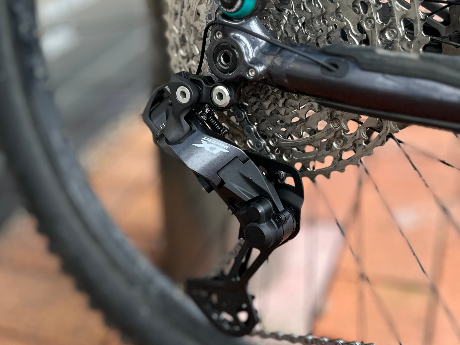

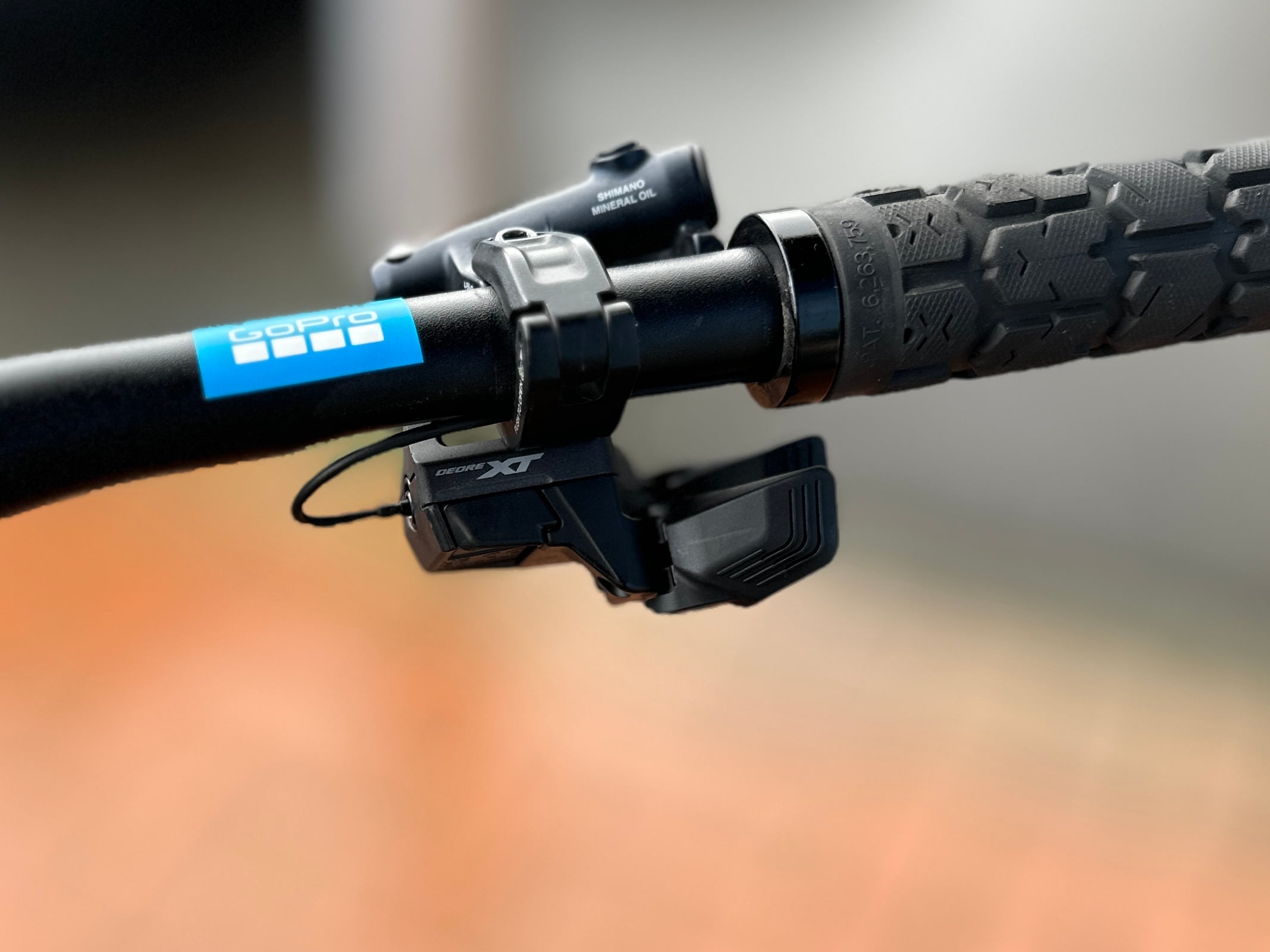

Finally had all my bits and bobs installed:
XT Di2 shifter
XT Di2 Derailleur

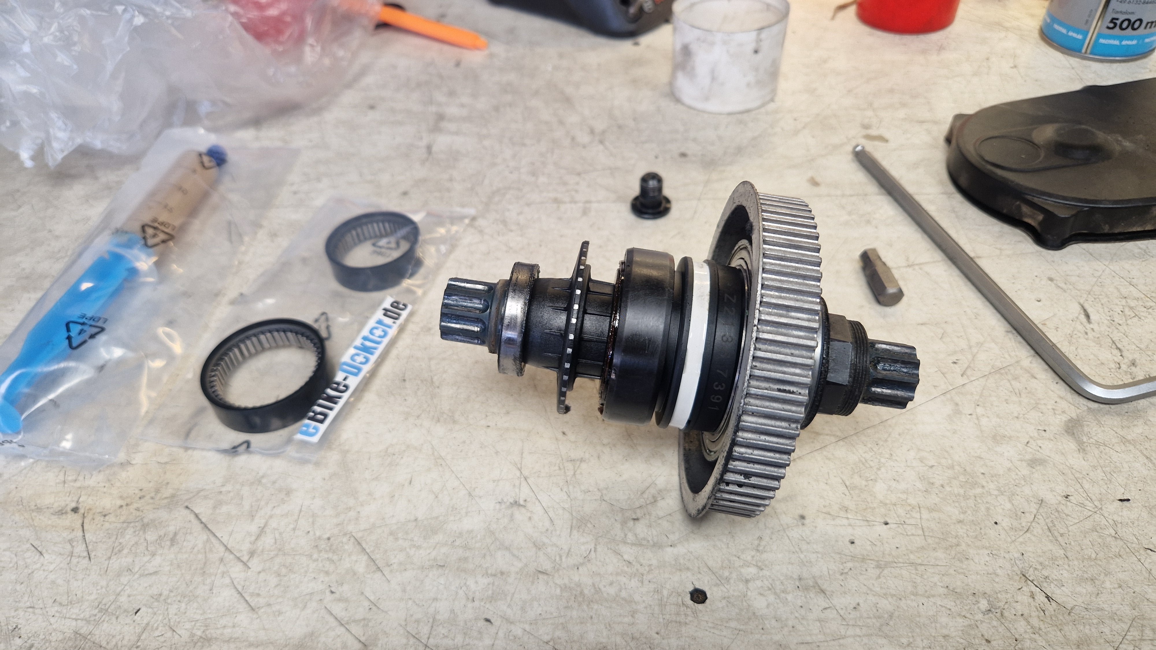

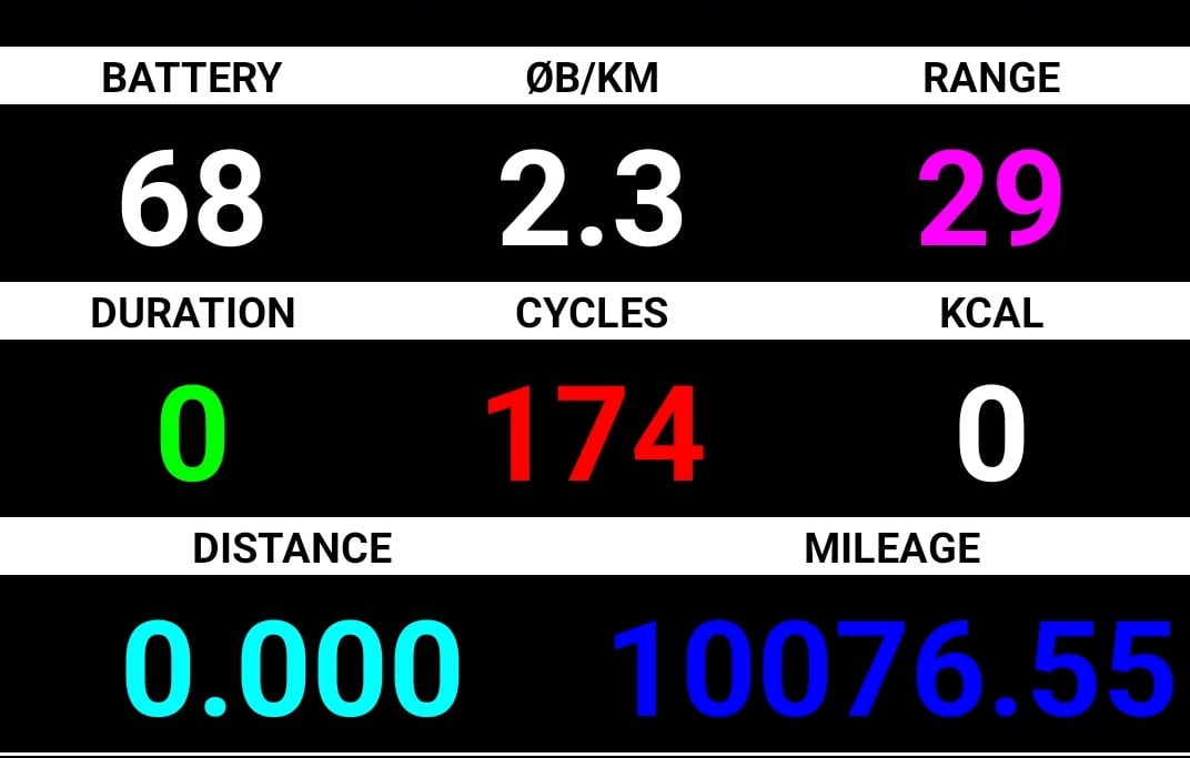

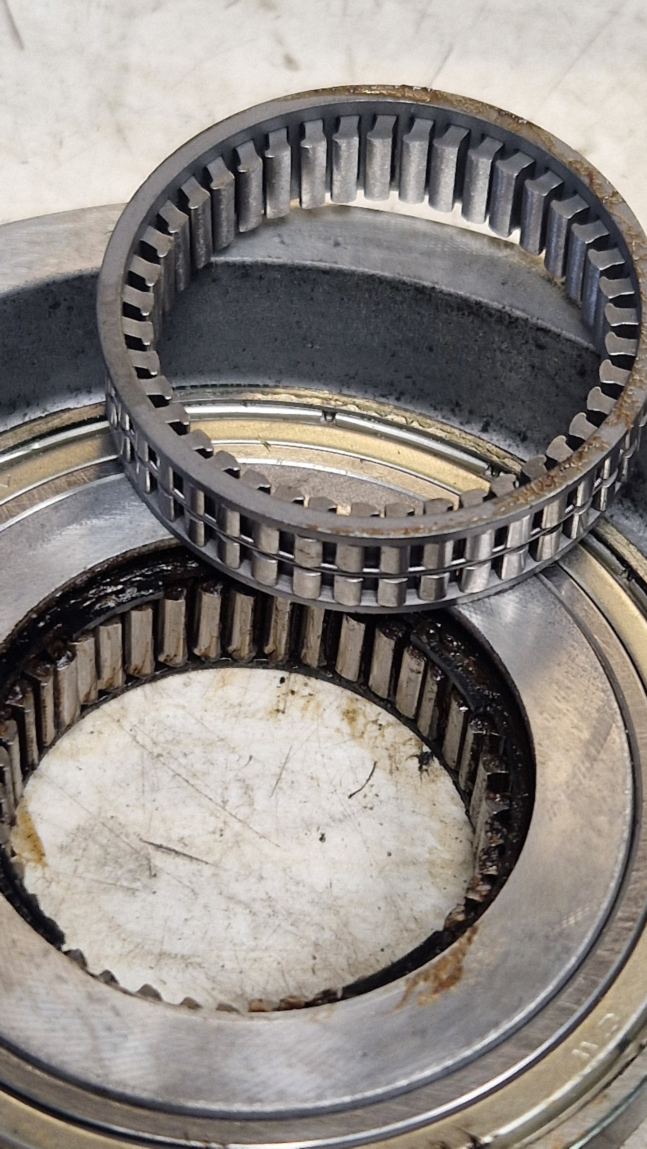

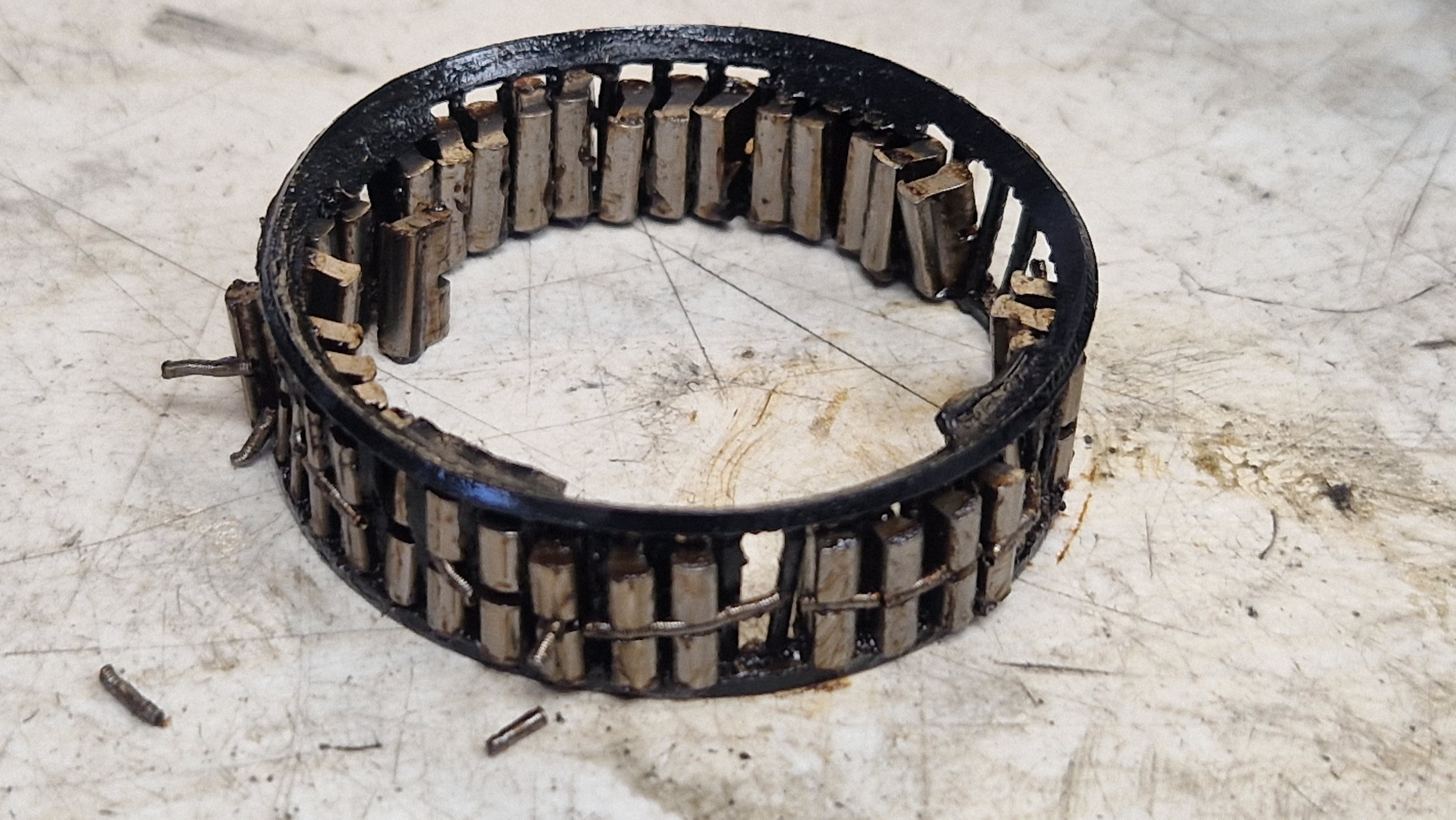

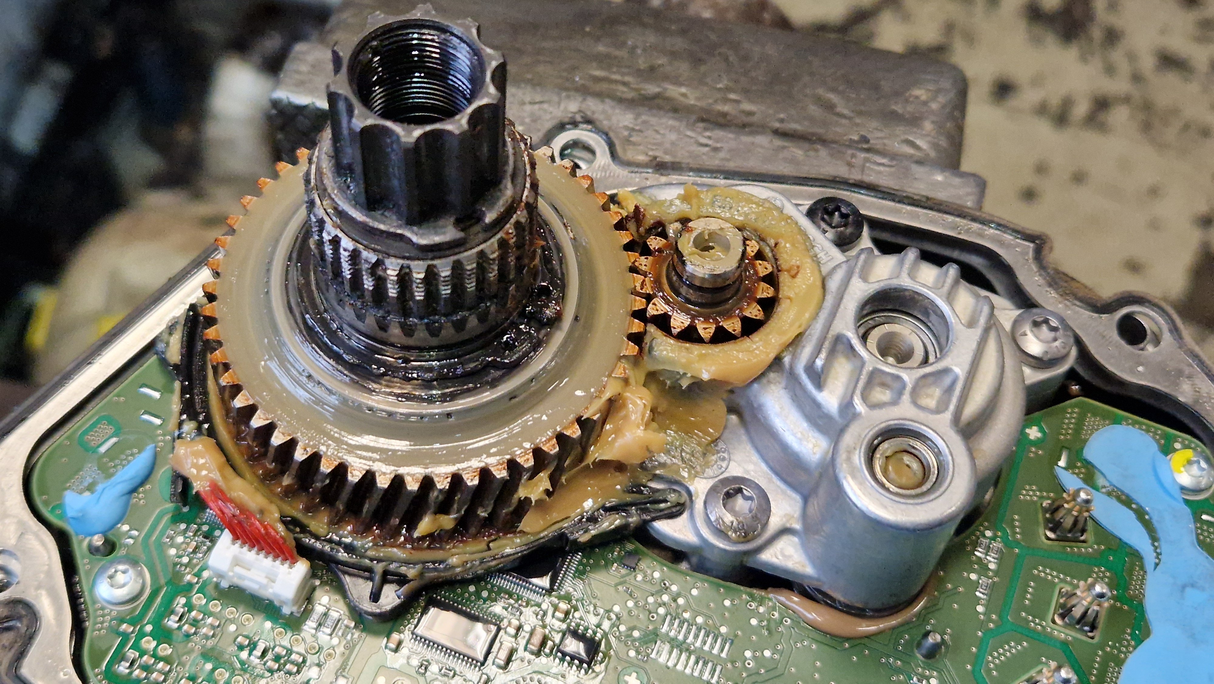

I hit 10 000km on my gen4 cx last week (in 1,5 year),it was getting bit noisier on the rough stuff, i decided to open it up, and re grease it. Looks like it got a little bit water ingress. Didn't took any picture afterwards, but I used a hefty amount Motorex white grease on the cogs, and the clunking noise is barely noticeable anymore. Also replaced the bearing protection rings.
Since i bought the used Kenevo, i felt the overrun was inconsistent, and too long in Turbo mode, ordered new sprag bearings, and replaced them. It feels pretty normal now.

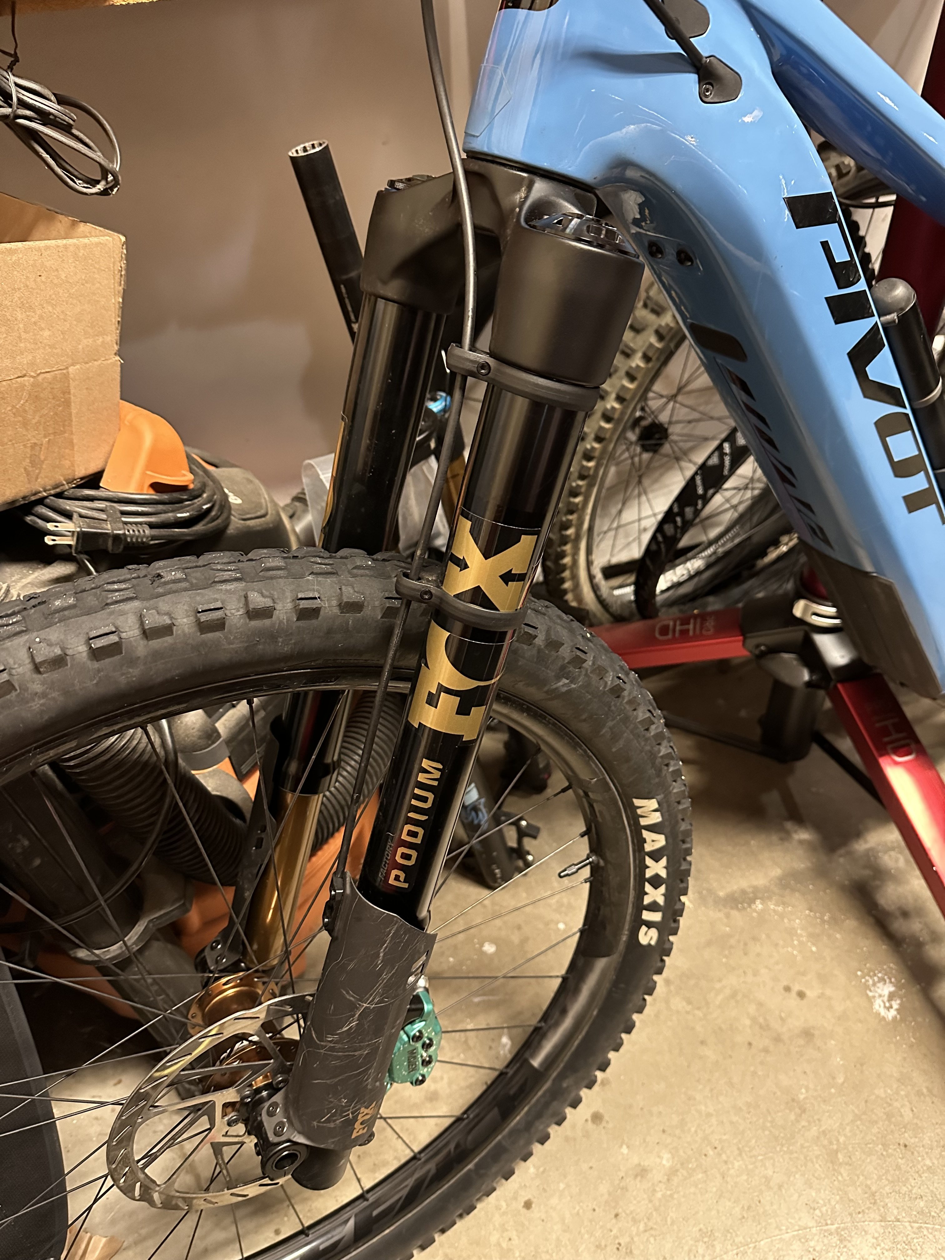

Had a 170mm air shaft fitted to my fork and also had XT Di2 (8150) fitted as mentioned in an earlier post.
Went for the maiden voyage yesterday and it was like a completely different bike!
Autoshift is not for me, but Freeshift is amazing.
The extra 10mm of fork travel really surprised me. I dropped the pressure a touch and added slightly more sag, half expecting there to be little to no difference, but I got exactly what I was after - plush, deep feeling travel that almost feels like a DH rig when pointing it down a chunky descent and going for a “rip and grip” kind of ride.
Also felt unnaturally smooth on the jump trails too.
