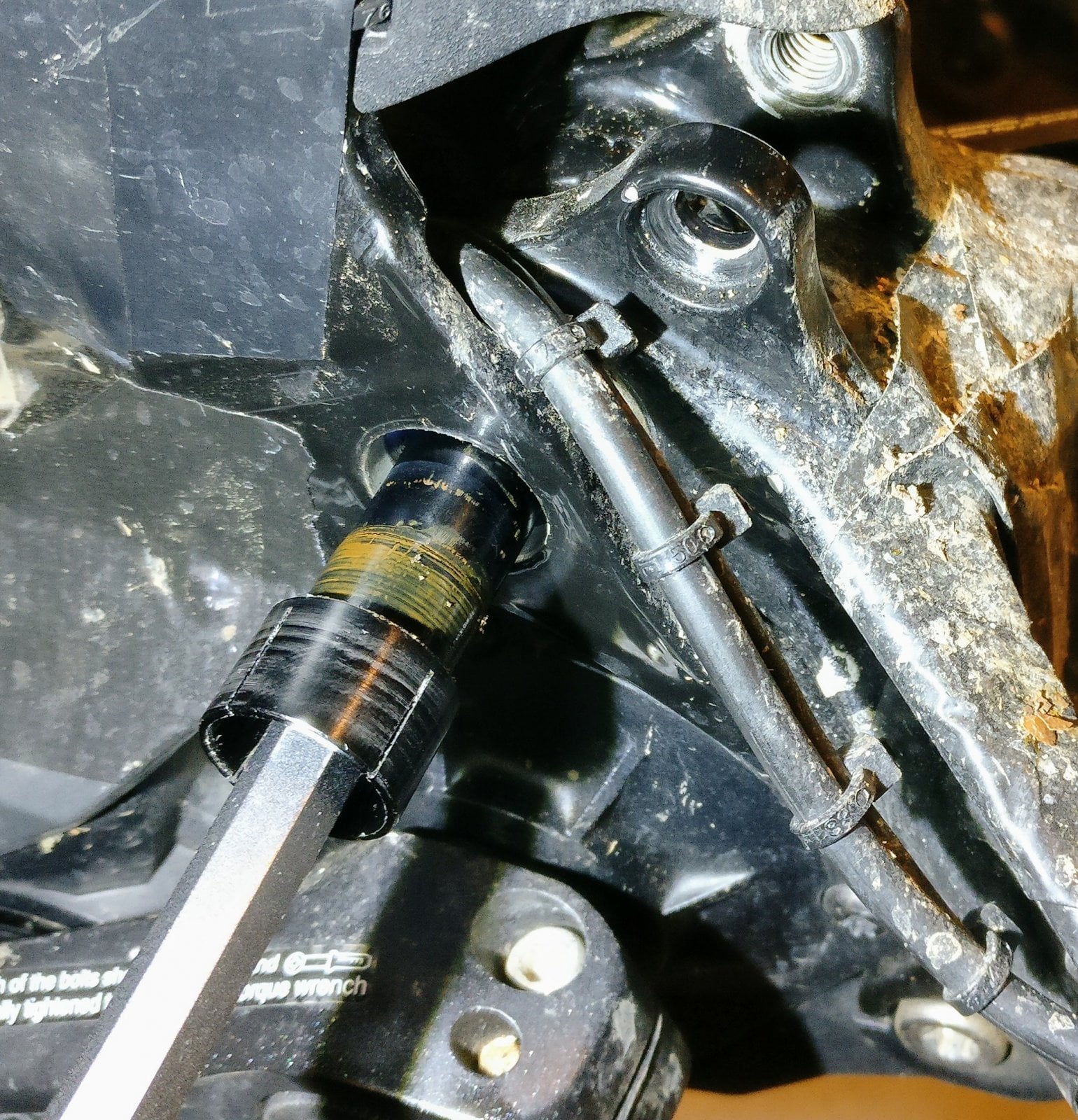

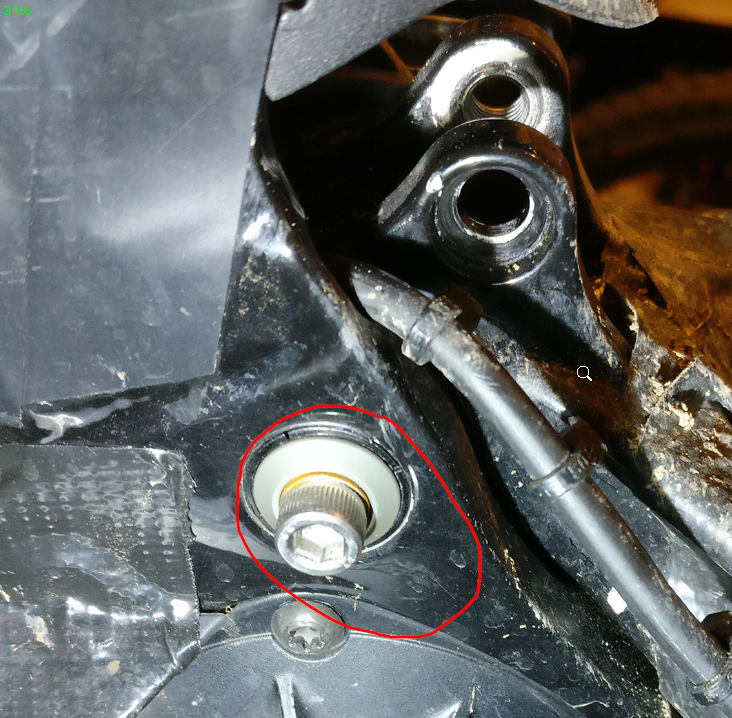

Has anyone removed the swing-arm from eSommet?
I noticed already some weeks back free play in the rear linkage. Today had time to remove all of the links and located the free play coming from main swing-arm axle/bearings. eSommet seem to have bit strange design as there is really no through axle (like any other bikes I have had). There is just small 6mm screw which can be removed with allen key. But it is only maybe 40mm long and removing it does not loosen the swing-arm.
Any advices how to proceed?

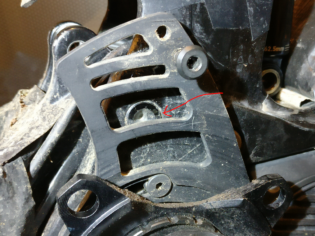

Here are some pics of it.
Should I knock the screw on opposite side with hammer to loosen the other side? Gently knocks did not push it through (TL-FC39 is in order as chain guide has to be removed as well..).
I would suggest dropping the motor, or at least removing cranks, spider, and chain guide before doing that just to get better access. If you haven't removed the cabling from the bike this may be preventing it moving too.
Thanks for the tips. I got the main axle out now. Under the smaller 6mm screw is another slot for 8mm allen key. This is the actual main pivot axle. And it is actually possible to remove from non-drive side.
I haven't identified still what is causing the free play. Bearings felt smooth, even there was some rust. I'll check tomorrow evening again and try to re-torque the main pivot axle (maybe it was just loose).
Yeah that's pretty standard.. same as some pivots on my Santa Cruz. Exploded looked like it interfaced with the other side and you often need to hold one side while you loosen the other.
I'd probably just clean it all up and grease/Loctite where appropriate then Torque everything up.

It is definitely play because I could feel small "edge" while rocking the linkage from side to side. But there is no signs that chain stay would have been scratching the frame (which is of course good). So I hope it was just because of the main pivot axle was not tight enough and the bearings were not "pre-loaded" against the frame.
I'll just put everything back together in evening and tighten back to correct torque and hopefully it is "fixed".

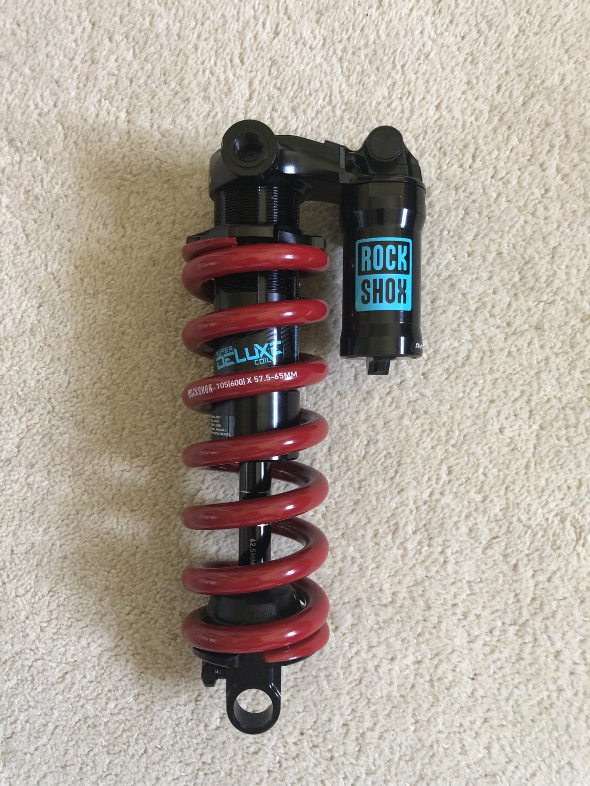

What shock are you going to use?

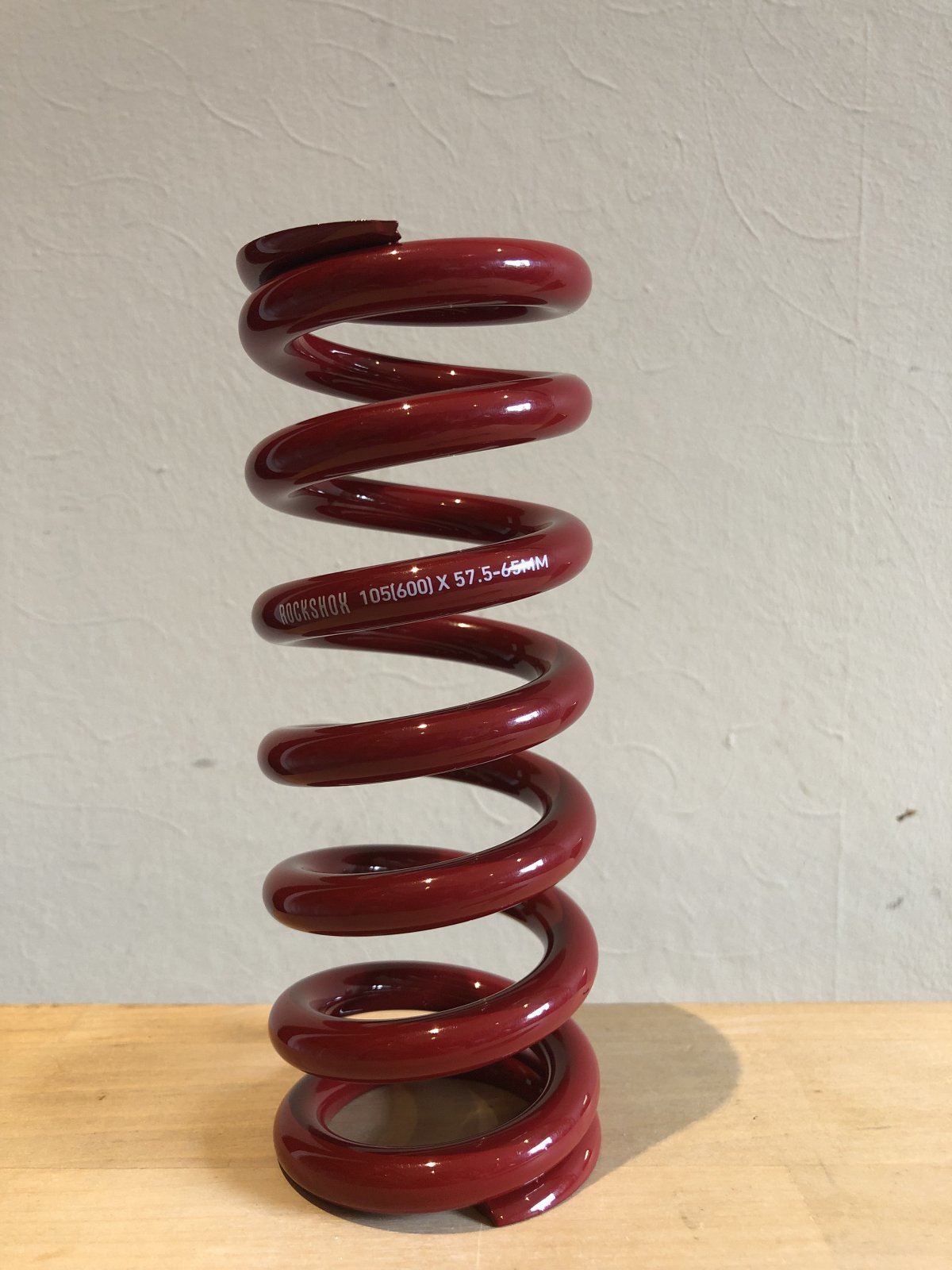

The next part in the plan has arrived - by sheer luck I managed to pick up a second hand unused boxed up as new shock with exactly the right measurements at a bargain price.
Still injured so proabbly won’t get a test ride till next weekend
What did that cost you? Had my eye on a listing on eBay for SD coil for £230 delivered from Taiwan, not including any import tax etc though. Was tempted but I have gone down this road before with a Cane Creek coil on a DW 5 spot and it really robbed a lot of pop from the bike, be interested to see how you get on with it.
I got shock for 200 - I am pretty sure the seller was a pro rider but can't be sure, it was a private seller uk based. I actually found it as I was doing an image search fro one and the listing came up, and then when I read the blurb it was the right size, which isn't an off the shelf size. Got the spring from TF for 35 quid.
At the price I am happy to try it out - my original shock is being serviced at TF Tuned at the moment, and having a Meg Neg can put on it, which is easy enough to reverse.
I nailed myself a couple of weeks ago so have taken the time off to play around with the bike some more, I am also having my forks which are 180mm (Lyrik RC2 that I put on, not the stock ones) put down to 170mm as I dont need 180mm and it does move the front end up a bit, and I want to make it a bit less effort to get my weight over the front. Also putting a 36t front ring on.
That is a good price. Keep us posted on how it rides. Be interesting to see If MRP sell the progressive springs aftermarket
