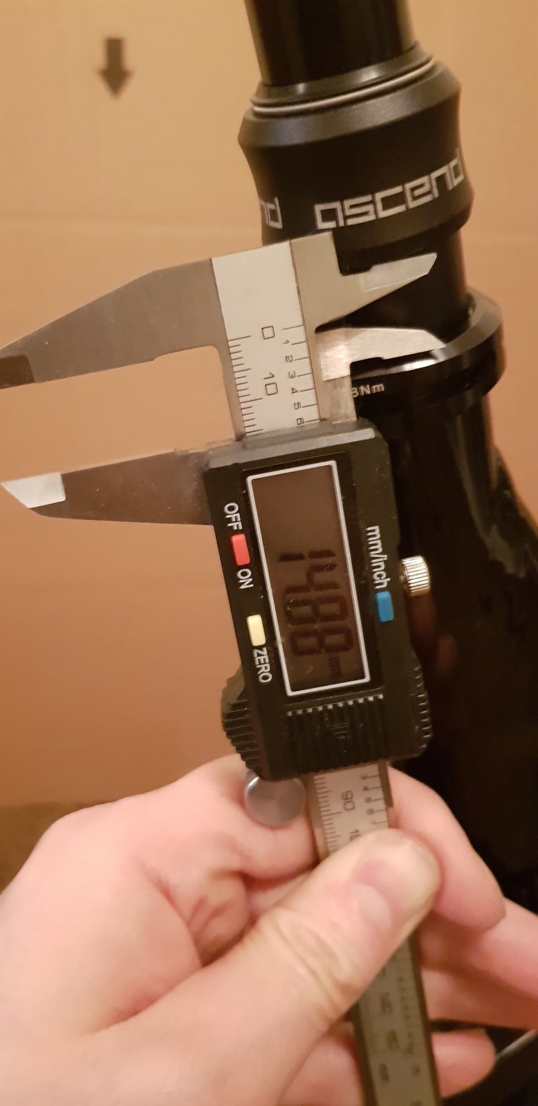

25-30mm, not ridden it yet so may tweak it.. it wont slam completely but maybe with some cable wrangling it may go down a bit lower.
My Santa Cruz Large Hightower LT is 55mm for the same measurement..
Sorry misunderstood your post, it slams into about 15mm but its cable resticted by feel but I set it to 25-30 for me to ride which doesn't leave much scope if your much shorter than 6 foot though its leg length that matters.
My SC Hightower LT is set to 55mm for me to ride showing how much more scope my large SC hightower as for upsizing.

slides all the way in.
9,185
Thats what we are tying to figure out, by comparing how far you can get it down on a 2018 vs 2019

In small-size 2019 E-Sommet VR you can't slide dropper post all the way in, must be pulled up approximately 20mm.
Of course you can't. the actuator would fuck your shock if you did.
if you only have 20mm sticking out it's reamed far deeper than the small 2018 was.

OK checked the large at full penetration and definitely as far as it will go.
Definitely bottomed out so the only option would be a dropper with a shorter insert depth would give you another 15mm + any collar depth variance if your legs are too short.
Like I've said before if you your saddle is too high all the way in then something with an adjustable max height will help such as the 50mm of adjustment allowed on the OneUP dropper.
9,185
The one up also has a lower overall height when raised, due to how it clamps the saddle much closer to the head of the seat post than most dropper posts, so for example on if you fitted a 150mm One Up in place of the 150mm Brand X, the top of the saddle would sit about 10mm lower due to the clamp set up.

I had a OneUP 170mm post and a 170 BX here at the same time.
Neither inserted far enough to be useable for m (33" inseam) at full extension.
the OneUp inserted less because of the lower post and actuator design. It was longer overall than the B-X (incl actuators) too.
150mm B-X fits fine and still has a little further insertion room available.
