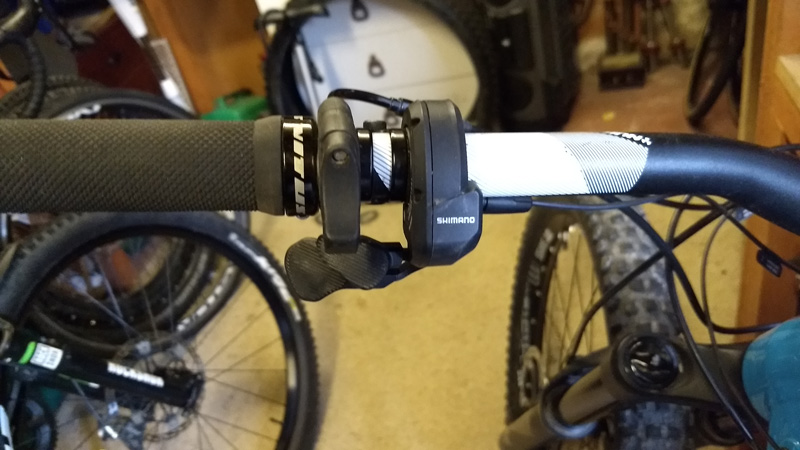

I honstly don't get this.

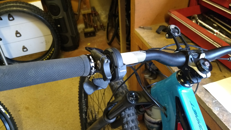

The e8000 controller is far more positive to use and fitted perfectly alongside my dropper lever.
I switched to e7000 because the e8000 is too vulnerable in crashes (bent the levers on mine a few times and cracked the casing, replaced with a new e8000)
I've had the e7000 a month and still prefer the e8000 to it.
Unlike most riders I change mode while riding technical terrain (Up, flat & down) and the e8000 paddles are just more positive in action and much easier to use/differentiate between when your concentration is on the terrain and your HR is redlining.
an e7000 component in a e8000 system is a cost saving downgrade whether or not you prefer it.
Although. I'm not sure how you'd possibly know not owning either.
I wouldn't mind trying the e7000 switch but do love the e8000 'shifters'. I have always had a front mech and my E-Sommet is my first single ring, so the e8000 is like having a front mech shifter in that you can change the 'assistance' a big leap in one go rather than going up a single gear on the rear mech (get what I mean?).

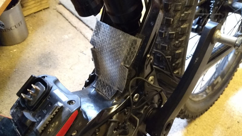

I sacked the original dropper remote and got the one in the photo off Amazon. I also made a cover for the frame above the BB to stop muck & stuff getting in. I've just plonked it on for the photo but needs trimming. Might try an old inner tube but they should have a plastic cover fitted. A bad frame design :(
I've also re-routed the rear mech cable as it was too tight compared to my Stumpjumper. It was that bad I was considering going Di2 but the cost of replacing a damaged Di2 rear mech 'occasionally' changed my mind :(

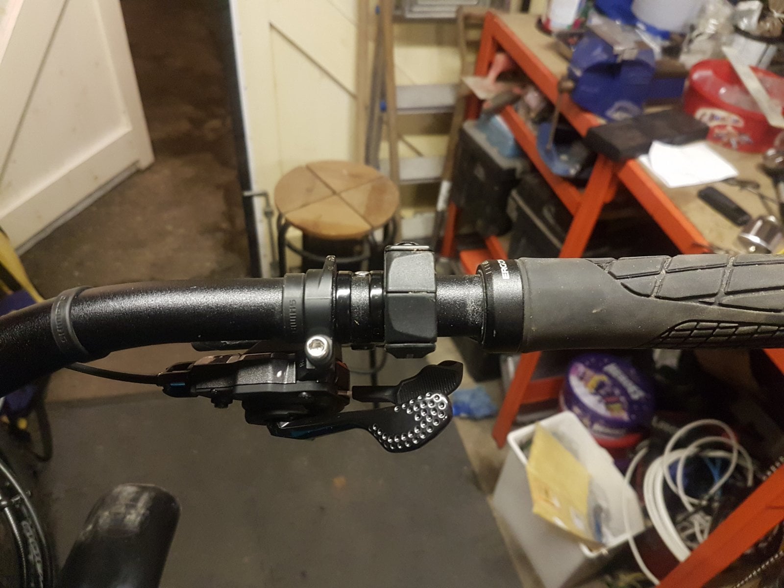

And on the subject of the mode shifter I bought a left hand E7000 with a 400mm cable before it dawned on me that my damaged left wrist didn't like it so much. Was going to return it but moved it to the right first. Meant that the button ergonomics weren't quite as good as they don't slant towards your thumb but main issue was that I couldn't get it where I wanted without a clash with the rear shifter, cable routing was shit too. So turned it upside down and it's bob on for me, no clash at all and button ergonomics are as designed. Doesn't look quite as neat with the cable exiting at the top and the up/down is arse about face but 2 rides in and I'm used to it, bit like a semi auto box on a car. I'd wager you could change it with the PCE-1 box and software but can't say I'm bothered.
Will post a photo up later. The 300mm version would have been perfect but not worth changing.

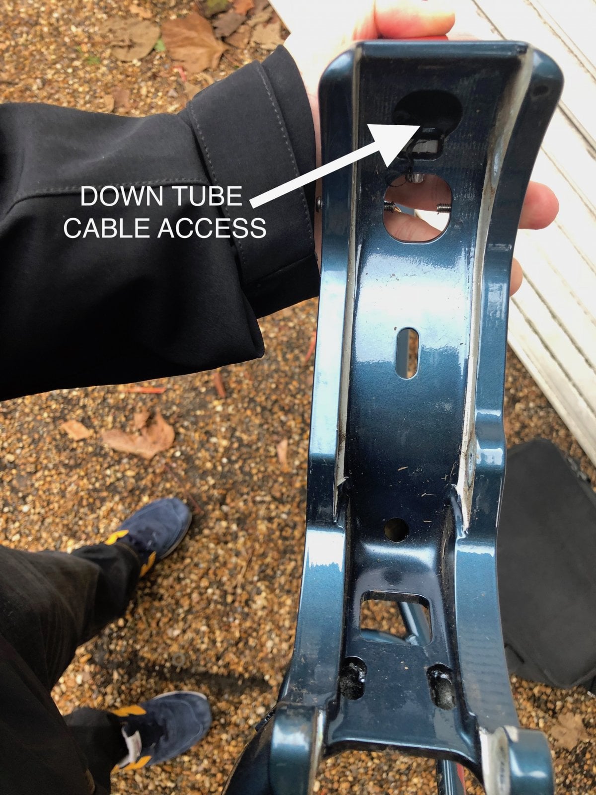

Never wash your bike upside down! The down tube design is the same as the E-Sentier in these pics, if you wash it upside down good chance water will get into the frame as there is a big hole where all the cable routing goes. It should drain back out over time, but what doesn't come out is any dirt or grit that gets in there when washing, and this can cause an annoying rattle when riding.
There are smaller holes on both the top tube and down tube where it meets the steerer tube, which is how water will have got to your headset
There is actually quite a gap between the motor and the frame bracket, and this allows water and crud to pass over it. After I wash mine I use a bike dryer to dry it, and when you blow into the area below the shock it actually blows any crap in there out the back of the motor mount, where there is another gap.
