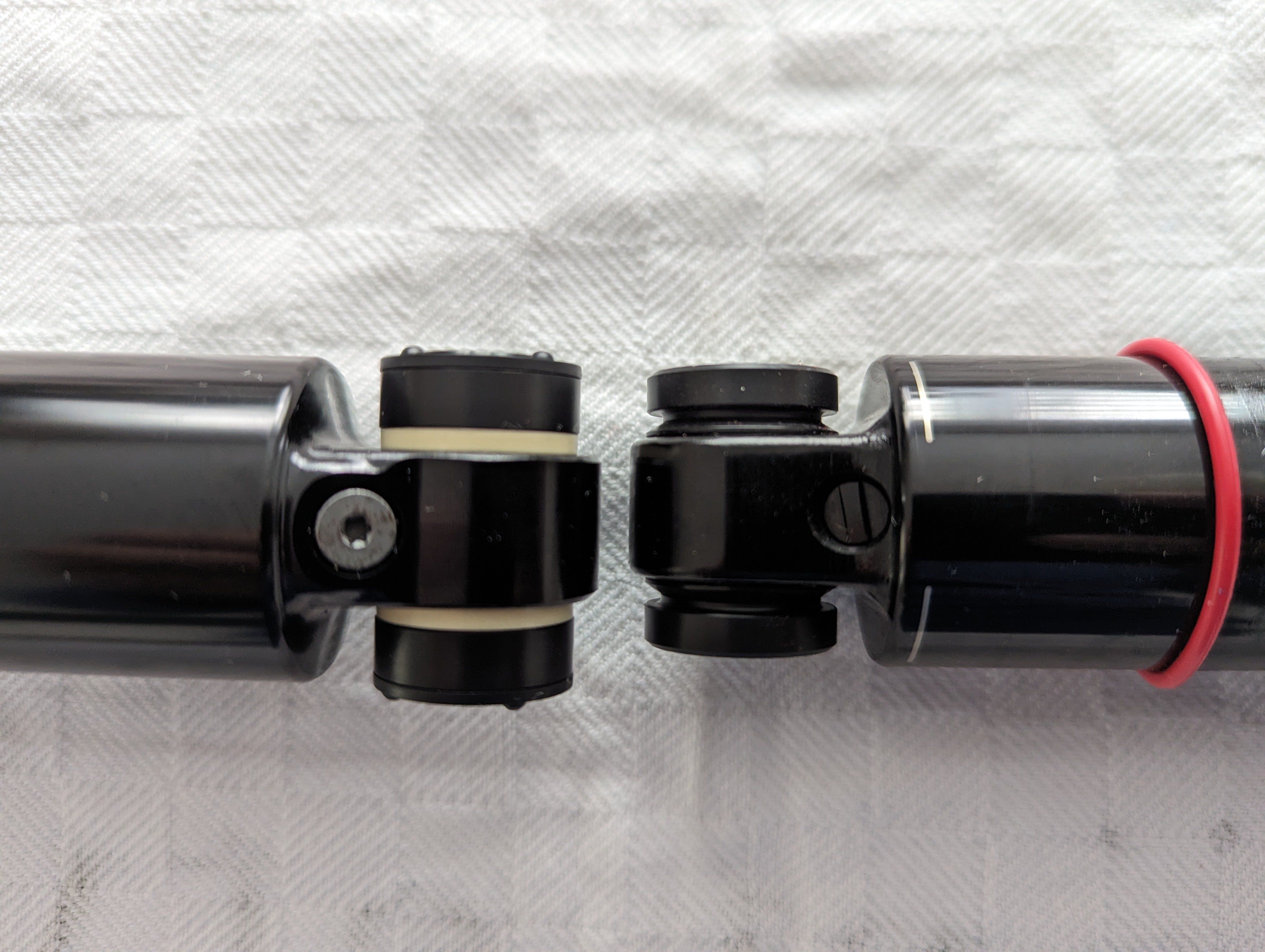

It's worth to check the link. The shock is in deed a trunnion mount shock and not a normal mount as in the picture.
The price is often changing and at the moment it seems to be very low:

20,498
The price is often changing and at the moment it seems to be very low: View attachment 126094
Did you manage to use the existing mounting hardware or did you need to order some different parts ?
