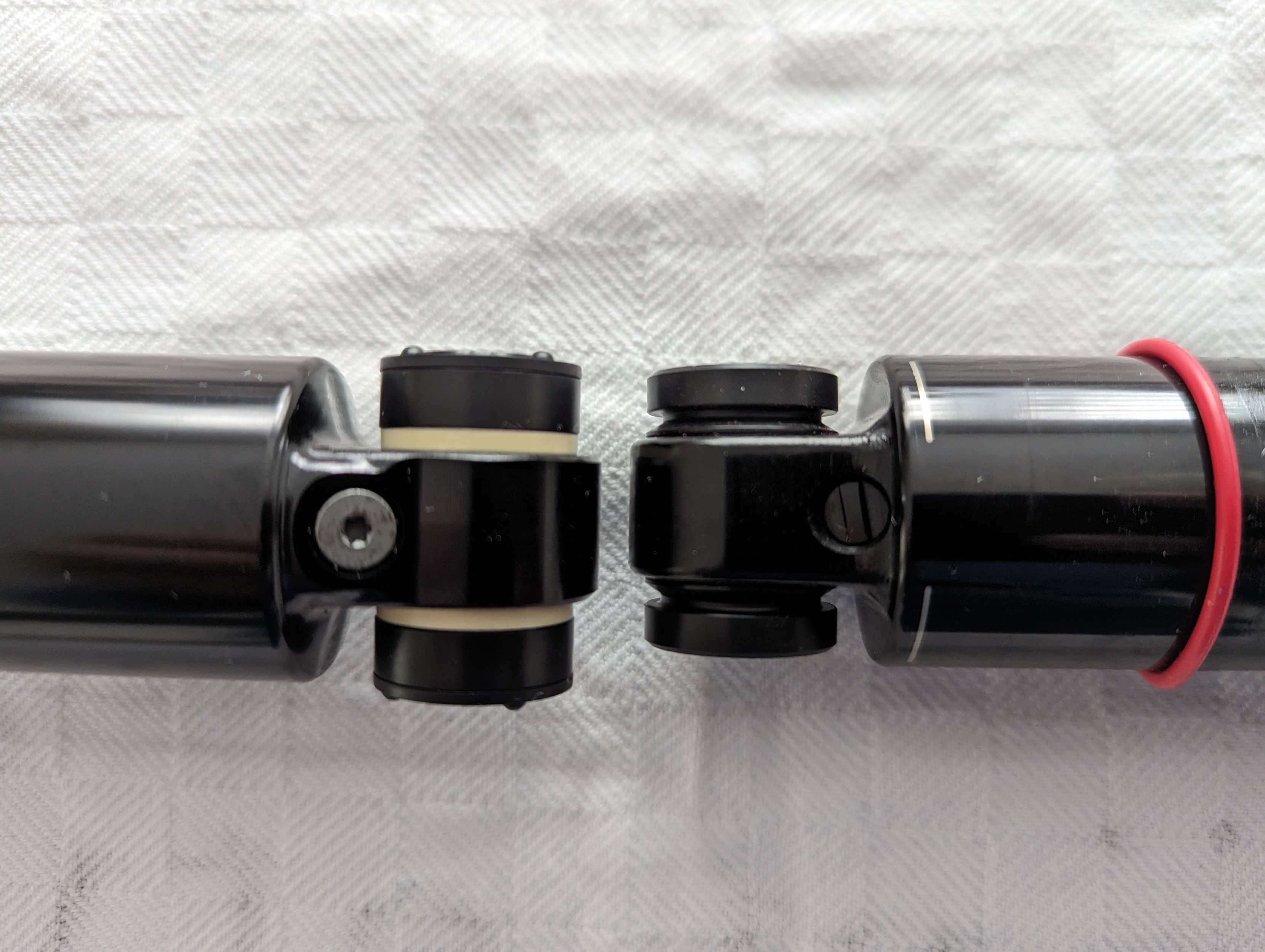

It's worth to check the link. The shock is in deed a trunnion mount shock and not a normal mount as in the picture.
The price is often changing and at the moment it seems to be very low:View attachment 126094
Did you manage to use the existing mounting hardware or did you need to order some different parts ?
OK .. The E-Mythique is 25*8 so the Fox code is : 803-03-328
Doesn't really spin out many Euro supplier options though !
DVO mounting hardware should work as well and I ordered a pair of them (2. Set as sparepart).
Rockshox won't fit (these I have here).
