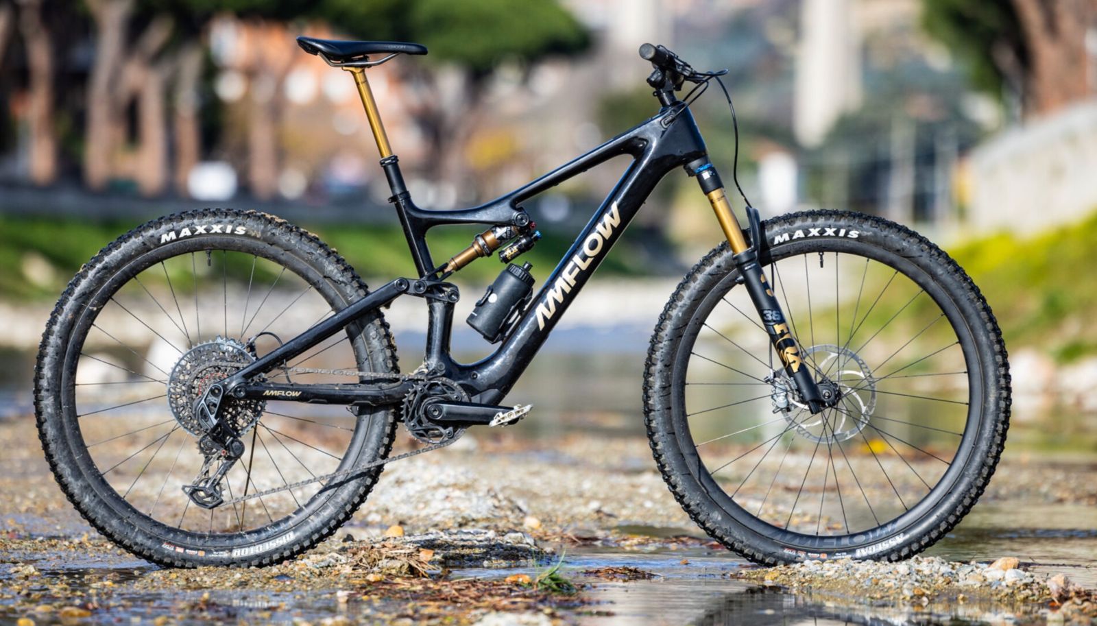

Well, the insertion depth of the Amflow Medium is 250mm, and absolutely will not accept anything longer that the One up 180 for me.
I’ll update with pics.
Perhaps the standover or top of the seatube is much higher on the Teewing, I haven’t looked.
an amflow has a seat tube length of 430mm in size m. you need a 210mm seatpost, the shortest one is a oneup with 545mm length. completely slammed that's 725mm to the rails (430-250 insertion + 545mm) + whatever your saddle is to the top from the rails.so if you have the long legs you claim you have, and that would be a saddle height of around 74-76cm, that would be right on the money. why do you think you need to slam the seatpost completely? that's not needed with your leg length?

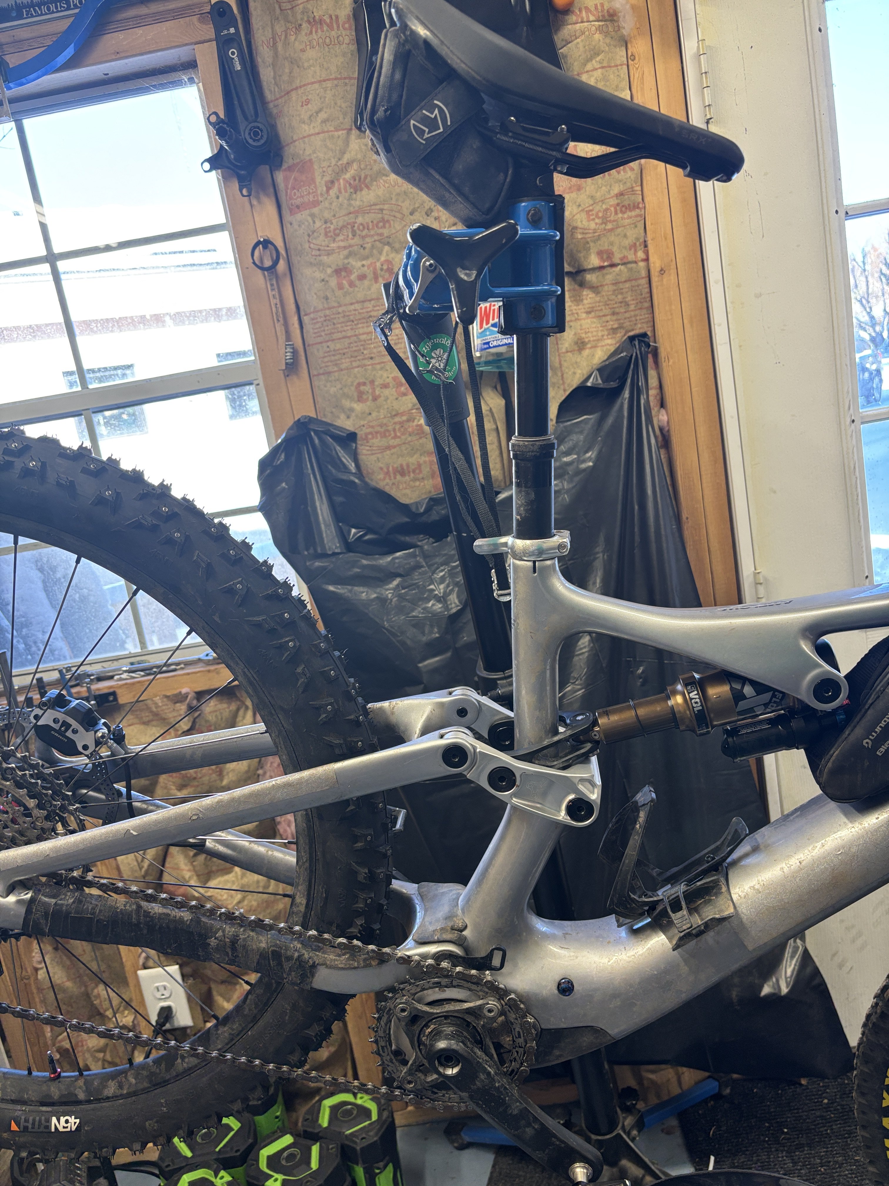

i still don't get why you can't put a 210 in then? i have long legs too, like REALLY long (i can ride a 210 in s4 KSL, that has way less insertion due to the shock tunnel)

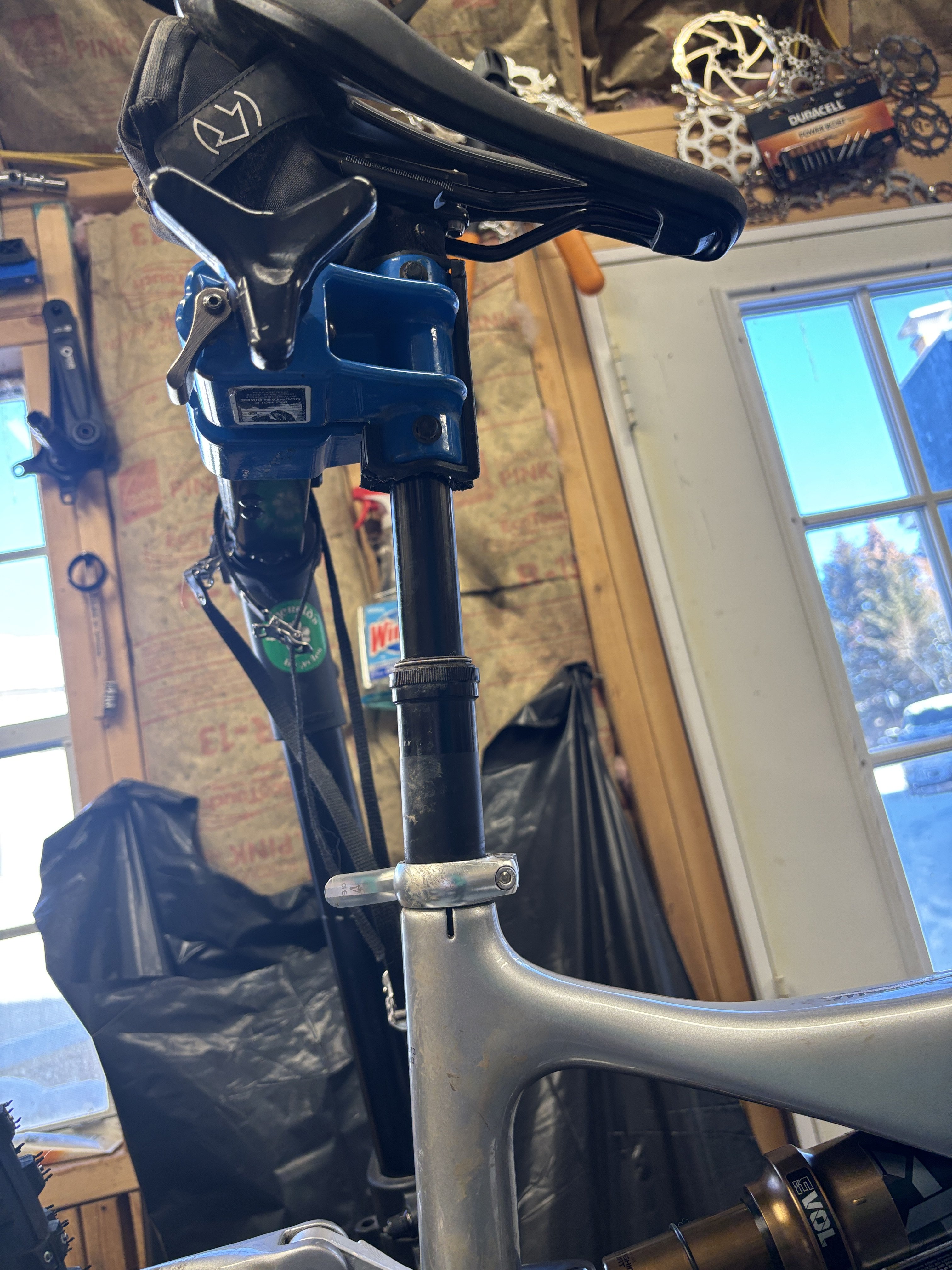

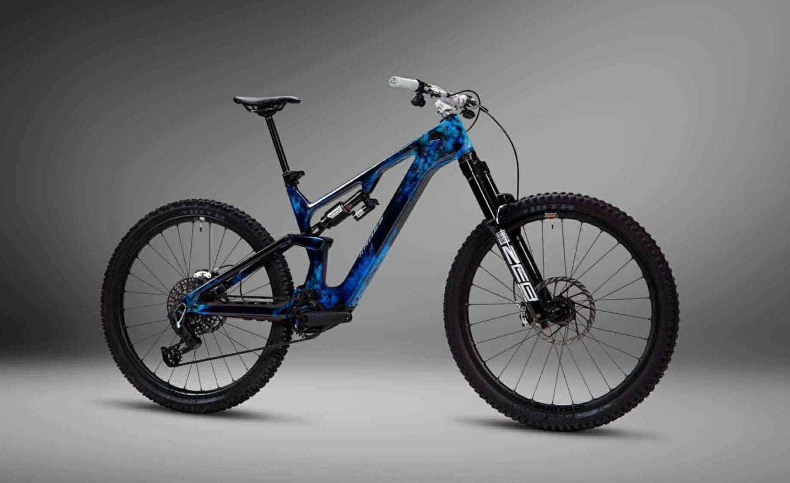

Ok, took pics. My saddle height (to top of saddle, as there are different saddle stack heights) is ~75cm, and 180cm from ground to top of saddle.
with this ideal height, the post is 90mm out of the frame. with the post slammed, it is 120cm. I would need to have the 210 almost slammed in order to achieve the desired saddle height.
however, the 210 doesn’t go anywhere near there, it sticks out almost to the height of the 180 where I have it now.
I would be willing to compromise with it dropped to 200mm, but that doesn’t work with either option, the lower part of the 180mm is too short, and the 210 too long.
To answer based on your pic, there are two issues. One, that much post sticking out of a medium frame would be way too much leverage, IMO.
But what I am looking to accomplish is to have a 210 that will allow me to run it with about 10-30cm of post showing max. (This is how it worked with all of my Rocky Mountains).
I hope that makes more sense?

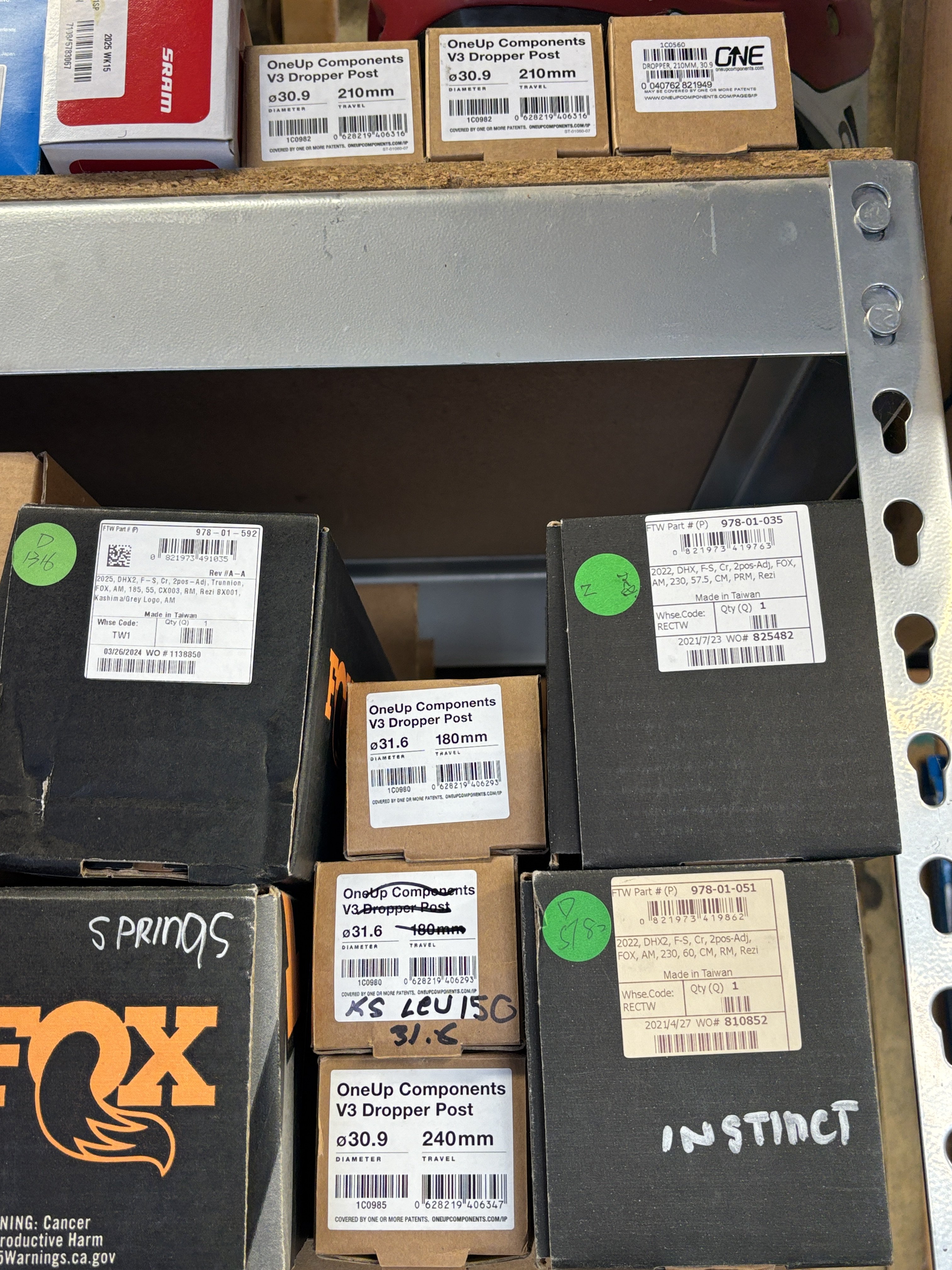

For reference, I have these posts in my personal inventory, I have tried every option, lol.
(not to mention lots of others from other manufacturers at the shop I work in)
then you must have a really high saddle or the insertion depth is less than 250mm. math doesn't lie. i ran in a similar problem when i installed a switchgrade and changed my pedals to outlier pendulums. needed to reduce the travel of the seatpost to 200mm in the end. thankfully the next bike is the velduro where i can run the 240mm easily
I guarantee the insertion depth is less that that, lol.
That’s just what the internet says.
Believe me, I have tried every option that I can think of to get the drop I am looking for from saddle to ground in both positions…🤟
My next step is going be removing the post, and measuring the actual insertion depth, which will be great to know, but still won’t solve my issue. I was thinking about this while driving, it might not be so much that I have a long inseam for my height, but more that I am most comfortable with a saddle height that is quite a bit taller than most. Not sure why.

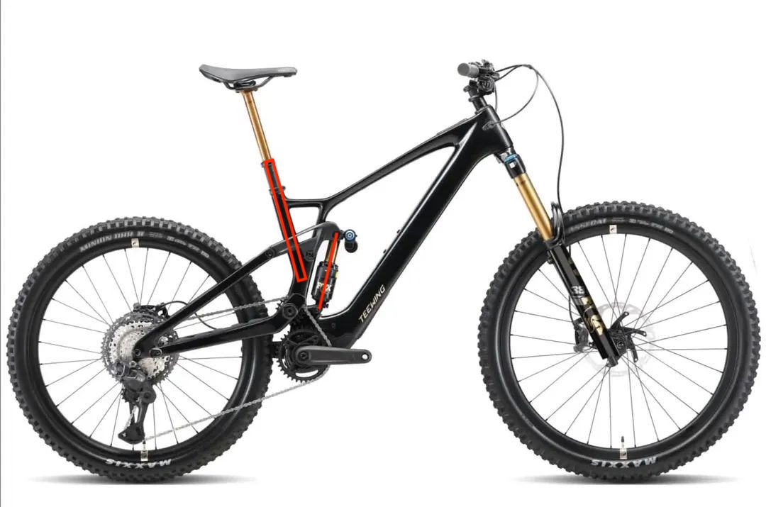

the shock length is a known measurement, 205mm. the red rectangle's side is about 1.25x the length of the shock, therefore the max insertion depth must be around 250-260mm in the size that is shown in the picture (which we don't know, but i guess it is a medium)
TBF, the insertion depth is from the seat post collar and not dropper collar... at least the way you have it drawn isn't accurate.

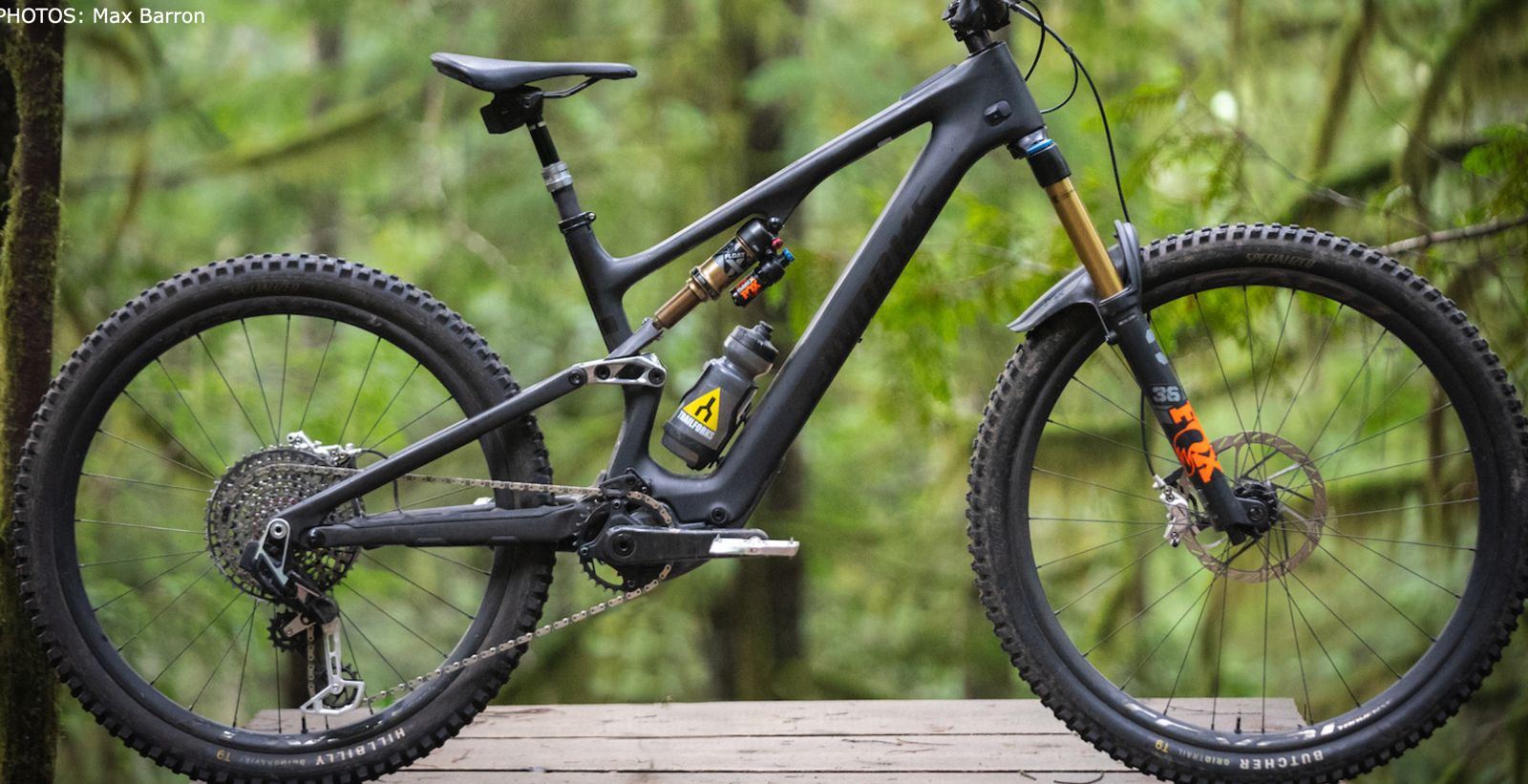

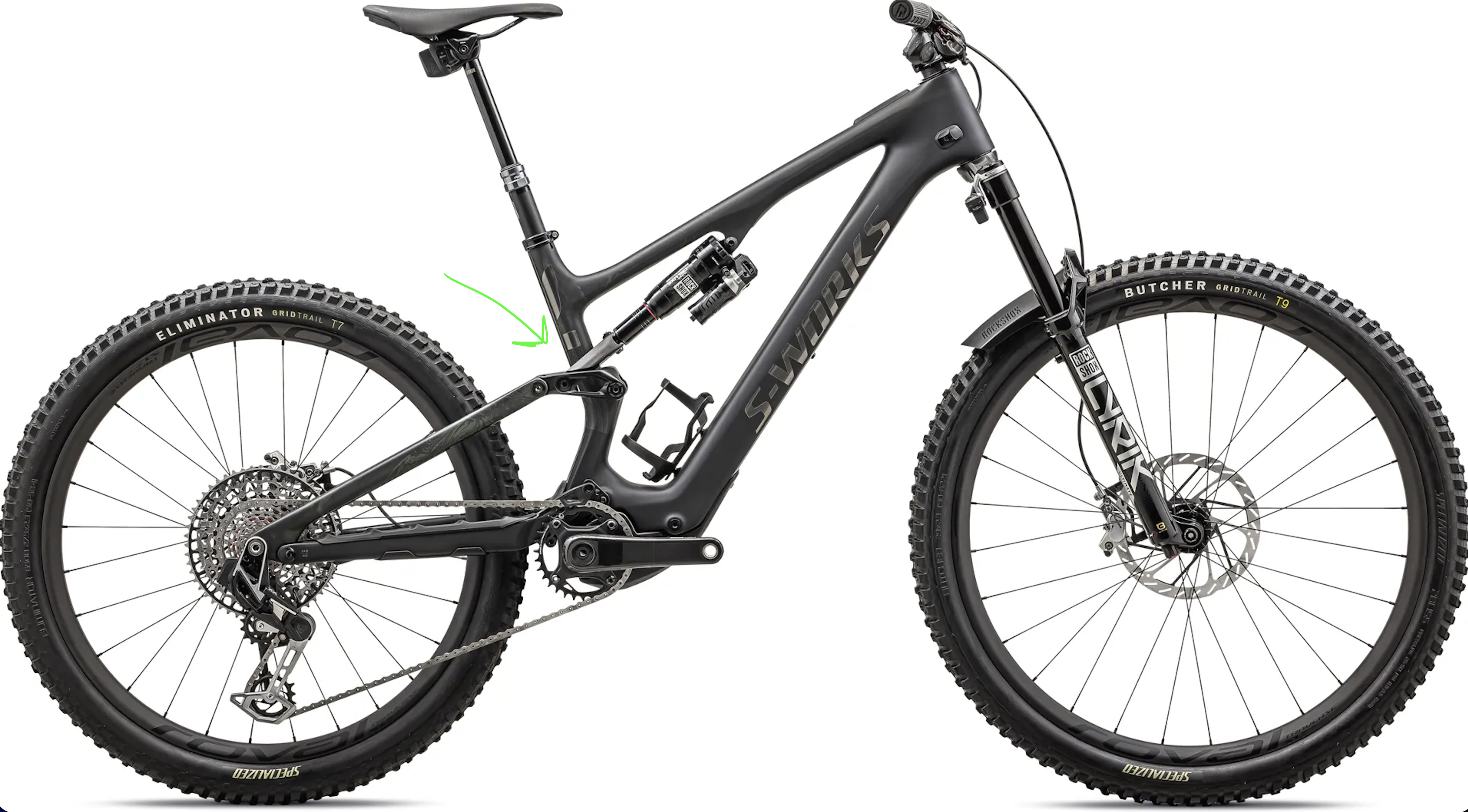

I have a theory, that all these Chinese designed DJI frames have all used this kinked seat tube design because they were heavily influenced by the original Levo SL. These kinked seat tubes limit dropper insertion.
There's no real reason for these kinked seat tubes.... Other than aesthetically looking like the Levo SL

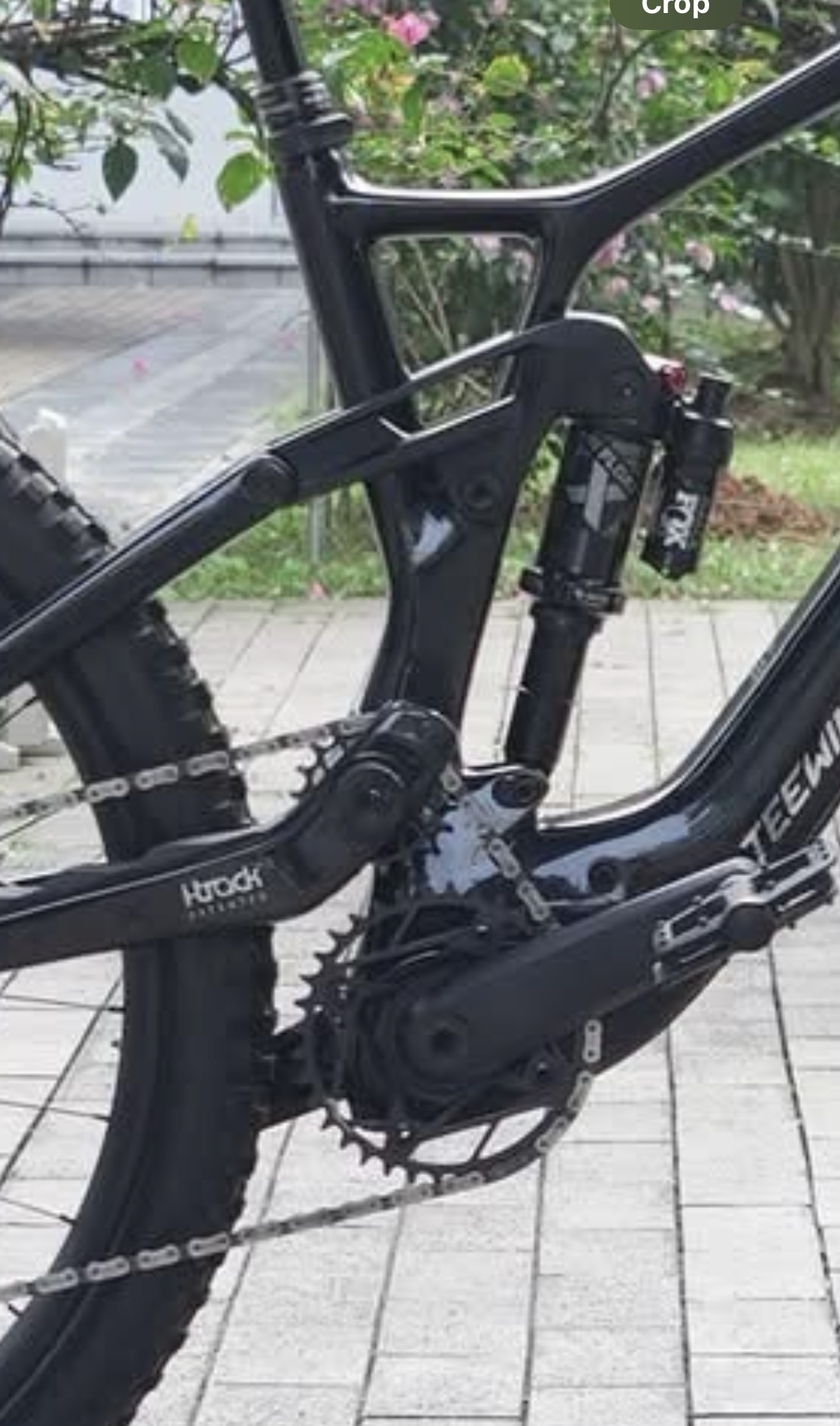

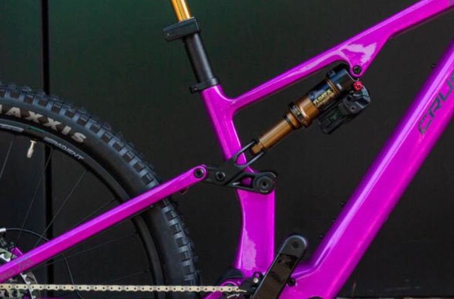

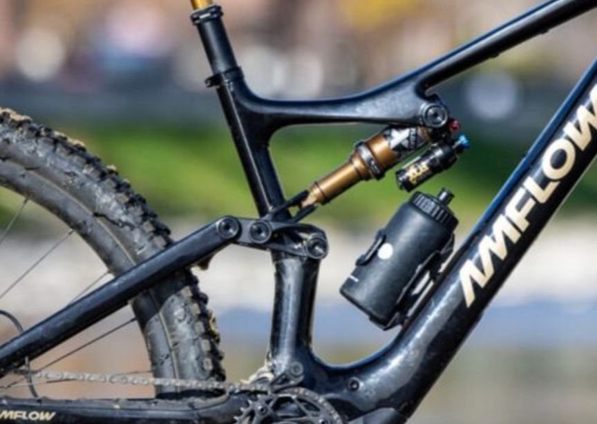

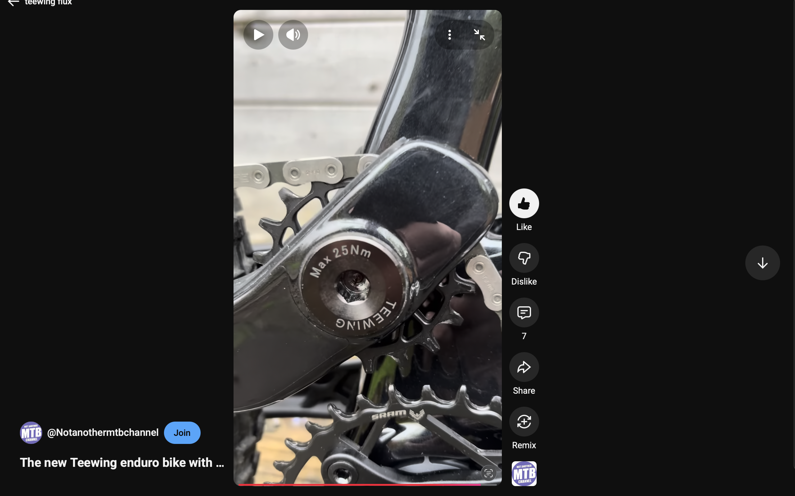

Is it really i-Track, though? From memory, the i-Track patent has to do with an idler mounted ON the swingarm (or attached appendage), in such a manner that the idler is dynamic as the bike moves through its travel, in order to vary the amount of anti-squat/pedal kick both initially and as the bike gets deeper into the compression.
This design, on the other hand, seems to have the idler located concentric to the main pivot, which is not, strictly speaking, mounting it on the swingarm, and it's certainly not dynamic in relation to the bottom bracket. The idler is captured between the 2 sides of the slot they have molded in that side of the swingarm, which seems like a great design from a durability perspective when compared to other bikes that have the idler axle cantilevered with no support on the outside edge, but is simply capturing the idler within a slot in swingarm enough to make it i-Track, even if it is static relative to the BB?
This was discussed earlier in the thread. It looks like the Teewing ripped off the Norco version of the iTrack, where the pulley is imbedded in the swingarm, so it's harder to see that it the idler has its own axle offset from the pivot axle, albeit pretty close to each other. Here is the a diagram of the Norco swingarm that illustrates what I'm talking about.
Technically I haven't really seen the idler close up and on-end, so I wasn't exactly sure if this was the case, but now that the bike sports and iTrack moniker, I guess this confirms it (whether or not Teewing actually licensed it remains to be seen). We need a Rob build out treatment vid to see exactly how the idler is assembled. Until such time, I still think its a complete Norco rip off.
With the Rogue, the distance between idler and pivot locations locations is both greater (since the pivot is fore of the seat tube) and more obvious (mounted external to the swingarm). That's it's an official iTrack design is far more apparent.
