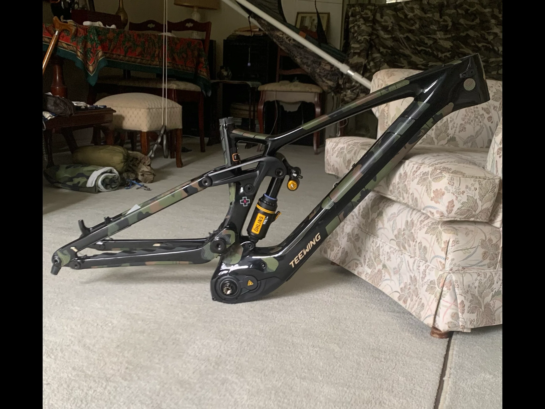

Pushys had a dramatic price drop recently on full frame Camo frame skin, $25. A pack, ordered 2 packs, was't sure how camo on black would turn out.... this all took me out of focus, sticking bits here and there becoming a mosaic game of pin the tail on the donkey, with so many camo pieces to choose from and with plenty of camo leftovers.

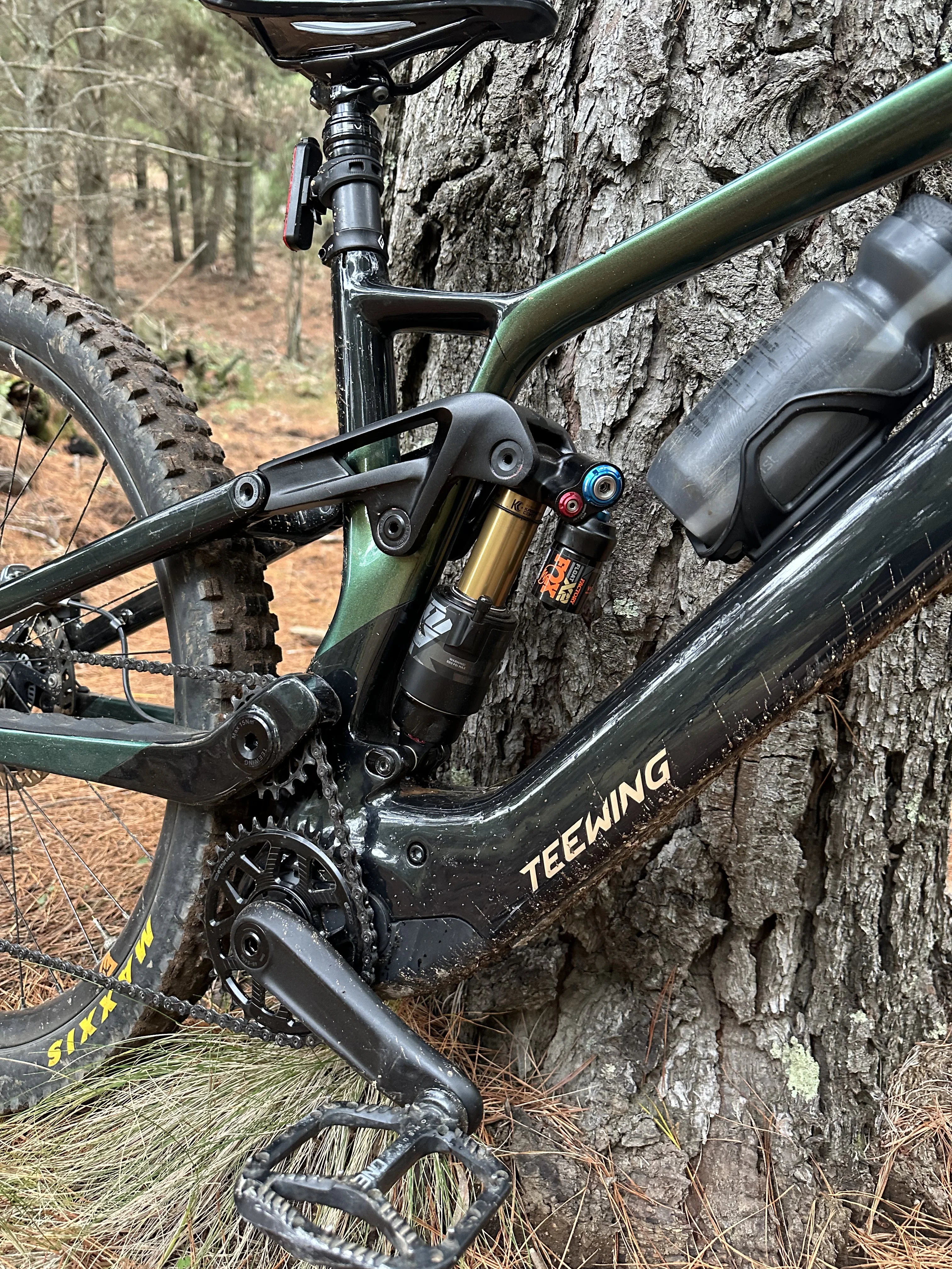

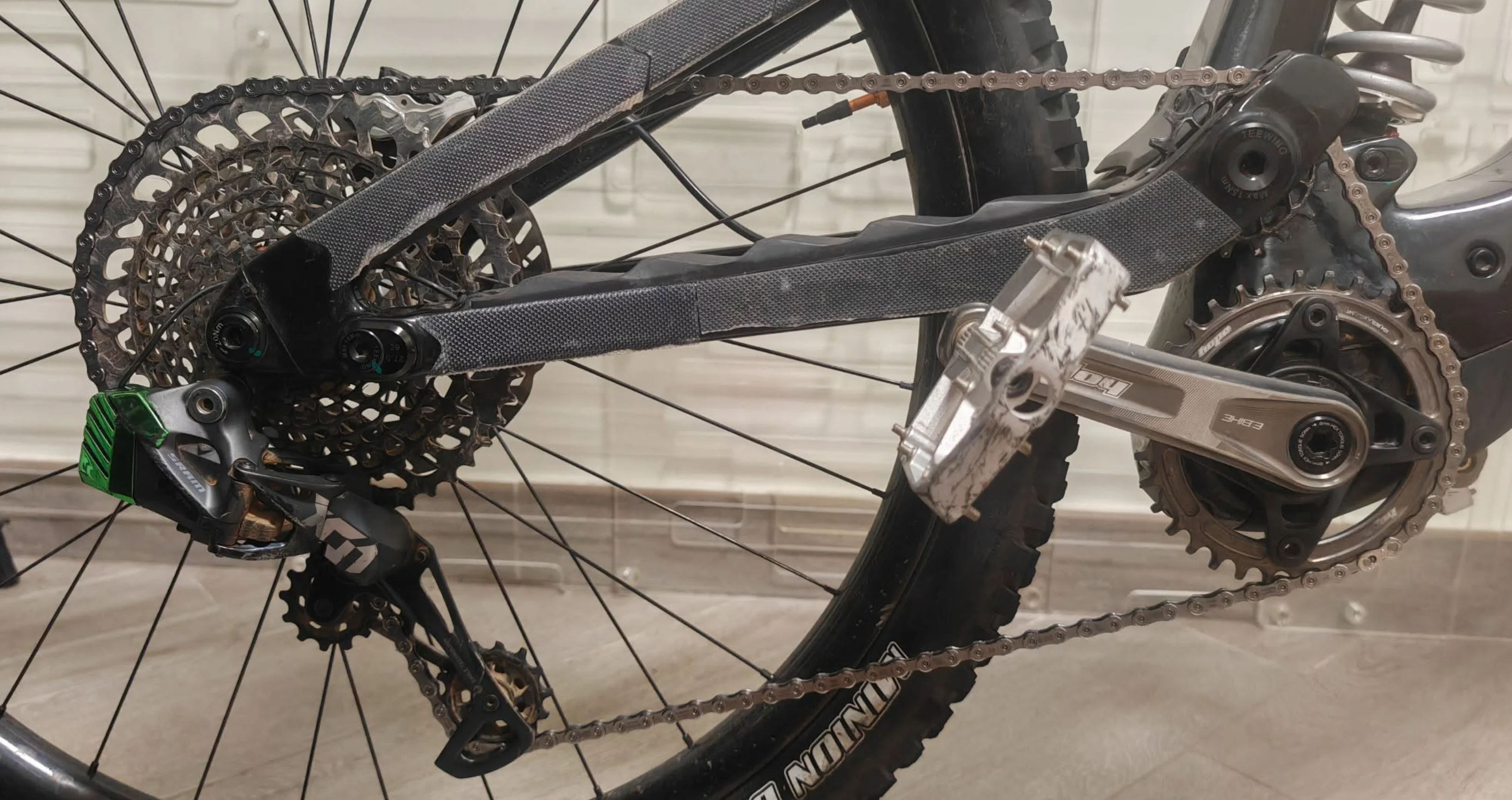

Negative on the chainline misalignment, still out 2-3mm and I don’t think there is anything I can do about it. I have an inquiry in with the Aussie Teewing brand manager so will see what he comes back with.
In other news the chain dropped of the idler today and jammed itself up pretty good. Had to break the chain to get it out. I’ll check my chain length tomorrow, I am running a very well used 11 speed sram unit, maybe the clutch is worn out and let the chain get outta control, still, never dropped a chain on the Spesh Enduro it was installed on before.

I think you need to get your idler alignment looked at Rabbit.

  1. Did the chain fall to the inboard or outboard side of the idler?
  2. If the gap between the idler and surrounding chainstay is unequal on each side, did it fall to the side with the bigger gap or the smaller one (I looked at your pics in an earlier post and it looked like the gap was bigger on the outboard side, but it was tough to tell)?
  3. If I understand the problem correctly, the chainring sits a few MM inboard of the idler (i.e. the chainring has a 55mm chainline, but the idler is more like 57mm+), correct?
If the chain indeed fell inboard, as if it was seeking alignment with the chainring, then, if it were my bike, I'd probably pick up an inexpensive chainring to use on the stock spider, with spacers to get it lined up with the idler, at least until an official solution comes from Teewing.
If the chain fell outboard, and there is indeed a bigger gap between the stay and idler on that side, I'd consider adding some material to supplement the built in rubber frame protection and act as a more comprehensive chain guide to keep it tracking straight onto the idler.
That is very charitable of you to consider that your clutch might be to blame, and more tension is generally better when it comes to keeping chains from derailing, but it seems unlikely to me that it is the root cause. Any slack on the bottom run of chain would need to be translated around either the chainring or cassette in order to generate excess slack at the idler. If the chain fell of the bottom section of the chainring, then then I'd certainly consider the clutch as a potential culprit.
1. Chain fell outboard
2. From memory the gap is fairly equal
3. Yes, Idler sits outside the chainring by a few mm, maybe 3.
Yes, I was very surprised to see the chain come off the idler, it just looks super secure. I dont suspect the idler being slightly off the 55mm chainline would effect holding the chain or not as the chain cross coming from either the low or high gear on the cassette would dwarf that.
And re suggesting the derailluer could of played a part, just want to be as charitable as possible as this could of just been a random one off event and until/if other people start having the same problem it could definitely be some sort of setup issue on my end.

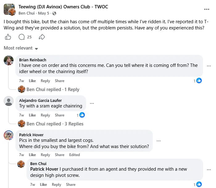

A quick search of FB does show someone having a problem dropping the chain off the idler, according to the OP Teewing sent out a different "high pivot screw" (might be a slight translation problem there).
I will report back if the problem persists :)
