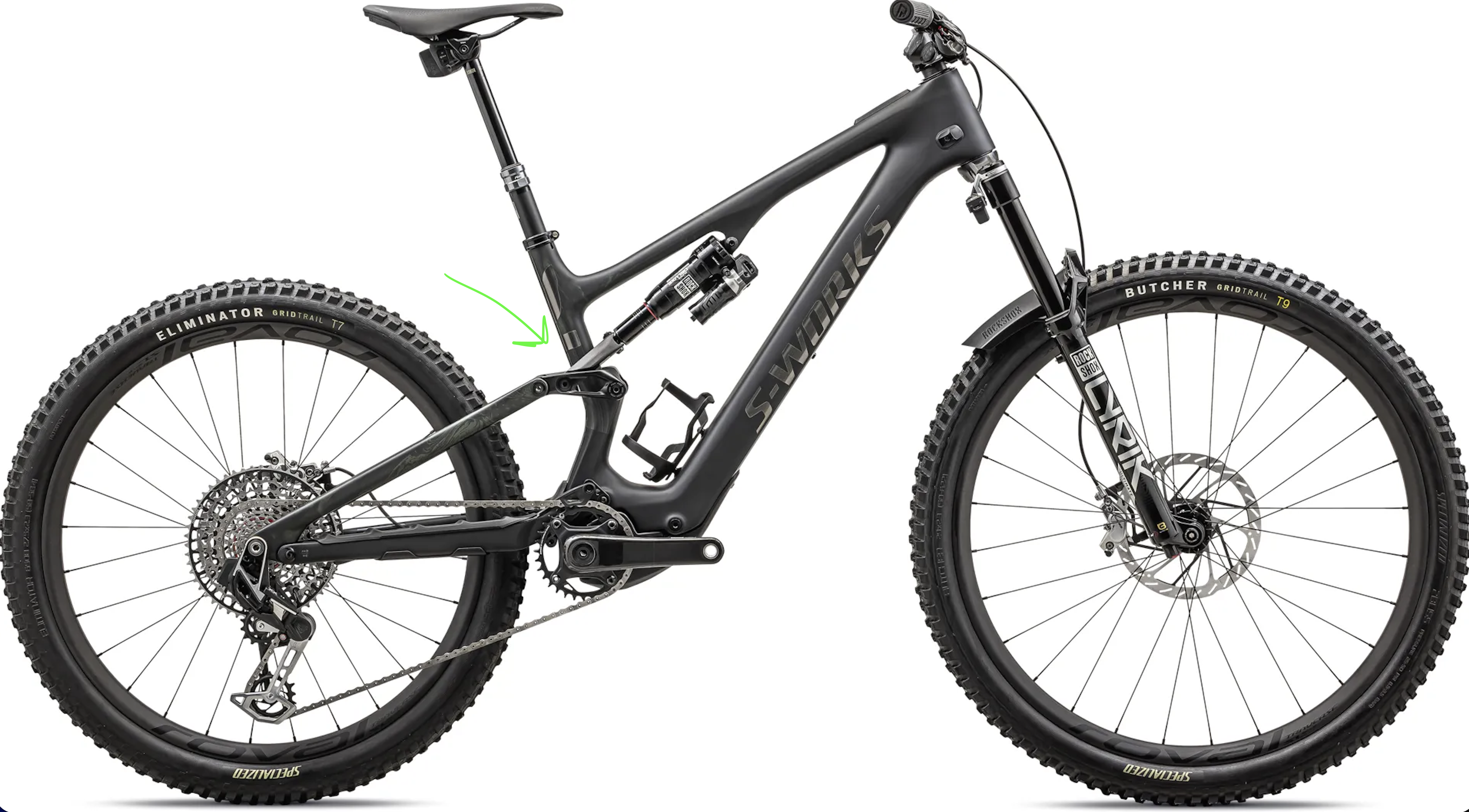

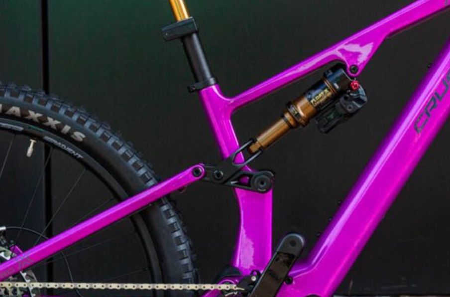

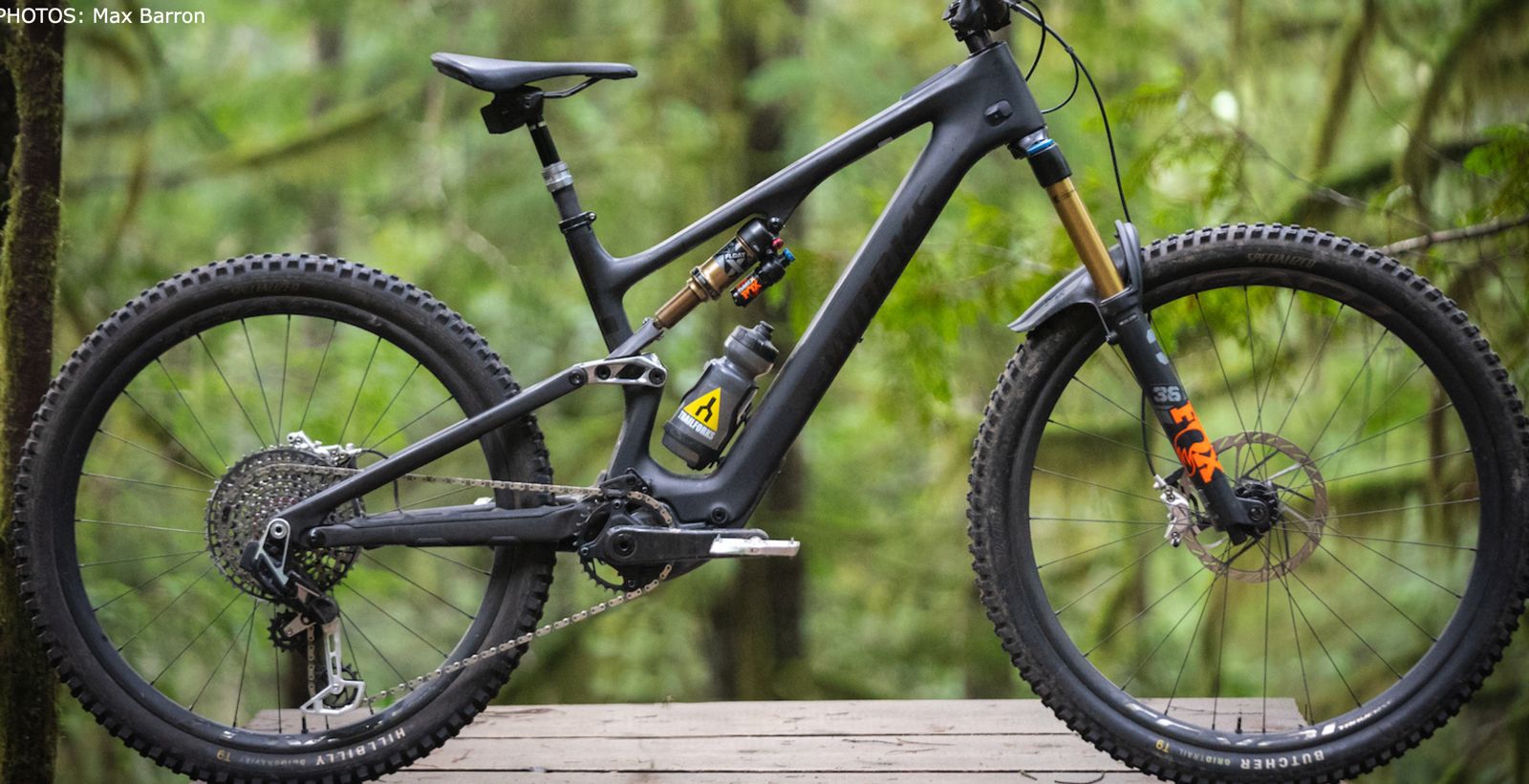

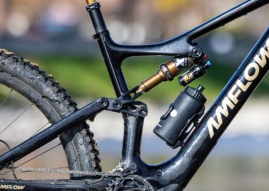

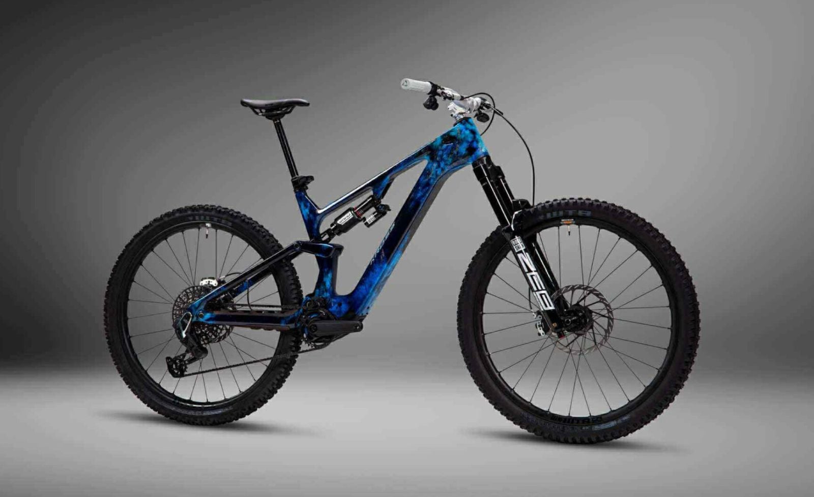

I have a theory, that all these Chinese designed DJI frames have all used this kinked seat tube design because they were heavily influenced by the original Levo SL. These kinked seat tubes limit dropper insertion.
There's no real reason for these kinked seat tubes.... Other than aesthetically looking like the Levo SL
View attachment 173321 View attachment 173322 View attachment 173323 View attachment 173325 View attachment 173324
The design purpose i can see is to allow for a smaller suspension lug, Create more wheel space and also allow room for the seat stay bridge (if it has one) running through the suspension travel range.
Its not just chinese bikes. Its pretty my every bike with that style of suspension pivot location.
Not really. Plenty of similar designs that still manage a straight seat tube.
Designer just needs to spend more time designing.

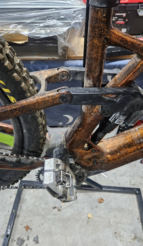

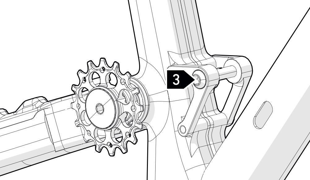

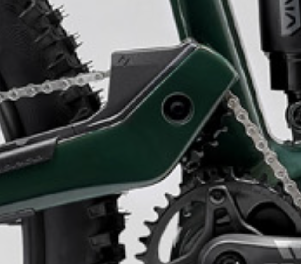

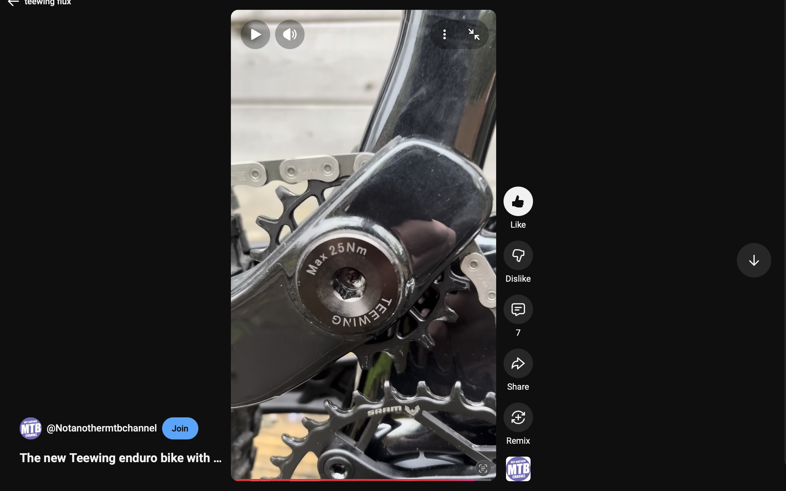

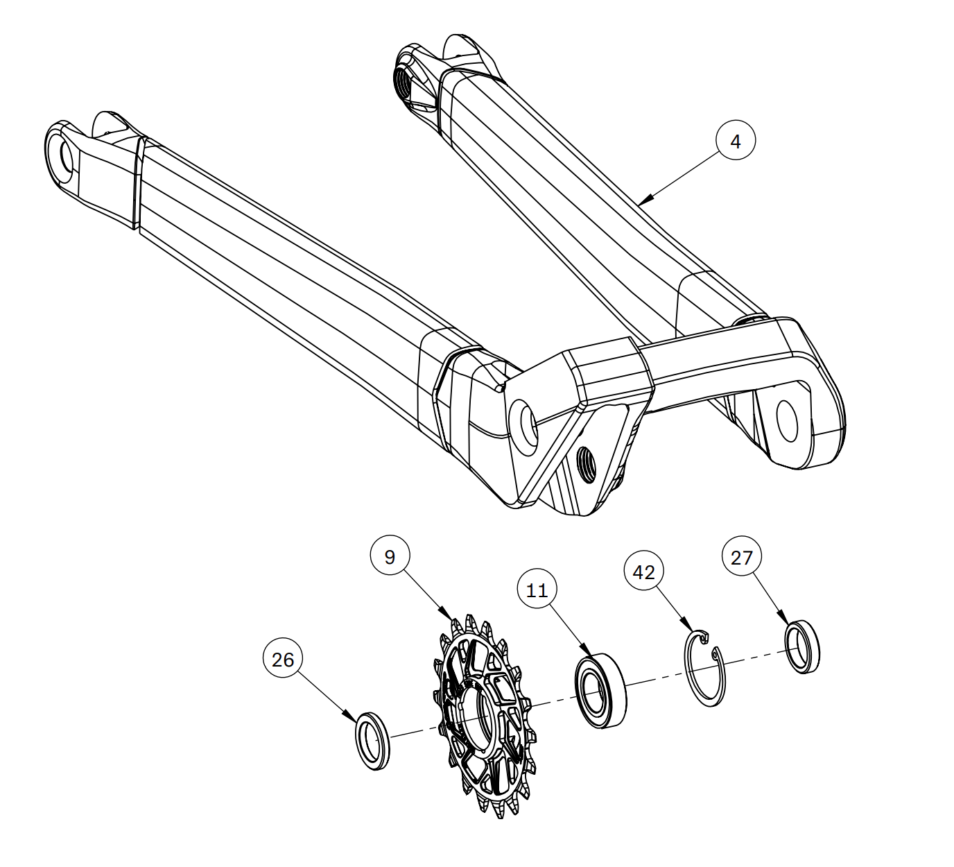

This was discussed earlier in the thread. It looks like the Teewing ripped off the Norco version of the iTrack, where the pulley is imbedded in the swingarm, so it's harder to see that it the idler has its own axle offset from the pivot axle, albeit pretty close to each other. Here is the a diagram of the Norco swingarm that illustrates what I'm talking about.
Technically I haven't really seen the idler close up and on-end, so I wasn't exactly sure if this was the case, but now that the bike sports and iTrack moniker, I guess this confirms it (whether or not Teewing actually licensed it remains to be seen). We need a Rob build out treatment vid to see exactly how the idler is assembled. Until such time, I still think its a complete Norco rip off.
With the Rogue, the distance between idler and pivot locations locations is both greater (since the pivot is fore of the seat tube) and more obvious (mounted external to the swingarm). That's it's an official iTrack design is far more apparent.
Thanks, yeah, after I made that post I went back and caught up on the earlier parts of this thread and saw people had already discussed that exact matter! With the existing pics, it is really tough to tell what is going on there, but it could very well be similar to the Norco setup. With some Chinese brands that mostly sell domestically, I wouldn't put it below them to just slap an i-Track label on to seem more legit, regardless of if they're paying for the patent or if the patent even applies to the design, but Teewing seems like they're pretty serious about making a real go of it in the international market...which means it's most likely a Norco ripoff. I know some people will hate on them for that, but the Norco designs are pretty dialed, so I can't really blame them for taking a lot of "inspiration" from a market leader. I actually wouldn't have minded if they took a little more inspiration from Norco in regard to that seat tube kink/insertion depth that everyone else is discussing! The Norco still has a big advantage in that regard.

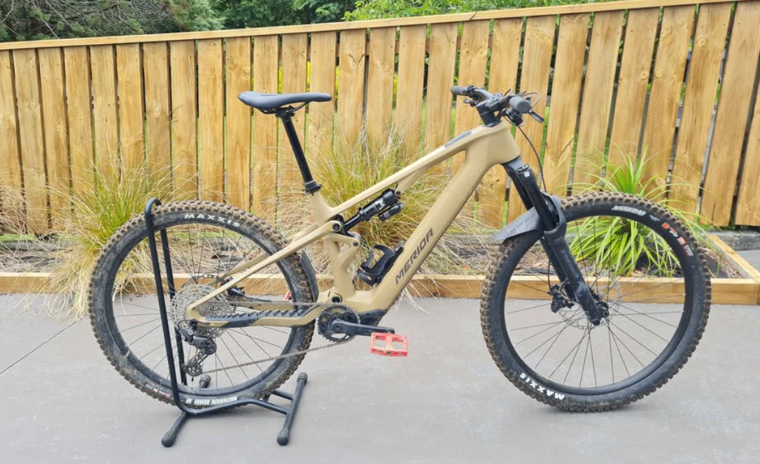

But aren't they compensating for the shorter suspension link, by running a bigger shock ? The bent post makes room for the longer suspension link. Thus allowing for a shorter shock without reducing travel?

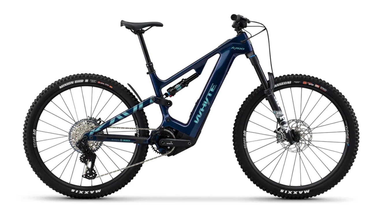

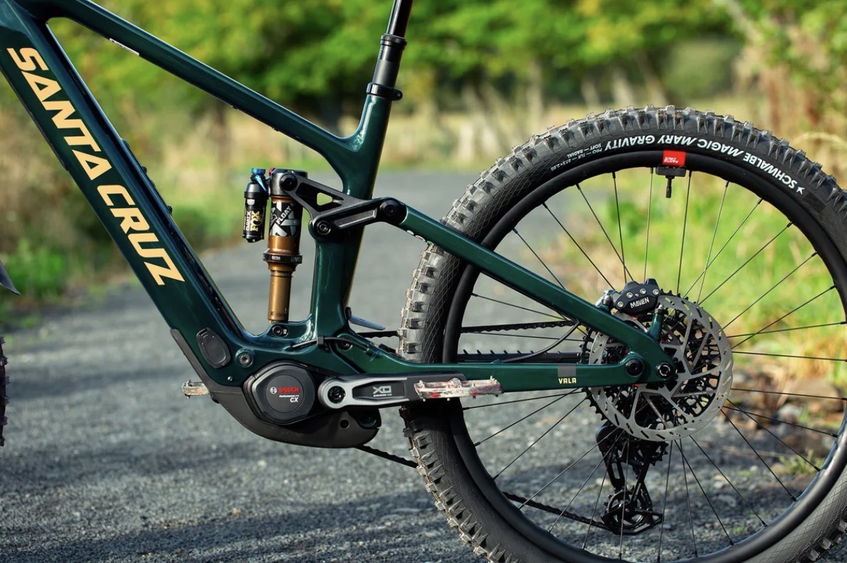

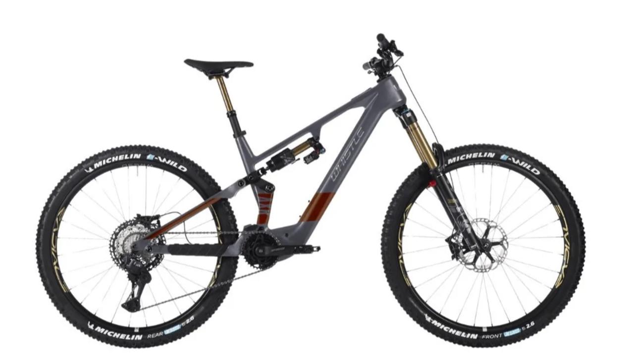

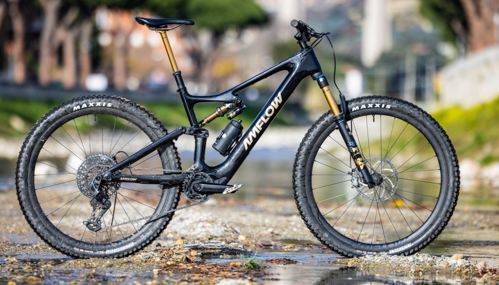

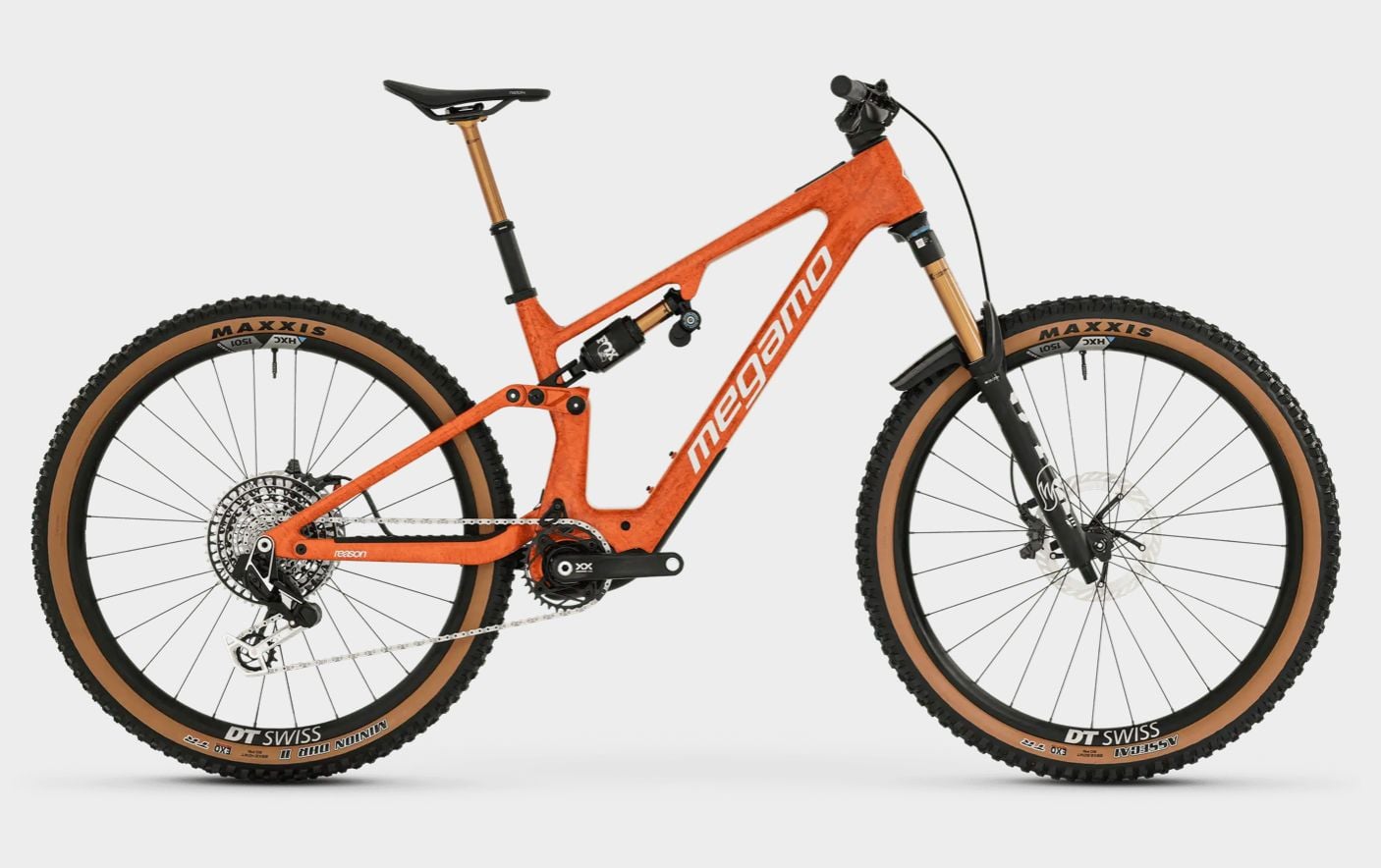

Look att Orbea wild, Rocky Mountain Instinct, Santa Cruz Vala / Bullit among others. There is plenty of bikes with straight Seat tube's. That takes a long dropper.
Nice looking rig this and l seem to think it supports a 205 x65 shock not sure though on a Trunnion mount.... but if so wondering wether downtube clearance prevails enough for the Ohlins coil.... Gotta watch this space....
Look closely and you see the straight seat tube crowd using different pivot locations. The top pivot location drives the seat tube design to a degree. Then esthetic design comes into play.. Do they run a big ugly lug like the marida or bend for a more pleasing visual look?

I reckon they could of got a straight seat tube in their design but i'm guessing that kinked seat tube is in their design language, for better or for worse.
And re the i-track question, this is a quote from @iamandisykes post 'The first thing that grabs your attention is the patented i-Track high-pivot idler suspension layout. High-pivot bikes aren’t new, but Teewing’s execution definitely stands out."

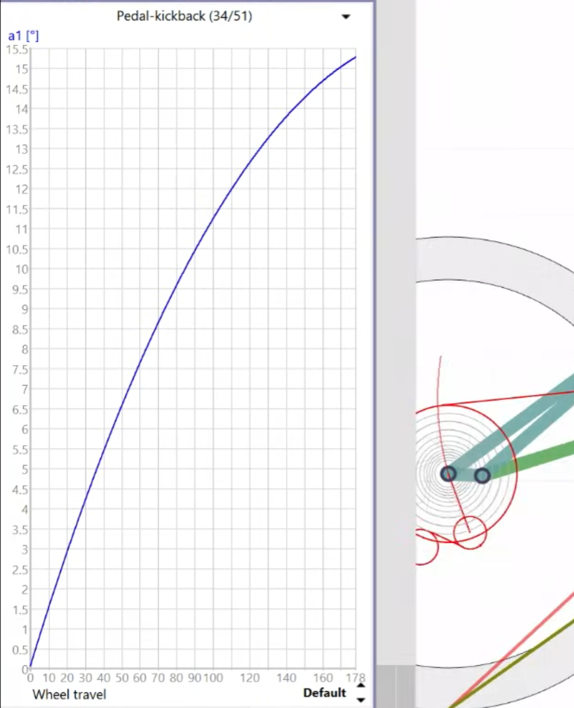

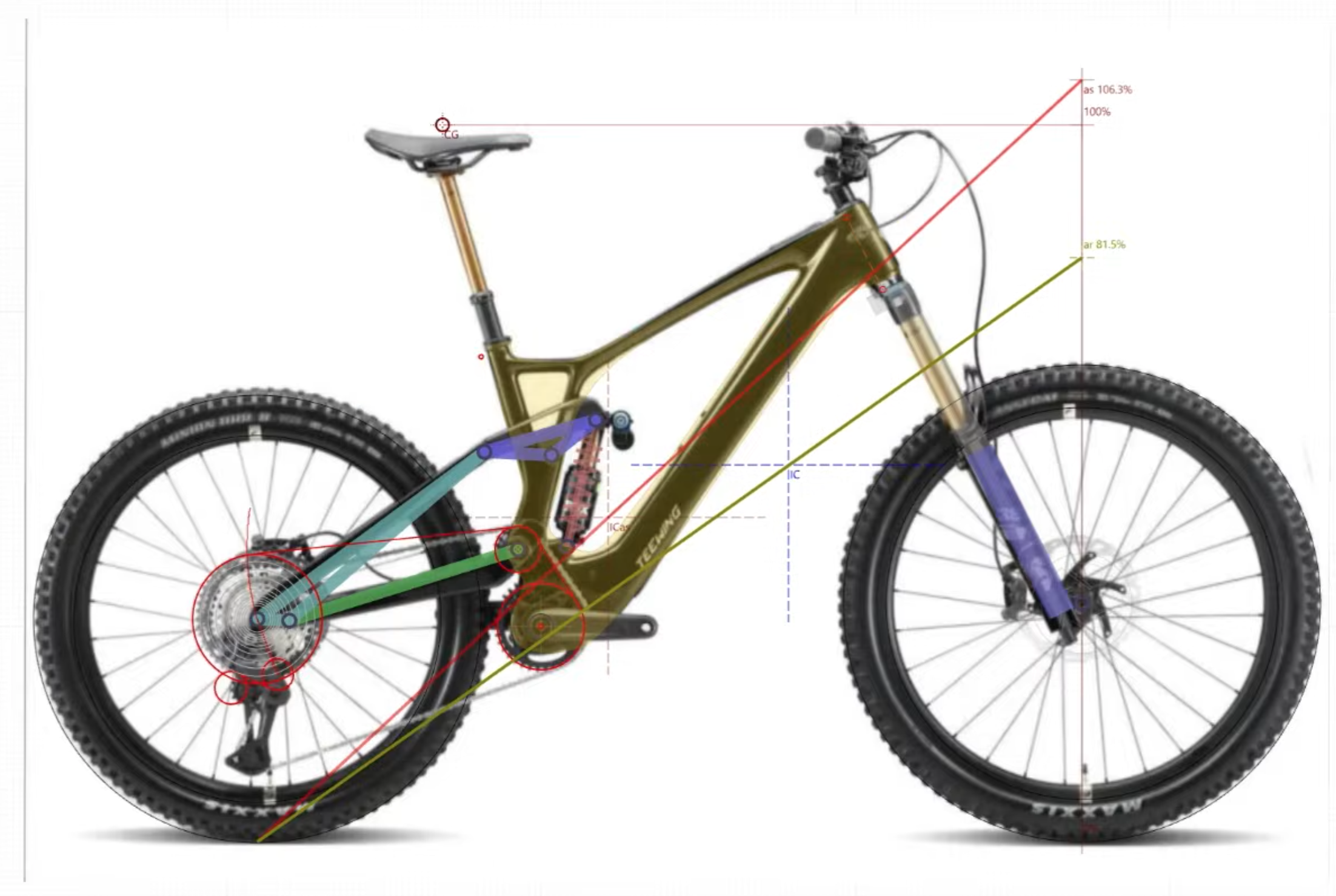

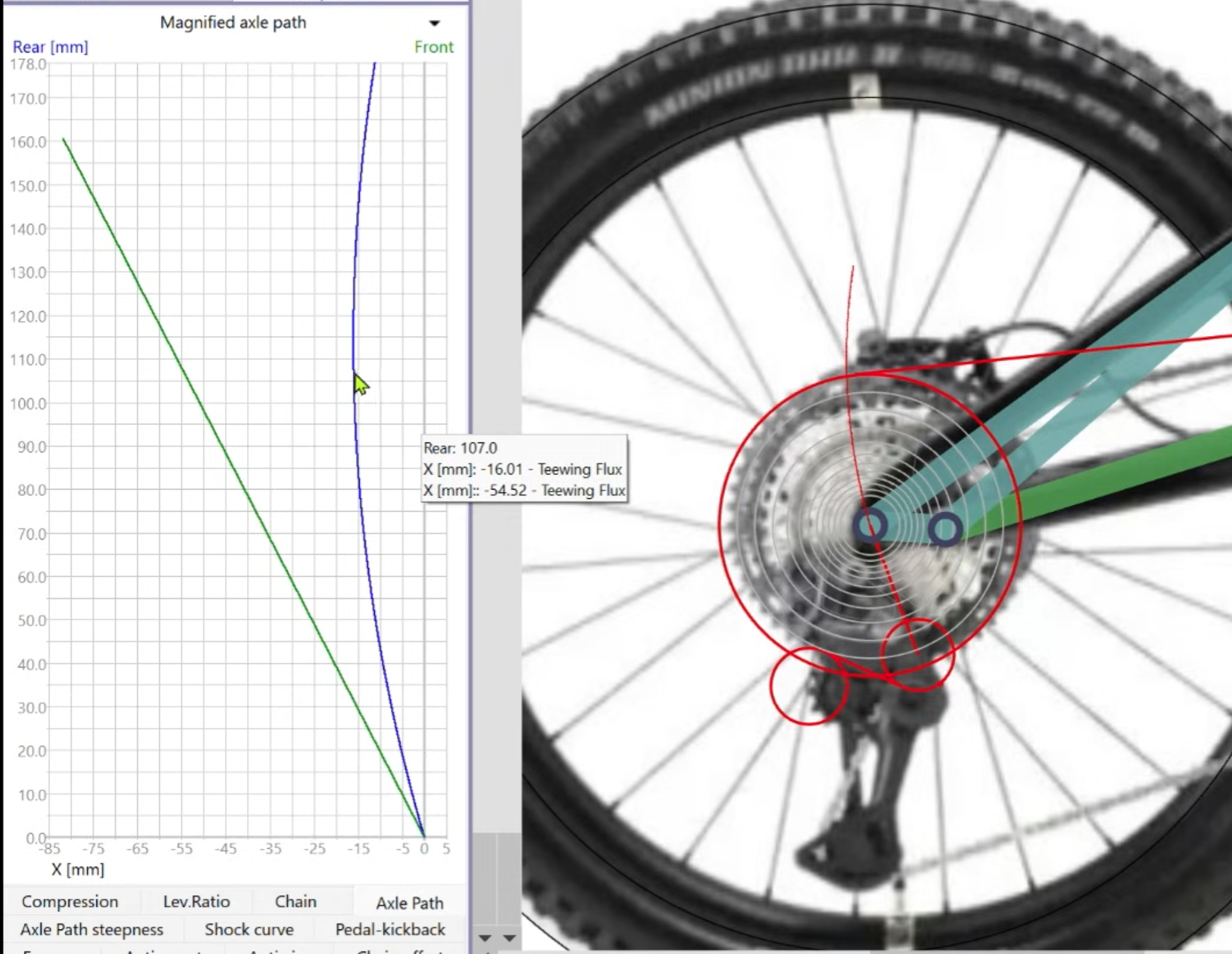

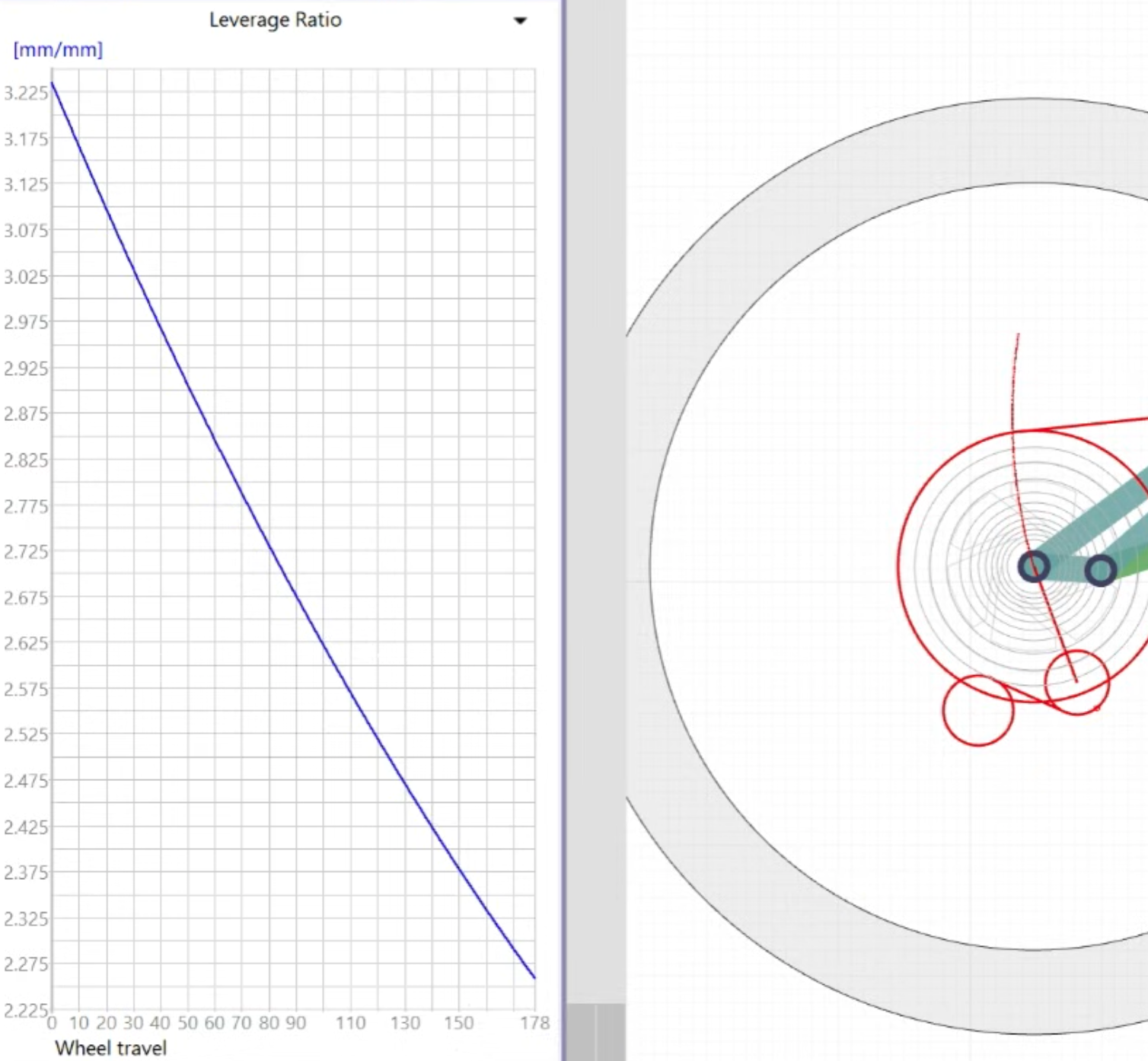

AFAIK, Teewing has not released kinematic graphs, so this video is a good proxy. What's not exactly clear from the video was if the graphs were being expressed while in 170mm flip chip config. The wheels look mixed but as mentioned before running MX with 170mm may be preferable, and I think the vidcaster agrees. And the free-body looks like he tried to model with the shorter CS, but he did didn't demonstrate it in 180mm mode [Edit: backing off this claim since I haven't used the software, and he may have been modeling something else.]. I suspect the 180mm mode will produce exaggerated kinematics, but really these graphs should come from Teewing. I took the liberty to snapshot a few the kinematics graphs here below:
Axle path
Leverage ratio: progressive and assumed to be in progressive mode
Anti Squat and Rise without sag: was a challenge to get this snap since most of the video was describing these under sag. It was need to see how dynamics of travel and chain ring can change AS.
Pedal kickback: Should only be compared to other bikes with similar sprocket sizes and to a lesser degree chainring sizes. Very interesting demonstration regarding how the idler really knocks this back in the smaller chainring sizes.
