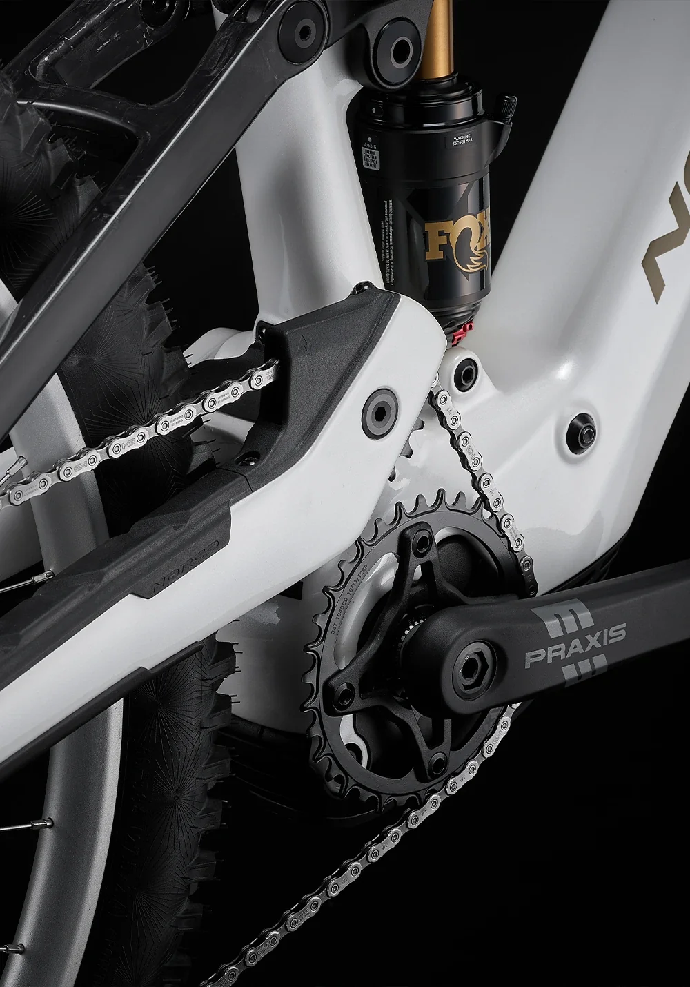

Yeah, tough to say. If I end up with a Flux, I was thinking of trying to rig up a little chain guide similar to what Norco uses on their Range CX, which many people speculated was the bike that heavily "inspired" the Flux. It would have been nice if Teewing had let that inspiration continue right through to the guide, rather than stopping with just the frame itself! Here is a close-up pic of what Norco is doing, and you can see how the whole top side of the pulley is completely shrouded, so if they've designed the internal dimensions properly, there should be nearly no leeway allowing the chain to misbehave.
I inquired with my local shop on getting one of those covers, I reckon it’ll fit with a bit of dremel action. But they are out of stock till end of the year. But if someone who has access to one wants to try I’d be interested!

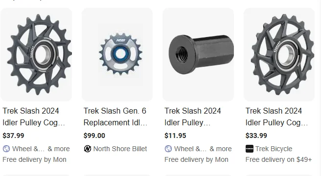

Wow, that's great you were already thinking of adding a guide, and I hope you are able to get your hands on one! In your other post, you mentioned the issues with the Slash dropping chains. Some of the drops on the Slash were related to backpedaling, and the acute angle between the lower pulley and the derailleur when shifted to the largest cog. On the Slash+ that was less of a concern since the chain doesn't run backwards when backpedaling on the ebike. Those bikes also dropped the chain off the upper pulley, despite using a little guide, and Trek issued an updated pulley with longer teeth that was supposed to help. Since they use a 19t upper pulley, they are unable to use a narrow-wide profile on the teeth, but I'm sure the longer teeth were a lot better as the original ones were almost comically small. I believe the original one is on the right of this pic, and the updated one is on the left:
Norco doesn't use a narrow-wide profile, unless they've had a running update that I'm unaware of, but despite that I could find no mentions of dropped chains. Since their pulley is 18t there is nothing stopping them from going narrow-wide, which the aftermarket North Shore Billet pulleys have done, so I can only imagine Norco is already pretty confident in the guide's security.
