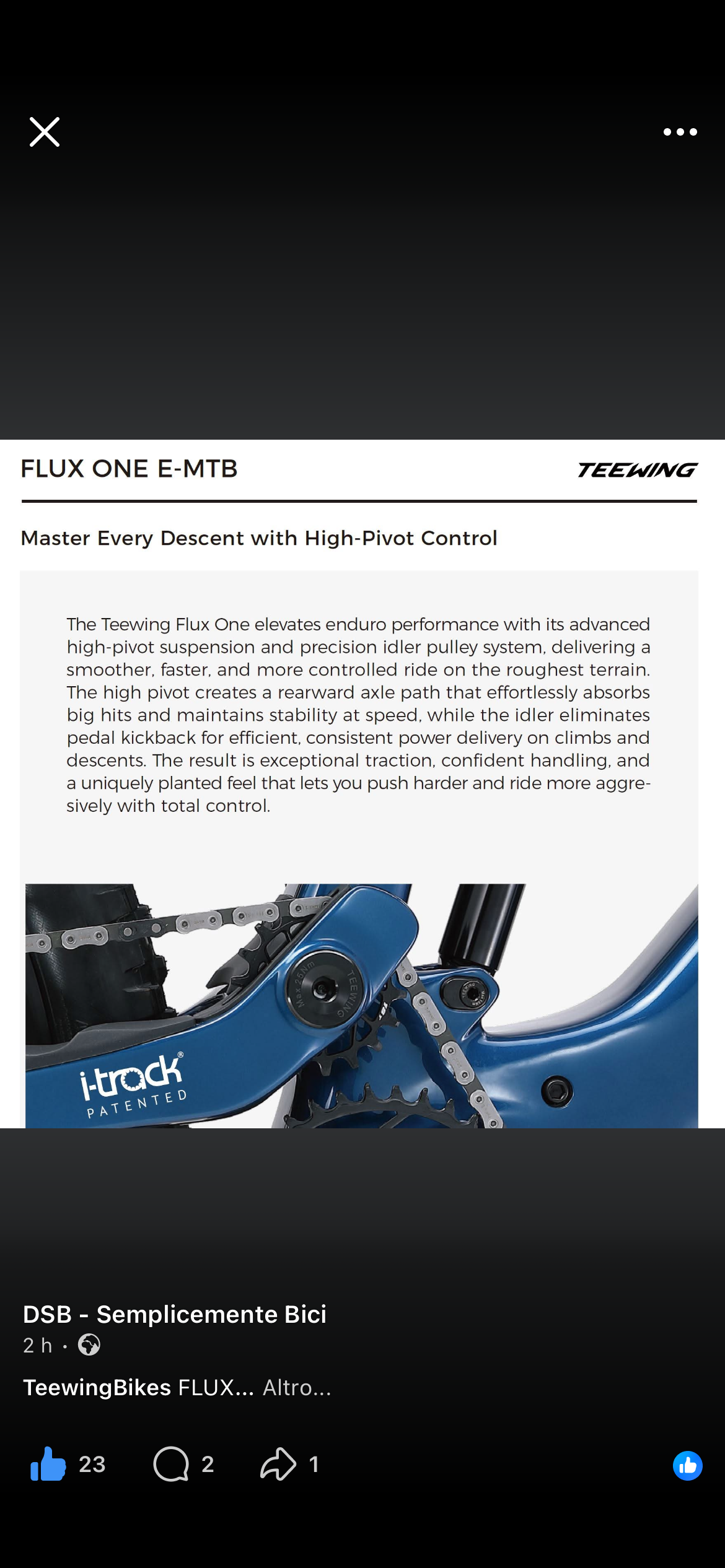

And re the i-track question, this is a quote from @iamandisykes post 'The first thing that grabs your attention is the patented i-Track high-pivot idler suspension layout. High-pivot bikes aren’t new, but Teewing’s execution definitely stands out."
Hi, so at the time of writing the first look and my video there were discussions between Teewing and iTrack about the design and I was informed at that time an iTrack patent would be applied to the bike (although I did find it odd as the idler isn't moving and is inline with the main pivot). Turns out the iTrack patent won't be applied to this bike due to the idler location. Hope that clears this up

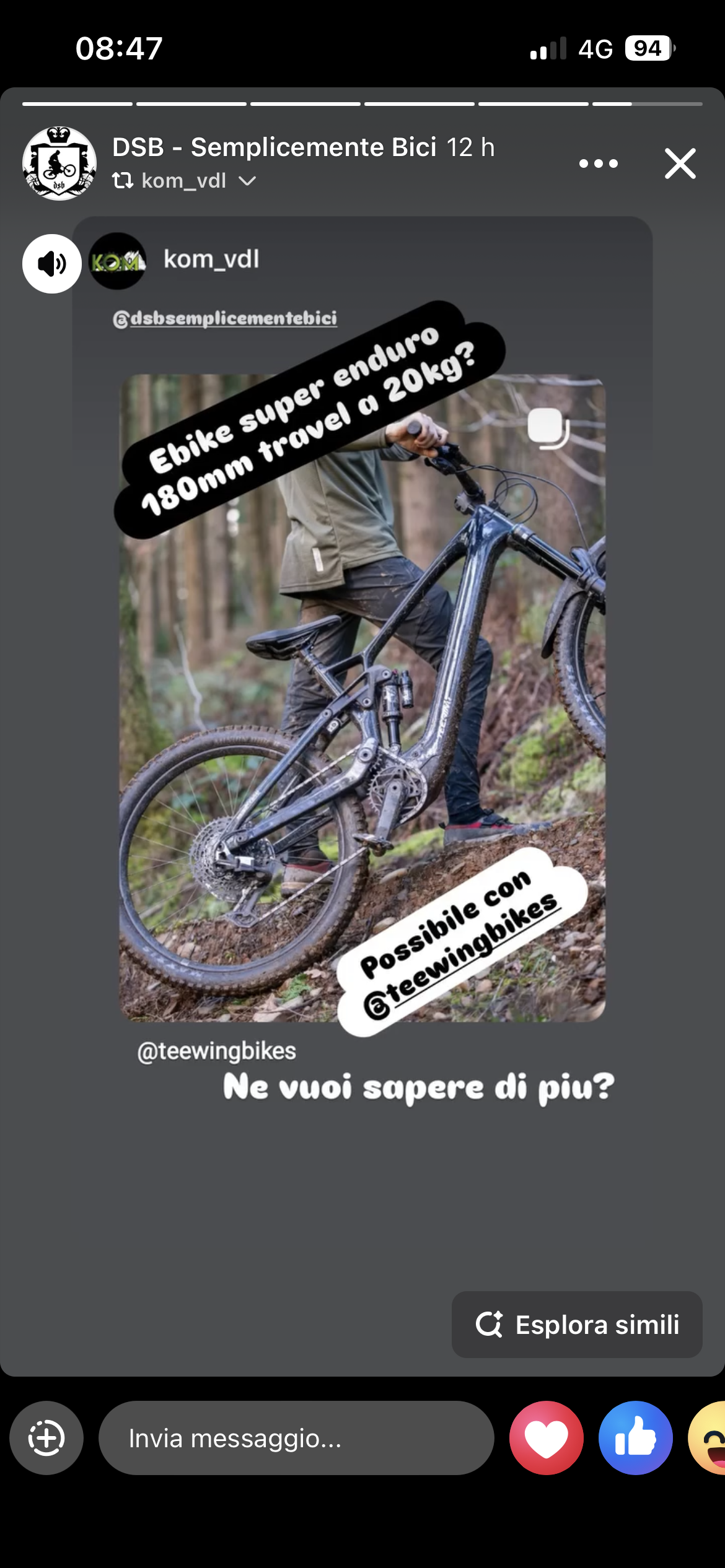

With 600 Wh battery maybe…..
In these days we’ve seen online Velduro with an extender….
If DJI comes out with 600 Wh and 250 Wh extender, this Flux is going to be a dream bike….
Even with a 600WH battery I don't think you are going to get the flux down to 20kg? I would be pushing to get my Turbo Force down to 20kg.
I agree. The only time your get a full power mid pivot 180mm ebike with a 600wh battery to 20kg is if it was built light with trail parts for a light rider. At that point you have compromised performance for weight. I'm all in for light weight until is compromised performance. Whats the point having a 180mm bike that cant do 180mm features because the tires are too thin and the wheels are too weak?
Agreed but it could well be a lighter frame than the Velduro which I think is 3.5kg, maybe a 2.8-3kg frame?
Hey everyone, Hugh McLeay here from i-track suspension.
It seems there is some confusion here whether or not the Teewing Flux uses i-track suspension, so I thought I should clear things up directly.
Late last year, Teewing was under the impression that they required a license agreement for their Flux design, and did the right thing in reaching out to secure it, and obtain graphics for the bike. This was before I had seen the design. Within about a week, I saw lots of leaked photos/videos of the Flux, and started to wonder whether the idler was concentric, rather than offset like other i-track designs. I reached out to Teewing about the specific position of the idler pulley, and they confirmed that it was concentric with the main pivot. Therefore, they didn't need a license agreement after all. Unforturnately in that short space of time, Teewing had released quite a bit of material regarding 'i-track' being used in their design, which they've tried to quickly undo afterwards.
On the Teewing Flux, the idler is concentric with the main pivot. This means that the idler pulley is effectively 'static' and does not move with the suspension (it's the same as if the idler was mounted to anywhere static on the front triangle, like many other high-pivot designs).
Both the Norco and Velduro designs have the idler pulley offset from the main pivot. This means the idler pulley moves with the chainstay as the suspension moves, which generates some additional anti-squat. The designers choose the idler position carefully to achieve the anti-squat characteristics that they're after. On the Teewing Flux, the anti-squat will be considerably lower which may impact the ride characteristics.
Hope that helps to clear things up.
Cheers,
Hugh.
Key Technical Difference In i-Track (as in Norco or Velduro), the tension pulley is offset from the main pivot, so it rotates and adjusts the chain during suspension compression. This creates a mechanical effect that counteracts squat (rear compression due to acceleration/pedaling), optimizing the efficiency of the Avinox motor (up to 120 Nm of torque). In the Teewing Flux, the pulley is concentric with the pivot: it remains static relative to the front triangle, similar to basic high-pivot designs. Mathematically, anti-squat is reduced because there is no relative movement of the pulley; The force curve is calculated as follows: "See attached image" Electromechanical Implications: Less anti-squat: The Flux will experience more squat under the Avinox's torque, potentially affecting traction on technical climbs and energy efficiency (greater demand on the BMS and integrated 800 Wh battery). Riding feel: More "floaty" downhill (up to 178 mm travel), but less planted while pedaling; ideal for pure enduro, not XC. Design advantages: Simplifies manufacturing (no patents), reduces chain/motor wear and costs, but sacrifices kinematic tuning.
Now that the great iTrack mystery has been put to rest (it looks so much like the VLT, but really is faux), we can put the responsibility back on Teewing to give us kinematic graphs, please. And while this AI slop post is partially correct, it makes assumptions about where Anti-Squat is at the sag point and forgets that AS is largely advanced by main pivot height. iTrack gives and extra degree of freedom to tune AS, which becomes more of an issue as HP location drift downward to and past the midpoint. In general, as motors get more powerful, how the bike behaves under power will be more driven on getting that AS tuned just right.
