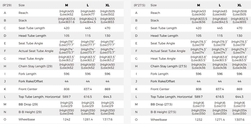

Its 452mm according to my tape measure that's static. I have a geo chart but I need to check over it properly as some numbers don't make sense. I've also been told an updated idler has already been developed, I think it should be with me today.

Will draw Rogue comparisons for sure as both are Horst link HPs. Will need kinematic graphs and geo forthwith. Bash guard solution needed. Because of aft chainstay pivot location, I wouldn't be surprised if this is mixed-wheel-only. Seat-tube angle looks slacker and design looks to limit seat insertion depth compared to the Rogue.
It's either 170/180mm 29/29 or Mullet, 178/180mm. flip chips plus geo chip on lower shock mount. Hi/LO

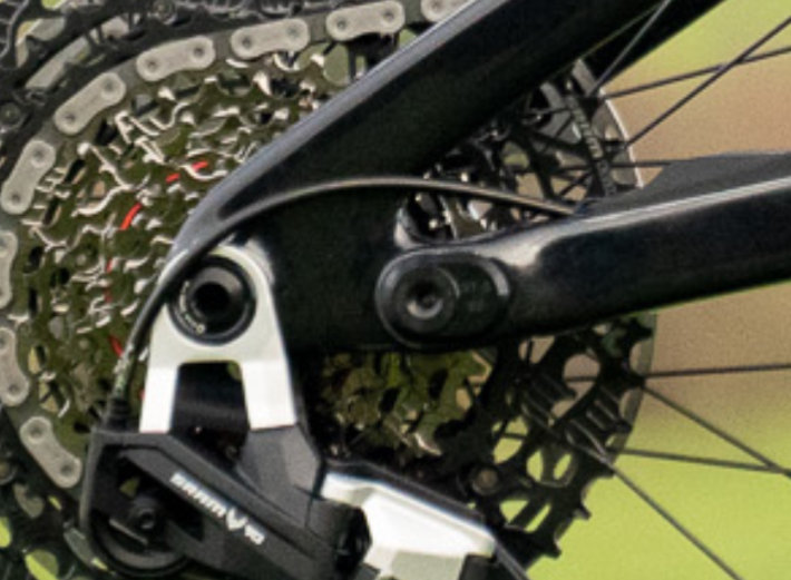

Is it just me or are those pretty short chainstays in the mullet setup? I’m not any expert on geo but have at least been familiarizing myself with the normal ranges you see on most frames and those stick out to me as being pretty short. Does the high pivot offset it in some way?
probably rear center and not cs. cs should be exactly the same length, or is there a flip chip on the cs?

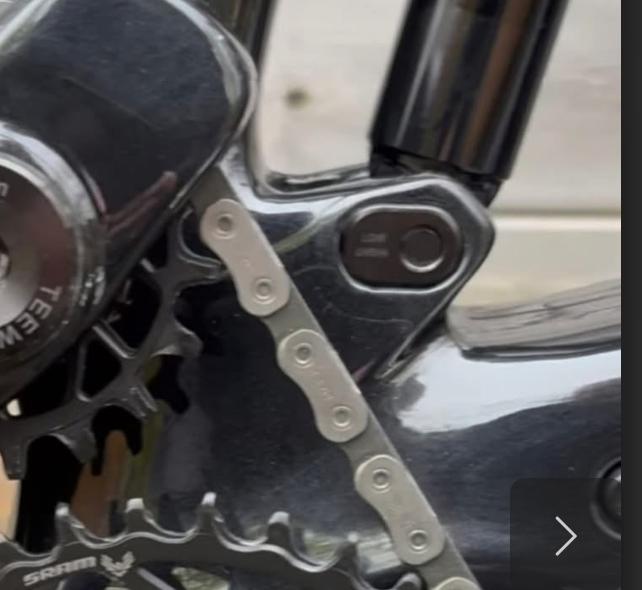

is there another flip chip?
this is the only adjustment on the frame i could spot so far
then it’s really shorter and causes the bb to be higher because the seat stay stays at the same length. strange design decision, the velduro location in the seat stay makes more sense

Man, the chainstay length takes a hit in the 27.5 mode, not an issue for those running 29er but.
I dont remember seeing another frame with a 27.5/29 flip chip in this location, is it very common? I cant even properly visualize how it would compensate for the BB height.
You could run the 27.5 with the flip chip giving the longer chainstay. But you don't gain the extra travel and you are lowering BB height. But you could then just run the shock flip chip in the high position.

You get more travel and more rearward hit compliance, but a price will be paid. Without the kinematic graphs, I would suspect the MX setup to have wild large rearward axle path, exaggerating the ride handling dynamics in the curves. You are gonna have to really like spirited HP handling here. Sag settings and shock tuning will be a tedious affair.
With the E-Druid, the bike already has long chainstays which IMO, tamps down some negative aspects of HP dynamics. With the Rogue, it tames things by having a longer pivot arm (mounted fore of the headtube) while keeping the rear-center geometrically more conventional.
I doubt Rob would take to this bike, especially in MX setting, as an XL Front Center is literally twice the length as the Rear Center. Not to mention the dude is just not a fan of short chainstays in general.
There is some experimentation that can be done. But I would definitely run the MX setup.
Started to think the same thing about just sticking with 29 setting for MX. It will also reduce reach and slacken seat tube / head tube angles as well and also give more mud clearance. The MX setting, OTOH, is a bit beyond the pale - again Kinematic graphs will be telltale.
the kenevo sl has one there too

What I was saying was, I don’t think I’ve seen a flip chip in that position that is specifically to change wheel sizes.
