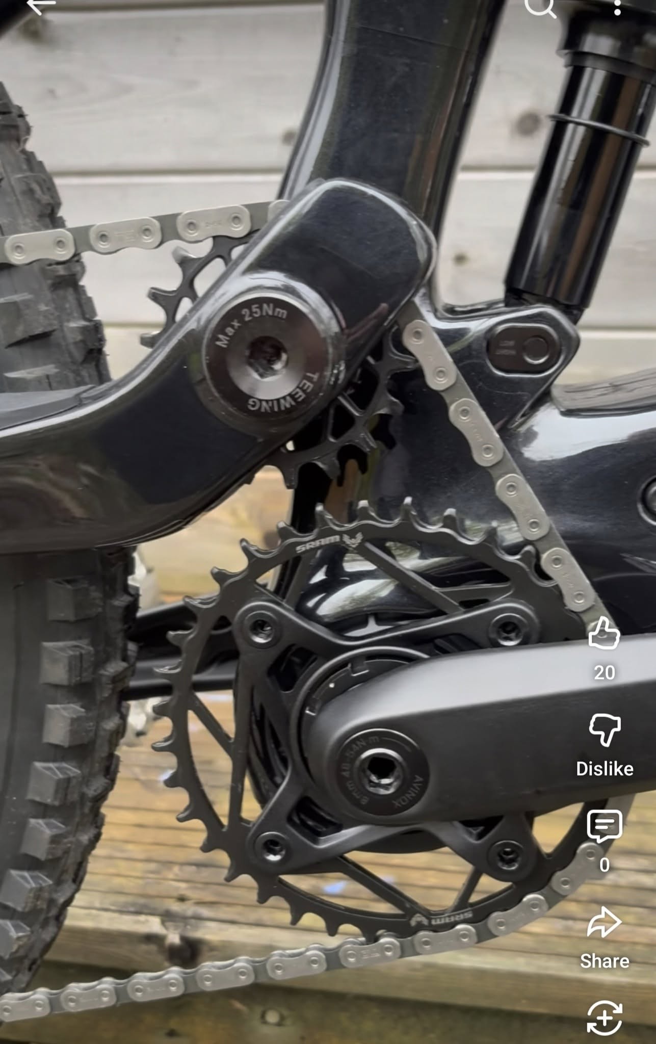

Trying to verify if this frame indeed has an i-Track idler as the article specified. Can't quite see where the CS pivot is relative to idler - looks to be the same, but again need closer inspection. It's hard to ferret out truth from AI slop.

Looks very similar to the Norco I-track setup, especially how the pulley is attached to the chainstay.
Would be very surprised if it wasn’t i-track. Keep us posted :)
Agree that it looks like the Norco, but at least Norco is licensing i-track. But have to admit that just looking afar at these bikes that idler is seems exactly aligned with the CS pivot, if not sharing the same shaft (i.e. idler location is static in relation to chainring). This seems to invalidate the whole point of i-Track, where the idler is meant to be on the chainstay aft of the rotating CS pivot . With the Rogue, it pretty clear its done this way because the CS pivot is fore of the seat tube and idler aft of it - i.e. the idler's location moves with the CS, so it's location is dynamic in reference to the chainring.

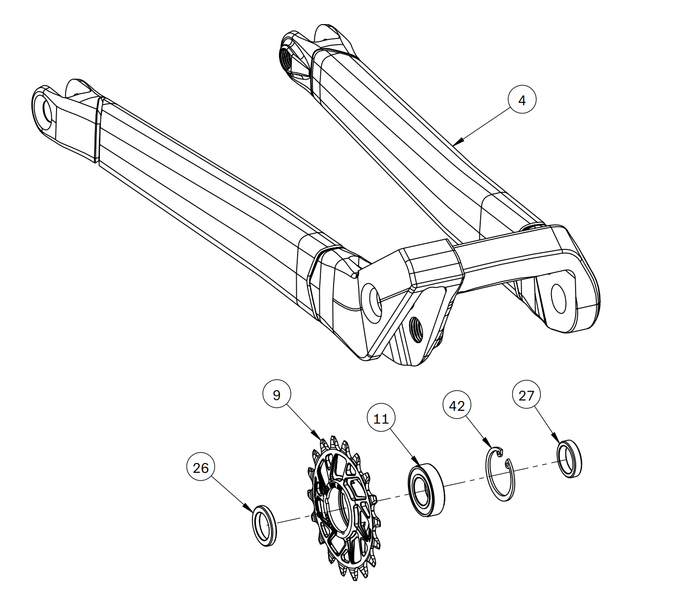

Edit: The Norco at least does not have the idler sharing the CS pivot shaft - can be seen to be located mostly higher and slightly aft of the pivot, per snapshot of Norco parts diagram below:
The Flux may will have a similar setup, but really need to see some better photos or any parts diagrams.

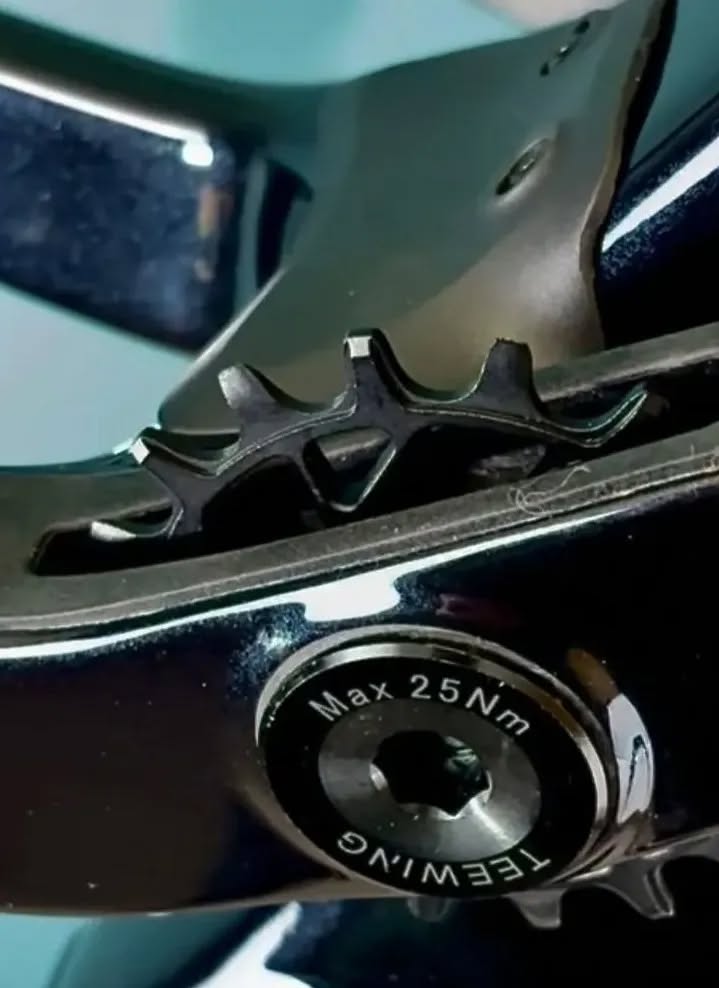

Here is s close up picture, looks like it is (if I understand i-track) the idler is on the pivot.
afaik idler on the pivot location is NOT i-track, i-track idler sit on the seatstay. see the kavenz, they have it on the same location, which does not interfere with the i-track patent. source: their videos about the development process.
