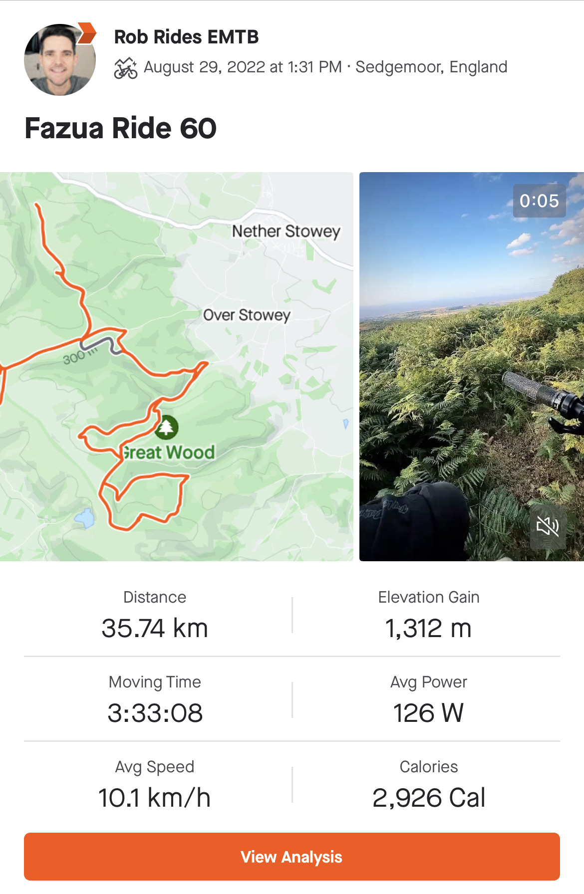

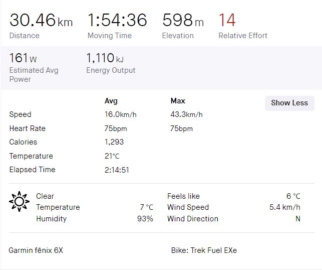

Although I have no doubts about Rob's testing in relation to meters climbed compared to the Fazua, to be fair, they were completely different rides.
Agree. But the range is similar across 3-4 rides, I just dug those out as they were the ones I found in my strava.
I only really ride in Turbo mode on light weight bikes, personal preference, but I like making boring bits / hills as fast as possible. I only ever get approx 750 metres of elevation on the Trek EXe. Side note, the test area in the Quantock Hills consists of big, long hill grinds. The start of the ride is a 250 metre ascent to the top
The Fazua was always over 1000 metres. Lowest was 1038 metres, highest approx 1350 ish metres.

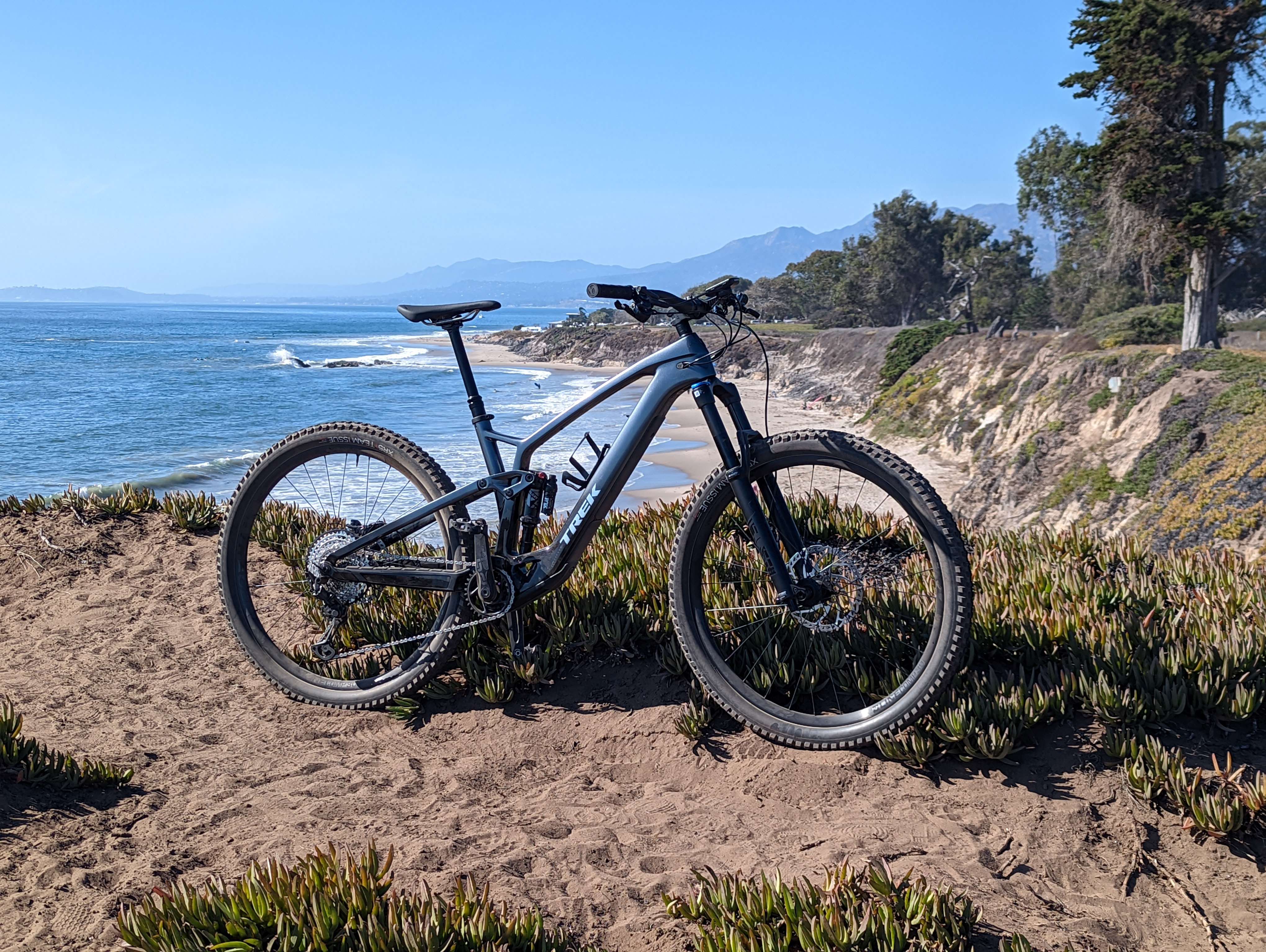

Procured on Saturday. Took it right home and proceeded to see how well the dealer built it. The answer...not as good as they should. Rode it 12 miles that afternoon just to feel it out. I bought it to be able to work harder and find that the low mode was far better than expected.
Yesterday took it out for about 15 miles with about 1500 feet of climbing, again mostly on low mode, and its pretty fantastic. Rode it with the motor off a bit and was really impressed as well. The first minute or two when cold going up a slight grade there was some very faint clicks or hitches in the drivetrain. It went away and was dead quiet and smooth the rest of the ride. Finished with about 55% battery so quite happy with that as well.
One thing I did notice is how much shifting you have to do to keep the cadence within reason. Coming off a 34-45 and onto a 32-51 with another gear you are really whacking away on the shifter.
So..... Shimano brakes are good. Tires are not bad with the pressure down a few pounds. Stock seat was not as bad as I thought it would be. What does it weigh? who cares?
Such a widely different experience from my Decoy. Especially when I have to get it on and off the bike rack.
Much to learn.

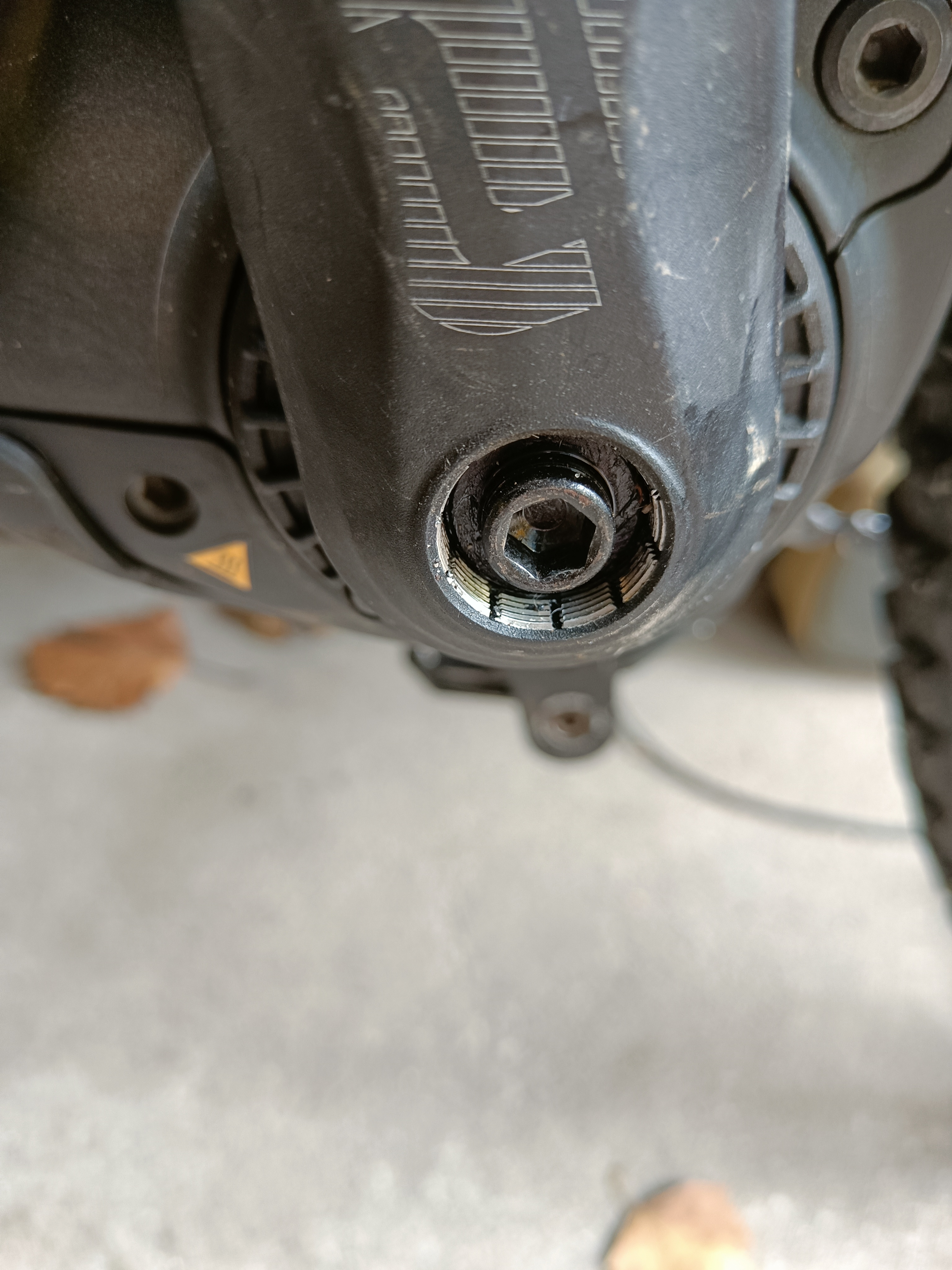

I lost this ring last weekend. Anybody knows what kind of ring this is and how to lock it?
Will call the shop too, but they are closed on Monday......

The average speed of the tq ride is 50% faster than the fazua ride, that would drain the battery on the tq quicker for every meter of height gained,wouldn't it
Although I have no doubts about Rob's testing in relation to meters climbed compared to the Fazua, to be fair, they were completely different rides. A real comparison would be the same climb back to back with the two bike systems. As a third comparison, below is my ride from yesterday on my exe. There was a lot of flat bitumen on this ride hence the decent average speed but I didn't need to work particularly hard (as seen by my heart rate) to achieve close to 60km and 674 metres of elevation. Again a completely different type of ride (80% paved, 20% dirt)
Looking at the efficiency specs of both motors, the TQ is rated at greater then 90% and the Ride 60 at approx 80%. based on this the TQ is rated at 324Whr to crank and the Ride 60 360 Whr to the crank. This gives the Ride 60 a 10% advantage.
I think bottom line, no one should be disappointed with either one of these systems. No doubt we are in a golden age of ebikes.
Your elevation gain is only 51’ of elevation per mile. Have you tried a big mountain ride, with more elevation gain per distance traveled? I think you would be a little surprised at the increase in discrepancy. I have zero regrets on my EXe purchase, but they really dropped the ball on the range capabilities. My wife’s Specialized Turbo Levo SL gets very similar range to my EXe. My Rise had noticeably more range than the EXe with the same size, 360 w battery. I’ve tested all three bikes. This is a real world comparison. My elevation gains on my testing trails is about 150’ per mile, so triple the elevation gain.
I guess that is the thing with testing range, we all have different experiences. Either way, my EXe having capabilities of 20 miles with 3,000’ elevation is plenty. That is about 40 % more distance than my full pedal MTB’s, in the same amount of time. I’ll take that all day. I ride by myself 98% of the time. I have no need to keep up with others.
Extractor- The usually have some Loctite on them to keep from rattling out. Don't really need it but its handy when you have to pull the crank arm without a special tool.

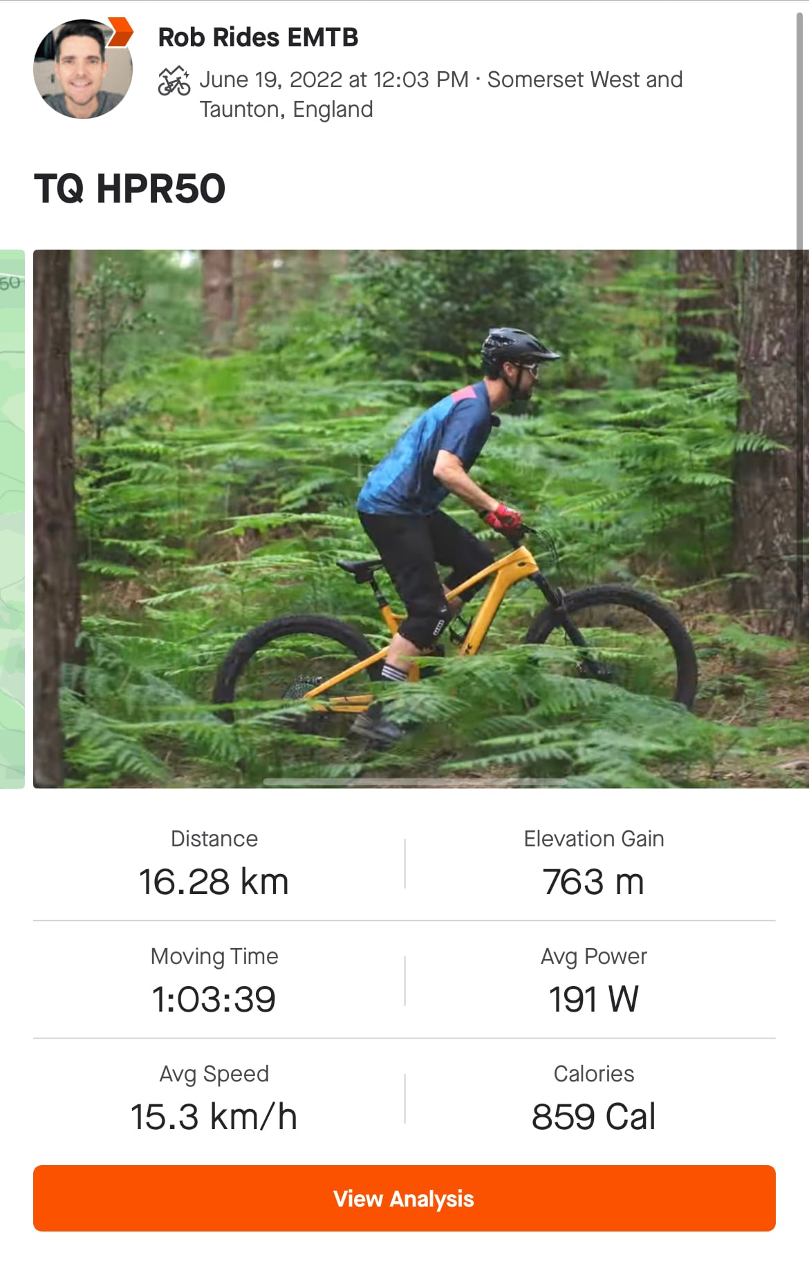

I got 720m of climbing over 16 miles on my first ride yesterday,which tallies with robs figures.
I have to say I am a bit disappointed with that, but I had tweaked the modes to offer more power/assistance than default, and I'm still learning how to get the best out of it.
I usually ride my full fat Bosch gen 4 (with 625wh battery) in tour+ mode, and that will typically give me ~1300m of climb over 30 miles ,of a similar ride.
I've since lowered the power/assist in the first two modes,so will see how it goes.
I was hoping for around 1000m of climbing without having to resort to the lowest power mode too much.
Knut got 938m in full power in his test here

Which does seem at odds with other people's numbers. Maybe it's all about the trail surface ?

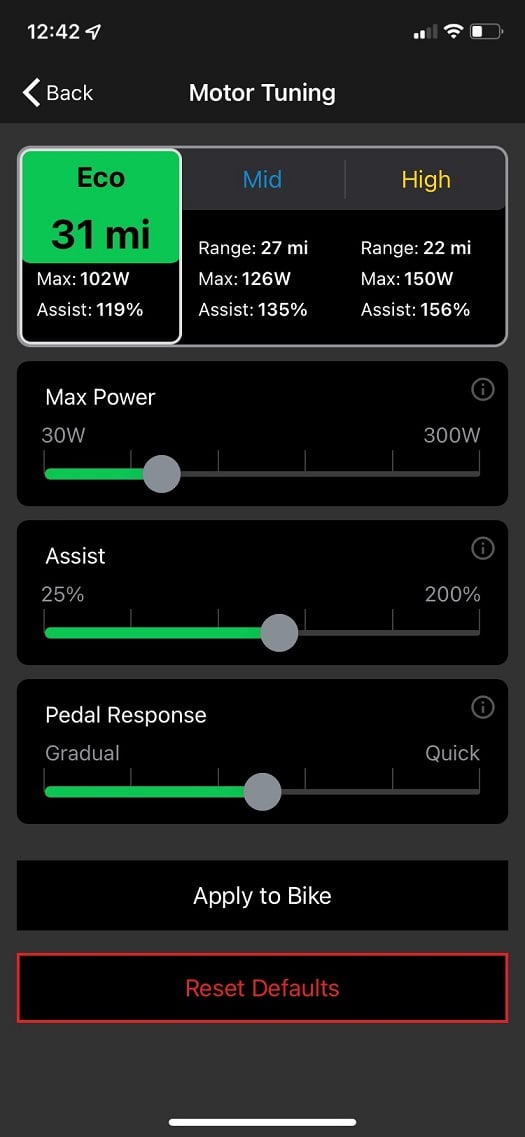

I think it's wattage, not assist level, that drains the battery. In the app, If you lower set the wattage for trail and boost, but increase the assist, the app shows similar ranges for all 3 modes. Thus, "I think" using lower wattage/higher assist is the way to get max vert range.
I got 1100m on the first ride over 32km, all singletrack climbing, I weigh 84kg.
I did the first 80% in Eco, then realized I wasn't going to kill the battery so put it in boost for the remainder and finished with 12%
Could you post a screenshot of your motor settings?

I think both the Assist Level and Max Wattage Level affect how fast the battery drains. If you set the Assistance Level to 100%, the battery will drain twice as fast as it would if you set it to 50%. That is guaranteed, all the time. At 100%, whenever you are pedalling, it is working twice as hard as it is when set to 50%. Max Watts only affects battery drain when you are pedalling harder than normal.
Max wattage determines the maximum amount of assist available when you are pedaling hard. For example, if you are inputting 100W and you assist level is set at 100%, the bike will assist 100W. If you input 200W, and the bike assist is set to 100% and the Max Watts is set to 100W, the bike will only assist the same 100W. So you battery drains less but you are getting the same assist at a time when it would be nice to have more assist. In that scenario, if you stand on the pedals to get up a steep hill, the bike only assists 100W. If the Assistance Level is set to 50% and the Max Watts is set to 300W, the bike is faster than a manual bike but when the going gets tough and you input 300W, the bike will assist 150W which is significantly more assist when you really need it. In this scenario, you aren't draining the battery very much when riding normally but when you need more help, it is there for you. If you need even more help, put it in Trail mode.
I think the range calculations can't anticipate how hard you will be pedalling so it can't accurately adjust for an increase in the Max Watts level.
Try lower assist and higher Watts settings. You might like it.

In my case, I tried creating 3 modes that were all somewhere between stock ECO and TRAIL modes, 100-150w, with varying levels of assist. I'll post a screengrab later.
I'll try it, but I don't expect to get 3500' /1100m+ with higher wattages. What do you think?
I'm definitely enjoying using the app to see what's possible. Make all 3 modes identical but with one variable, etc.

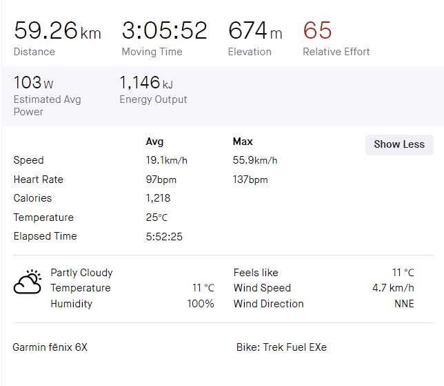

View attachment 100361 View attachment 100362
Here’s the Strava data. The TQ was with original tyres too.
