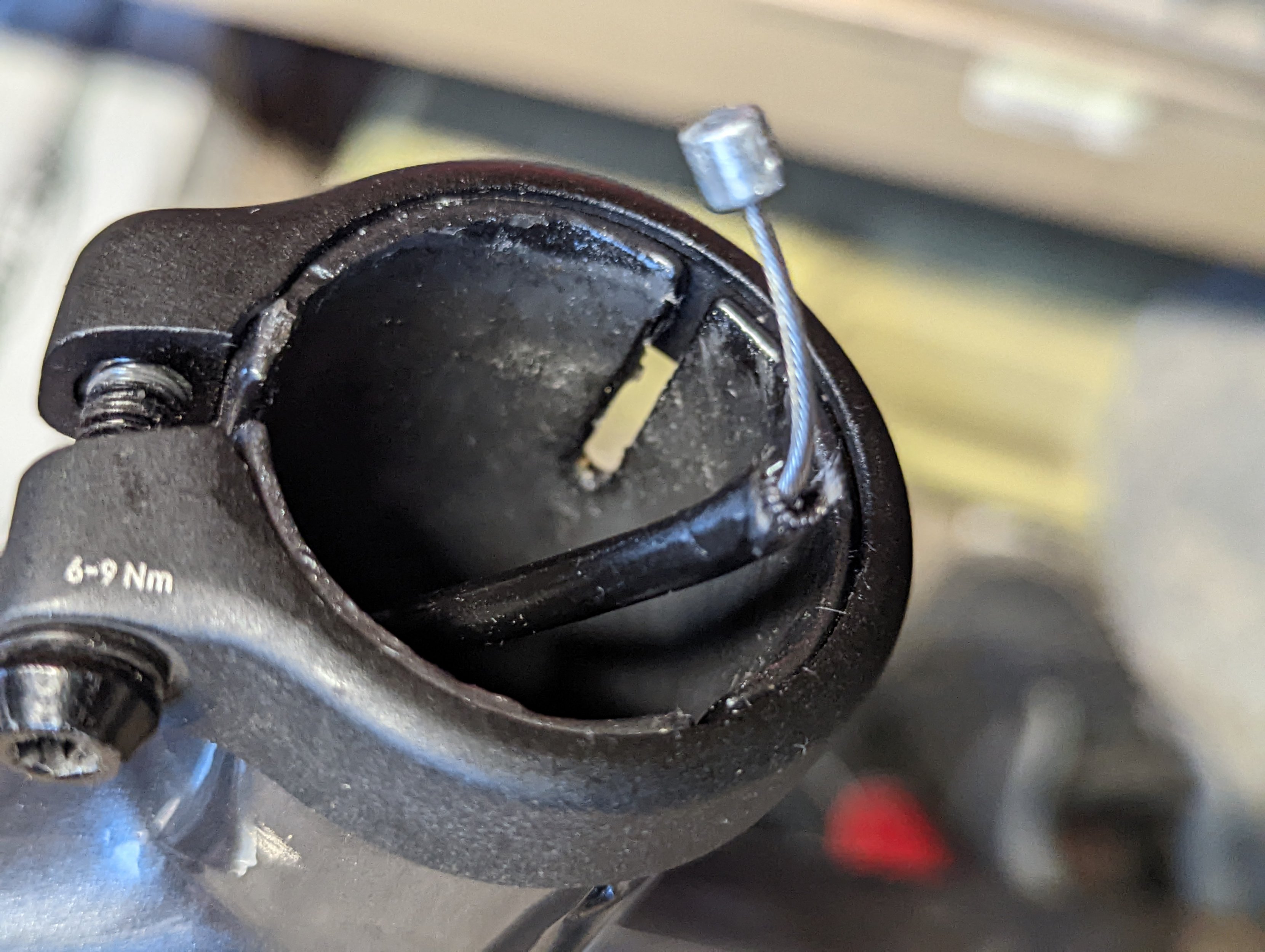

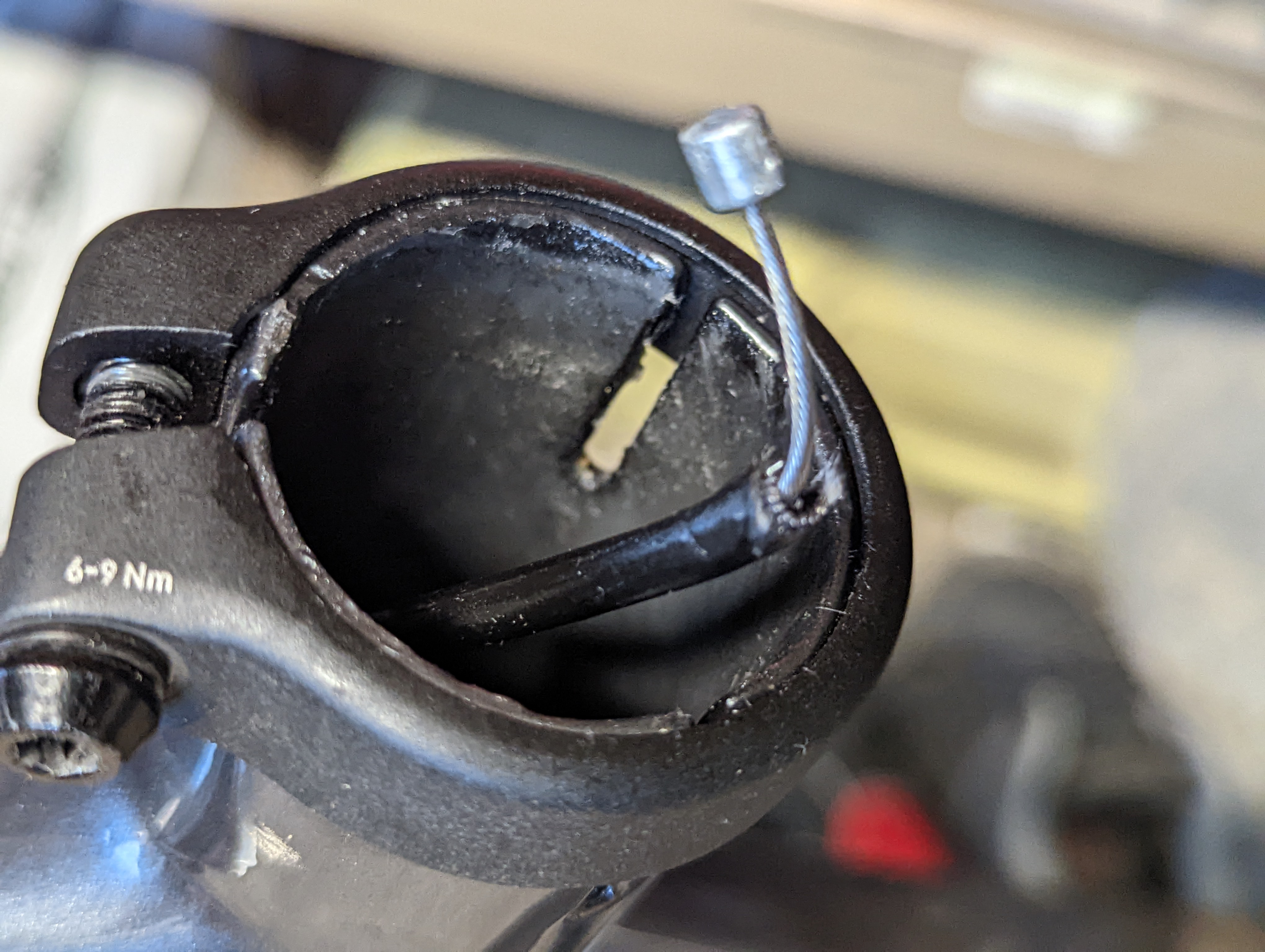

My main dealer problem was the set up of the seat post. No ferrule on the housing and no barrel on the end of the cable (square peg in a round hole) ordered a Fox Transfer barrel for the cable and Wolf Tooth Remote lever. Should improve the feel.

My main dealer problem was the set up of the seat post. No ferrule on the housing and no barrel on the end of the cable (square peg in a round hole) ordered a Fox Transfer barrel for the cable and Wolf Tooth Remote lever. Should improve the feel. . .
UGH, that's nasty and unforgivable! Just waiting to fail. Was that done at the factory or the shop?

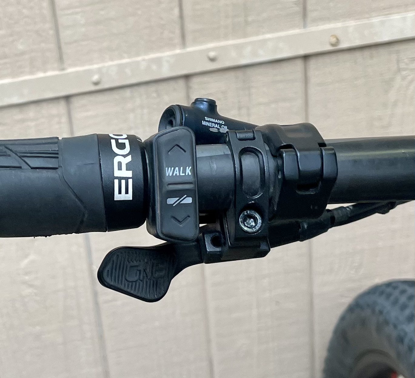

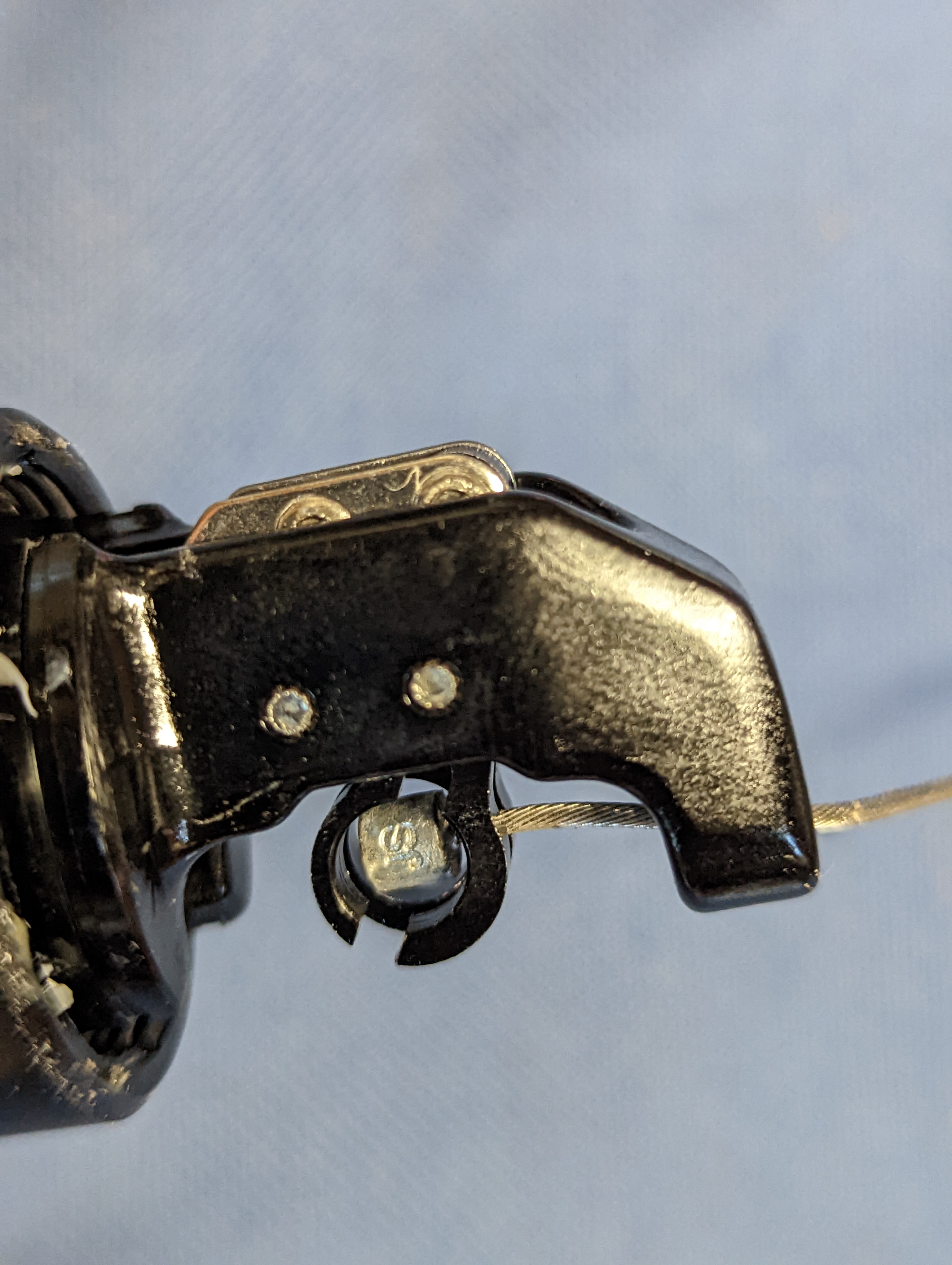

BTW, highly recommend the OneUp remote lever -

Not sure what the assembly sequence is and whether the factory or the dealer did the deed. I take everything apart anyway when I get home so that I know what I have. Trans X says it could have a barrel or not which is odd. For almost 8k I expected better.
I consider dropper function to be a serious safety issue. When they hesitate to drop you can really join the OTBSC (over the bar scar club) Highly advise other owners to check that connection at the trigger on the bottom of the post.
Looks like there are some excellent dropper remote choices out there.
The OEM post on my 9.7 works fine, but you definitely need the barrel insert for smooth operation.

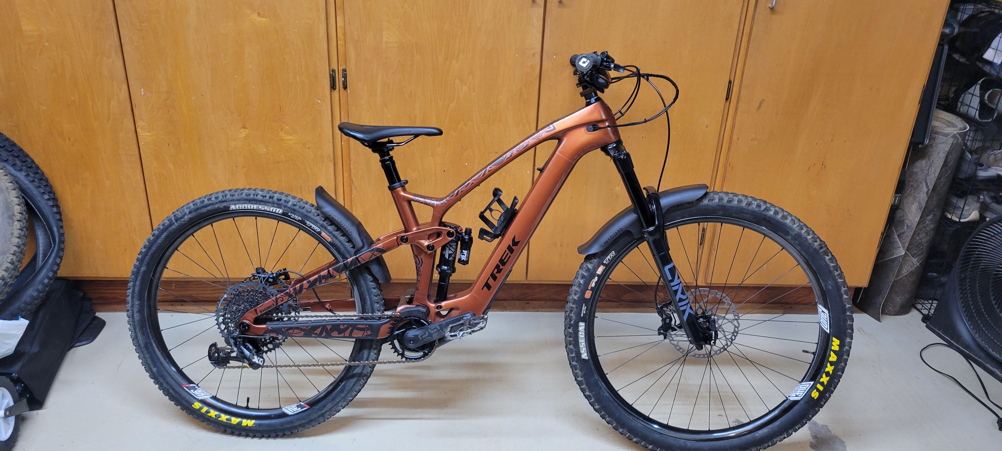

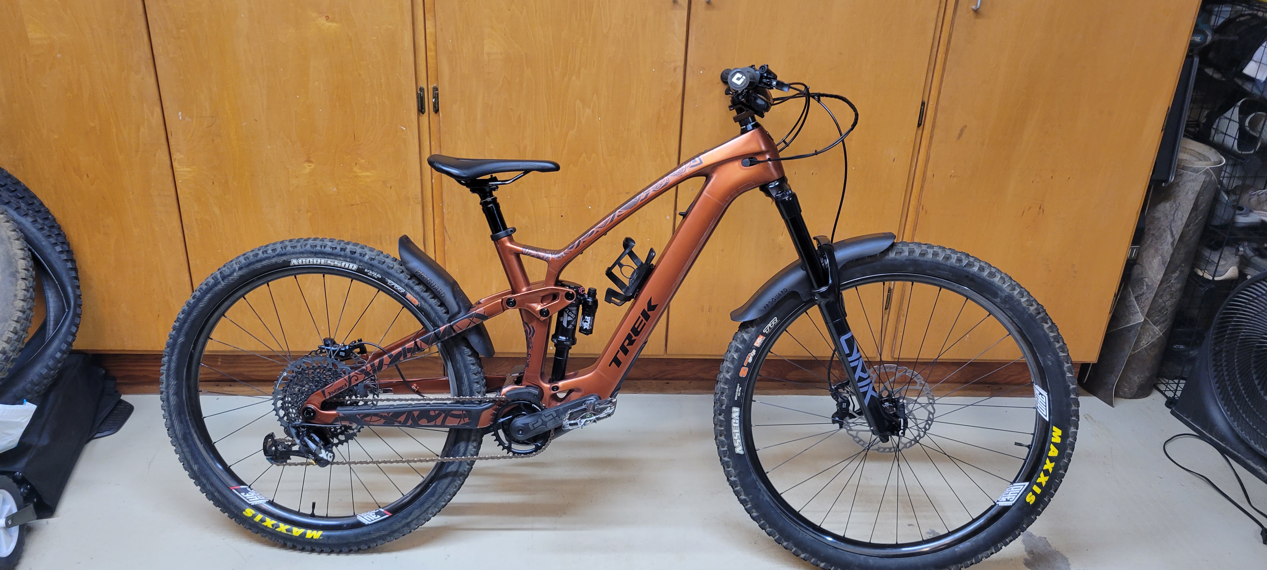

Didn't stay stock for long. Fenders in San Diego huh?

Yeah, never planned to keep it stock. Mostly take offs from my other frame. Lyrik, DD tires, We are One wheels (with XD driver), SRAM XO1. I would have gone with a matte black 9.5 if there was nearby. But what are you gonna do?
Hell yes fenders! haha. They weigh nothing and keep the backside clean at all times. We get some rain here occasionally this time of the year (like right now in fact), and things can get messy because of the clay soils. I would say rear is definitely optional, but the front is critical year round for the pebbles kicking up from all the loose over hard terrain--especially with a MaxGrip front tire.

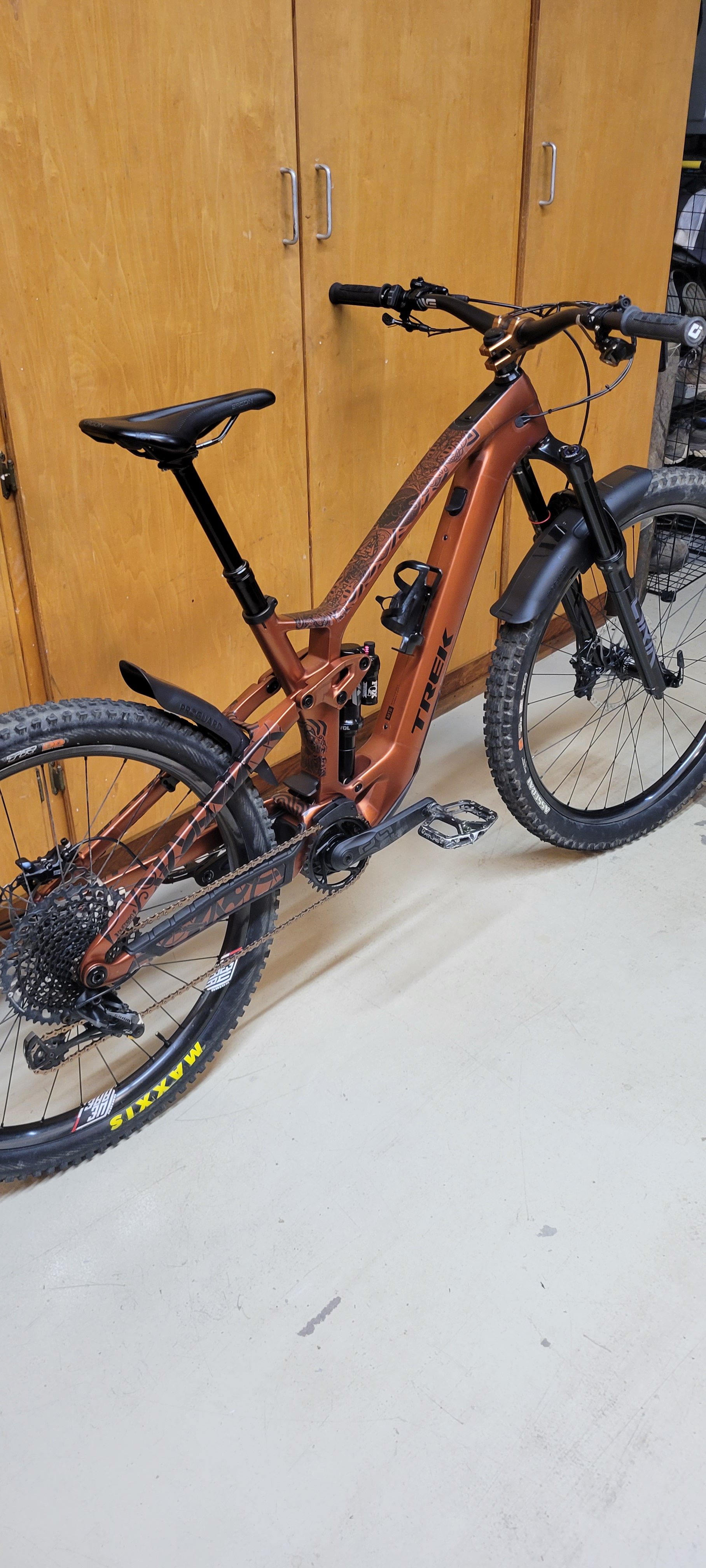

Just got my 9.7 in Matte PennyFlake over the weekend. Had to drive a little over an hour to pick it up (central San Diego to South Orange County with some traffic).
Just one ride so far, but completely blown away--mainly because it feels so natural with the light weight and power delivery.
This bike now sits next to my Santa Cruz Heckler 9 MX and Stumpy Evo. Unfortunately I can see my Evo getting a lot less ride time now.
Here are some pre-ride pics.
(Edit: the Trek bike shop could have done a better job setting it up, though. Among other things, the cockpit cable/hoses are a bit too long and need to be trimmed)

I love that Pennyflake colour! Unfortunately it is not available as a colour option in Australia so far.
I have a Small frame and the hose lengths are waaaay too long on mine. It looks very untidy, but more significantly the front brake cable is so excessively long that it loops outwards from the bike that it risks catching on a tree branch or bush when things get really tight on the track. Also the electrical cable length for the TQ remote switch is so excessive it rattles in the frame and I have to keep (carefully) pulling the excess out of the frame. I spoke to my Trek shop (who are really great to deal with) and they are going to shorten / tidy up all the cable lengths next week.
