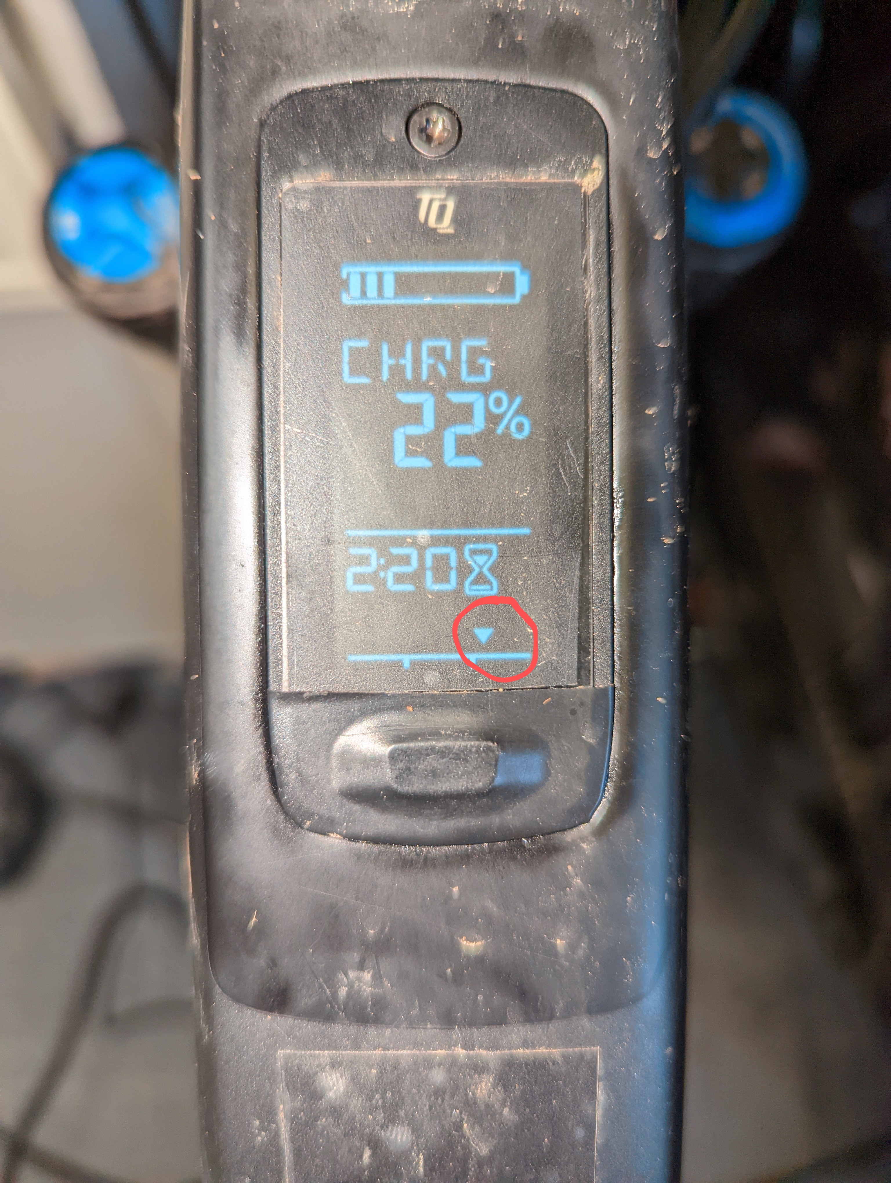

When you plug the bike in to charge it, this little arrow (circled in red below) appears on the display, does it signify anything?
This is trying to call out a "countdown" that is different than you typical ride-range countdown.
The #2:20 with the hour glass is saying it should take about that long till 100% charge. (the last 5% takes a very long time to protect the battery health) This # will refresh as the charge goes on.
This is one approach that is different than most "ride computers" that track how long you've been riding. There are plenty of other devices, watches, garmins that can track your ride time... but very few things that can give your range in time. "do I have enough battery to do another 30min loop?"
Thats a really cool feature. Thats what I miss on other Ebikes. Another nice little feature that shows how well integrated the system is.
