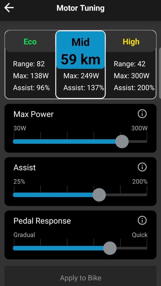

The motor characteristics is slightly altered with all settings at max. The motor feels very similar, but now we can feel some slight motor jerks when riding slowly in technical sections.
The motor is still easy to handle, but there are a few situations where we are reminded there is a motor there. This isn’t that surprising. More power usually means a less natural feeling motor.
We get why ~150% amplification was the default setting. It provides the ultimate user experience for someone coming from an unassisted bike.

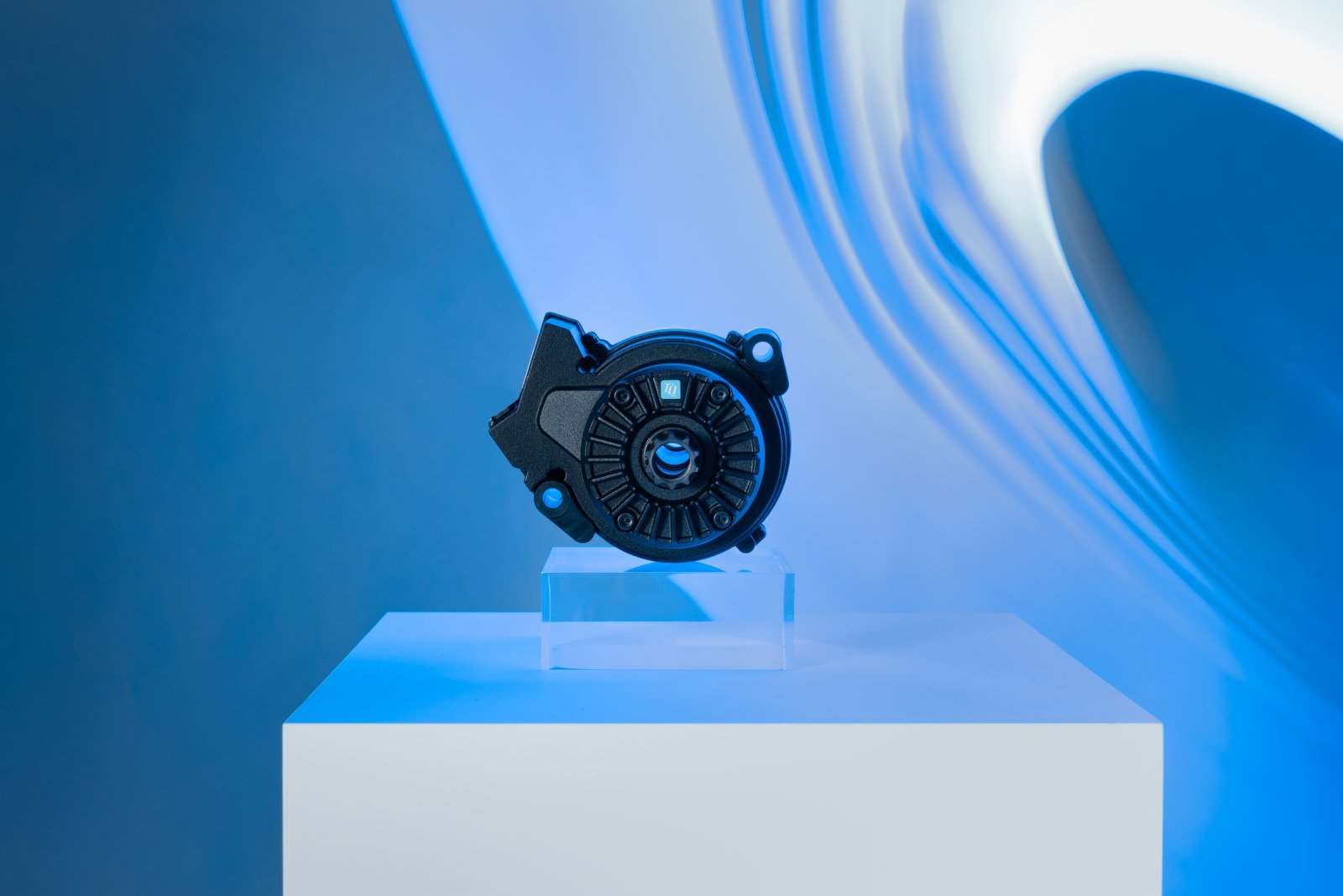

The design of the TQ HPR50 is quite unusual with the crank axle in the center.
Trek central app
But I think it’s important having access to maximum motor power. And we need Trek Central for that. I set level 3 to max everything. Level 2 was set slightly lower than the default settings for level 3. And Level 1 was increased slightly. I like it this way.
Max assistance can be used for transport or when I need a bit of rest. Then I’m alternating between the two other modes for normal trail riding.

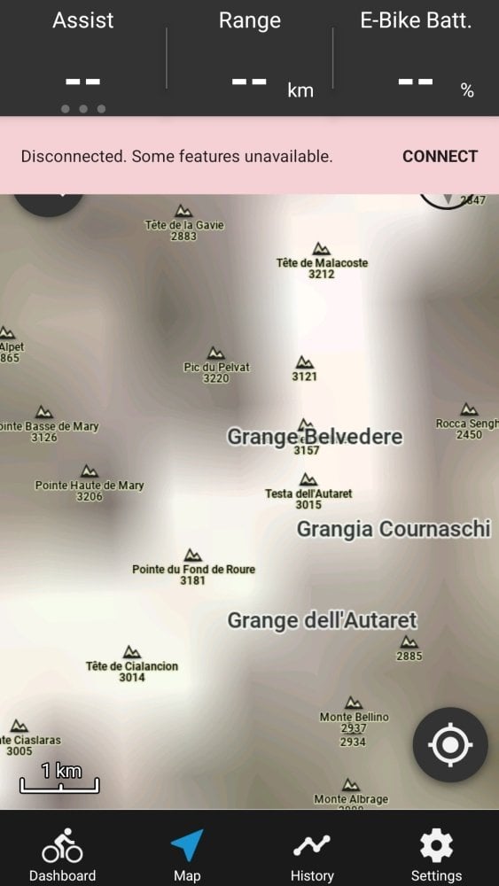

The map
The map
Trek Central can be used to track a ride. And we downloaded the maps for the navigation, but we didn’t find the time to test it. The app can also be used to set a service appointment, it will list nearby service centres. There are three different levels of service to chose from, and you'll find maintainance tips there too.

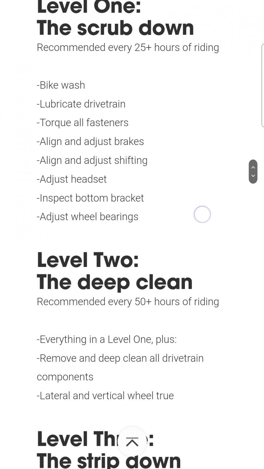

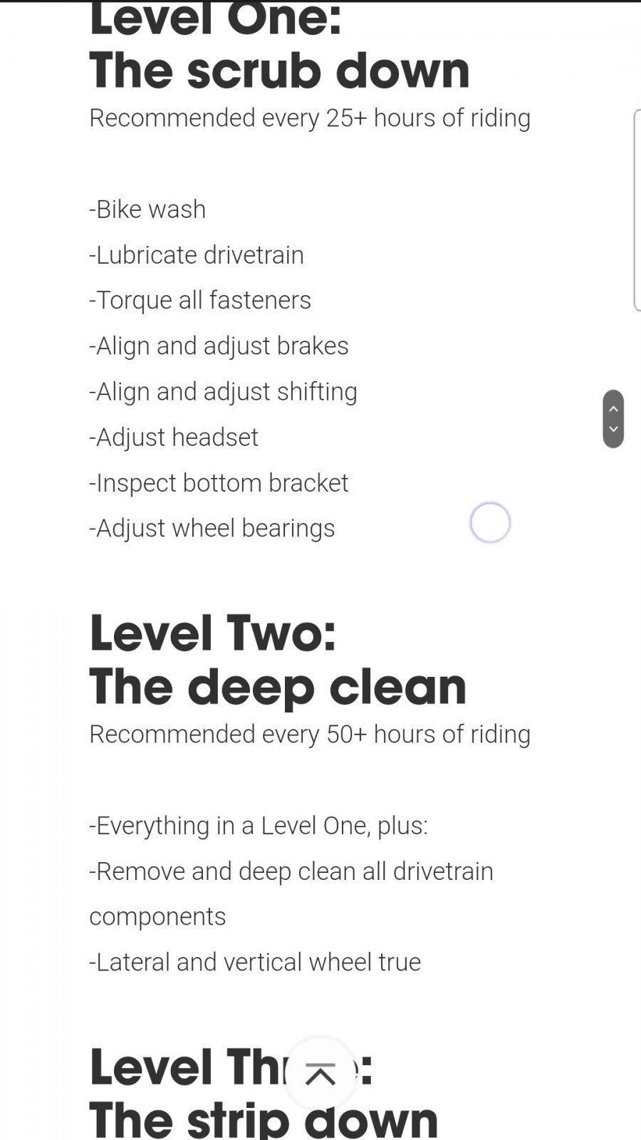

Clicking this opens the trek website for tips and service
Three levels of service

I asked about this, and they said the usual stuff about having tested carefully and decided on these settings. But also; they're continuing to improve the system and it is possible to change the power amplification in the future.
So, reach out to them and let them know you want more :)

Glad to have bumped into Knut 7's review of the TQ HPR50, especially his coverage of tuning options and their effect on assist power. I hope he can help me better understand how the assist level might translate to a road e-bike, so that I can adapt the HPR50's tuning options to my limited condition.
Angina keeps me from pushing more than 100W on a sustained basis, which becomes a challenge when climbing. [One issue is that even at the 200%, the most assist I can get on a sustained basis is 100Wx2=200W, leaving 50 to 100W of motor untapped. I've asked TQ about a boost to 300% for High, got the same uninformative response.]
My interest is increasing the amount of HPR50 assist wattage at lower input. Can I expect a noticeable difference in response between Eco set say to 125W/125% vs 250W/200% (sustained max) , Mid at 225W/150% vs 250W/200%, and High set to 300W/200% (peak max) in both scenarios, with my input at say 75W, 100W, and (briefly) 125W ?
Any other thoughts or insights are welcome. Thanks.
PS. Would setting Eco, Mid and High all to 300W/200% make them all respond the same and make switching between them pointless, or does the TQ algorithm impose some differentiation?
if you set each mode to the same settings, then yes, each mode will just feel the same, and would be pointless switching between them.
I dont follow/understand your earlier question - could you elaborate on it?
Thank you.
The motor seems set up to respond in proportion to rider input: stronger rider effort gets more assist, reaching maximum assist at high wattage. Correct?
I don't get anything near the higher assist wattages due to my low input. My condition would be better served if the motor provided higher assist earlier, in response to the lower input. I'm trying to figure out what tuning settings will bring me closest to that goal.
Simplifying (I hope) my example, I'm asking whether I would feel a beneficial difference by upping the Mid settings from 200W/150% to 250W/200% (or even 300W,/200%) and whether the difference would take effect at rider inputs as low as 75W, 100W, or 125W, or not at all at less than 150W.
Even if it amounts to speculation, your educated guesswork would be sounder than mine, but no problem if you decline because I'm asking too much.

Just crank all the bars up then all the bars down. Try different things and figure out what you like.
True. Will do some testing, when I have the bike. I was asking Knut because he assessed the tuning parameters more deeply than other reviewers.
I'm trying to understand how TQ's algorithm operates, which is not all that well defined beyond aiming at a 'natural' feel. By comparison Fazua seems to also aim at a natural feel for the capable rider, but also provides what I'm looking for as an option. According to its Customizer description, Fazua's "Support Relation" can be set such that a limited rider can get the set maximum assistance with low input, my holy grail.
I think you'll find a lot more information if you look in the actual forum rather than the articles. Search for TQ or look in the Trek Rail eXE thread and read all of that. There's lots of advice and ideas. Lots of bikes will give you maximum assistance with low input - most bikes on "turbo" or "boost". Some bikes like Levo's/Kenevo's let you set "shuttle mode" - so even less effort required for full boost - though those are "full fat"(heavy) bikes.
Pardon my interloping: already committed to the Domane+ SLR 6 road bike. Just figuring out how the get the most from my medicated 100W of input out of the TQ motor. Not the likeliest forum, but Knut's review was more probing than most.
Thanks. Will let it rest there.
No need for pardon's ! :) I just thought you would have more success finding information and answers in the forums where lots has already been discussed and discovered.
in french, sorry...
utilisateur du Domane + SLR, je fais le même constat: assistance qui intervient tard, vers 70/80w/cycliste, et accompagne de façon instable ensuite, variation de l'assistance de 0 à 50w, sans raison. Si le cycliste est fatigué, et faible, il n'a pas d'assistance moteur?.....
J'en ai fait part à TQ, j'attends avec impatience, une mise à jour du firmawre 1.4.132.
Déçu de l'assistance, comparativement à Spécialized Créo, la puissance me convient, mais pas la gestion de l'assistance.
When riding in the max assistance mode on my new Scott Lumen 900, I have the motor that frequently turns of and on, when I am peddling at the same pace. Very annoying. Does somebody has the same issue? Does this have something to do with the pedal slider in the app (turtle)? Thx for your answers!
