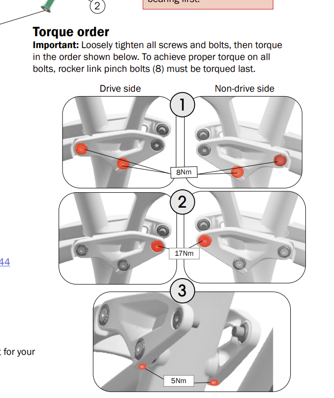

When swapping a shock on this frame, are folks loosening the pinch bolt and all rocker link hardware and following this torque order? Or just the 3 required shock bolts? (2 upper bolts into the shock trunnion and 1 lower bolt with the mino link).

I remove only the 3 bolts holding the shock itself when i take shock off for service..
Hi, you should loosen the other bolts and retighten to spec in sequence as per manual to ensure your alignment of the shock is optimum. Misaligned / torsioned trunnion shocks are a very bad thing if you do a deep dive on the subject....

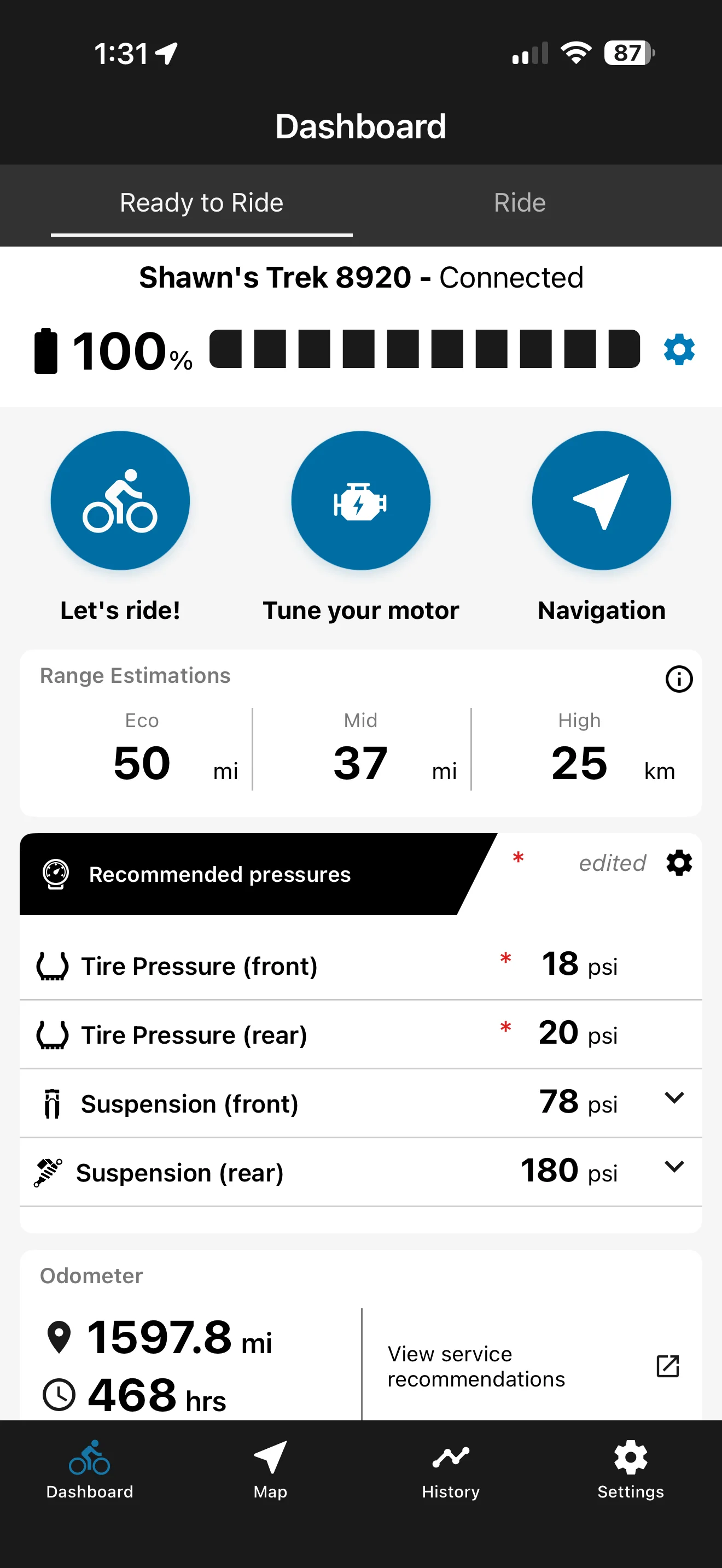

Well this is strange. I have my bike set up for miles, not Kilometers. But, my range estimate in High power is in kilometers, while Mid and Eco are in miles.
The 25 looks like it might be the right number in miles so it might be just the wrong label on display. Bug anyway.
It’s hard to say. I could never get 25 miles on High, with the elevation I normally ride. But, the estimates are always way too high. I don’t think I could get 50 miles in Eco, even on flat ground.
