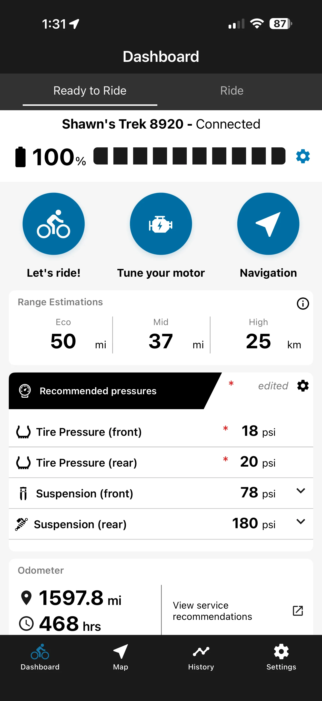

Well this is strange. I have my bike set up for miles, not Kilometers. But, my range estimate in High power is in kilometers, while Mid and Eco are in miles.
