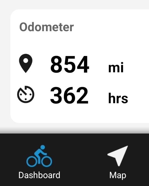

How do I know if my EXE is self draining quicker than it should? The hours versus mileage has always been out of cock. Theres no way I've done that mileage to those hours ..... I always shut the bike off straight at the end of the ride too. I've noticed my battery doesn't seem to last as long now too. Its 14months old.
I think the hour counter also counts hours the bike was charging, not solely the hours spent riding.
If you have the latest version of the firmware you can see in the app the current battery capacity and compare to the specifications listed in the battery user manual , the rated capacity of the battery is listed as 6.24ah in the manual . One of my batteries say it has 6.3ah capacity, the other that is more worn says 6.1ah capacity.

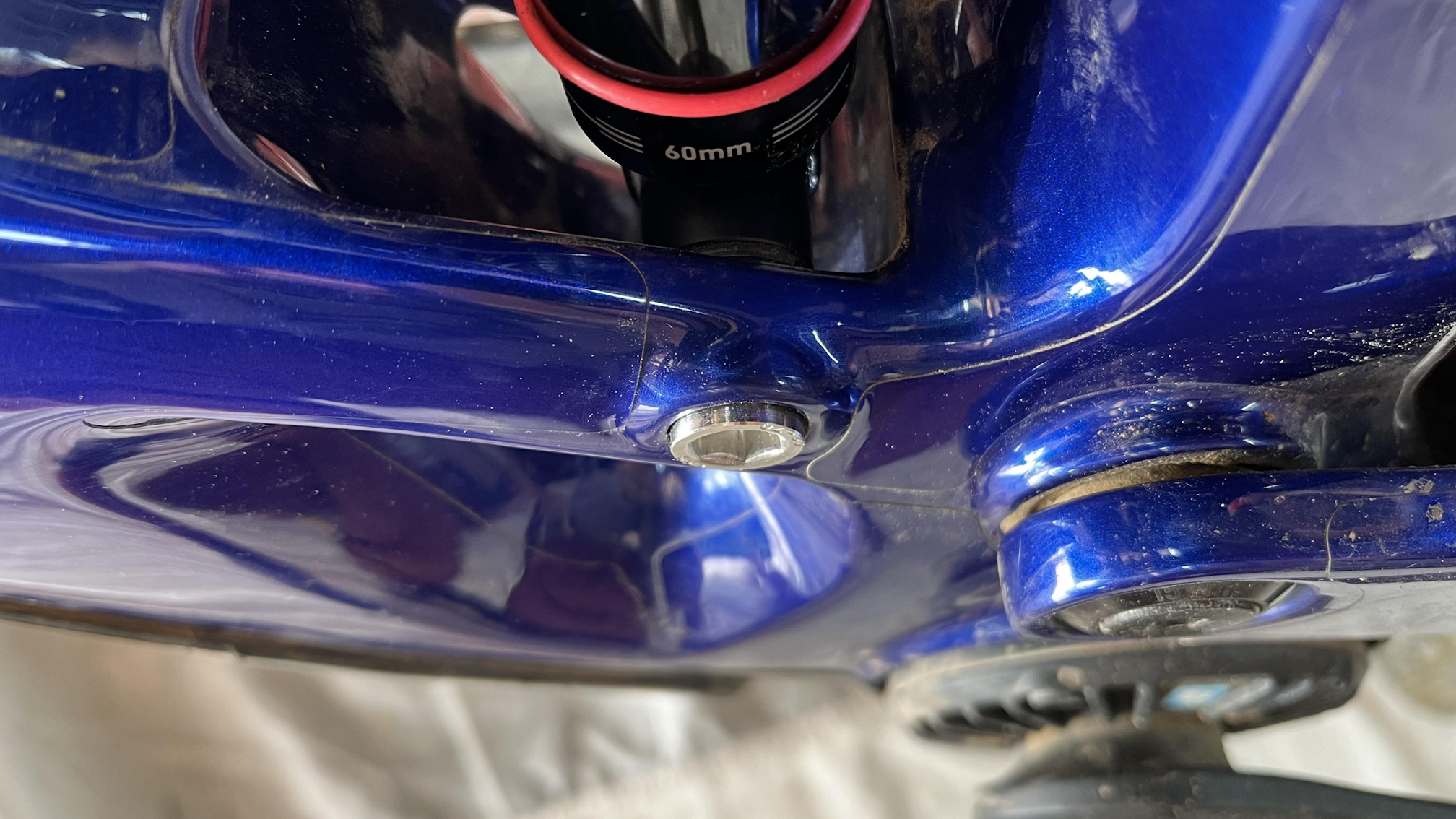

I'm wondering about the lower shock bolt. It sounds a bit like small displacement rattle that could be that. Are you running the original bolt that has threads in shear through the carbon on one side>
Same on my bike. That's why I mounted a bolt from Pinner on Whistler. Fits perfectly
I've noticed this on mine as well on some root sections, didn't think a lot about it but now that I read all this it's going to bug me...
Pinner is sold out so I submitted a "let me know when available", and if a few others do the same it might urge them to fire up the lathe.😉
Yes, I am running that bolt. I had not heard of this being the noise issue before but it seems like it's common. thanks for raising it, gives me a new angle to investigate :-)
Budget alternative is to wrap the bolt threads in teflon tape to get a tighter fit. Cut the noise from mine seems to hold up.
great idea, will give that a go, how much tape did you use, and was it all the way along the bolt? like to give this a try before trying to get custom bolt, so if you have any more details that would be amazing with thanks:)
I also found this which dives into it a bit more, seems like a common issue...https://www.emtbforums.com/threads/trek-fuel-exe-megathread.29784/post-556361

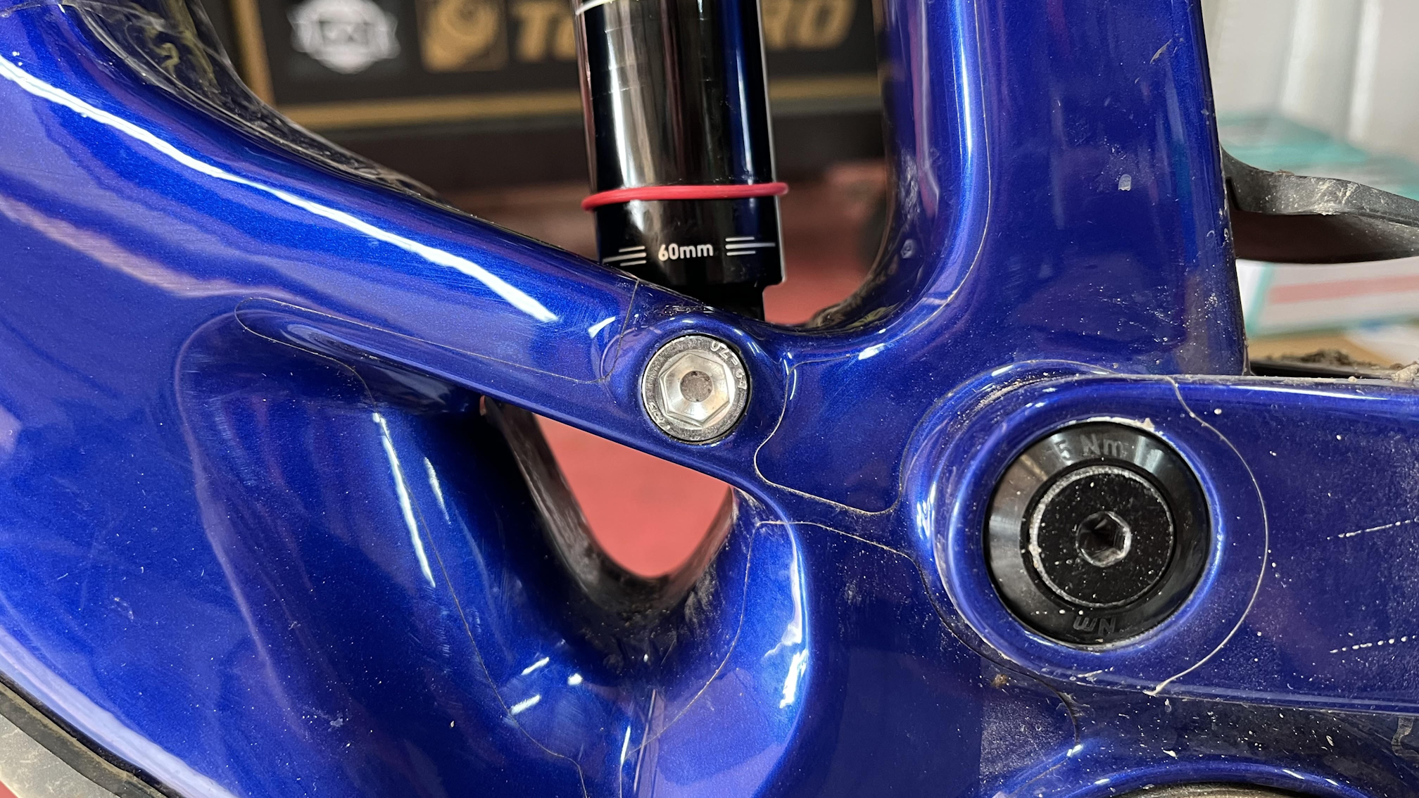

As you may have experienced first hand or read about it here or on forum, Trek Fuel EXE owners have reported play in the lower pivot bolt. By play, I mean vertical movement between the shock bolt and hardware.
How to check if your bike has this issue:
Loosen your lower pivot bolt. Put one hand on the seat tube below the seat collar and another on the rear triangle holding it down. Pull up with the seat tube hand and you’ll hear a clicking coming from the lower shock mount. You can pull on the seat tube with your other hand under the lower shock mount and you’ll feel the movement. Repeat this at 10NM, 13NM and 15NM.
10 and 13 you should still feel the movement, and 15 is about where the horizontal force is greater than the weight of the bike so you won’t feel it.
What is actually causing this?:
There is a very small gap between the bolt and shock hardware (regardless of Fox, Rockshox etc).
The cause of this is that Trek decided to use a generic off the shelf M8x60 threaded bolt. You can get these for as low as $2. Turns out that all off the shelf M8x60 bolts have a diameter of 7.85mm. This is an industry standard. Surely this would be a common issue for many bikes then? No it isn’t because the majority have their pivot bolts custom made. For example both shock bolts on a Canyon Torque measured at 7.97mm. All shock hardware measures in at about 7.99mm.
Trek’s Recommendation:
Trek issued a bulletin regarding this (it was directed only at Fox shocks but it applies to all kinds of shocks). Their solution was to replace the hardware and tighten the bolt to 15NM. The torque rating used to be lower in the original Trek manual.
Essentially it’s a bandaid fix because tightening the bolt more will apply more horizontal force to clamp the hardware tighter to the frame. Which means when your bike is static, you won’t feel the play because the horizontal force is greater than the force you apply when wiggling the seat tube. It will appear to have no play but in reality, it will still move under big compressions and decompressions when riding. If you forcefully push and pull the seat tube then you will feel the play still there. This can also lead to extra stress and wear on the frame that over time, you’ll have to tighten it a bit more and more.
The recommendation of replacing the hardware and even supplying a new shock bolt will have zero effect as you’ll still end up with ~0.14mm gap. You may get lucky and get an out of tolerance bolt that is thicker, but there is another problem with this off the shelf bolt.

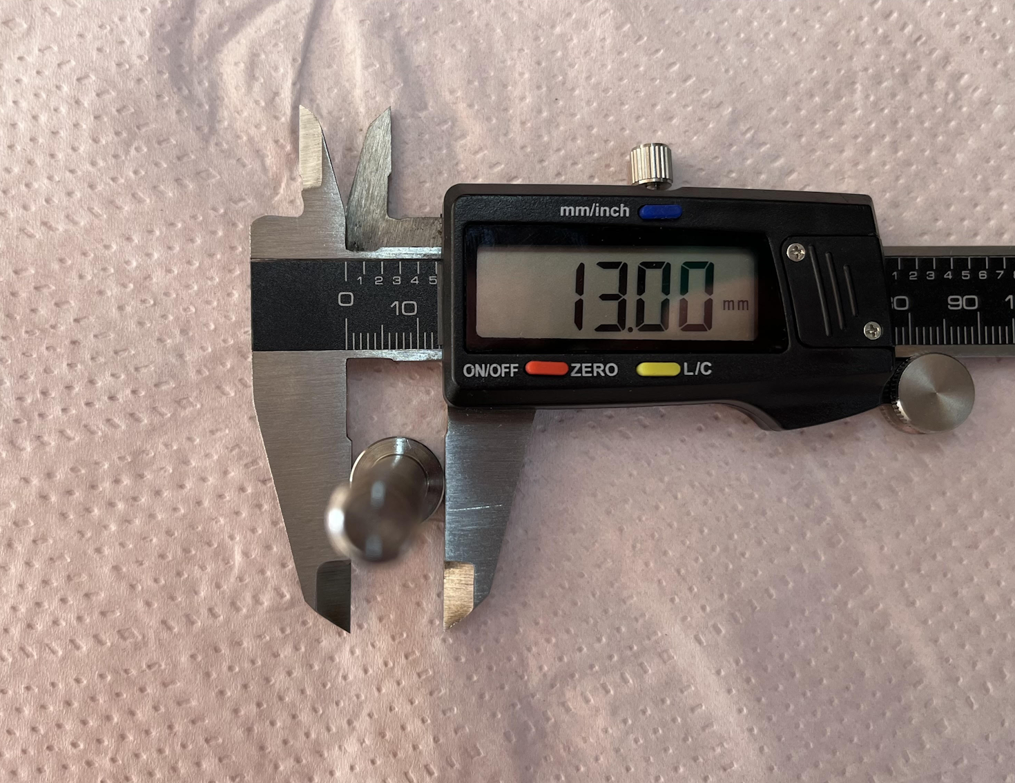

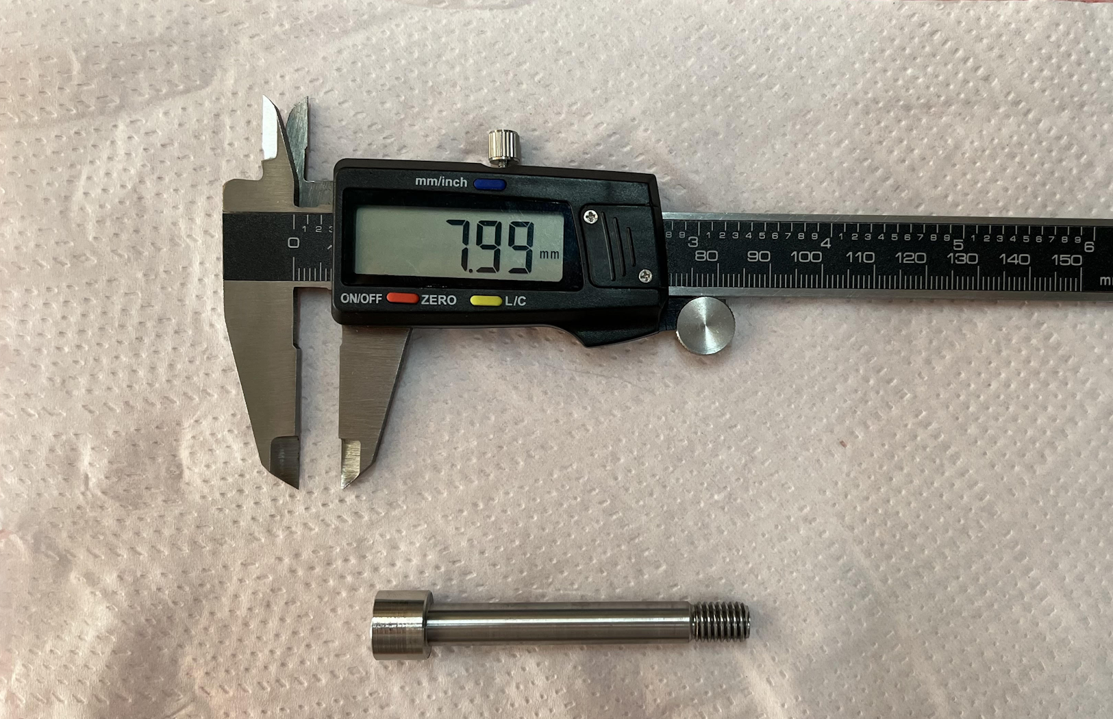

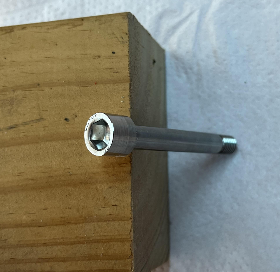

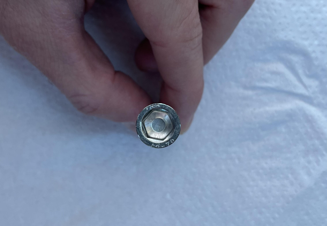

How this problem is solved:
Firstly, full credit goes to @Jazzii . He posted his findings on the EMTB Forum and I used that as a basis.
The fix is that you need an M8x60 bolt with a 1.25 thread of ~10mm, shaft diameter of 7.99mm and head diameter of 13mm.
The way to achieve this is to get an M10x80 bolt machined down to this spec.
As simple as this sounds, it took quite a bit of asking many local places and prototype trial and error. Some things I learned:
  • Most shops don’t want to deal in quantities of just one.
  • If they deal in one, the cost usually is pretty high $100-$150.
  • Not all machinery can deal with such a small bolt.
  • Getting to exact 7.99mm accuracy evenly can be tough.
After two failed prototypes, through the MTB community I was referred to someone that was able to prototype one for me successfully.
How you can get one:
I’m putting out an expression of interest for these to owners like yourselves.
Ideally I would order in bulk as it’s easier for the machinist and will take a few bucks off the bolt.
The price of the bolt will be AUD $50 posted anywhere in Australia.
NZ I can probably post to you guys.
If there is high interest in Europe and the US then I can try to get postage quotes for you also.
I’m not looking to make a profit on this. Just to cover the manufacturing cost, postage and recoup costs in two failed prototypes at other machinists.
It’s made from stainless steel. Due to it originally being an M10 head, the head will protrude about 1-2mm from the frame which is negligible as the rear triangle behind it protrudes way more. Black anodizing and head length machining will only add to the cost and add no functional value.
Attached are photos of the bolt, and two videos (EMTB didn't allow videos so check my post on FB). The videos are of each bolt, demonstrating the movement and sound when the bolt is loose and when it is hand tightened. (see ‘How to check if your bike has this issue’ above to do this yourself)
I’ve also attached a design drawing that you can provide to a machinist if you wish to have this manufactured yourself.
Let me know if you’re interested in purchasing one so I can gauge numbers and put an order in the next few weeks.
If there’s any questions, then feel free to ask.
