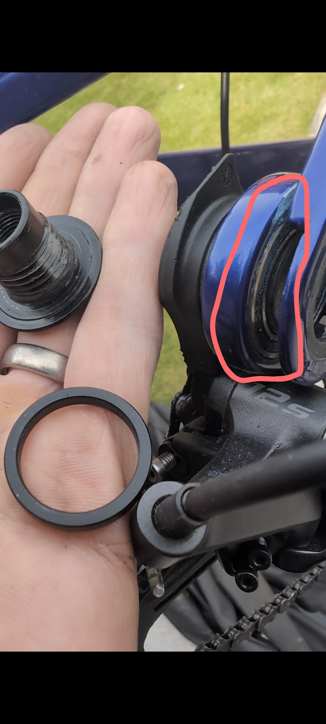

Could someone take a picture of the their derailleur hangar and share please. I took mine off, not sure if I lost a spacer or washer but can't seem to re assemble it without the chain stay rubbing the seat stay and scraping off paint and probably going to damage it if I don't solve it.
Thanks.
Thanks.
You can check the diagram in the service manual from trek's website:
See page 3 and 4 for the hanger and ABP diagrams.
Thanks.
That back circular washer in your hand goes between the chaistay and the seat stay.
Thanks, sorted now. The bit that threw me off was some how the chain stay and seat stay had swapped meaning the chain stay was on the inside of the seat stay instead of the other way round. Not sure how that happened in the first place but fits together perfectly now.

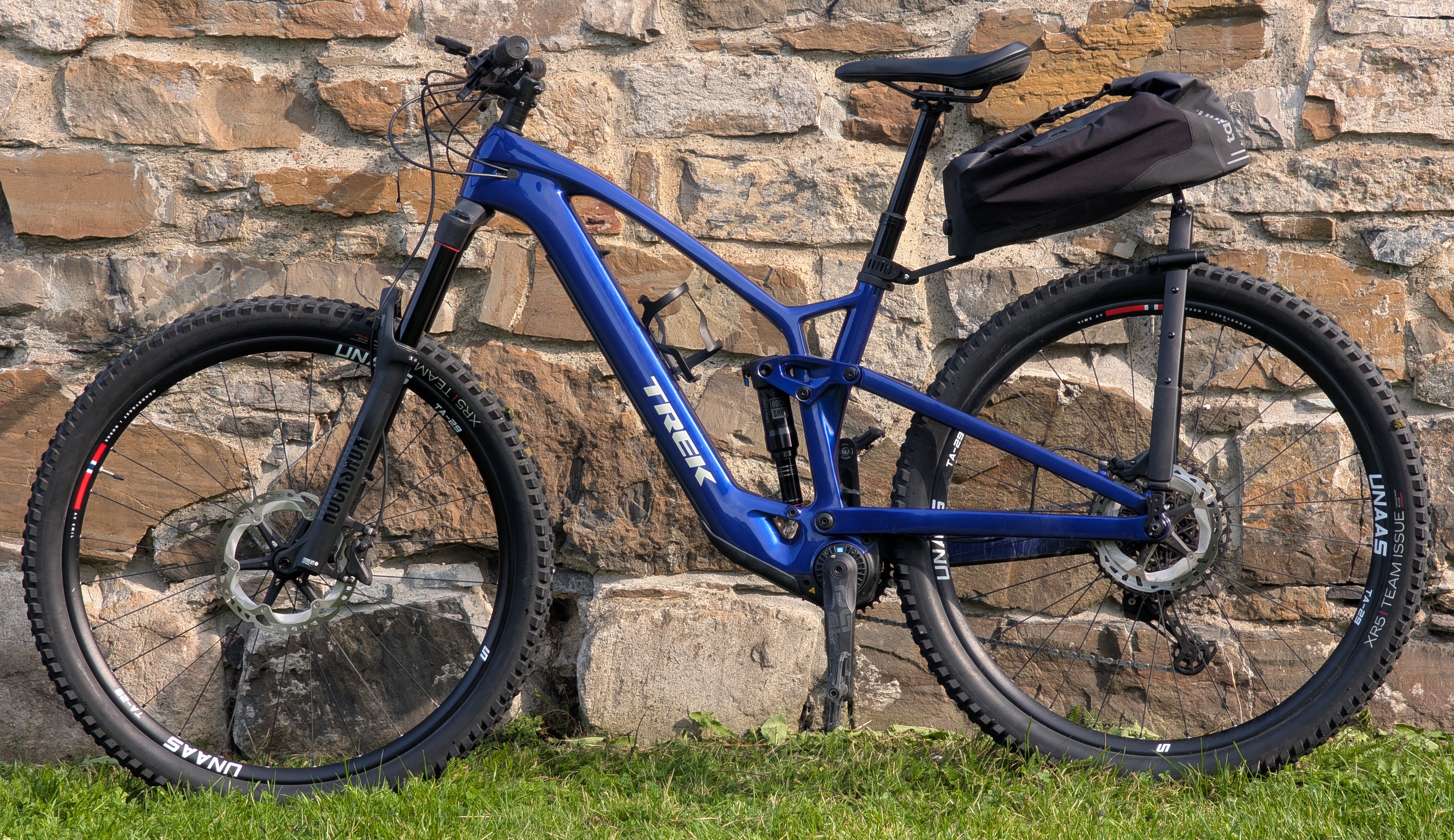

For anyone interested in using their Fuel Exe for commuting/touring/bikepacking once in a while, here's a pic of the Fuel Exe with the Tailfin rack attached. Quick release and it's pretty hard to see that the thru-axel has been changed to accommodate the system.
Doesn't that cause issues when the rear wheel moves up and down with the suspension?
Yes, the suspension will obviously be affected by a high unsprung weight. Will it "cause issues" when touring on tarmac, gravel and easy trails? Probably not. Certainly still better than a hardtail. There are very few full suspension bikes where the rack is supported by the main frame. Riese & Muller Delite is one.
