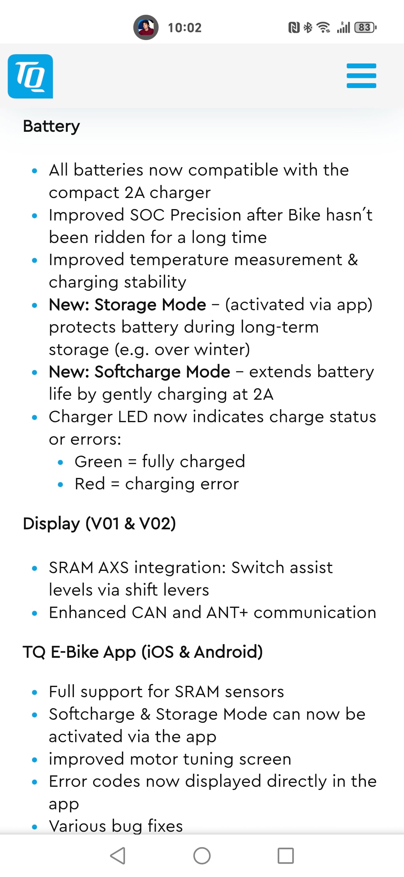

Did anyone actually get the updated app? Not showing in the iOS store for me. My TQ app is still 2nd July. Not going to ask the bike shop for an update until I get the app. Could it be regional? I'm in Australia.
The TQ app came out a while ago. Look at past release notes, all of the slow charging, storage mode, etc. are in there. They were just waiting on the firmware release.

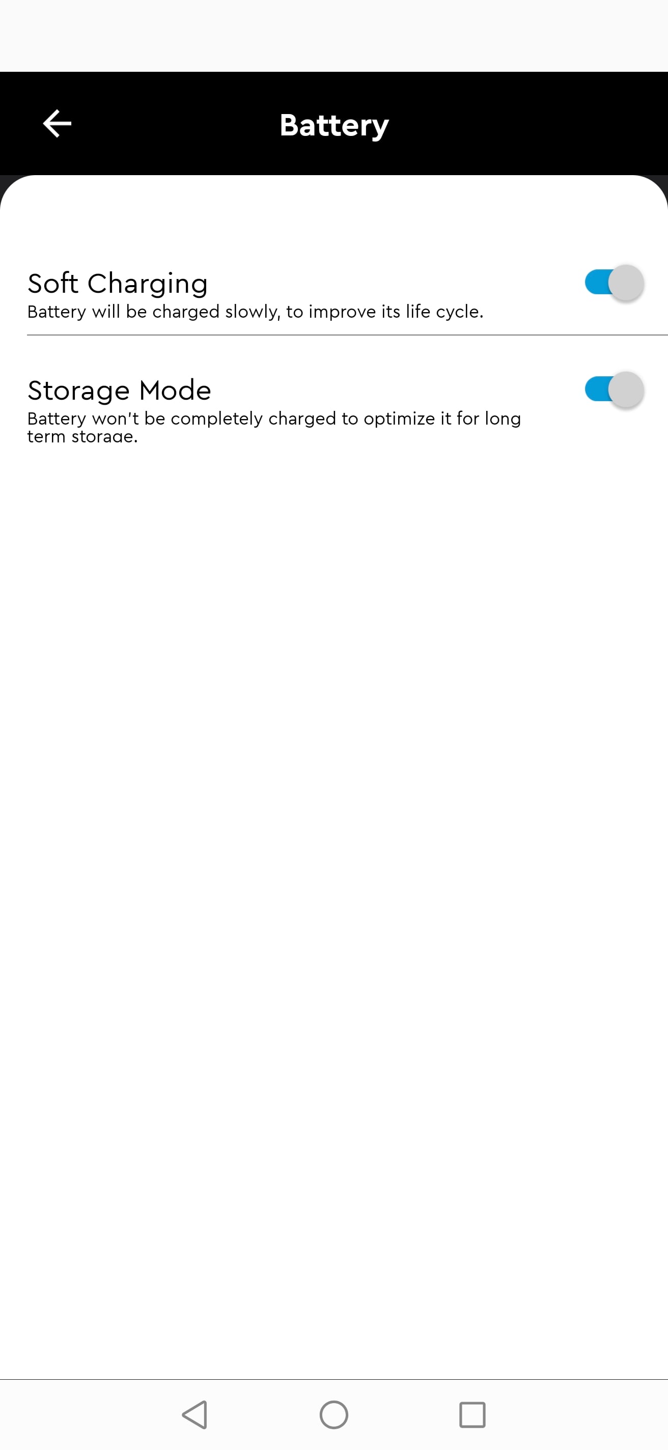

Can you post a screenshot showing where to find the charging modes etc?
I just updated my bike to all the latest firmware, and the tq app is the most recent version, but I don't see any options for setting charging modes etc?
I'm using the android version of the app.
Ignore me, it has now appeared, had to log out of the app and back in again though.
Screenshots below

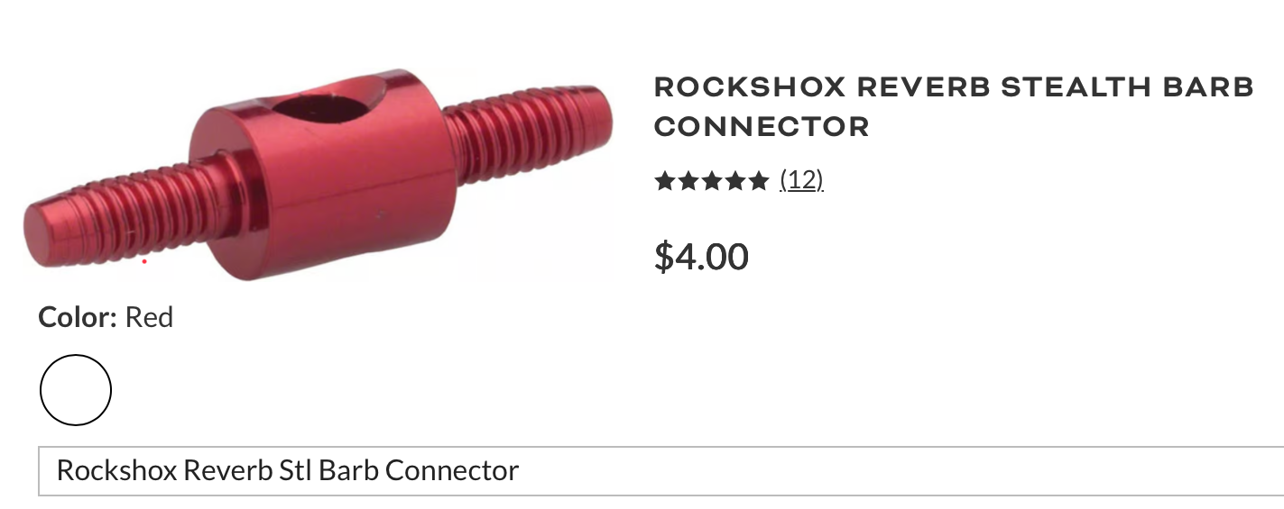

@xcel - you can connect the new brake hose to the old and pull it through
Cheers ordered one of these and a cheap toopre internal cable routing kit. I think @volts is correct though, would have to cut the old hose down at the caliper so I can pull the new one through. I'll have to check how strong the magnets of the routing kit are, using this barb connector is probably easier though.
I really hope the hayes hoses fits into the frame though, seems like quite the tight fit already where the hose enters the frame under the mud flap.

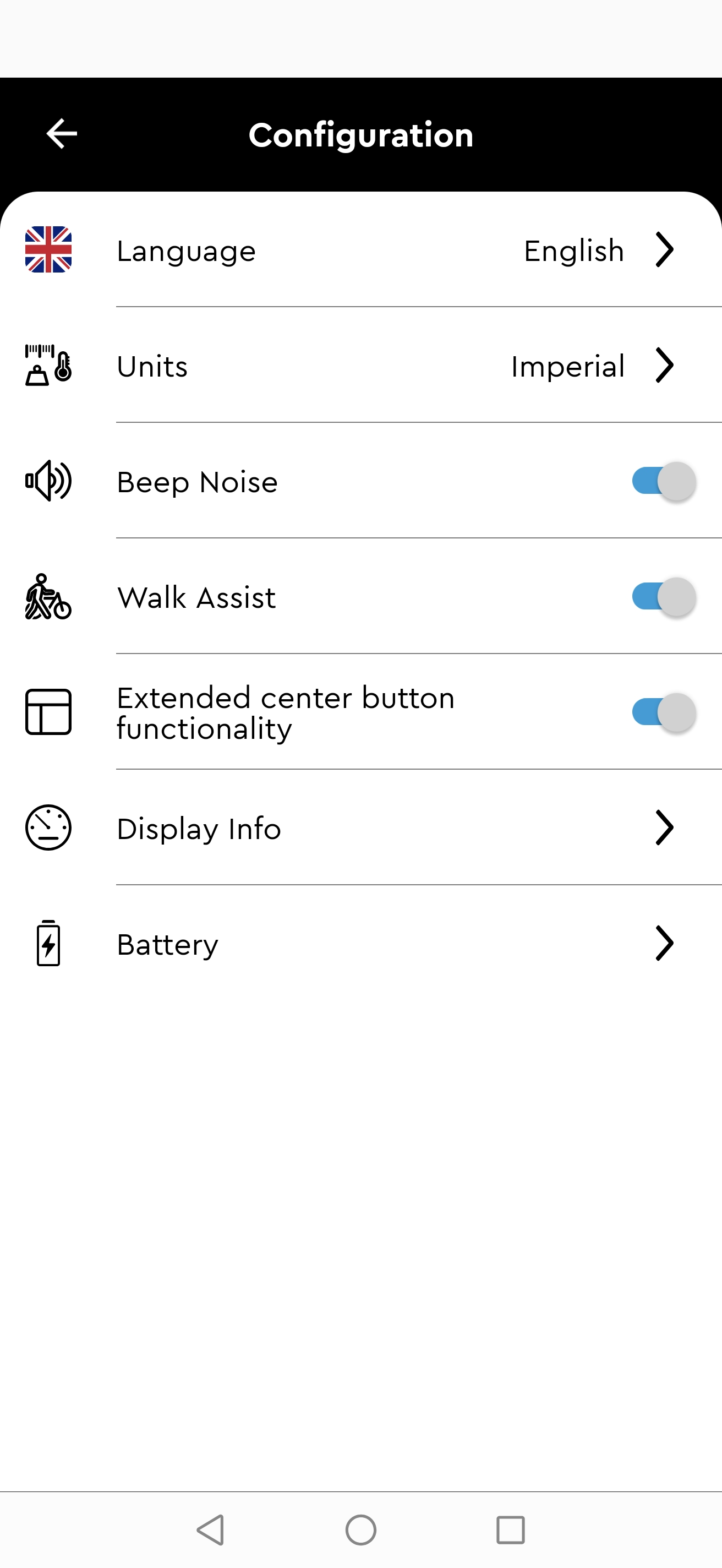

How do you adjust the Fuel EXE charge settings? I have the latest app on my phone an when I go to the battery section, I have no options. Also, it list lists many parameter and history info but all of mine are zero. Is my phone supposed to update my bike firmware but it hasn't done that? My phone says Trek Central is connected to my bike.
From memory, I found the options by pushing the blue battery button in the Trek app, and scrolling down. I think my bike was connected to yhe app at the time. And they were there.
Perhaps your bike needs updating? I have a feeling a shop may need to do that, but not 100% sure.

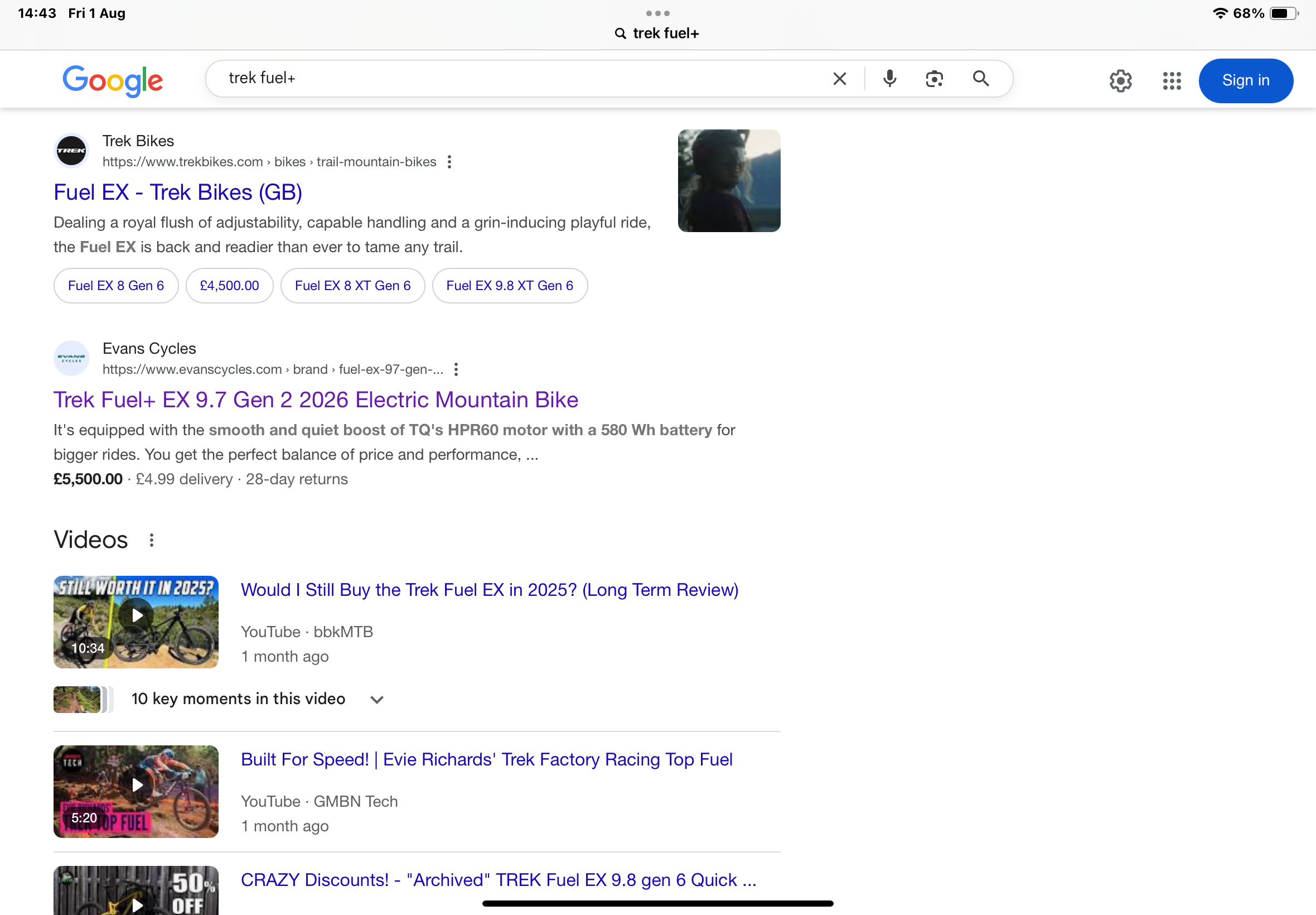

A new Fuel+ in the flesh.
Not keen on the cranked top tube, but this is a small frame. Presumably these are going to be launched imminently.
So it looks like Evans cycles of all shops might be first off the marks with the new Fuel+.
£5,500 with the 580wh battery looks not too bad. I’m thinking it’ll be an alloy frame for that money.
The link goes to an unknown page when clicked, hence the search result image posted.
