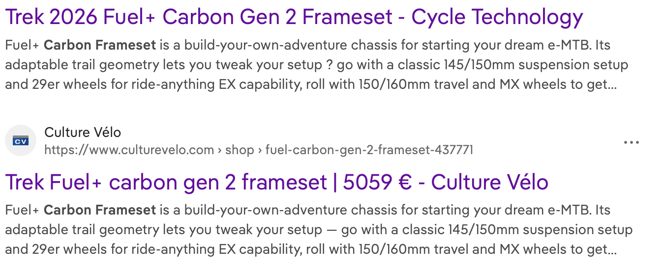

Looks like there were some frame-only listings, obviously taken down now:

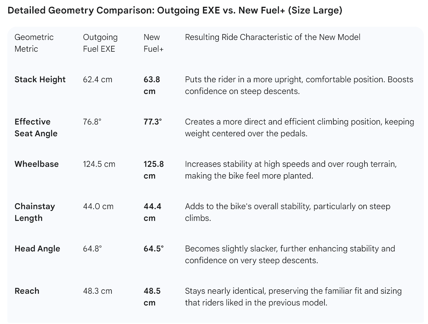

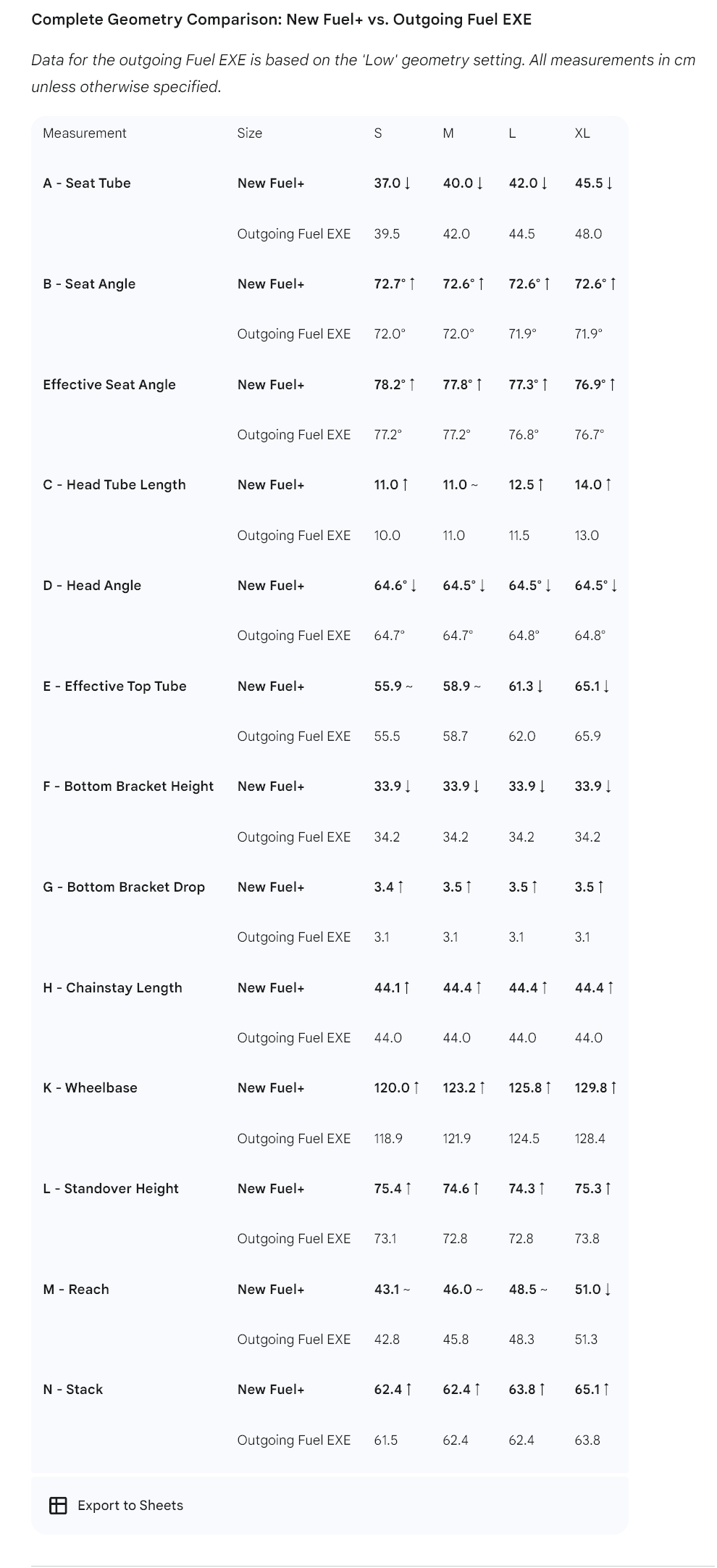

Did a quick geo comparison thing. Little bit longer, little bit slacker, etc.
Well done on finding geo numbers. I couldn't when I looked a couple of weeks ago. Do we have weights? Normally I don't much care (own a RAAW), but that's a big part of the point with the current EXe. Wondering how much the bigger battery weighs and if there will be options so you could have one small battery and one big battery.

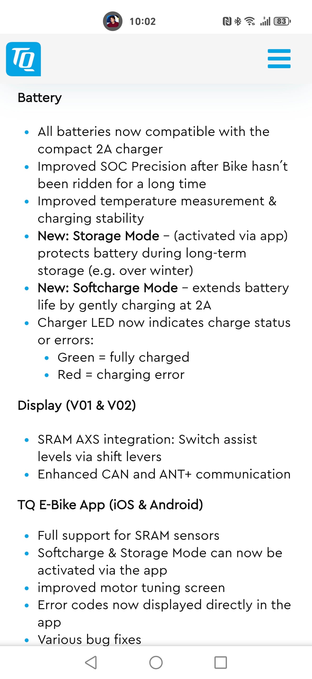

It looks like there are a new batch of firmware updates available for the hpr 50 batteries, display etc.
Has anyone installed them yet?
Did anyone actually get the updated app? Not showing in the iOS store for me. My TQ app is still 2nd July. Not going to ask the bike shop for an update until I get the app. Could it be regional? I'm in Australia.
The latest TQ App in the App Store is v1.6.10, which was released three weeks ago. I can confirm that this version of the TQ app supports the functions of the latest firmware updates. I'm running the latest firmware.
