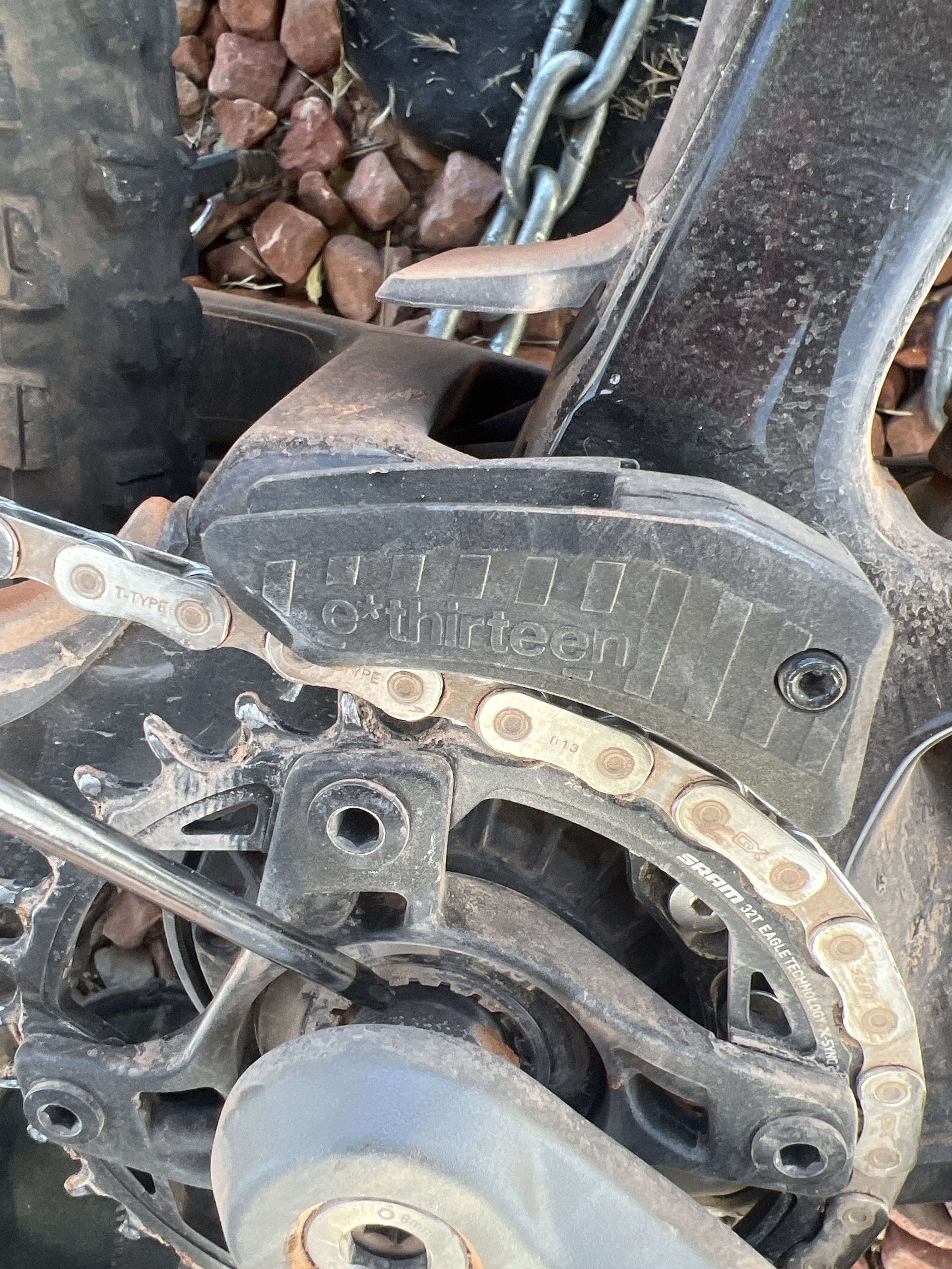

My EXe has creaked since I got it earlier this year. In the beginning, it only creaked while pedaling while standing but it got worse with time. I fixed it by tightening the front chainring. To accomplish this you need to remove the driveside crank arm with an ISIS crank arm removal tool and then tighten the chainring with an ISIS bottom bracket tool.

are you saying tighten the item i have the screw driver pointing to? i see it says tighten to 50 NM as a reverse thread.

Got the 20tooth tool today for the lock ring. The thing was finger tight. So tightened that and also realized the builder misaligned the cranks on the motor spindle, so fixed that. I'll ride this afternoon to see if the combo of that and tightening the one motor mount bolt will fix the creak.
Good luck. Fingers crossed you resolved your issues.
