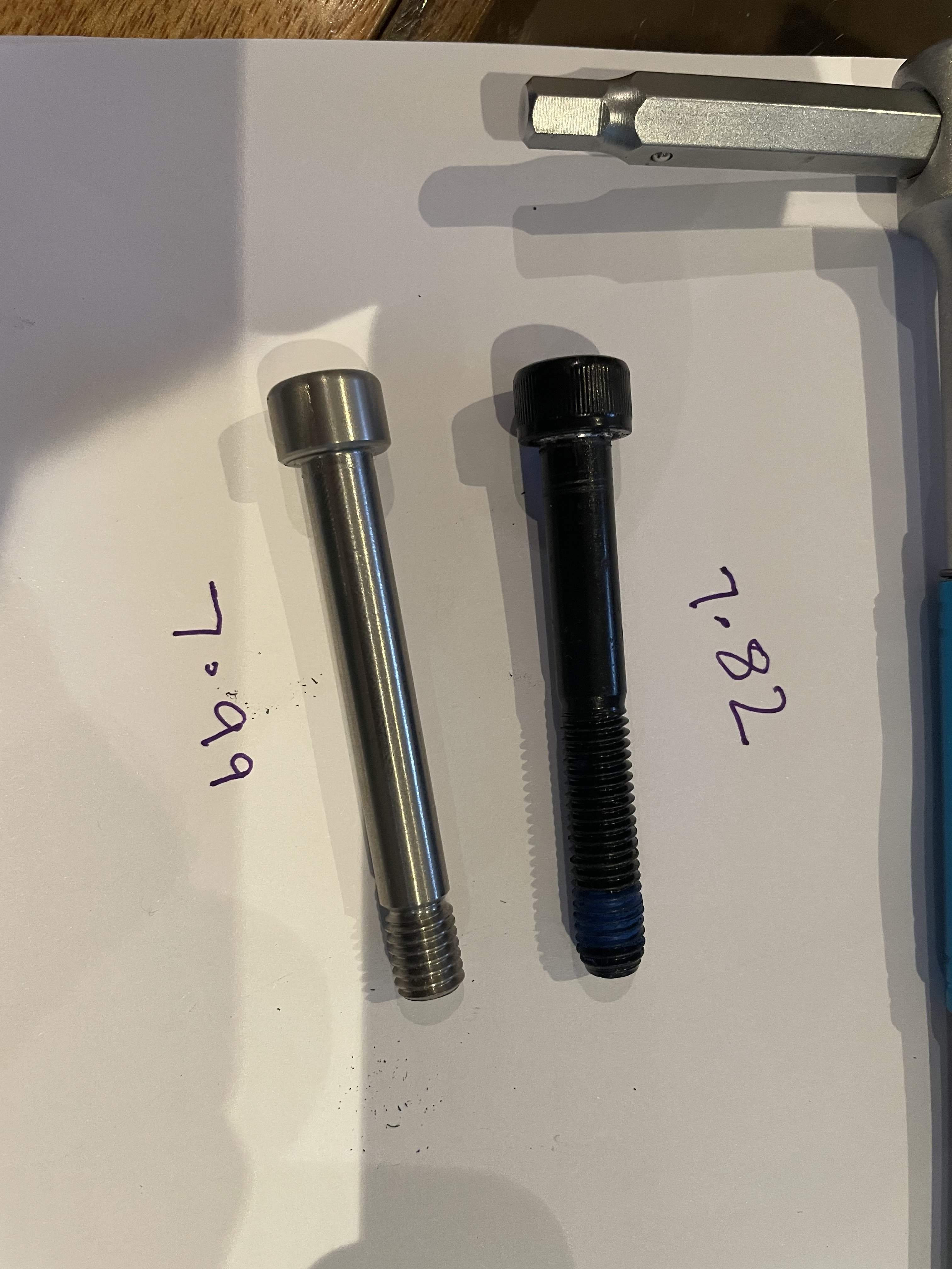

Should we all get a Pinner lower shock mount bolt? The stock bolts on by 9.8 EXE has not been a problem but should everybody get the better fitting bolt before the old one becomes a problem?
I got one just in case here. Nothing worse then shock play in my book.
Yes.
Everybody should change that bolt.
The stock one doesn’t fit the design, just almost.
With the stock bolt you will damage the frame over time, and the «remedy» is to apply more torque..
The threads on the stock one also covers more area of the bolt and overlaps with the mounting hardware of the shock, and that can also be problematic over time.
I just don’t understand why Trek decided to save money on this particular bolt..

It depends on your approach. Here's a pic of the old and Pinner bolt. There is measurably .2mm difference in diameter through the carbon frame on 1 side (the other side is threaded) and the shock lower bushing. What set of other circumstances make it turn into a noticeable issue later (rider, shock, usage etc) is probably too hard to determine. If it was just the shock bush I would have left it to see as the bush is replaceable but the notion of the undersize shank on the head end through the carbon and treks solution to just tighten it was worth fixing now for me. Just my thought.
I thought about my scenario and this is the result.
With the stock bolt that is too narrow, when the rear tire leaves the ground, while jumping for example, the weight of the rear suspension would pull up on the bolt. If it was loose enough, the bolt would move up to the top of the hole. This would cause where on the frame at the bolt pinch points and would possibly dent the upper surface of the hole. Is this the essence of the problem? If it is, it might not be a problem for me because my rear tire almost never leaves the ground. Maybe it does occasionally and I don't realize it but I don't remember jumping anything in the last ten years. I'm 74 now, enough said ;). My suspension drops when I put my bike on a bike stand but I think that isn't jolting enough to be a problem.
Is my theory here accurate or not? The Pinner bolt is obviously ideal but I think I don't need it.
Not entirely true - damping on both compression and rebound causes load reversal on the end points of the shock and that might happen up to tens of times per second. Your attempt to describe the problem is right enough. Standard bolts are made and sized to fit very slackly in the hole they are in because the expectation is that their job is to resist force along their length(bolting two bits of wood together) not transversely as is the way it is used in this case - thats why they should have specified a bolt with the right diameter and specific thread length.
Either way I wouldn't sweat it too much - get out, hit the trails and enjoy your time. If this goes badly it will only start making noise not throwing you into the scenery. I'm only 9 years behind you. Every ride is precious.

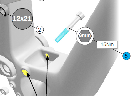

Just curious about this as it appears that the design uses the bolt shank as the bearing surface for the shock mount. I’ve only experienced a hand full of full suspension bikes but all of them used the bolt only to nip up the frame mounts to “top hat“ hat style bushings. The bolts sole purposes was to pull the frame mount together, then this would hold the bushings around which the shock rotated. In theory, you could have a 1mm smaller diameter bolt, would make no difference so long as it clamped the bushings in place.
I’m really surprised to see the shock mount has been designed to rotate around a threaded portion of the bolt.
I am following this thread as an Exe is on my watch list.
It's not supposed to rotate around the bolt, the rotation should take place in the eyelet and either the DU or metal bush in fox and rockshox. I suspect the lateral play of .2mm CAN (and might not) loosen the sleeve in the frame and then allow rotation. That's why Trek just responded by reefing it up tighter.
Regarding "Reefing it up tighter", has the torque spec changed for that bolt? It was 15Nm.
If my memory serves me right it is bumped up to 17Nm if you experience any problems. I believe it is mentioned in this thread.
Thanks! Your memory is correct. I searched this thread and there are several posts confirming that 17Nm is best for the lower shock bolt.
