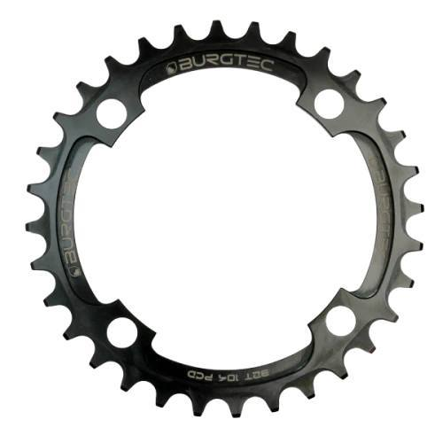

Long shot....... but, is anyone aware of a STEEL 30T 104 BCD chainring that I can fit to the E13 104 BCD spider that I have on my Trek Fuel EXE? Thanks in advance. Pic of alloy version attached for reference

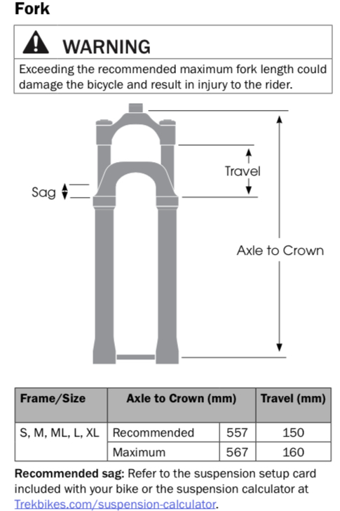

I don't think this should hold you back, but I'm noting it because you mentioned "warranty issues": a Zeb 160 is 576mm axle to crown, technically exceeding the Ex-e frame spec by 1mm. I don't see this creating material risk, and I suspect Trek wouldn't give you any grief about it... but if you did crack your headtube with that fork, they would be within their rights to deny a warranty claim.

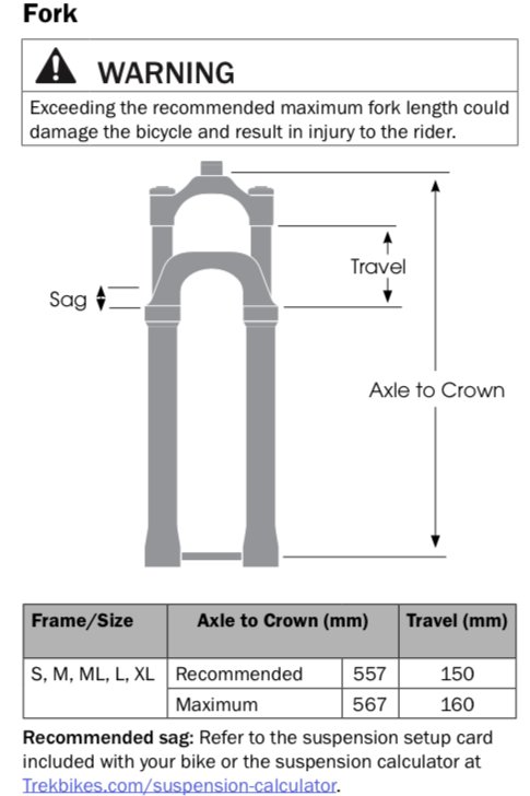

The fork with 160mm upgrade should be within the warranty.
What I was referring to is the 60mm travel of the rear shock.
The user manual says the the fork can have maximum of 160mm travel, but when describing the rear shock it is no maximum number, just 60mm as the only number.

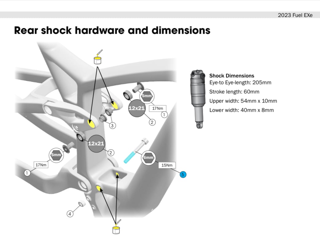

Which aftermarket shocks are compatible?​
We know that the following shocks will fit. Other shocks may fit, as there is generous clearance, but should be checked for frame clearance at full suspension compression.
- Fox Float X
- Fox DHX
- RockShox Super Deluxe
- All coil shocks from Fox and RockShox
What size hardware is required for aftermarket shocks?​
205mm x 60mm eye-to-eye, 54mm x 10mm trunnion mount upper, 40mm x 8mm pin mount lower.
That^^^ is after market with stock stroke, where do Trek state that a longer stroke shock cannot be fitted?
Exactly where does Trek say that you can NOT fit a larger travel rear shock?
These are the two places I found references to shock and fork stuff in the owners manual.
The fork specifies maximum, but the shock doesn’t have such information, and therefore they have specified that stroke shall be 60mm and nothing else. And that ‘s why I suspect that a warranty claim related to any kind of damage from installing i.e. a shock with 65mm stroke, you are on your own.

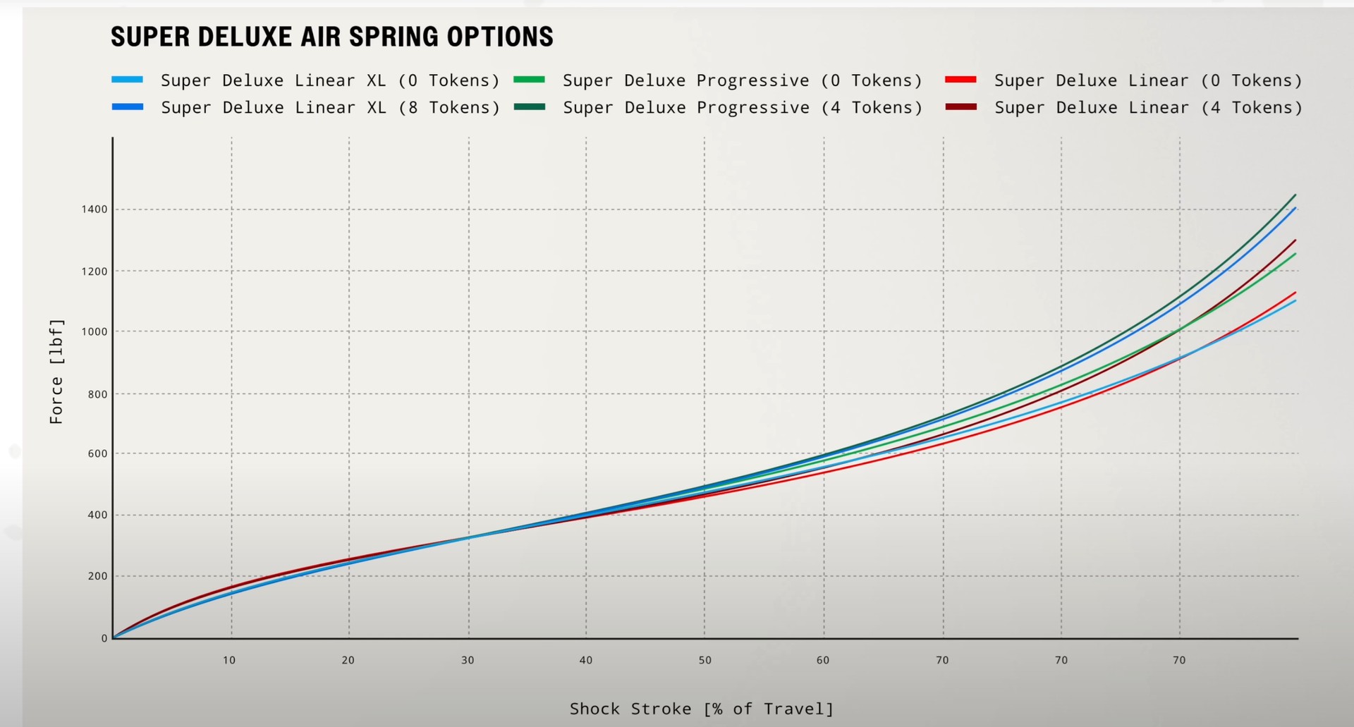

It depends how many volume spacers you put in it. It can be configured to be slightly more linear than the linear air can or nearly as progressive as the progressive air can. Ie it's a single air can that can pretty much do the same as the linear aircan and the progressive air can depending on how many spacers you fill it with.
Rockshox has a graph comparing the spring curve of it with the linear and progressive air cans. I'll try and find it.
Here you go, see about 2 thirds of the way down this oage
