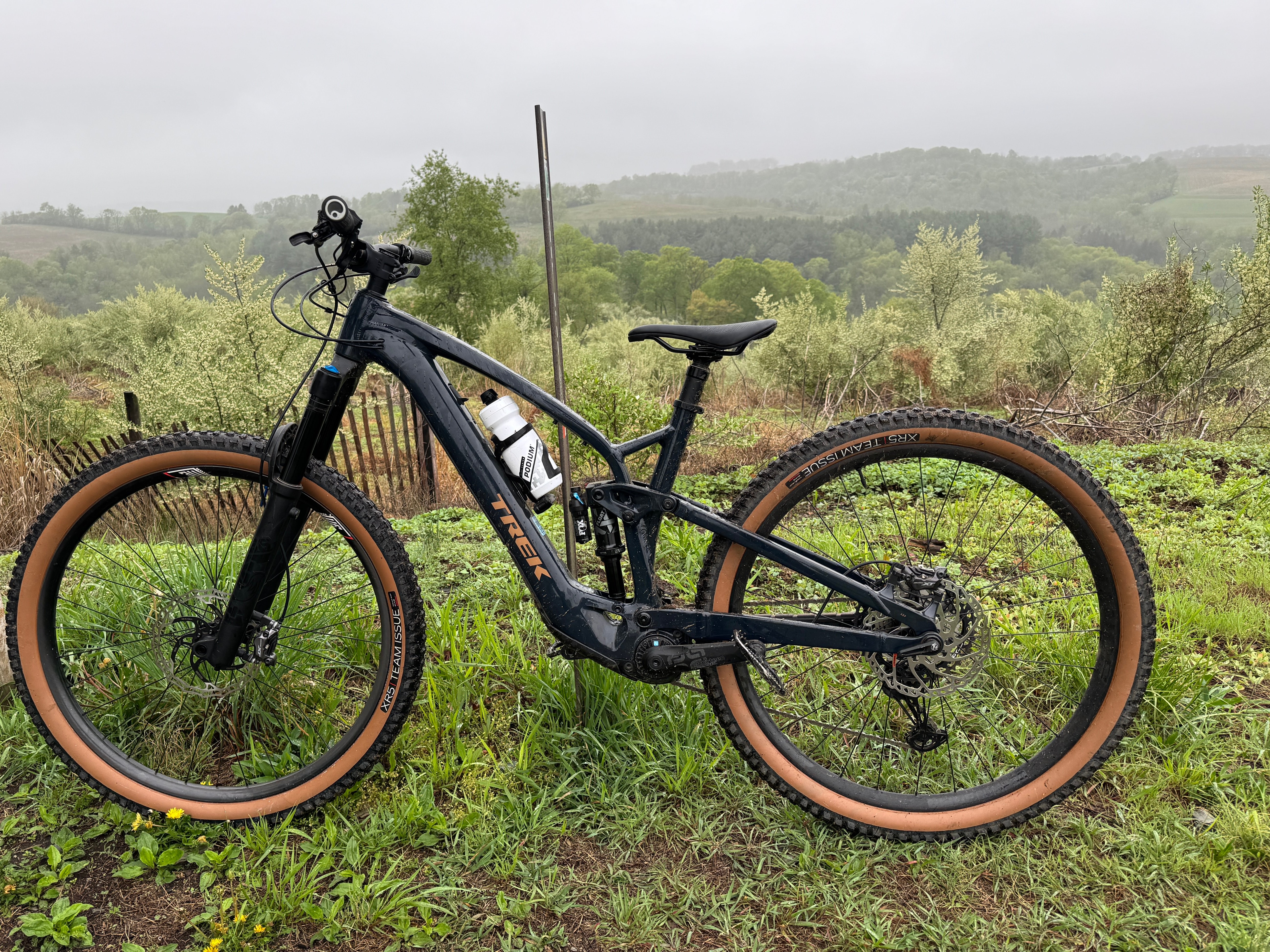

Hey all, I recently picked up a lightly used exe aluminum and have had a blast riding it! Its a great bike and I've maxed out at 3,250 ft of elevation on one charge so far with 7% left.
I noticed there is a rattle noise from what seems like the bottom bracket / downtube area when riding over rocky terrain or landing jumps/drops. Any ideas what could be the cause of this, and is it common?
I tried searching through this forum but didn't see anything with the same issue. I checked all of the linkage, shock, thru axle, brake caliper bolts as well as the battery holder bolts (basically a full bolt check) and the battery seems very secure in the downtube. Thanks!

Look at this link , could this be what you hear? Lower Shock Bolt for Trek Fuel EXe

The Allen key tool that's stored in the rear wheel axle rattles, it could be that. Remove it and see if the rattle stops
That could be it. I didn't think it would cause such a loud rattle but there's a chance. I'll order this if other quick fixes don't work!

I'm going to try this first as an easy fix. I thought of removing it prior since I always carry allens anyway.

From what I see in the photo the noise could be coming from the rear brake pads, you are about to lose the spring.

I see you have finned brake pads, those are notorious for rattling. Try putting a piece of mastic or padded tape in between the finned part and caliper. That fixed my rattle on my 9.8.
