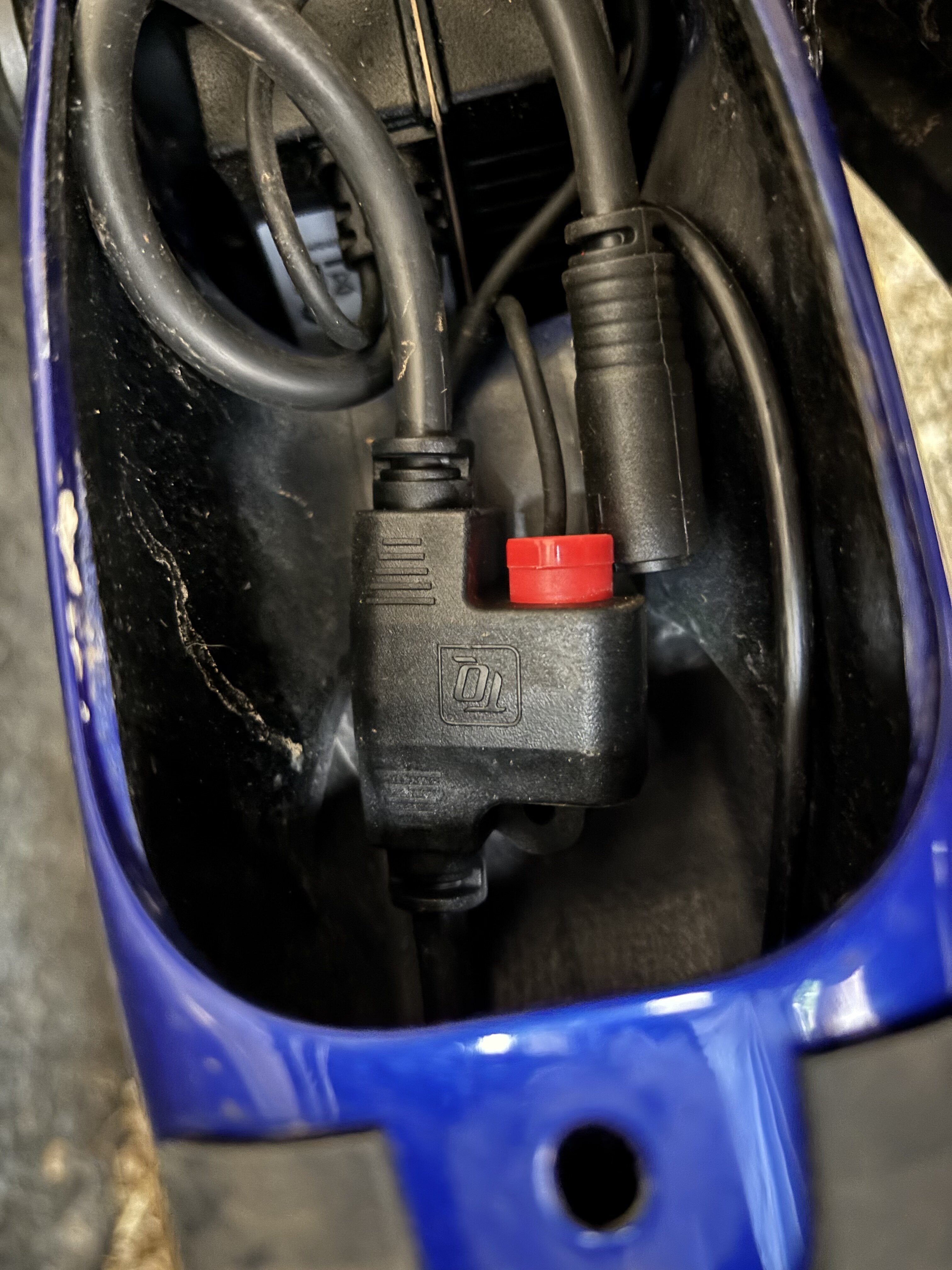

Will give that a go later. Tried unplugging the ones from the display but they seemed on there so tight I didn’t want to break them!
If the main battery connector is not in the 'locked' position it can vibrate loose and cause that error
Tried battery in and out a couple of times. Will check the display wires later and see if I can get it to go!
That would be why lol

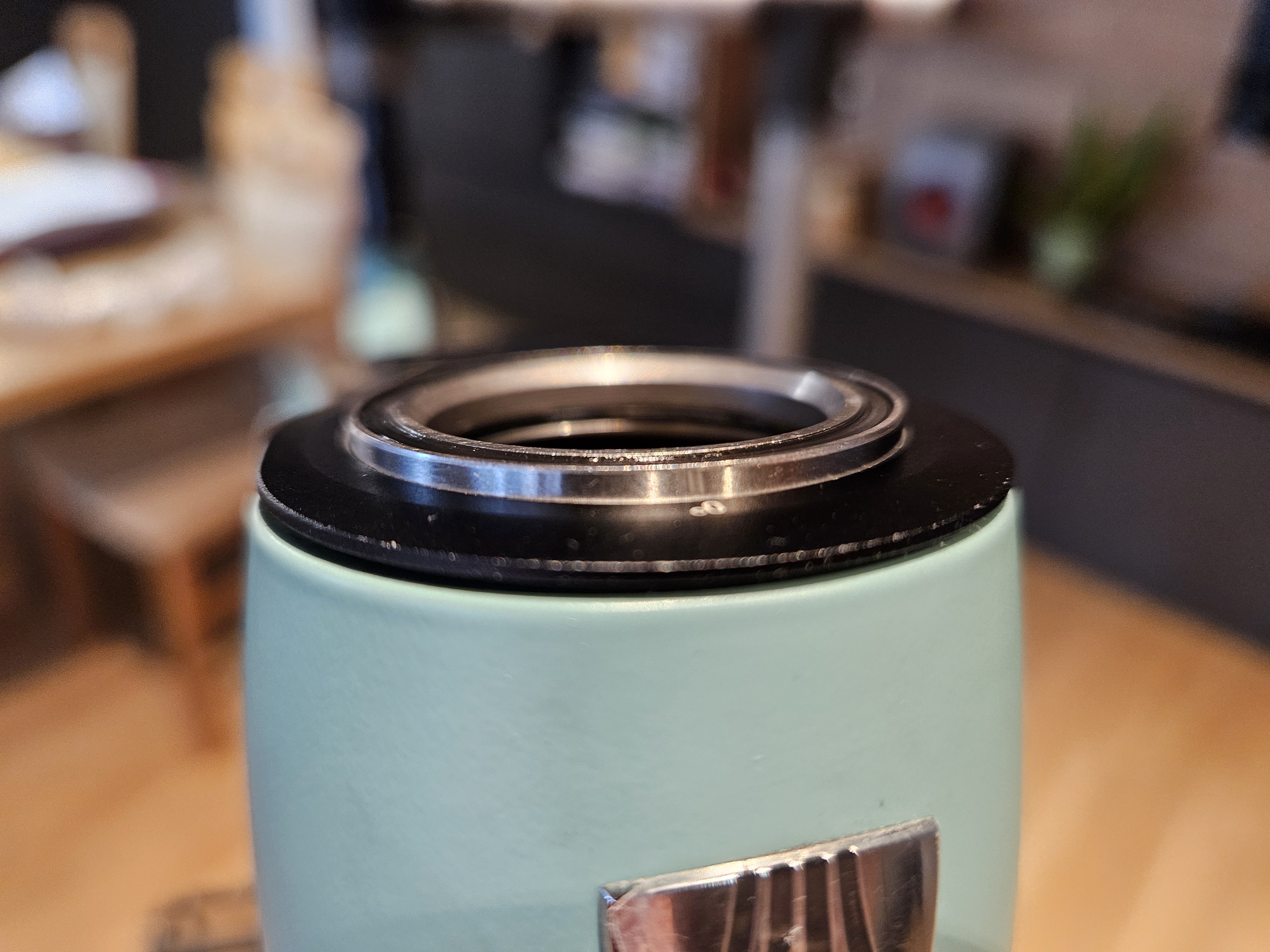

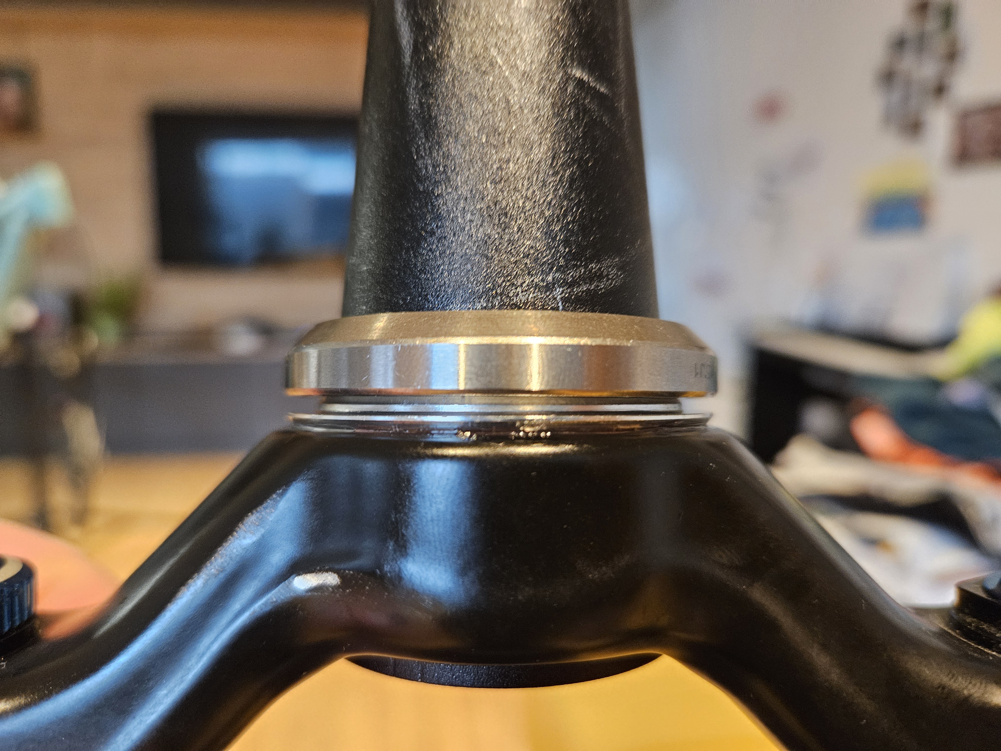

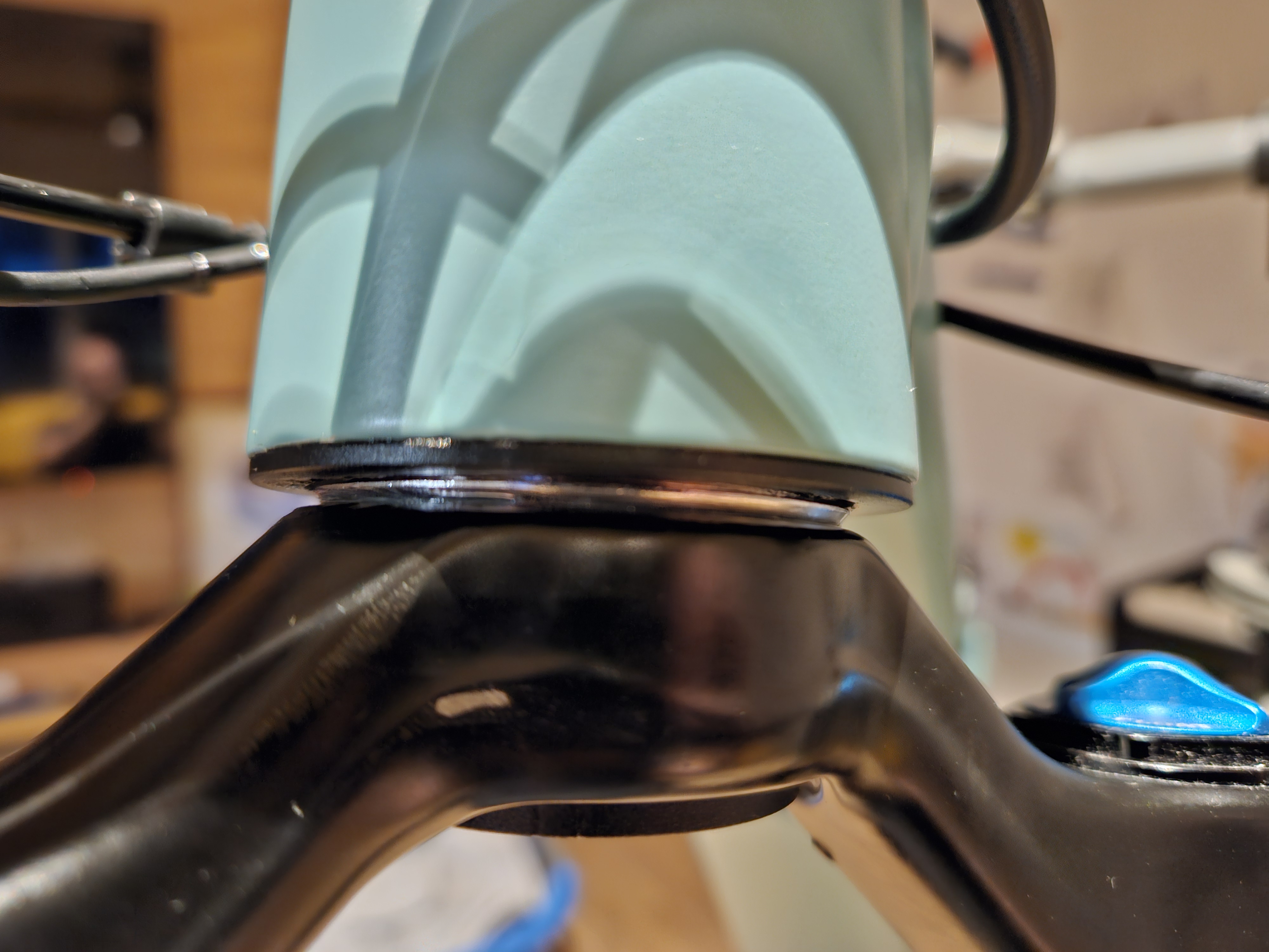

Hey guys, hope someone can check on their bike and chime in with a dilemma I'm having. Trying to replace the fork on my wife's Fuel EXe 5. I moved the crown race from the stock Rockshox Recon Silver to my old Fox 36. Now I am getting this 2-3 mm gap between the race and lower headset bearing. Aren't they supposed to sit flush? This way the fork can't sit flush with the frame. Is this normal, am I misremembering the original fork having no such gap? Just doesn't seem right for dirt and water to have pretty much direct path to bearing seals. Much thanks for your input.
At least the lower bearing sits nicely in lower cup. Upper bearing doesn't even sit flush with it's cup. This is doing my head in o_O .
It appears you still have the lower crown race on the CSU. You need to remove that I think.
As for the upper, if the bearing is fully in, then it must be the wrong bearing thickness.
It's the same bearing that was on the bike before... And the same crown race was moved from one fork to another.
It’s not a 1.8 rather than a 1.5 fork?
Fox spec by code says it's a 1.5T. Besides, crown race wouldn't fit if it was a different taper, right?

I'm coming to the conclusion that it's normal and supposed to look like that :sleep:

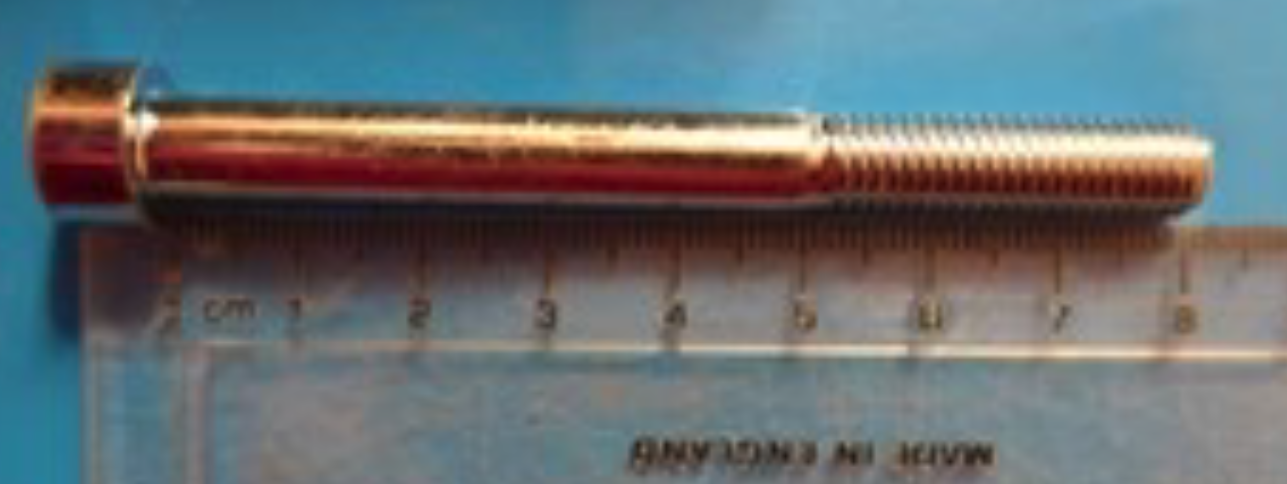

Yes I'm just getting across this too - once you have any movement in it it will have damaged the shock bushings (replaceable) and the frame (yikes) so im jumping on this on my wife's new one - looks like m8 SHCS by 80mm fortunately has the right grip length (will need to check on assembly) so that will resolve the threads eating the frame on one side issue so I'm doing that now while waiting for Pinner to do another run with the correct bolt diameter. I was going to rail against whatever engineer specified using a gutter bolt in double shear on a suspension fitting but we all know marketing rules. Wont be rustproof but lesser of two evils. This is the link to the entry earlier in this thread about the correct solution. Fuel EXe - Trek Fuel EXe Megathread!

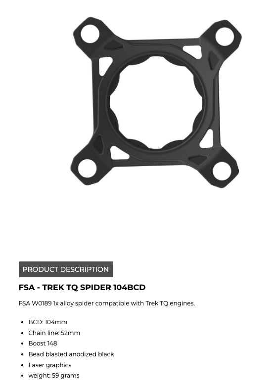

I'm currently piecing together a new drivetrain as mine is getting worn and due for replacement.
I'm in camp Shimano and looking to move from the one piece chainring to a spider and easily replaceable 104bcd chainring. The stock one piece chainring chainline is 55mm.
This FSA spider is available locally. I see it has 52mm chainline, whereas the ones that come on other models are using a 55mm (part No. W0190).
Wondering if the one available locally will work OK, and fit in the chainguide that comes on the exe. Will I need a chainring with an offset to get it back to 55mm, or is the offset accounted for in the spider instead of the chainring with this configuration?
All a bit confusing for me, so hoping to get a clear answer here. Thanks in advance!
