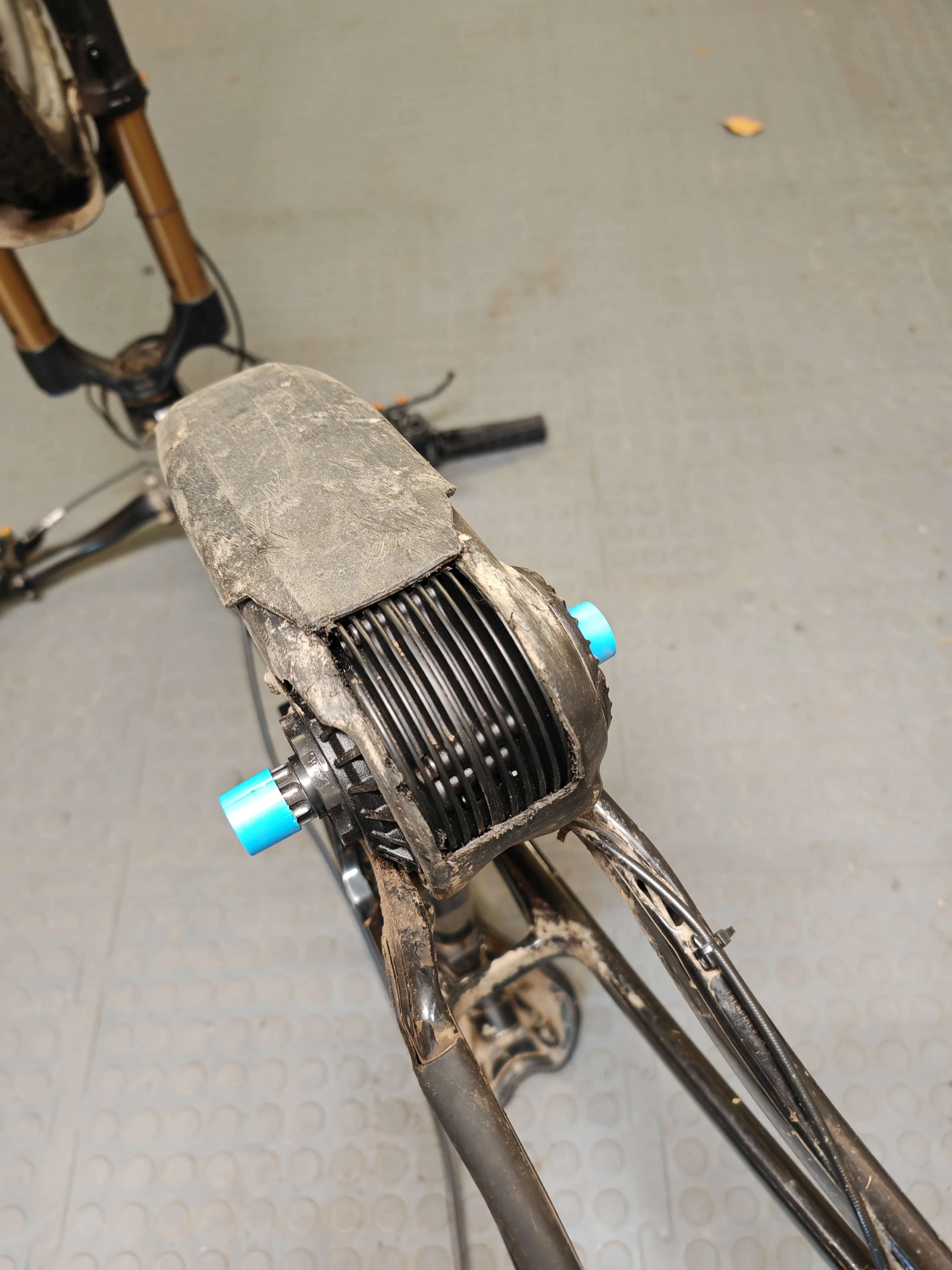

Has anybody fitted an HPR60 to an EXE and kept the cooling fins on. Most interested in what the hack is to get the motor cover to fit. Asking cos my constantly overheating HPR50 is making some unhappy noises and will inevitably expire at some stage
Out of interest, what range are people getting on the Fuel EXe with the HPR50 motor when they're using the range extender?
Yes I did this.
You just need to cut a hole in the plastic motor cover large enough for the fins to fit through. You also need to modify the separate battery cover to shorten the two tabs that locate it into the motor cover.
It's easy to do with a hot Stanley knife blade or hacksaw blade
Yes I did this.

The exposed fins are removable, so I guess if they get substantially damaged you could just buy a new set and fit them.
Difference wise, the extra 10nm torque is noticable, but the max power is the same as the hpr50 at 300w.
The hpr60 motor is noticeably quieter than the hpr50, and it seems about 15% more efficient.

You don't get the choice to use 350w max power when the motor is fitted to a bike that originally came with an hpr50 motor. The tq dealer software forces you to have a max of 300w
Are you saying that max power is controlled in the TQ dealer software? So if you know a guy.. it is possible to change it there?
The motor requires that you 'activate' it using the dealer software, if you don't activate it then it doesn't work and just throws an error.
When you activate it you need to enter the serial number of the bike it's going into, the software then does a lookup on a database that tq hold to find out if that bike serial number originally had an hpr50 motor, if it did then it sets the power limit to 300w.
You could in theory input a serial number of a bike that was sold with the hpr60 and get the full 350w, but then there would be two bikes allocated to the same frame serial number, so not sure if that would cause warranty issues further down the line, or software update issues.
