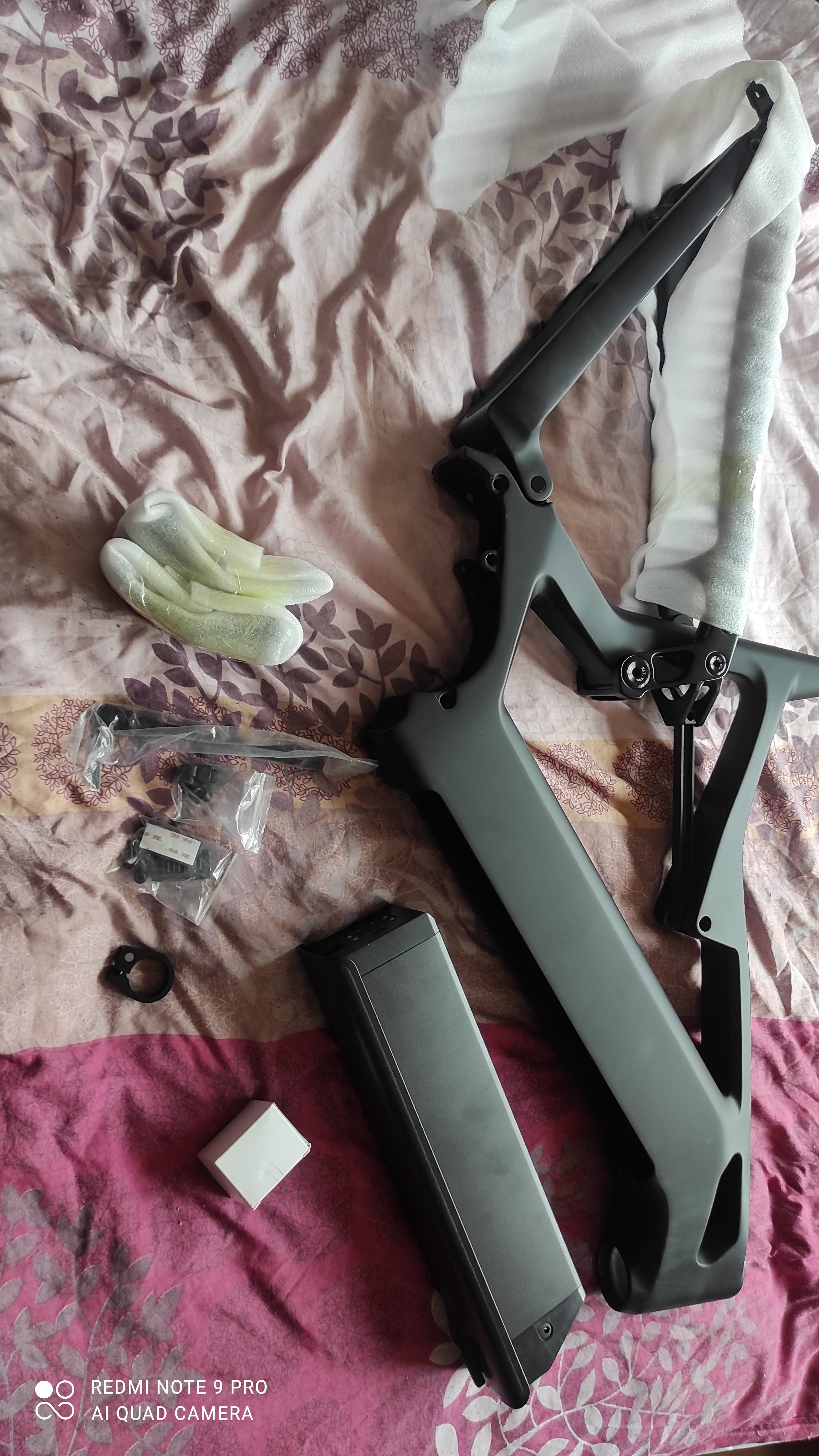

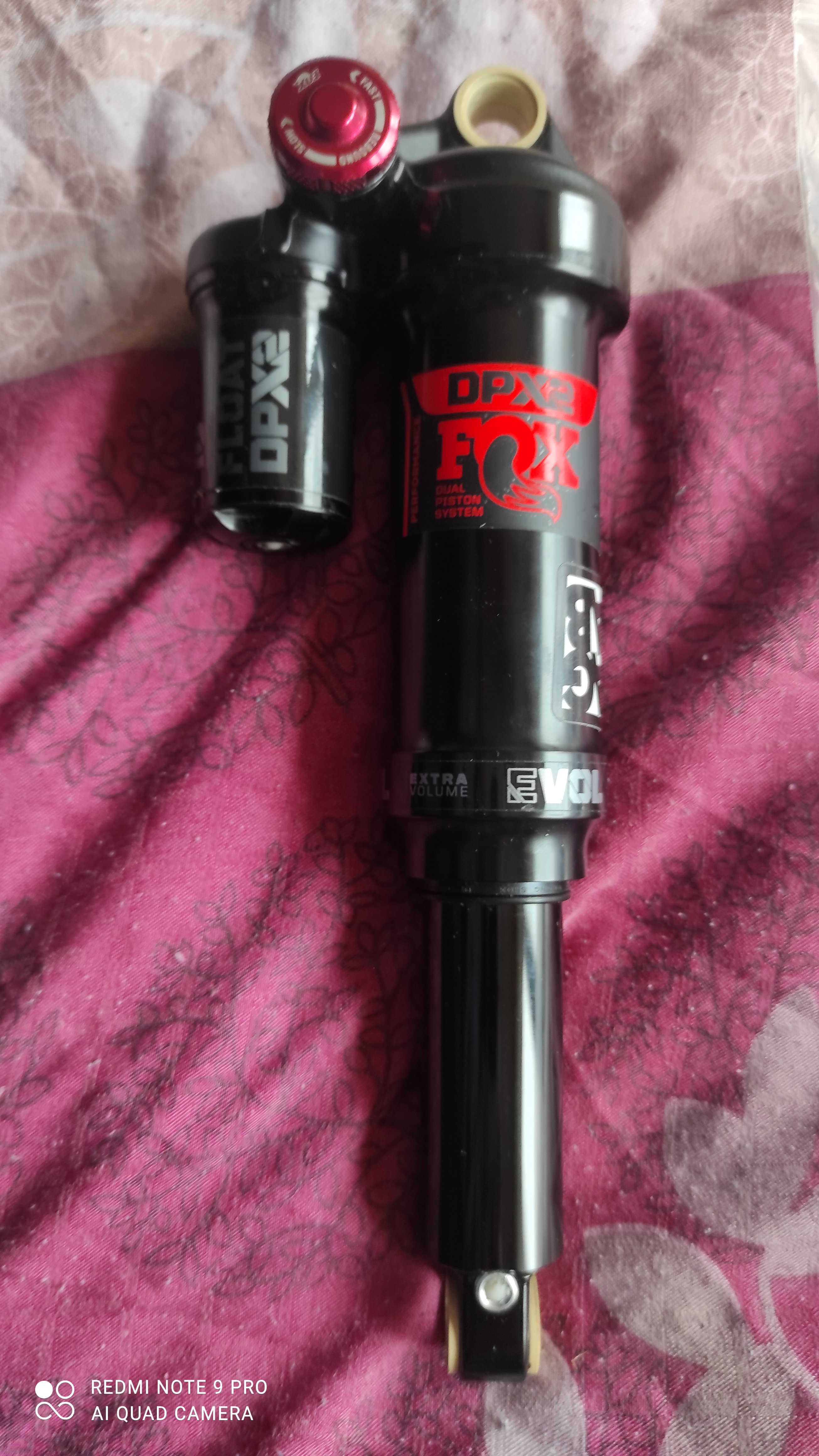

Looking to sell my E55 frame(size L, Matt black). I bought the frame for a project I had in mind but as time went on I have dropped the idea and hope that someone might find this interesting. The frame comes with a headset, spare bashguard, rear axle, battery box and a few other small bits. Frame located in Estonia and willing to ship across Europe. I also have fox dpx2 230x60 in case someone's interested. Willing to make a good deal for the whole bundle. If interested please DM
View attachment 135990 View attachment 135991
I would've bought it right away from you, unfortunately i already ordered 2 weeks ago. :(

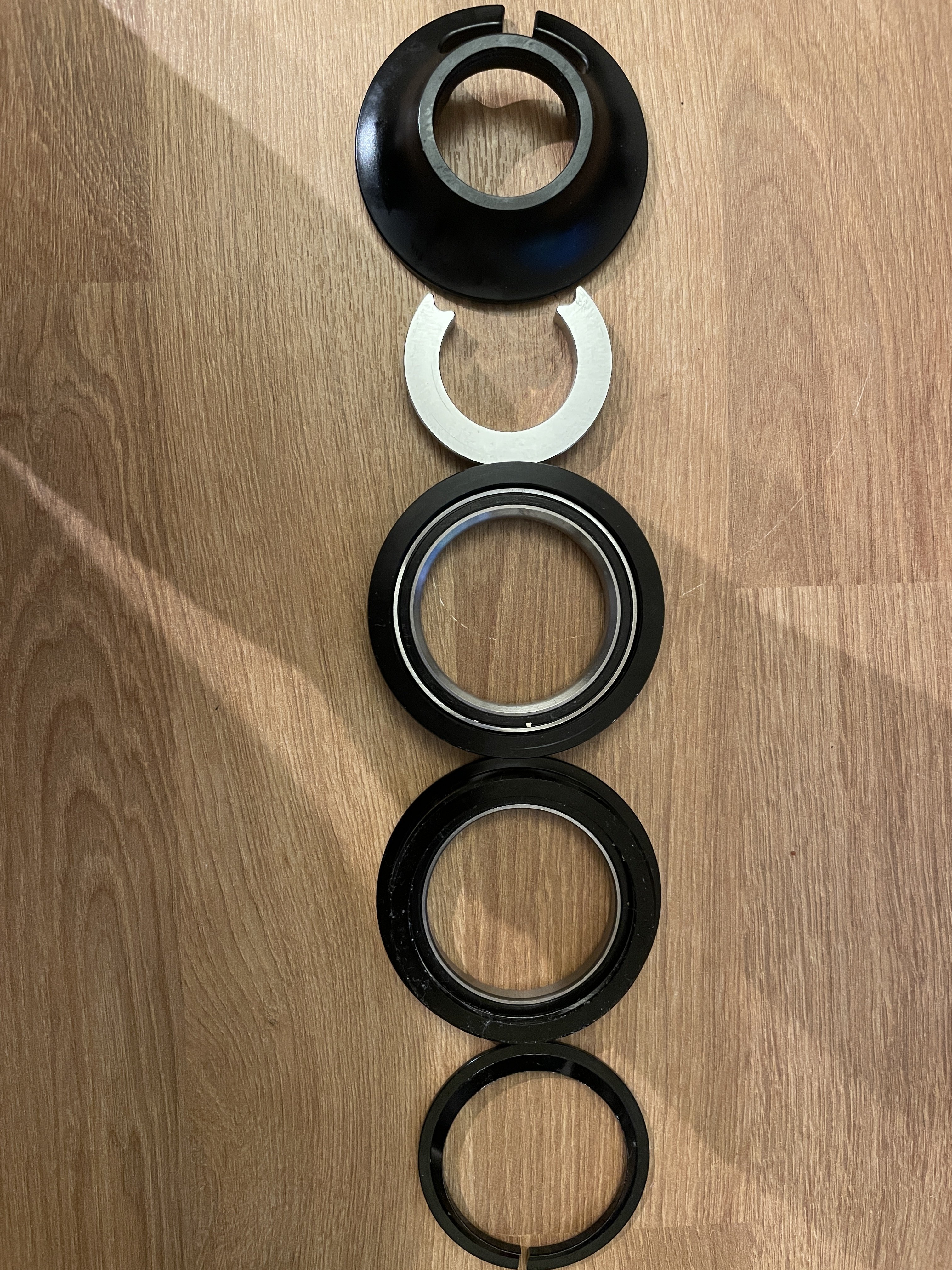

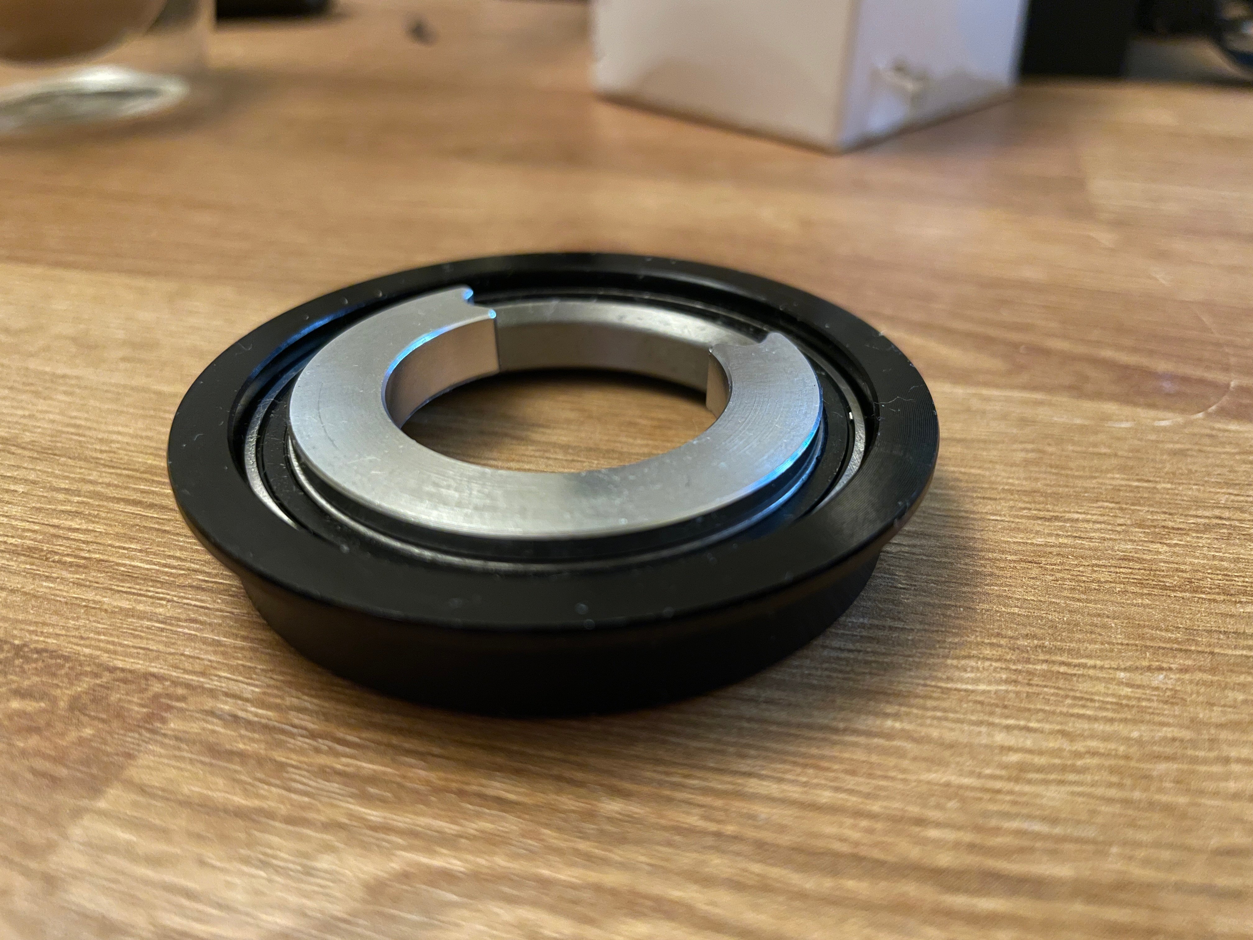

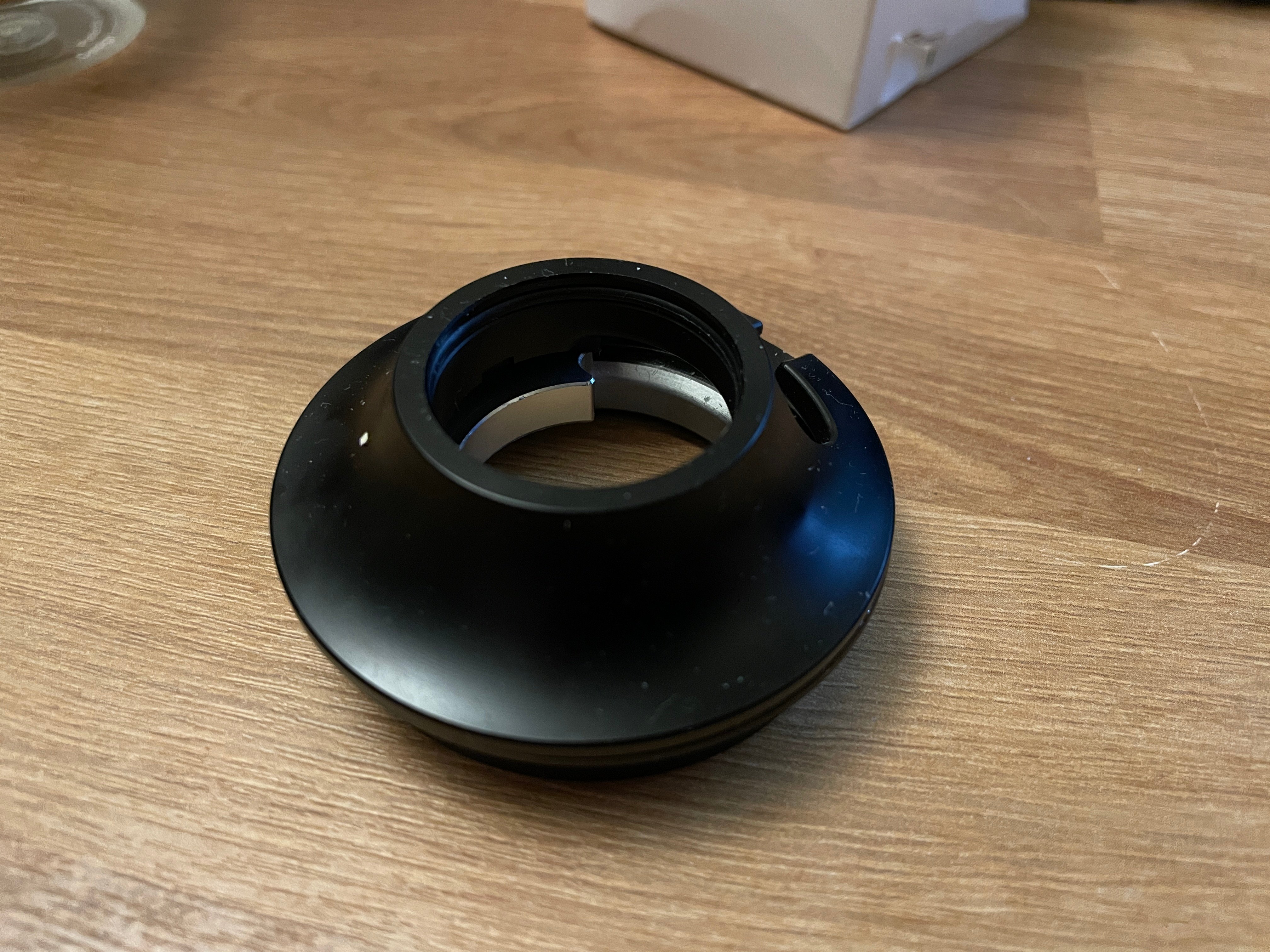

It looks about right. It looks like they changed the headset design and split the top part on two parts.
I genuinely didn't know the way it went together until I fitted it to the fork. Once I assembled it it was immediately obvious.

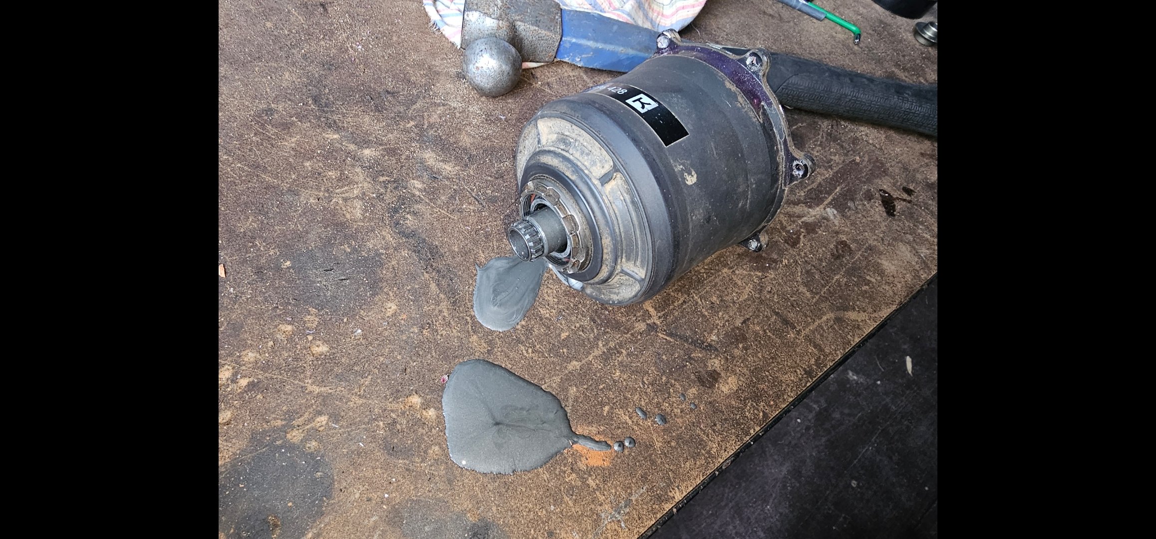

Kindernay VII is amazing except one issue - it leaks oil. And the worst part of it is the oil gets on the rear brake over some time. If not this issue it would be the beat gear hub ever created. It uses regular brake rotors and regular Shimano cogs so changing those parts is not expensive and you have a bunch of options. It has cool hydraulic shifter also. It tolerates my 3000W Innotrace motor controller without issues.
Service parts are cogs (standard Shimano cogs), rear brake rotor (standard 6 bolts brake rotor), oil (I use Red Line D4 ATF oil), hydraulic oil (I use Magura blood)
If there are internal issues I doubt you can find a service to repair it, but I did not see anyone had internal issues with it except the oil leakage.

My Kindernay VII died today. I did 30 mph in light uphill on my Bafang m620 with 3000W Innotrace controller, everything was fine and then all of a sudden quite loud inconsistent clicking sound with resistance spots. I was thinking something happened with the Bafang m620. But after inspection I realized the source of the issue is the gear hub. I was able to get home, inspected thoroughly and found the rear wheel locks when I rotate it backward. It also can lock rotating forward but if I put enough force it can overcome the resistance spot. Changing gears does not change the behavior.
So if you are planning to put a lot of power on the rear wheel maybe skip Kindernay VII.
I am sure though my gear hub did not experience excessive torque because of I used smallest cog and biggest chainring but it died anyway.

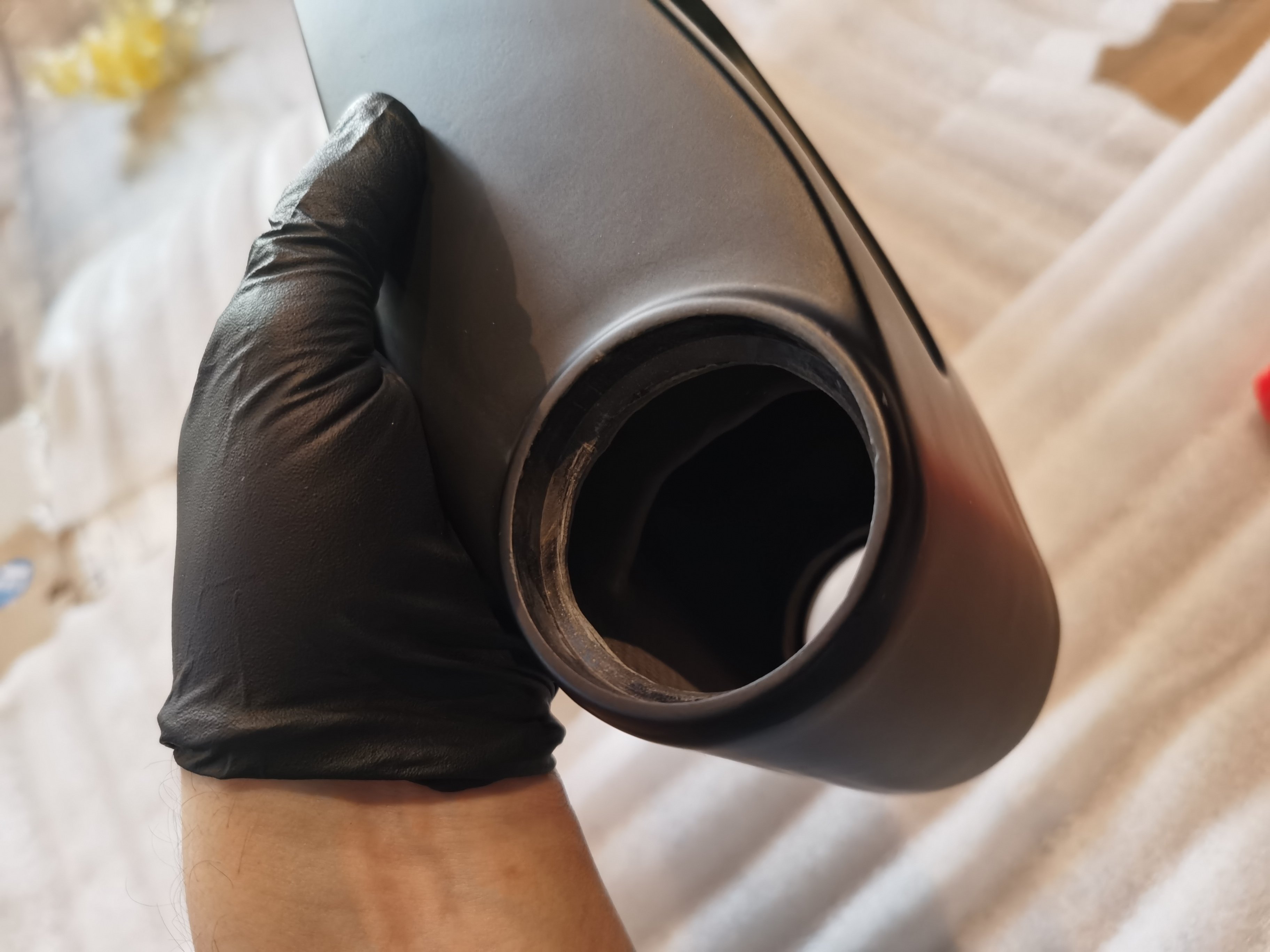

Installed the headset cups supplied with the frame gradually snugging the headset pressing tool and lightly tapping with a soft plastic hammer around the cups. The parts fit good.
The headset cups top and bottom are the same. Mounting diameter is 56 mm, mounting depth is 7.8 mm.
Hi, hoping TQ or anyone else can confirm. Are the upper and lower headset openings ZS56 size. I have ordered a E55 frame, but it is not delivered yet.
I believe the bores diameters in the frame is 56mm and allow to install cups with up to 7.8 mm tall insertion portion if I said so. The cups and the bearings are the same for top and bottom. The cups flange outside diameter is about 62 mm. I do not know other sizes. The frame should be delivered with the headset parts. If you consider to install other headset you need to search the headset sizes of the parts you want to purchase (it looks like different manufacturers do them different). I do not know what ZS56 sizes and standards are. I remember people had problems fitting aftermarket headsets in some frames because of the headsets cups insertion portion was too tall for the bore in the frame.
Thanks for the info. That sounds like ZS56 top and bottom.
FYI. With regards to head set sizing, there is a Standardized Headset Identification System (SHIS) which is used to identify and classify the various headset standards. ZS means Zero Stack. Which is bearing cups pressed into a frame, with cartridge bearings into the cups. They call it Zero Stack because it doesn't add anything to the overall Stack of the headset, it is all inside the frame head tube. 56 means 56mm. There are alot of different sizes. But 56mm is quite common for lower cups as it allows for a 1 - 1/2" tapered steerer. Often the upper cup will be smaller like 44mm. From there you can then go on to describe the steerer tube dimensions. At the bottom its nominal size (rounded to nearest hole number) in mm of the lower fork bearing seat. So the size for a 1 - 1/2" steerer will be 40mm, and a 1 - 1/8" straight tube steerer will be 30mm. On the upper side, they define the steerer tube sizes directly. Which for 1 - 1/8" is equal to 28.6mm.
So someone can correct me if im wrong, but I expect that it is :
Upper ZS56-28.6
Lower ZS56-40
The reason I ask is I want to fit a straight 1 - 1/8" steerer dual crown fork, and an angle set, and want to get the parts ordered ahead of time

With regards to kindernay vii. I have destroyed 2 of them now. The first one lasted ok. And I bought the second one after the company went bankrupt. I found a guy selling surplus inventory and purchased a 2nd kit. And it has just started to slip and crunch which is exactly what my first one did right before it locked up.
My Kindernay VII unit is over too.

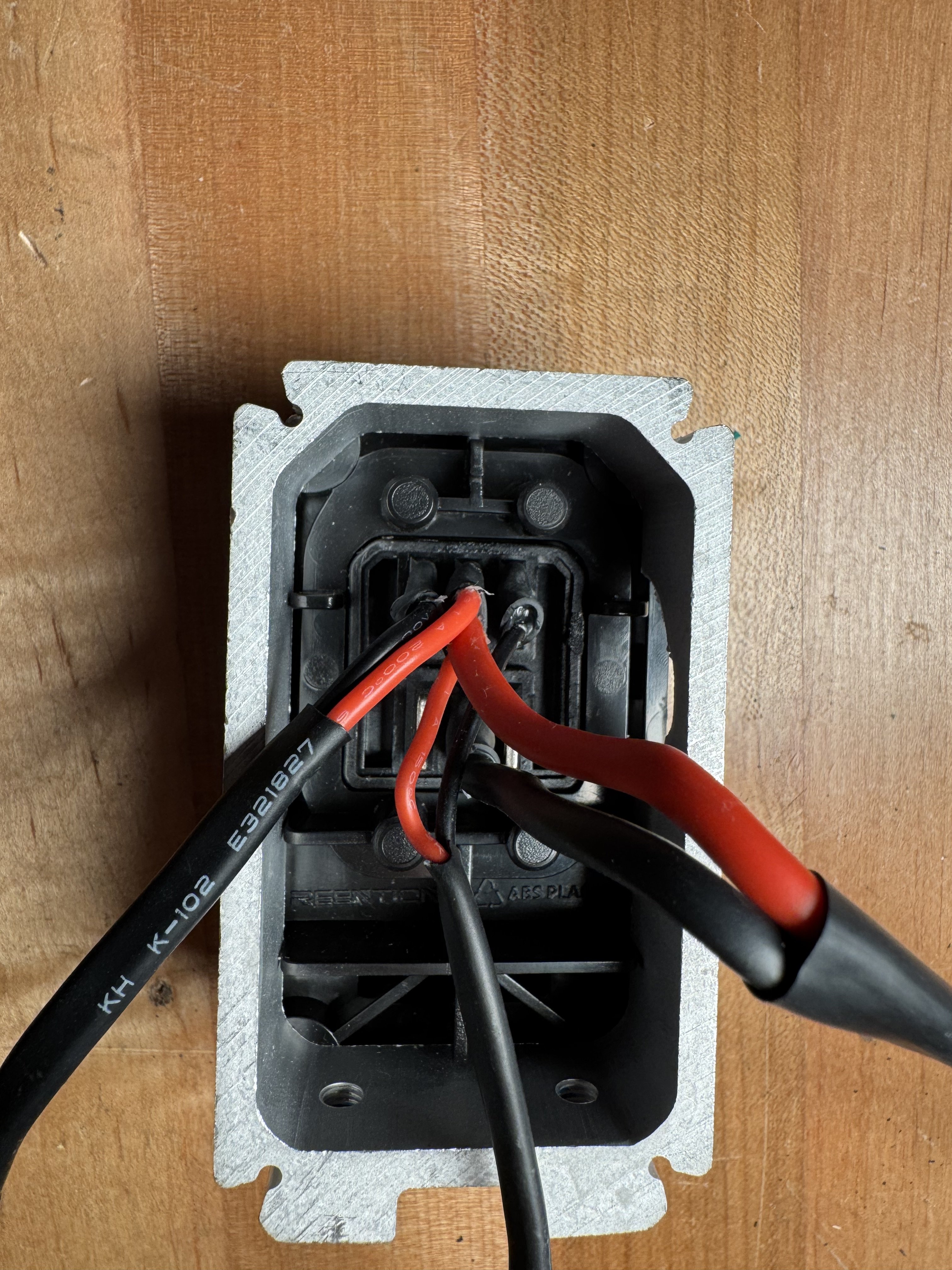

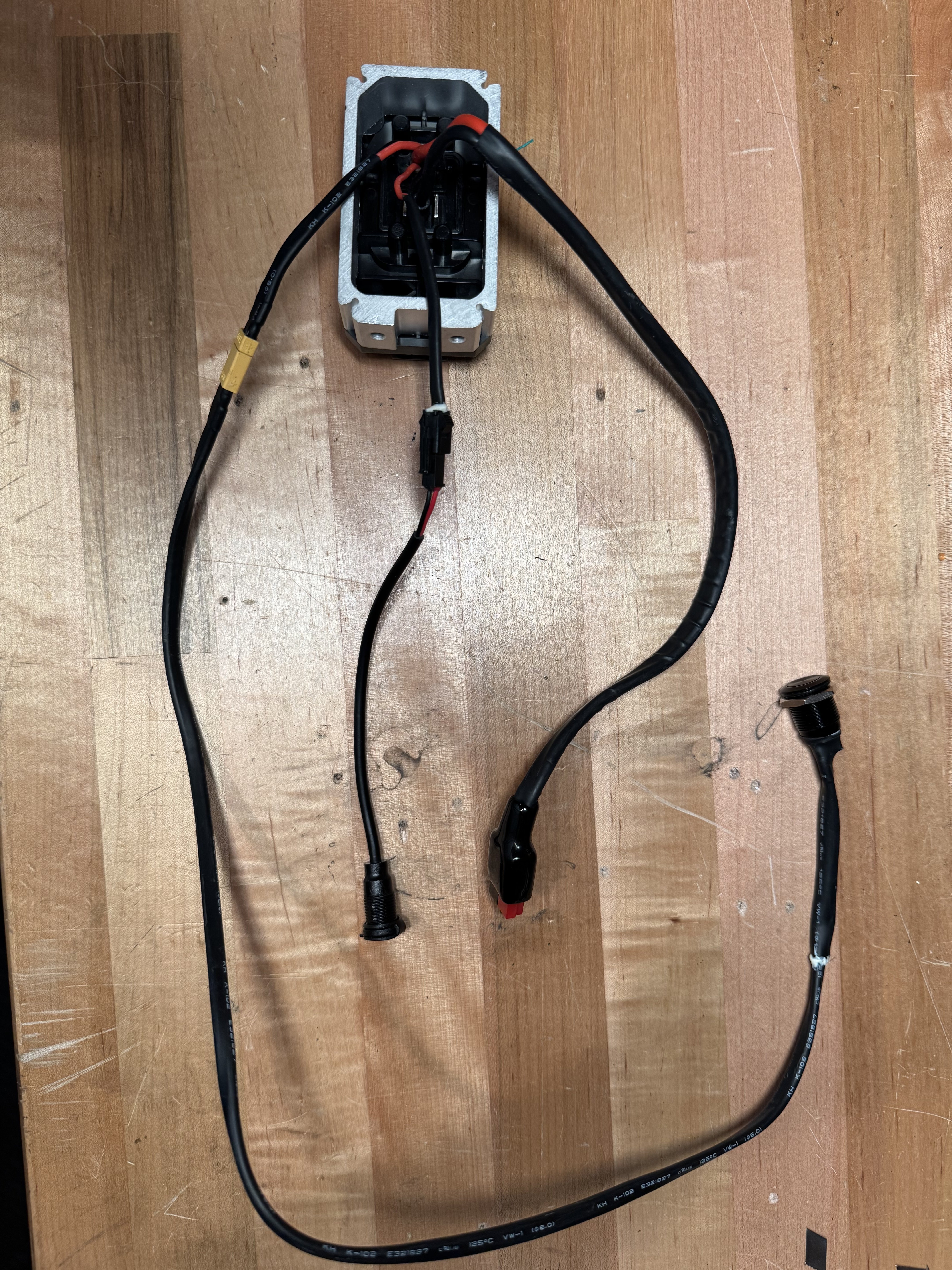

What an incredible build thread and resource! I stumbled upon this thread looking for a wiring diagram for the retention rhino battery as I’m building my own battery and E55 frame as well. It looks like you connected things a lot differently than how I was imagining it, gonna have to dive into your bms switch wiring pictures to understand what’s going on there!
Can someone who’s built one of these batteries before explain why the wires are connected this way (the battery case I bought came like this)? I’m having a hard time understanding it.
The switch is wired to +1 and +2. The charge port is wired to +2 and +3. The motor power is wired to +2 and -4.
On the battery side of this terminal block, I thought I was going to connect three leads from the battery positive side to +1, +2, +3, and three leads from the BMS P- to -4, -5, -6. That seems wrong though. And where would I wire in the bms switch?
