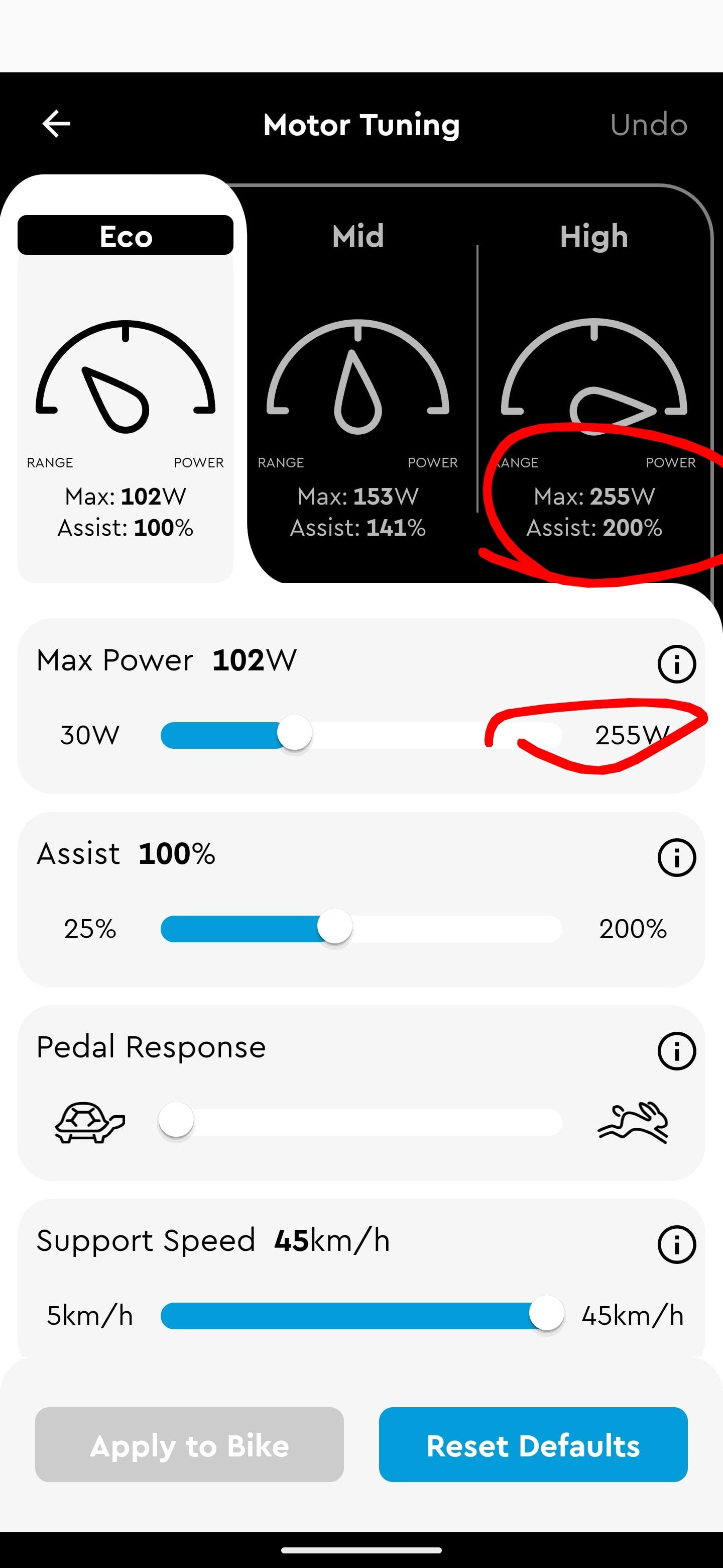

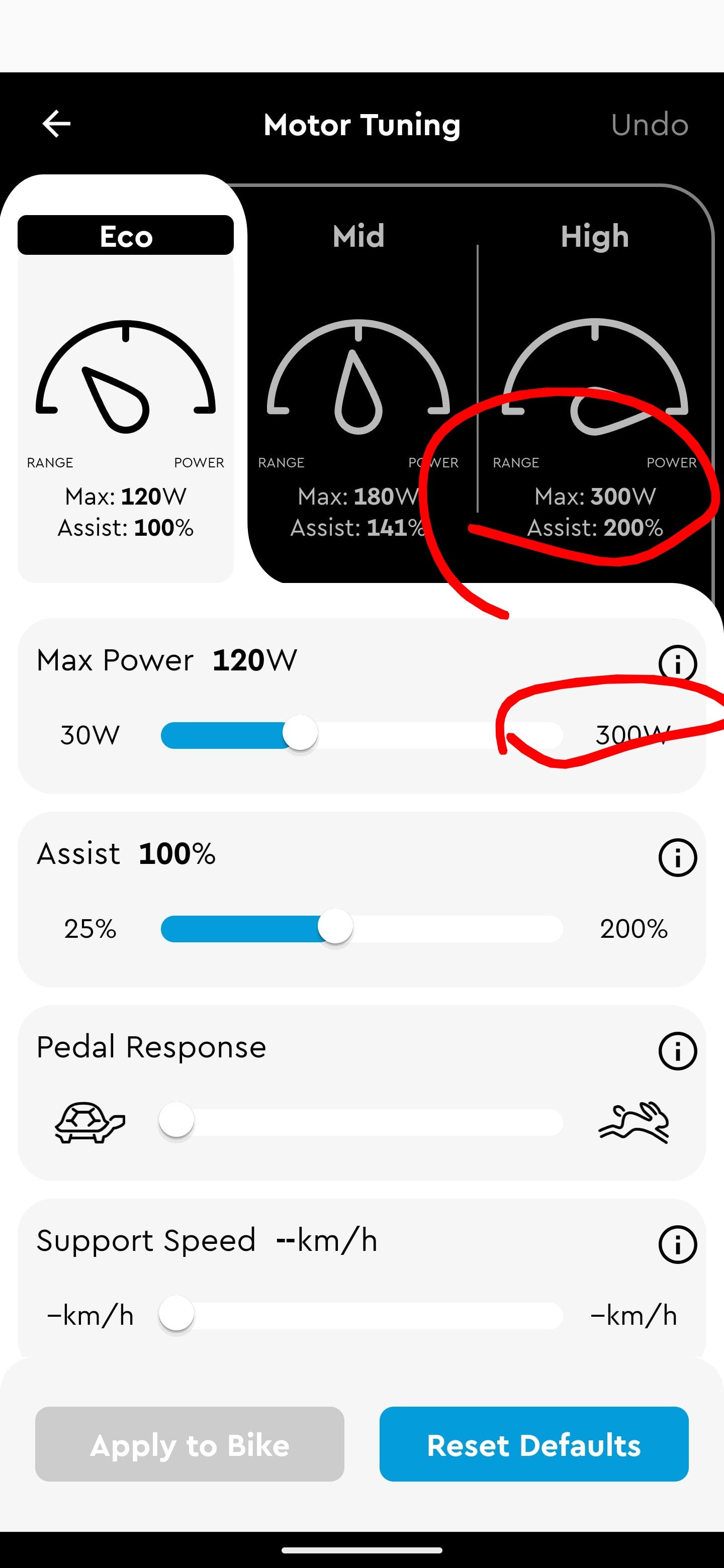

Hi all. I have 2023 Scott Solace eRide 20 and just updated it to the latest firmware via the Service Dongle/ Dealer Service Tool.
Curiously, before the update, when connecting via the phone app, the max watts available were 300W.
Now after the update, the max is only 255W.
Anyone else seen this?
View attachment 166715 View attachment 166716
no, in my case it stay at 300 w

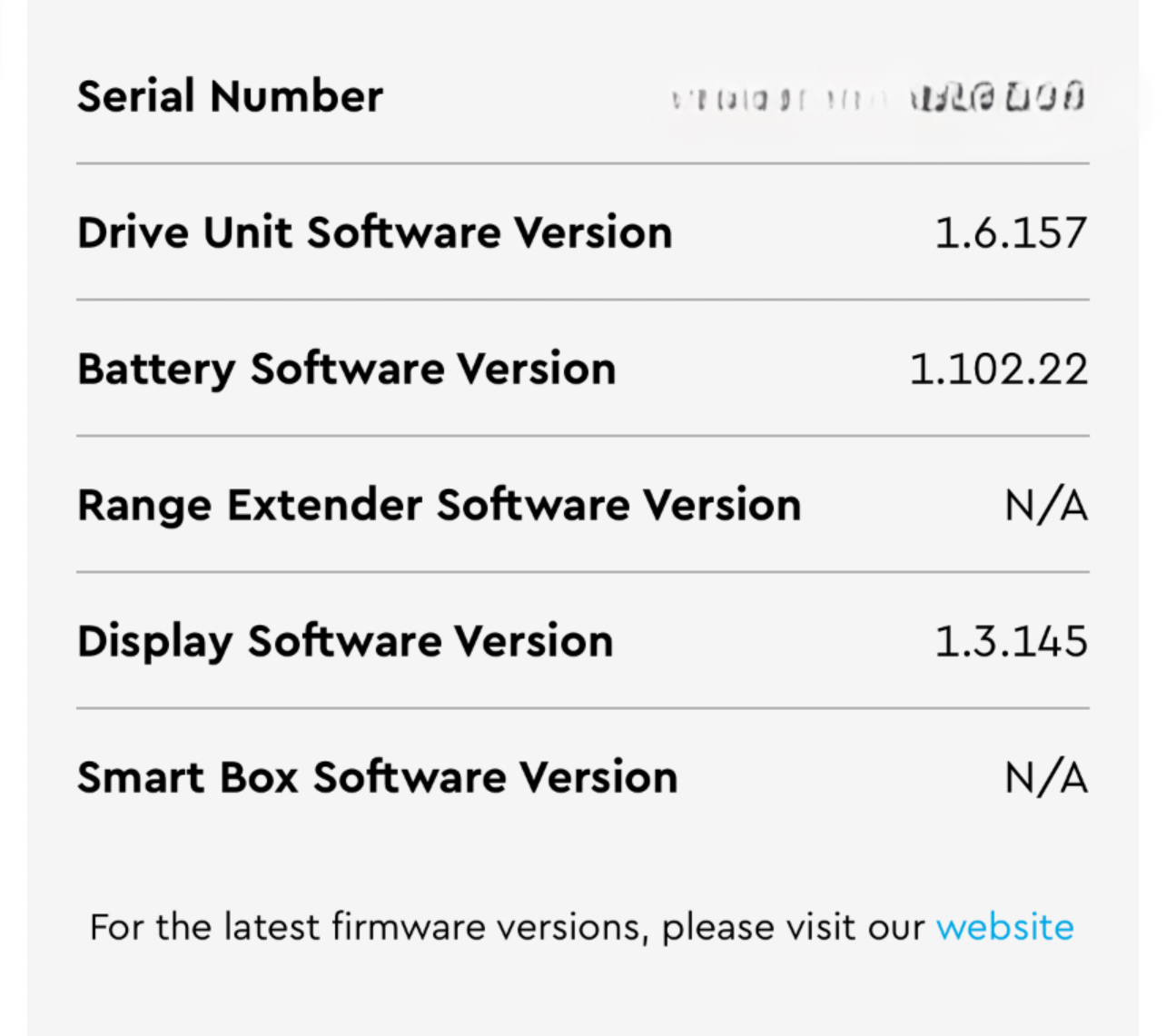

I’m not sure. My Canyon Spectral Onfly came with the motor up to date and the battery one version behind. Everything works fine but I’ve noticed the TQ battery information is nothing but dashed lines. I suspect if the battery was at the current version I would receive all the data provided by the TQ app. Maybe someone knows more about this?
Yes, early battery firmwares did not support a lot of app-side reporting. The display also has its own firmware and probably needs some minimum version to enable that. I expect a software update would fix this for you.

Yeah it’s a little strange but according to the TQ app my motor has the current version of software and my battery is one version behind. It has been working this way from the day I got the bike and I have about 1,100 miles on it so far. From what I read the latest software for the battery provides better charging strategies.

You would think so but in the TQ app it shows my motor has the latests but the battery is one version behind. Everything works fine (1,400+ miles) but I only get dashed lines for the battery info in the app. Maybe Canyon forgot to update the battery before assembling the bike who knows?

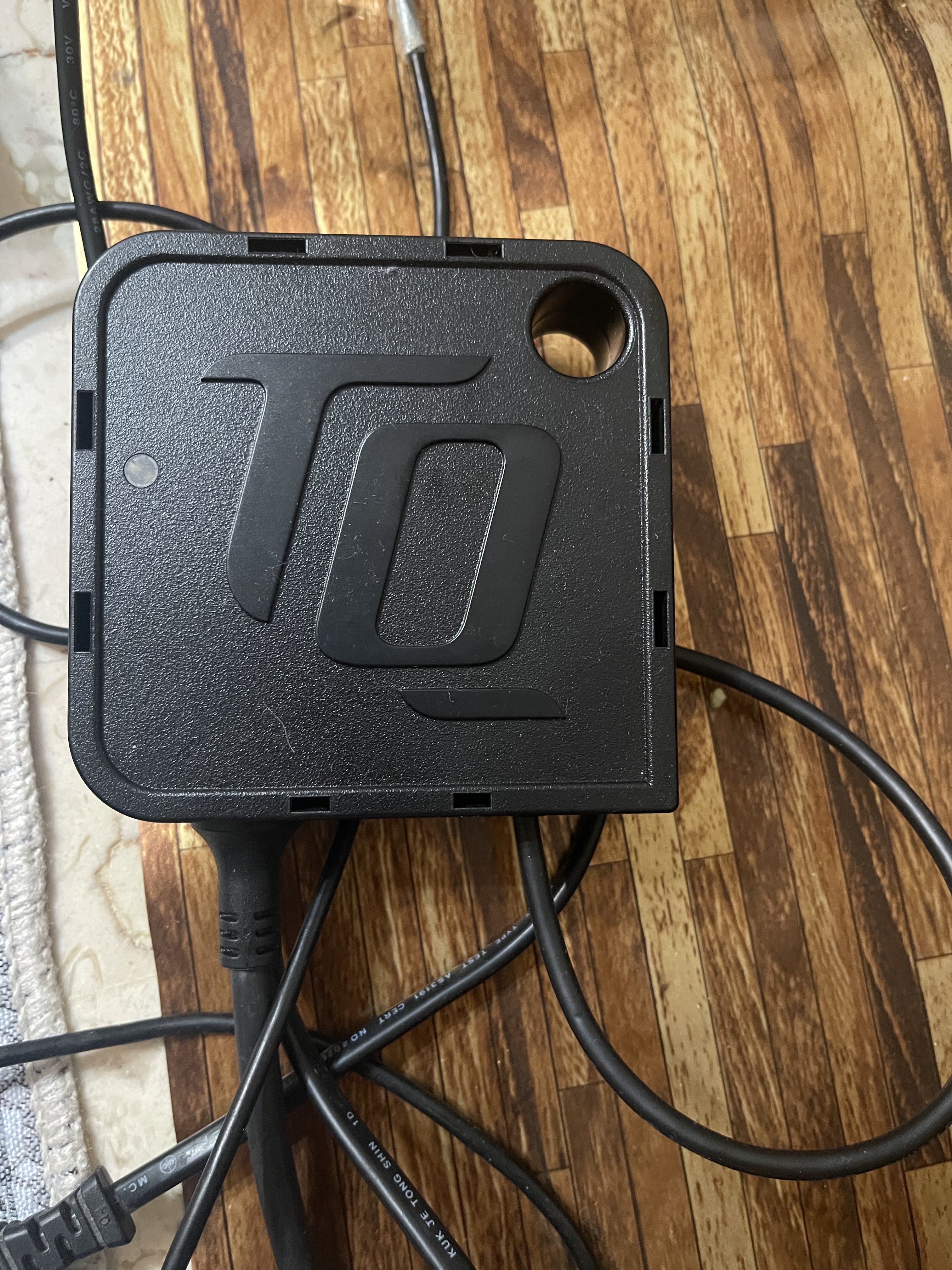

I’ve got the dongle and just myself up as a store. No issues so far.
I have also just got a dongle. Was setting up as a store difficult vat etc? Asking because having software would be a great help as the new update will allow my SRAM blips to work.
Super easy. I’ve had it for about two years. Don’t recall it being difficult at all.
