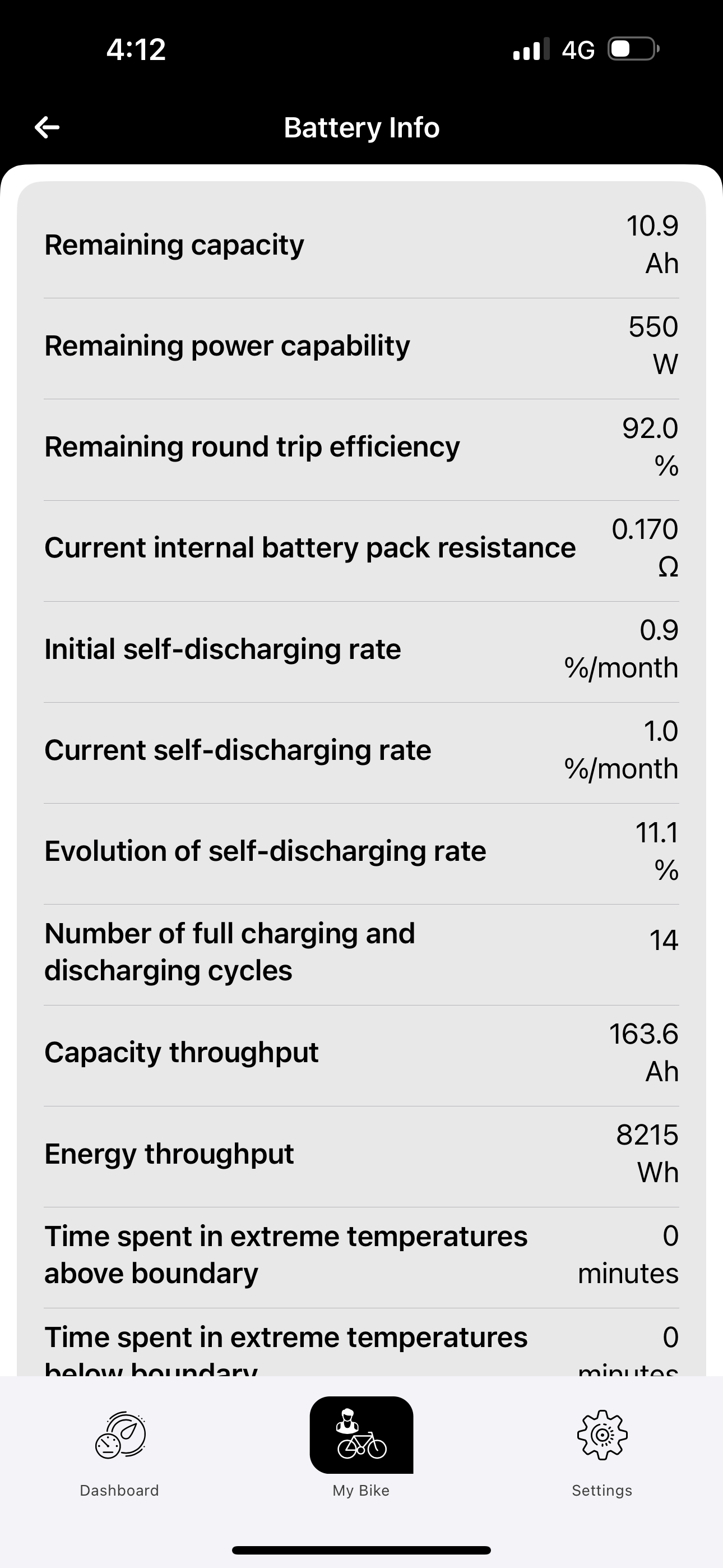

Does this look right ? Thought these were 580 batteries. Have I got 11% deg already ?
Does this look right ? Thought these were 580 batteries. Have I got 11% deg already ? View attachment 152635
It's the remaining capacity that shows how much of your initial 580wh you have left. Check the specs as published by tq in the battery manual for the stated rated capacity, it say the 580 wh battery should have 11.12ah,but your screenshot shows 10.9ah,which means your battery appears to be down by about 2%.
The remaining power capability (550w in your screenshot) is the peak power the battery can supply (in watts), and is not to be confused with Capacity which is measured in watt hours (wh) or amp hours (ah)

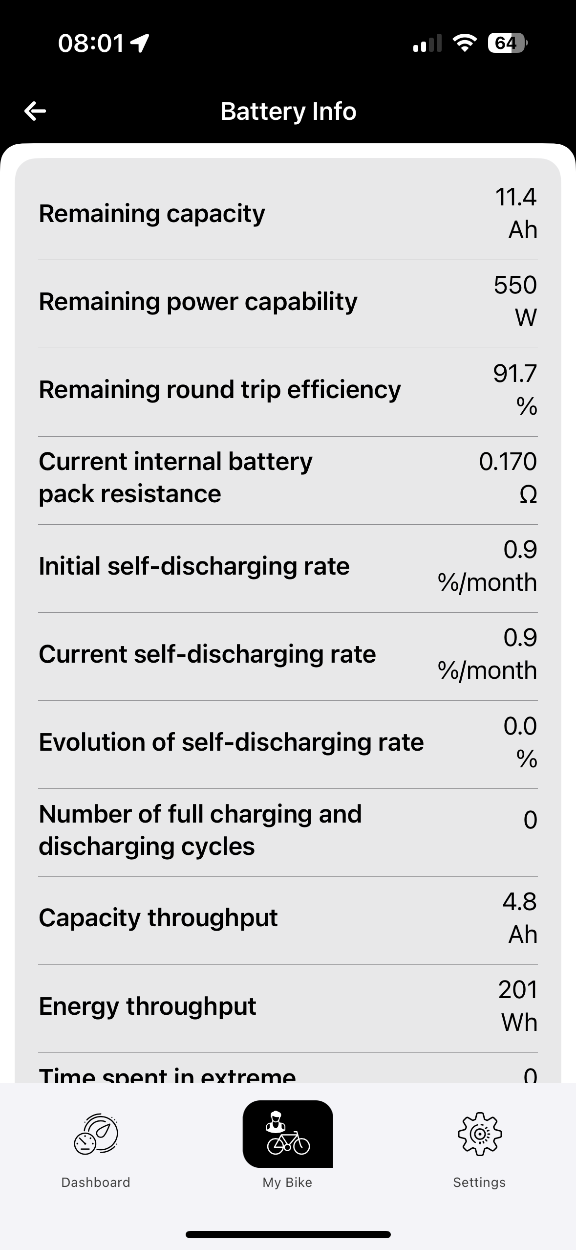

Here mine for comparison, that said I did not do any full cycle yet - so far I stayed by luck above 50% - current screenshot relate to a 67% charged battery.
Thanks. Means I'm at 10% after 1 year and 4000km

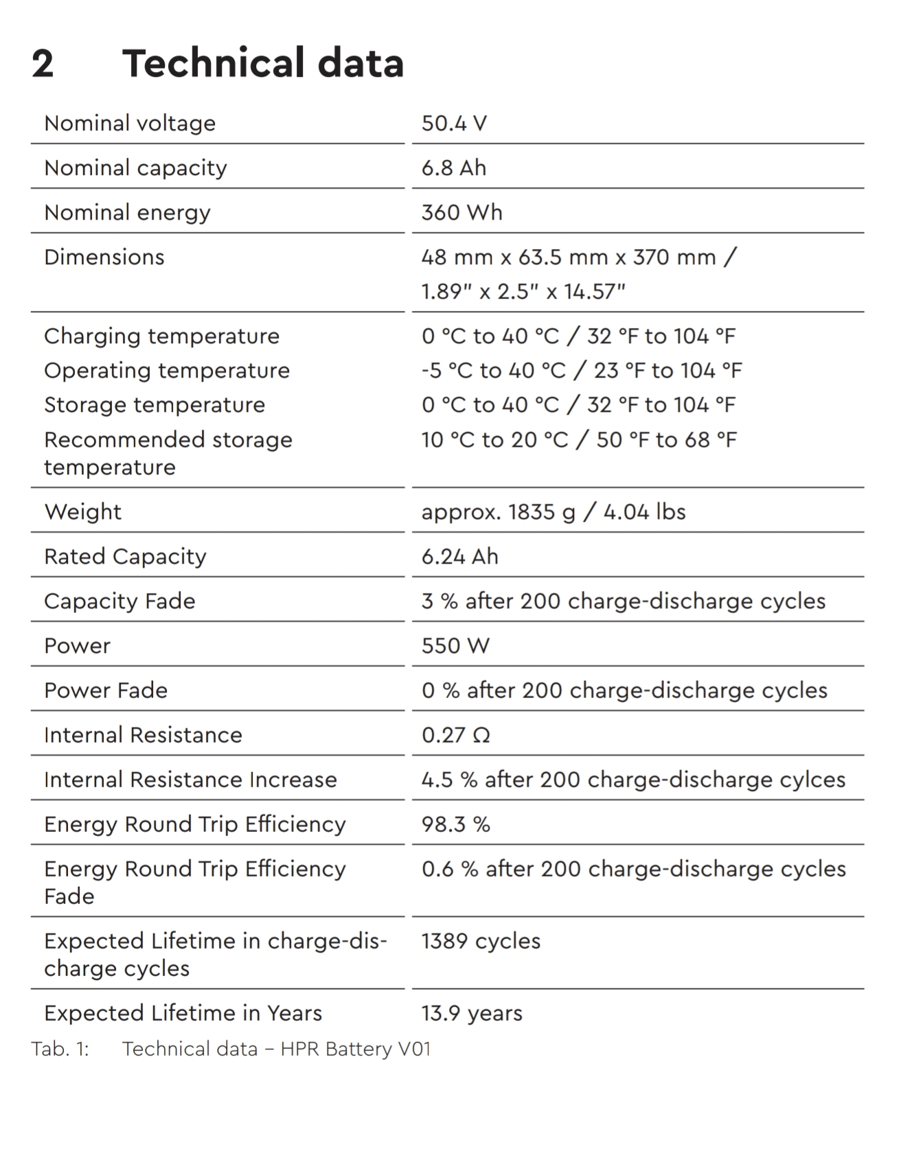

The docs state to expect 3% after 200charge/discharge cycles.
One ofmy batteries has lost just over 5% in about 50 cycles. The other is showing 6.3ah.
My range extender is showing an even bigger loss of capacity.
I'm not sure why tq are showing those stats in the app, it's surely going to lead to a load of people claiming their batteries failed prematurely?
Specs for the 360wh battery below.

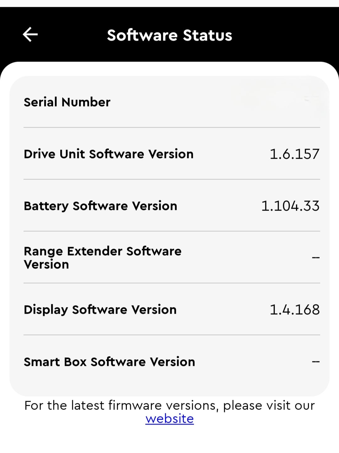

Hi & Happy New Year everyone,
I own a Trek Fuel eXE with the TQ HPR50 motor & have recently taken the bike into my nearest Trek dealer to have the firmware updated.
The dealer is unable (& does not know how) to update the TQ HPR range extender - they have updated the motor, display & battery but are not able to update the range extender firmware.
They have tried updating the bike with the range extender connected but apparently need to disconnect it to process the update & have also tried plugging just the range extender into the diagnostic/update cable without any success.
I have the latest TQ App & it does not seem to recognise the range extender - when in use on the bike the switch between range extender & battery now causes the motor assist to be totally turned off, rather than previously when there was just a short pause in assist with the current assist mode being retained.
The dealer has left it with me to solve the problem (rather than taking it up with TQ themselves) - does anyone have experience of this issue & know how I could update the range extender firmware?
I assumed it would be just a case of plugging in the range extender directly & updating, so not sure if the dealer is doing something incorrectly, as they do not seem to be very knowlegable on the firmware side of things!
Attached screenshot of the TQ app showing the new/current firmware on my bike.
Thanks for your help.

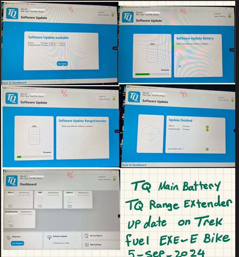

I've updated the firmware of the range extender , you just leave the range extender connected to the bike (as normal via the charge port) and plug the tq service dongle into the range extender.
The tq software then detects all the components (screen, motor, main battery and range extender) and updates them one at a time, it takes a few minutes and is v easy.
I'd try a different dealer, your current one sound as useless as mine.
What is sure is that if the version are not somehow aligned the extender cannot be found as per doc.
Honestly, I know this might be a hard pill but I bought the dongle and got the account/software on my own, you are really better of doing it at home with time and test & tries vs a shop.

Leave your bike with the dealer and tell them to get off their ass, contact Trek/TQ and to call you when it’s updated. It’s really disappointing and unacceptable that they leave it for you to figure out.
Thanks for the responses - it's sounds like it should be as easy as I thought then & something that I could easily sort myself if I had the dongle.
I would have pushed the dealer harder & maybe left the bike, but need/want to keep riding & they were not giving me a lot of confidence that it would get sorted - which I know shouldn't be the case!
Thanks again.
On my 2nd hand exe (with spare 360wh) One battery is at 90% capacity and the other at 93% based on remaining ah in the app. The bike has only done 1050km and I'm not sure how many charges on each battery.
3% sounds a long way off to what others are seeing here. I have a dongle en route so will update this thread when I have latest info.
