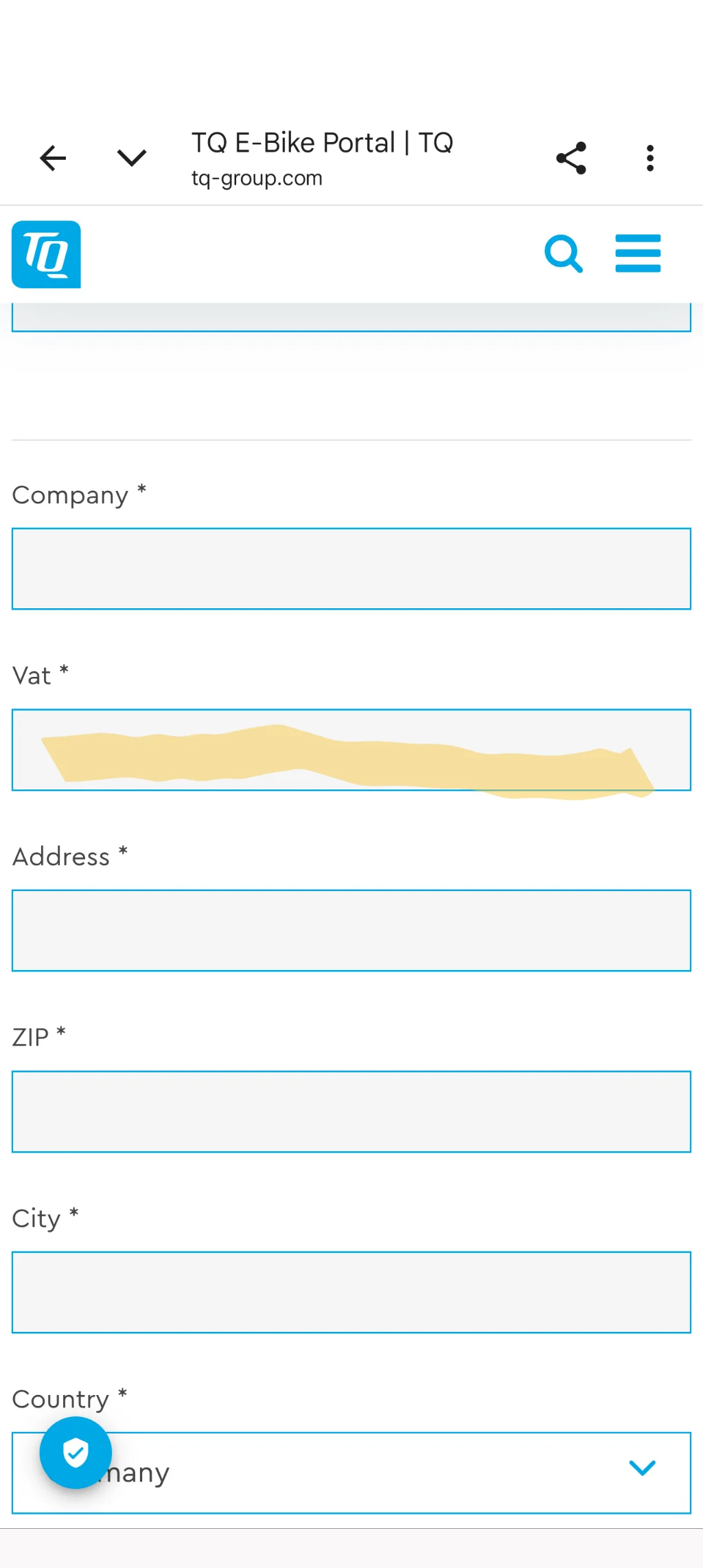

Hello, everyone. I’m currently thinking about buying the dongle to update my HPR50. I’ve almost given up hope that this will ever be possible through the app. As much as I like the TQ motor, the app is stuck in the past—it’s from 10 years ago and just isn’t up to date anymore. The nearest TQ dealer is 50 km away.
If I want to register as a dealer with TQ, I have to provide a sales tax ID number to TQ, otherwise I can’t register there. Of course, I don’t have one. How did you guys solve this?

Hello, and thank you in advance for your reply. I’m from Germany, and since I don’t have a VAT ID—meaning I don’t have a business there—I can’t register.
Where are you from? Maybe there are country-specific differences.
What did you enter in the VAT field?
It doesn't work for me if I don't enter anything there.
I don't want to order the box and then find out I don't have access.
