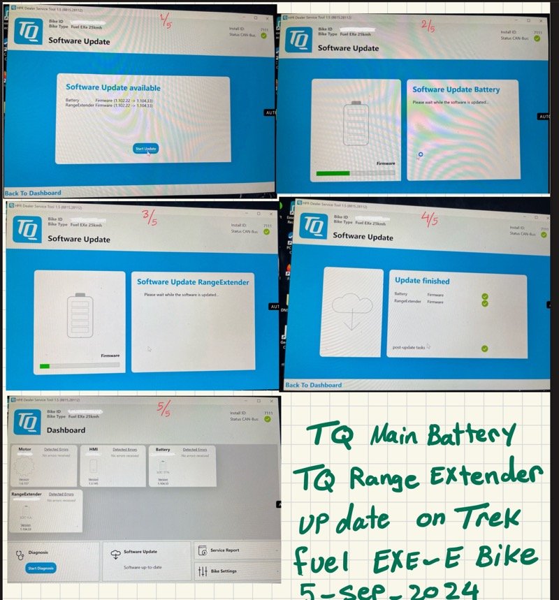

Yes you can , first you download the program from TQ just by small trick and then purchase a cable and finished

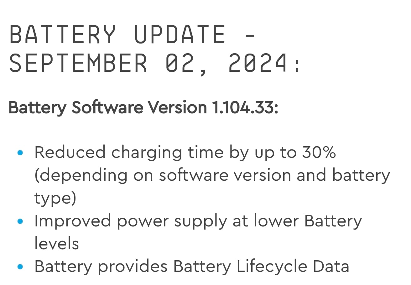

I notice from the tq website that they have just yesterday released a new battery firmware (v 1.104.33), does anyone know what the changes are?
Ill install it in a few days and report back if any obvious changes.
Edit: I found the release notes, looks like a useful update

I thought the release notes had a date of 2 September for this update, which I found a bit curious. Maybe that is their way of announcing future releases... so it may become available tomorrow. 🤔
Any body could up date the battery of Fuel Exe-E battery firm ware , I tried but not updated

I tried again yesterday, but the tq software just kept going round in a loop
I'm waiting for my TQ Dongle to arrive, hopefully this week; then I'll take a swing at updating my firmware and see if the new battery update happens or not.

You will get previous updates for all bike components , so let us know your bike battery firmware after updating
The first thing I noticed , is the charging time of main battery , from 8% to 100 % the main battery charged in 2HR &20 minutes , before it was around 3 HRS & 30 minutes

So my TQ dongle arrived today and I was able to update my Fuel EXe across the board, zero issues. All appear to have the newest firmware.

Has anyone who has installed the new firmware noticed any changes that relates to the "improved power supply at lower battery levels" bulletpoint from the release notes?
Just wondering what this actually is, was thinking they might have reduced the point when the battery goes into low power mode from 10% to 5% or something?
