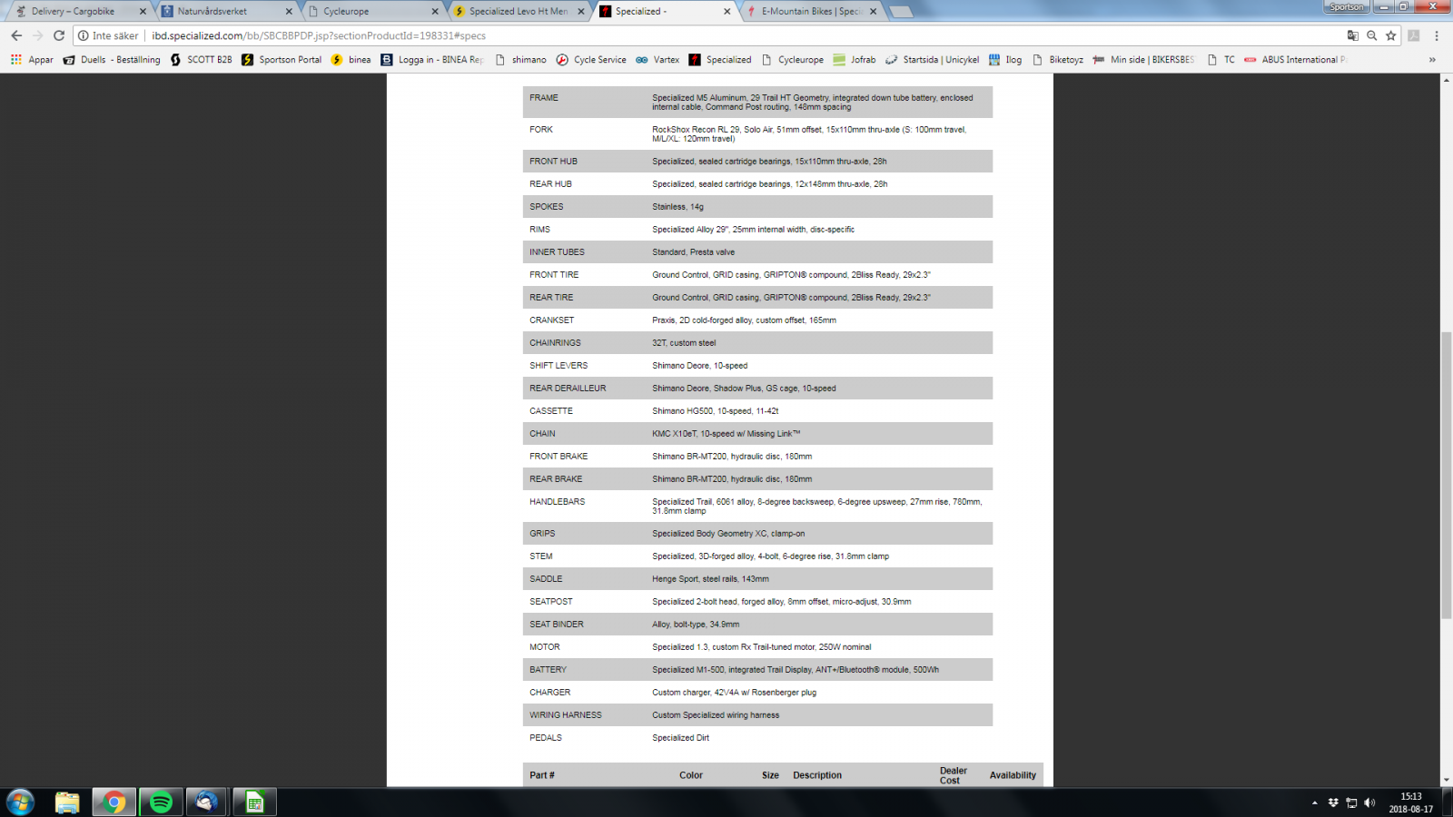

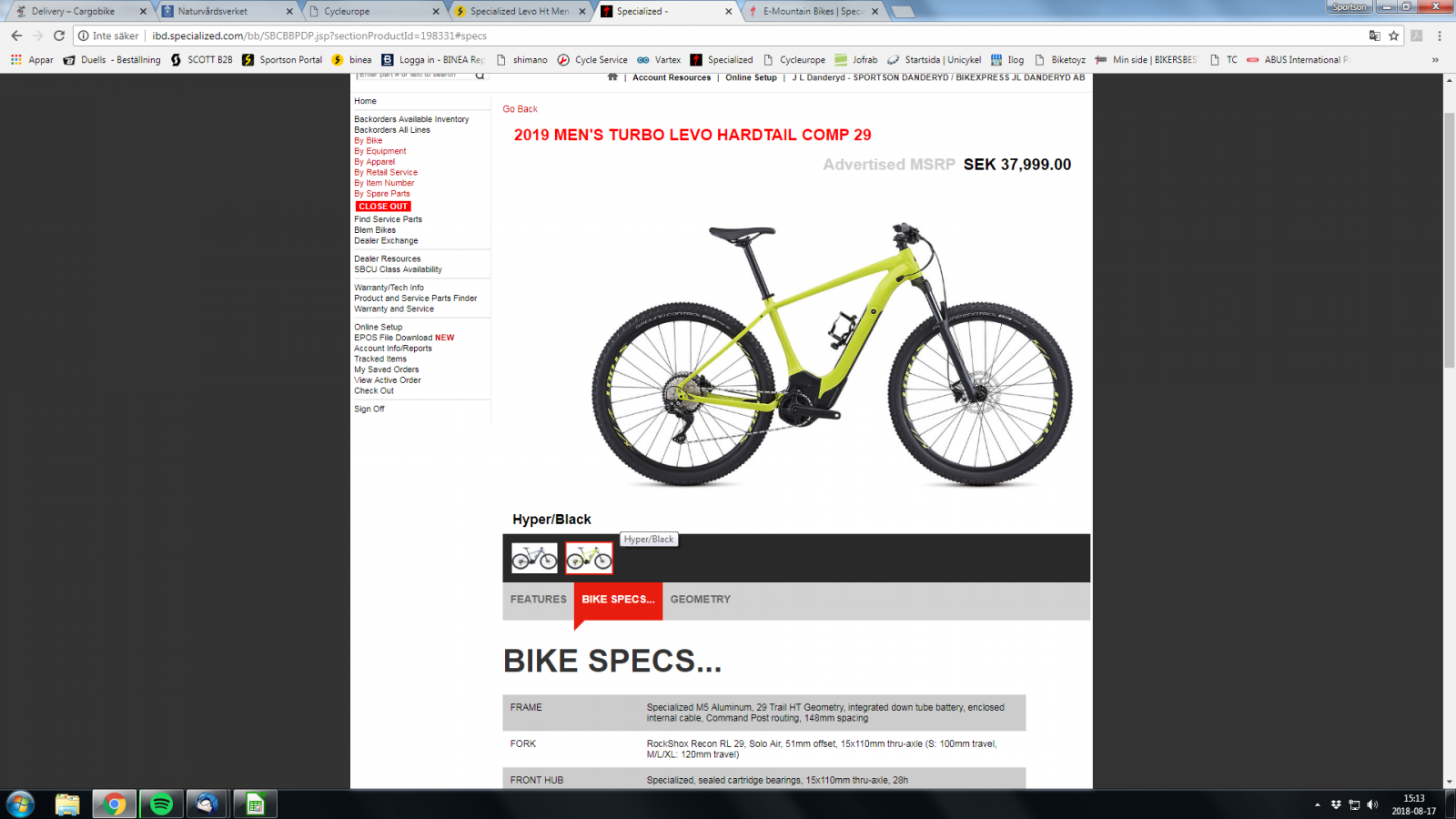

Hi,
Bought my Levo Comp 2019 yesterday and installed Blevo on Iphone. No decent testing at the moment. All I can say for now is that the app connects fine to the bike and that I was able to increase speed limit.
Goal is to tune the bike to make it feel as natural as possible.
Also I'm already thinking about installing another chainring at the front because I feel I have to pedal too fast.
I will use the levo mostly on the road to go to work. Every few weeks it will be used offroad.
Kind Regards
Hi.
Should / may I use Levo’s modes (Eco, Trail, Turbo) when I use Smart Power on Blevo?
Hi,
Kind Regards
Sorry, but are you sure that you have a Levo 2019?
BLEvo for ios is not yet compatible, so I don't think you have a Levo 2019..

Hi @PaoloBLEvo. I've attached the specs for my bike but also @sdelen.
